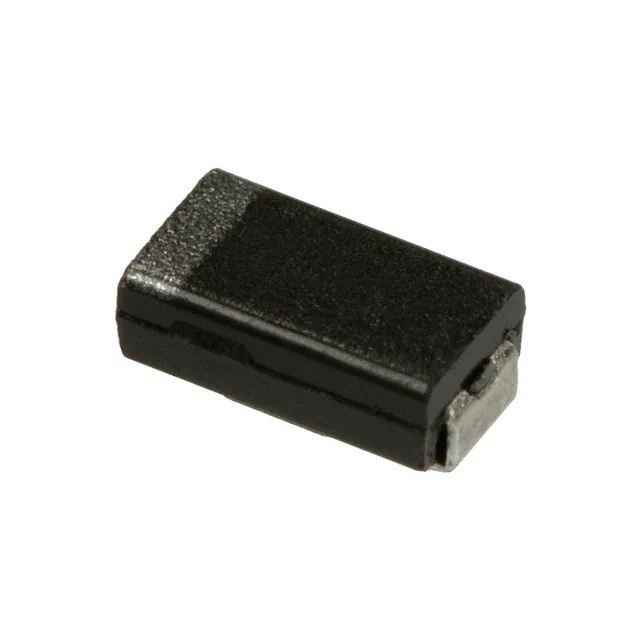

    钽电容 1206 22µF ±20% 2.5V 2.8Ω 3.20 x 1.60mm 1.30mm
F920E226MAA 数据手册
F92 Series – Low Profile F92 Series Resin-Molded Chip, Low Profile J-Lead FEATURES • • • • Compliant to the RoHS3 directive 2015/863/EU SMD J-Lead Low Profile Case Sizes 100% Surge Current Tested LEAD-FREE COMPATIBLE COMPONENT APPLICATIONS • Handheld Electronics • USB Accessories CASE DIMENSIONS: millimeters (inches) Code EIA Code EIA Metric L ± 0.20 (0.008) W+0.20 (0.008) -0.10 (0.004) P 0805 2012-12 2.05 (0.081) 1.30 (0.051) A B 1206 1210 3216-12 3528-12 3.20 (0.126) 3.50 (0.138) 1.60 (0.063) 2.80 (0.110) W1 ±0.20 (0.008) H Max. 1.00 ± 0.10 1.20 (0.047) (0.039 ± 0.004) 1.20 (0.047) 1.20 (0.047) 1.20 (0.047) 2.20 (0.087) A+0.30 (0.012) -0.20 (0.008) S Min. 0.50 (0.020) 0.85 (0.033) 0.80 (0.031) 0.80 (0.031) 1.10 (0.043) 1.40 (0.055) W1 dimension applies to the termination width for a dimensional area only MARKING P CASE A, B CASE Capacitance Value in pF 106 = 10μF Polarity Band (Anode+) 4V 6.3V 10V LOGO Rated Voltage Code J = 6.3V 16V 20V 25V G J A 35V C D E 226 A xxxxx Polarity Band (Anode+) 106 J Capacitance Value in pF 226 = 22μF Rated Voltage Code A = 10V ID Code V *Capacitance code of “P” case products are as shown below. HOW TO ORDER F92 0J 106 M P  Type Rated Voltage Capacitance Code pF code: 1st two digits represent significant figures, 3rd digit represents multiplier (number of zeros to follow) Tolerance K = ±10% M = ±20% Case Size See table above Packaging See Tape & Reel Packaging Section TECHNICAL SPECIFICATIONS Category Temperature Range Rated Temperature Capacitance Tolerance Dissipation Factor ESR 100kHz Leakage Current Capacitance Change By Temperature 28 -55 to +125°C +85°C ±20%, ±10% at 120Hz Refer to next page Refer to next page After 1 minute’s application of rated voltage, leakage current at 20°C is not more than 0.01CV or 0.5μA, whichever is greater. After 1 minute’s application of rated voltage, leakage current at 85°C is not more than 0.1CV or 5μA, whichever is greater. After 1 minute’s application of derated voltage, leakage current at 125°C is not more than 0.125CV or 6.3μA, whichever is greater. P Case A, B Case +20% Max. at +125ºC +15% Max. at +125°C +15% Max. at +85ºC +10% Max. at +85°C -15% Max. at -55ºC -10% Max. at -55°C The Important Information/Disclaimer is incorporated in the catalog where these specifications came from or available online at www.kyocera-avx.com/disclaimer/ by reference and should be reviewed in full before placing any order. TDS-PTNO-0009 | Rev 1 – polymer, tantalum and niobium oxide capacitors – F92 Series Resin-Molded Chip, Low Profile J-Lead CAPACITANCE AND RATED VOLTAGE RANGE (LETTER DENOTES CASE SIZE) Capacitance μF Code 0.22 224 0.33 334 0.47 474 0.68 684 1.0 105 1.5 155 2.2 225 3.3 335 4.7 475 6.8 685 10 106 15 156 22 226 33 336 47 476 68 686 100 107 4V (0G) 6.3V (0J) 10V (1A) B 20V (1D) 25V (1E) A/P A A/P A B 35V (1V) A A A P A A/B B P P P P P P A/P A/P P A/P(M) A B P P P P A/P P(M) A/P(M) B B P P P P P A Rated Voltage 16V (1C) A/P A A/B B B B A(M)/B *Cap Code J N S W A E J N S w a e j n s w A Released ratings **Rated temperature 60ºC only. Please contact KYOCERA AVX when you need detail spec. Please contact to your local KYOCERA AVX sales office when these series are being designed in your application. (M tolerance only) RATINGS & PART NUMBER REFERENCE Part Number Case Size Capacitance (μF) Rated Voltage (V) DCL (μA) F920G335#PA F920G475#PA F920G685#PA F920G106#PA F920G156#PA F920G226#AA F920G476#BA F920G107MAA F920G107#BA P P P P P A B A B 3.3 4.7 6.8 10 15 22 47 100 100 4 4 4 4 4 4 4 4 4 0.5 0.5 0.5 0.5 0.6 0.9 1.9 4.0 4.0 F920J225#PA F920J335#PA F920J475#PA F920J685#PA F920J106#AA F920J106#PA F920J156MPA F920J226#AA F920J226MPA F920J336#BA F920J476#BA P P P P A P P A P B B 2.2 3.3 4.7 6.8 10 10 15 22 22 33 47 6.3 6.3 6.3 6.3 6.3 6.3 6.3 6.3 6.3 6.3 6.3 0.5 0.5 0.5 0.5 0.6 0.6 0.9 1.4 1.4 2.1 3.0 F921A105#PA F921A155#PA F921A225#PA F921A335#AA F921A335#PA F921A475#AA F921A475#PA F921A685#PA F921A106#AA F921A106MPA F921A156#AA F921A226#BA P P P A P A P P A P A B 1 1.5 2.2 3.3 3.3 4.7 4.7 6.8 10 10 15 22 10 10 10 10 10 10 10 10 10 10 10 10 0.5 0.5 0.5 0.5 0.5 0.5 0.5 0.7 1.0 1.0 1.5 2.2 F921C474#PA P 0.47 16 0.5 DF @ 120Hz (%) 8 8 10 10 10 12 12 30 18 ESR @ 100kHz (Ω) 4 Volt 12.0 6.0 6.0 6.0 5.0 2.8 1.7 2.8 1.3 6.3 Volt 8 12.0 8 12.0 8 6.0 10 6.0 8 4.0 10 6.0 10 6.0 12 2.8 20 5.0 12 1.7 12 1.7 10 Volt 8 12.0 8 12.0 8 12.0 6 7.0 8 12.0 6 4.0 8 6.0 8 6.0 8 4.0 14 6.0 8 4.0 8 1.9 16 Volt 8 20.0 25ºC 100kHz RMS Current (mA) 60ºC 85ºC 125ºC *1 ΔC/C (%) MSL 50 71 71 71 77 146 210 146 240 – – – – – – – – – 45 64 64 64 70 132 189 132 216 20 28 28 28 31 59 84 59 96 * * * * * * * ±15 * 1 1 1 1 1 1 1 1 1 50 50 71 71 122 71 71 146 77 210 210 – – – – – – – – – – – 45 45 64 64 110 64 64 132 70 189 189 20 20 28 28 49 28 28 59 31 84 84 * * * * * * * * * * * 1 1 1 1 1 1 1 1 1 1 3 50 50 50 93 50 122 71 71 122 71 122 199 – – – – – – – – – – – – 45 45 45 83 45 110 64 64 110 64 110 179 20 20 20 37 20 49 28 28 49 28 49 79 * * * * * * * * * * * * 1 1 1 1 1 1 1 1 1 1 1 3 39 – 35 15 * 1 The Important Information/Disclaimer is incorporated in the catalog where these specifications came from or available online at www.kyocera-avx.com/disclaimer/ by reference and should be reviewed in full before placing any order. TDS-PTNO-0009 | Rev 1 – polymer, tantalum and niobium oxide capacitors – 29 F92 Series Resin-Molded Chip, Low Profile J-Lead RATINGS & PART NUMBER REFERENCE Part Number Case Size Capacitance (μF) Rated Voltage (V) DCL (μA) DF @ 120Hz (%) ESR @ 100kHz (Ω) F921C684#PA F921C105#PA F921C225#AA F921C225#PA F921C335#AA F921C475#AA F921C475#BA F921C685#BA F921C106#BA P P A P A A B B B 0.68 1 2.2 2.2 3.3 4.7 4.7 6.8 10 16 16 16 16 16 16 16 16 16 0.5 0.5 0.5 0.5 0.5 0.8 0.8 1.1 1.6 8 8 6 8 6 6 6 6 6 12.0 12.0 7.0 12.0 7.0 7.0 3.0 3.0 2.0 F921D474#AA F921D474#PA F921D684#AA F921D105#AA F921D105#PA F921D155#AA F921D225#BA A P A A P A B 0.47 0.47 0.68 1 1 1.5 2.2 20 20 20 20 20 20 20 0.5 0.5 0.5 0.5 0.5 0.5 0.5 4 8 4 4 8 6 6 F921E105#PA F921E225#AA F921E225#BA F921E475#BA P A B B 1 2.2 2.2 4.7 25 25 25 25 0.5 0.6 0.6 1.2 8 8 6 6 F921V224#AA F921V334#AA F921V474#AA F921V105#AA F921V225#BA A A A A B 0.22 0.33 0.47 1 2.2 35 35 35 35 35 0.5 0.5 0.5 0.5 0.8 4 4 4 6 6 20 Volt 25 Volt 35 Volt 25ºC 50 50 93 50 93 93 158 158 194 100kHz RMS Current (mA) 60ºC 85ºC – – – – – – – – – 45 45 83 45 83 83 142 142 174 *1 ΔC/C (%) MSL 20 20 37 20 37 37 63 63 77 * * * * * * * * * 1 1 1 1 1 1 1 1 1 125ºC 10.0 20.0 10.0 10.0 20.0 7.4 6 77 39 77 77 39 90 115 – – – – – – – 70 35 70 70 35 81 104 31 15 31 31 15 36 46 * * * * * * * 1 1 1 1 1 1 1 20.0 10.0 4.0 3.0 39 77 137 158 – – – – 35 70 123 142 15 31 55 63 * ±15 * * 1 1 1 1 10.0 10.0 10.0 10.0 4.0 77 77 77 77 137 – – – – – 70 70 70 70 123 31 31 31 31 55 * * * * ±10 1 1 1 1 1 *1: ΔC/C Marked “*” Item Damp Heat Temperature cycles Resistance soldering heat Surge Endurance 30 P Case (%) ±20 ±10 ±10 ±10 ±10 A, B Case (%) ±10 ±5 ±5 ±5 ±10 #: "M" for ±20% tolerance, "K" for ± 10% tolerance. When you need K tolerance for the part numbers which have M tolerance only, please contact to your local KYOCERA AVX sales office. Moisture Sensitivity Level (MSL) is defined according to J-STD-020. The Important Information/Disclaimer is incorporated in the catalog where these specifications came from or available online at www.kyocera-avx.com/disclaimer/ by reference and should be reviewed in full before placing any order. TDS-PTNO-0009 | Rev 1 – polymer, tantalum and niobium oxide capacitors – F92 Series Resin-Molded Chip, Low Profile J-Lead QUALIFICATION TABLE TEST P Case Damp Heat (Steady State) Temperature Cycles Resistance to Soldering Heat Surge Endurance Shear Test Terminal Strength F92 series (Temperature range -55ºC to +125ºC) Condition A, B Case At 40°C, 90 to 95% R.H., 500 hours (No voltage applied) Capacitance Change .................Refer to the table above (*1) Refer to the table above (*1) Dissipation Factor.......................150% or less than the initial specified value Initial specified value or less Leakage Current ......................... Initial specified value or less Initial specified value or less -55°C / +125°C, 30 minutes each, 5 cycles Capacitance Change .................Refer to the table above (*1) Refer to the table above (*1) Dissipation Factor ......................150% or less than the initial specified value Initial specified value or less Leakage Current .........................Initial specified value or less Initial specified value or less 10 seconds reflow at 260°C, 5 seconds immersion at 260°C. Capacitance Change..................Refer to the table above (*1) Refer to the table above (*1) Dissipation Factor ......................150% or less than the initial specified value Initial specified value or less Leakage Current .........................Initial specified value or less Initial specified value or less After application of surge voltage in series with a 33Ω (For “P” case: 1kΩ) resistor at the rate of 30 seconds ON, 30 seconds OFF, for 1000 successive test cycles at 85ºC, capacitors shall meet the characteristic requirements in the table above. Capacitance Change..................Refer to the table above (*1) Refer to the table above (*1) Dissipation Factor ......................150% or less than the initial specified value Initial specified value or less Leakage Current ......................... Initial specified value or less Initial specified value or less After 2000 hours’ application of rated voltage in series with a 3Ω resistor at 85°C, or derated voltage in series with a 3Ω resistor at 125°C, capacitors shall meet the characteristic requirements in the table above. Capacitance Change .................. Refer to the table above (*1) Refer to the table above (*1) Dissipation Factor .. ..................... 150% or less than the initial specified value Initial specified value or less Leakage Current ......................... Initial specified value or less Initial specified value or less After applying the pressure load of 5N for 10±1 seconds horizontally to the center of capacitor side body which has no electrode and has been soldered beforehand on a substrate, there shall be found neither exfoliation nor its sign at the terminal electrode. Keeping a capacitor surface-mounted on a substrate upside down and supporting the substrate at both of the opposite bottom points 45mm apart from the center of capacitor, the pressure strength is applied with a specified jig at the center of substrate so that the substrate may bend by 1mm as illustrated. Then, there shall be found no remarkable abnormality on the capacitor terminals. The Important Information/Disclaimer is incorporated in the catalog where these specifications came from or available online at www.kyocera-avx.com/disclaimer/ by reference and should be reviewed in full before placing any order. TDS-PTNO-0009 | Rev 1 – polymer, tantalum and niobium oxide capacitors – 31 F92 Series Resin-Molded Chip, Low Profile J-Lead SOLID ELECTROLYTIC CAPACITOR ROADMAP SERIES LINE UP: CONVENTIONAL SMD MnO2 TMJ High Rel. & Special High Temp THH ultra low DCL THJ 200°C THJ F97-HT3 175°C auto 135°C auto TRM TRJ Industrial & Automotive 230°C COTS+ Hermetic professional multianode professional TAJ F91-AJ6 auto TPS auto *T/*U F93-AJ6 auto *T/*U TPS F97 professional auto F98-AJ6 auto TPM multianode Standard TAJ Standard Low Profile High CV 32 TAJ TLN undertab F91 TAC Low Profile microchip TLJ microchip TLC F93 TPC microchip Low ESR F98-AS1 undertab, fused F92 F98 undertab The Important Information/Disclaimer is incorporated in the catalog where these specifications came from or available online at www.kyocera-avx.com/disclaimer/ by reference and should be reviewed in full before placing any order. TDS-PTNO-0009 | Rev 1 – polymer, tantalum and niobium oxide capacitors –
