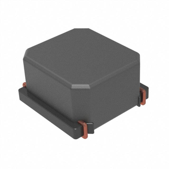

    固定电感器 Nonstandard 22µH ±20% 2.2A 66mΩ
LMLP0808M220CTAS 数据手册
LMax Low Profile Power Inductor LMLP Series – Style C FEATURES INDUCTANCE AND RATED CURRENT RANGES • Small and low profile inductor • It corresponds to high current • Simple and original magnetic shield structure APPLICATIONS • For small DC/DC converter (cellular phone, HDD, DVC, DSC, PDA, LCD display etc.) CHARACTERISTICS • Operating Temperature Range: -40°C to +125°C • Storage Temperature Range: -40°C to +85°C • Saturation Current: The saturation current value (lSAT) is the DC current value when the inductance decreases by 30% of it initial value (at 20ºC). • Temperature Rise Current: The temperature rise current value (IRMS) is the DC current value that increases component temperature by up to 40ºC. • • • • • • • • • • • • • • • • 0202 0303 03A2 03B3 0404 04A4 04B4 0505 05B5 05D5 0606 06A6 06B6 06C6 06D6 0808 2.2 ~ 22μH 1.0 ~ 22μH 1.0 ~ 22μH 1.0 ~ 22μH 1.0 ~ 22μH 1.0 ~ 22μH 1.0 ~ 220μH 10μH 1.50 ~ 22.0μH 1.50 ~ 47.0μH 4.7 ~ 10.0μH 2.50 ~ 100μH 0.80 ~ 22.0μH 1.50 ~ 100μH 1.30 ~ 100μH 0.90 ~ 22μH 1.290 ~ 0.390A 1.30 ~ 0.350A 1.50 ~0.370A 2.10 ~ 0.470A 1.80 ~ 0.360A 2.50 ~ 0.510A 4.0 ~ 0.270A 1.00A 3.35 ~ 0.90A 6.00 ~ 1.10A 1.40 ~ 1.00A 2.10 ~ 0.35A 5.50 ~ 1.05A 5.00 ~ 0.62A 8.00 ~ 0.80A 11.0 ~ 2.2A DIMENSIONS A G C D B E H E H PCB Pattern mm (inches) Type A B C max D E F G H 0202 2.40 ± 0.10 (0.095 ± 0.004) 2.40 ± 0.10 (0.095 ± 0.004) 1.00 (0.039) 1.45 ± 0.20 (0.057 ± 0.008) 0.60 ± 0.20 (0.240 ± 0.008) 1.45 (0.057) 2.00 (0.079) 0.70 (0.028) 0303 3.00 ± 0.20 (0.118 ± 0.008) 3.00 ± 0.20 (0.118 ± 0.008) 1.00 (0.039) 1.90 ± 0.20 (0.075 ± 0.008) 0.90 ± 0.20 (0.035 ± 0.008) 2.20 (0.087) 2.70 (0.106) 0.80 (0.032) 03A2 3.00 ± 0.20 (0.118 ± 0.008) 3.00 ± 0.20 (0.118 ± 0.008) 1.20 (0.047) 1.90 ± 0.20 (0.075 ± 0.008) 0.90 ± 0.20 (0.035 ± 0.008) 2.20 (0.087) 2.70 (0.106) 0.80 (0.032) 03B3 3.00 ± 0.20 (0.118 ± 0.008) 3.00 ± 0.20 (0.118 ± 0.008) 1.50 (0.059) 1.90 ± 0.20 (0.075 ± 0.008) 0.90 ± 0.20 (0.035 ± 0.008) 2.20 (0.087) 2.70 (0.106) 0.80 (0.032) 0404 4.00 ± 0.20 (0.157 ± 0.008) 4.00 ± 0.20 (0.157 ± 0.008) 1.00 (0.039) 2.50 ± 0.20 (0.099 ± 0.008) 1.10 ± 0.20 (0.043 ± 0.008) 2.80 (0.110) 3.70 (0.146) 1.20 (0.047) 04A4 4.00 ± 0.20 (0.157 ± 0.008) 4.00 ± 0.20 (0.157 ± 0.008) 1.20 (0.047) 2.50 ± 0.20 (0.099 ± 0.008) 1.10 ± 0.20 (0.043 ± 0.008) 2.80 (0.110) 3.70 (0.146) 1.20 (0.047) 04B4 4.00 ± 0.20 (0.157 ± 0.008) 4.00 ± 0.20 (0.157 ± 0.008) 1.80 (0.071) 2.50 ± 0.20 (0.099 ± 0.008) 1.10 ± 0.20 (0.043 ± 0.008) 2.80 (0.110) 3.70 (0.146) 1.20 (0.047) 0505 5.00 ± 0.20 (0.197 ± 0.008) 5.00 ± 0.20 (0.197 ± 0.008) 1.00 (0.039) 3.50 ± 0.20 (0.138 ± 0.008) 1.50 ± 0.20 (0.059 ± 0.008) 3.80 (0.150) 4.70 (0.185) 1.60 (0.063) 05B5 5.00 ± 0.20 (0.197 ± 0.008) 5.00 ± 0.20 (0.197 ± 0.008) 2.00 (0.078) 3.50 ± 0.20 (0.138 ± 0.008) 1.50 ± 0.20 (0.059 ± 0.008) 3.80 (0.150) 4.70 (0.185) 1.60 (0.063) 05D5 5.00 ± 0.20 (0.197 ± 0.008) 5.00 ± 0.20 (0.197 ± 0.008) 4.00 (0.157) 3.50 ± 0.20 (0.138 ± 0.008) 1.50 ± 0.20 (0.059 ± 0.008) 3.80 (0.150) 4.70 (0.185) 1.60 (0.063) 0606 6.00 ± 0.20 (0.236 ± 0.008) 6.00 ± 0.20 (0.236 ± 0.008) 1.00 ± 0.10 (0.039 ± 0.004) 4.00 ± 0.20 (0.157 ± 0.008) 1.35 ± 0.20 (0.053 ± 0.008) 4.70 (0.185) 5.70 (0.224) 1.60 (0.063) 06A6 6.00 ± 0.20 (0.236 ± 0.008) 6.00 ± 0.20 (0.236 ± 0.008) 1.20 (0.047) 4.00 ± 0.20 (0.157 ± 0.008) 1.35 ± 0.20 (0.053 ± 0.008) 4.70 (0.185) 5.70 (0.224) 1.60 (0.063) 06B6 6.00 ± 0.20 (0.236 ± 0.008) 6.00 ± 0.20 (0.236 ± 0.008) 2.00 (0.078) 4.00 ± 0.20 (0.157 ± 0.008) 1.35 ± 0.20 (0.053 ± 0.008) 4.70 (0.185) 5.70 (0.224) 1.60 (0.063) 06C6 6.00 ± 0.20 (0.236 ± 0.008) 6.00 ± 0.20 (0.236 ± 0.008) 2.80 (0.110) 4.00 ± 0.20 (0.157 ± 0.008) 1.35 ± 0.20 (0.053 ± 0.008) 4.70 (0.185) 5.70 (0.224) 1.60 (0.063) 06D6 6.00 ± 0.20 (0.236 ± 0.008) 6.00 ± 0.20 (0.236 ± 0.008) 4.50 (0.177) 4.00 ± 0.20 (0.157 ± 0.008) 1.35 ± 0.20 (0.053 ± 0.008) 4.70 (0.185) 5.70 (0.224) 1.60 (0.063) 0808 8.00 ± 0.20 (0.315 ± 0.008) 8.00 ± 0.20 (0.315 ± 0.008) 4.20 (0.165) 5.60 ± 0.30 (0.220 ± 0.011) 1.60 ± 0.30 (0.063 ± 0.011) 5.60 (0.220) 7.50 (0.188) 1.80 (0.071) The Important Information/Disclaimer is incorporated in the catalog where these specifications came from or available online at www.avx.com/disclaimer/ by reference and should be reviewed in full before placing any order. 103020 49 LMax Low Profile Power Inductor LMLP Series – Style C HOW TO ORDER LM LP Family LM = Power Inductor Series LP = Low Profile 0303 M Size Tolerance 0303 = 3x3xh 03A3 = 3x3xA(h) (h = see catalog) M = 20% N = 30% R04 C T Inductance Style Termination R39 = 0.390μH 3R9 = 3.900μH 390 = 39.00μH 391 = 390.0μH A T = Sn Plate Special A = Standard S Packaging R = 7" Reel S = 13" Reel ELECTRICAL CHARACTERISTICS 0202 AVX PN L (μH) at 100KHz 1.0V Tolerance LMLP0202N2R2CTAR LMLP0202N3R3CTAR LMLP0202N4R7CTAR LMLP0202N6R8CTAR LMLP0202M100CTAR LMLP0202M150CTAR LMLP0202M220CTAR 2.2 3.3 4.7 6.8 10 15 22 ±30% ±30% ±30% ±30% ±20% ±20% ±20% AVX PN L (μH) at 100KHz 1.0V Tolerance LMLP0303N1R5CTAR LMLP0303N2R2CTAR LMLP0303N3R3CTAR LMLP0303N4R7CTAR LMLP0303N6R8CTAR LMLP0303M100CTAR LMLP0303M150CTAR LMLP0303M220CTAR 1.5 2.2 3.3 4.7 6.8 10 15 22 ±30% ±30% ±30% ±30% ±30% ±20% ±20% ±20% AVX PN L (μH) at 100KHz 1.0V Tolerance LMLP03A2N1R0CTAR LMLP03A2N1R5CTAR LMLP03A2N2R2CTAR LMLP03A2N3R3CTAR LMLP03A2N4R7CTAR LMLP03A2N6R8CTAR LMLP03A2M100CTAR LMLP03A2M150CTAR LMLP03A2M220CTAR 1.0 1.5 2.2 3.3 4.7 6.8 10 15 22 ±30% ±30% ±30% ±30% ±30% ±30% ±20% ±20% ±20% ISAT* (A) 1.29 1 0.88 0.75 0.55 0.47 0.39 IRMS** (A) 0.97 0.77 0.67 0.57 0.45 0.37 0.3 DCR ±20% (Ω) ISAT* (A) 1.2 1.1 0.87 0.75 0.61 0.5 0.4 0.35 IRMS** (A) 1.3 1.1 0.94 0.78 0.63 0.51 0.4 0.35 DCR ±20% (Ω) ISAT* (A) 1.5 1.36 1.1 0.91 0.77 0.67 0.54 0.44 0.37 IRMS** (A) 1.49 1.4 1.2 1.05 0.98 0.74 0.63 0.485 0.42 DCR ±20% (Ω) 0.15 0.22 0.29 0.41 0.69 1.02 1.47 0303 0.08 0.095 0.14 0.19 0.3 0.45 0.74 1.03 03A2 *The saturation current value (lSAT) is the DC current value when the inductance decreases by 30% of it initial value (at 20ºC). **The temperature rise current value (IRMS) is the DC current value that increases component temperature by up to 40ºC. 50 The Important Information/Disclaimer is incorporated in the catalog where these specifications came from or available online at www.avx.com/disclaimer/ by reference and should be reviewed in full before placing any order. 103020 0.05 0.06 0.08 0.1 0.13 0.19 0.29 0.45 0.63 LMax Low Profile Power Inductor LMLP Series – Style C 03B3 I SAT* (A) 2.1 1.8 1.48 1.21 1.02 0.87 0.7 0.56 0.47 I RMS** (A) 2.1 1.82 1.5 1.23 1.04 0.88 0.71 0.56 0.47 DCR ±20% (Ω) Tolerance I SAT* (A) I RMS** (A) DCR ±20% (Ω) 1.0 2.2 3.3 4.7 6.8 10 15 22 ±30% ±30% ±30% ±30% ±30% ±30% ±20% ±20% 1.8 1.15 1.1 0.9 0.74 0.56 0.47 0.36 1.05 0.89 0.82 0.75 0.62 0.6 0.51 0.4 0.1 0.15 0.18 0.21 0.3 0.38 0.51 0.87 AVX PN L (μH) at 100KHz 1.0V Tolerance I SAT* (A) I RMS** (A) DCR ±20% (Ω) LMLP04A4N1R0CTAS LMLP04A4N2R2CTAS LMLP04A4N3R3CTAS LMLP04A4N4R7CTAS LMLP04A4N6R8CTAS LMLP04A4M100CTAS LMLP04A4M150CTAS LMLP04A4M220CTAS 1.0 2.2 3.3 4.7 6.8 10 15 22 ±30% ±30% ±30% ±30% ±30% ±20% ±20% ±20% 2.5 1.65 1.2 1.05 0.9 0.74 0.56 0.51 1.5 1.2 0.98 0.96 0.84 0.77 0.6 0.54 0.06 0.09 0.13 0.14 0.18 0.24 0.4 0.48 AVX PN L (μH) at 100KHz 1.0V Tolerance LMLP03B3N1R0CTAR LMLP03B3N1R5CTAR LMLP03B3N2R2CTAR LMLP03B3N3R3CTAR LMLP03B3N4R7CTAR LMLP03B3N6R8CTAR LMLP03B3M100CTAR LMLP03B3M150CTAR LMLP03B3M220CTAR 1.0 1.5 2.2 3.3 4.7 6.8 10 15 22 ±30% ±30% ±30% ±30% ±30% ±30% ±20% ±20% ±20% AVX PN L (μH) at 100KHz 1.0V LMLP0404N1R0CTAS LMLP0404N2R2CTAS LMLP0404N3R3CTAS LMLP0404N4R7CTAS LMLP0404N6R8CTAS LMLP0404N100CTAS LMLP0404M150CTAS LMLP0404M220CTAS 0.03 0.04 0.06 0.08 0.12 0.16 0.23 0.36 0.52 0404 04A4 *The saturation current value (lSAT) is the DC current value when the inductance decreases by 30% of it initial value (at 20ºC). **The temperature rise current value (IRMS) is the DC current value that increases component temperature by up to 40ºC. The Important Information/Disclaimer is incorporated in the catalog where these specifications came from or available online at www.avx.com/disclaimer/ by reference and should be reviewed in full before placing any order. 102920 51 LMax Low Profile Power Inductor LMLP Series – Style C 04B4 AVX PN L (μH) at 100KHz 1.0V Tolerance LMLP04B4N1R0CTAS LMLP04B4N2R2CTAS LMLP04B4N3R3CTAS LMLP04B4N4R7CTAS LMLP04B4N6R8CTAS LMLP04B4M100CTAS LMLP04B4M150CTAS LMLP04B4M220CTAS LMLP04B4M330CTAS LMLP04B4M470CTAS LMLP04B4M680CTAS LMLP04B4M101CTAS LMLP04B4M151CTAS LMLP04B4M221CTAS 1.0 2.2 3.3 4.7 6.8 10 15 22 33 47 68 100 150 220 ±30% ±30% ±30% ±30% ±30% ±20% ±20% ±20% ±20% ±20% ±20% ±20% ±20% ±20% AVX PN L (μH) at 100KHz 1.0V Tolerance LMLP0505M100CTAR 10 ±20% AVX PN L (μH) at 100KHz 1.0V Tolerance LMLP05B5N1R5CTAR LMLP05B5N2R2CTAR LMLP05B5N3R3CTAR LMLP05B5N4R7CTAR LMLP05B5N6R8CTAR LMLP05B5M100CTAR LMLP05B5M150CTAR LMLP05B5M220CTAR 1.5 2.2 3.3 4.7 6.8 10 15 22 ±30% ±30% ±30% ±30% ±30% ±20% ±20% ±20% AVX PN L (μH) at 100KHz 1.0V Tolerance LMLP05D5N1R5CTAS LMLP05D5N2R2CTAS LMLP05D5N3R3CTAS LMLP05D5N4R7CTAS LMLP05D5N6R8CTAS LMLP05D5M100CTAS LMLP05D5M150CTAS LMLP05D5M220CTAS LMLP05D5M330CTAS LMLP05D5M470CTAS 1.5 2.2 3.3 4.7 6.8 10 15 22 33 47 ±30% ±30% ±30% ±30% ±30% ±20% ±20% ±20% ±20% ±20% I SAT* (A) 4 2.7 2 1.7 1.45 1.2 0.94 0.8 0.65 0.57 0.47 0.4 0.31 0.27 I RMS** (A) 1.83 1.44 1.23 1.2 1.06 0.84 0.65 0.59 0.49 0.42 0.32 0.27 0.22 0.17 DCR ±20% (Ω) I SAT* (A) 1 I RMS** (A) 0.94 DCR ±20% (Ω) I SAT* (A) 3.35 2.9 2.4 2 1.6 1.3 1.1 0.9 I RMS** (A) 3.2 2.9 2.4 2 1.65 1.45 1.2 1 DCR ±20% (Ω) I SAT* (A) 6 4.6 3.8 3.3 2.6 2.3 2 1.6 1.3 1.1 I RMS** (A) 3.6 3.5 3.3 3.1 2.3 2.1 1.8 1.4 1.2 0.9 DCR ±20% (Ω) 0.03 0.06 0.07 0.09 0.11 0.18 0.28 0.36 0.53 0.65 1 1.5 2.5 4 0505 0.48 05B5 0.026 0.035 0.048 0.06 0.09 0.12 0.165 0.26 05D5 *The saturation current value (lSAT) is the DC current value when the inductance decreases by 30% of it initial value (at 20ºC). **The temperature rise current value (IRMS) is the DC current value that increases component temperature by up to 40ºC. 52 The Important Information/Disclaimer is incorporated in the catalog where these specifications came from or available online at www.avx.com/disclaimer/ by reference and should be reviewed in full before placing any order. 102720 0.02 0.022 0.027 0.029 0.049 0.056 0.08 0.126 0.18 0.31 LMax Low Profile Power Inductor LMLP Series – Style C 0606 AVX PN L (μH) at 100KHz 1.0V Tolerance LMLP0606N4R7CTAR LMLP0606N6R8CTAR LMLP0606M100CTAR 4.7 6.8 10 ±30% ±30% ±20% AVX PN L (μH) at 100KHz 1.0V Tolerance LMLP06A6N2R5CTAR LMLP06A6N6R8CTAR LMLP06A6M100CTAR LMLP06A6M150CTAR LMLP06A6M220CTAR LMLP06A6M330CTAR LMLP06A6M470CTAR LMLP06A6M680CTAR LMLP06A6M101CTAR 2.5 6.8 10 15 22 33 47 68 100 ±30% ±30% ±20% ±20% ±20% ±20% ±20% ±20% ±20% AVX PN L (μH) at 100KHz 1.0V Tolerance LMLP06B6N0R8CTAS LMLP06B6N1R5CTAS LMLP06B6N2R2CTAS LMLP06B6N3R3CTAS LMLP06B6N4R7CTAS LMLP06B6N6R8CTAS LMLP06B6M100CTAS LMLP06B6M220CTAS 0.8 1.5 2.2 3.3 4.7 6.8 10 22 ±30% ±30% ±30% ±30% ±30% ±30% ±20% ±20% AVX PN L (μH) at 100KHz 1.0V Tolerance LMLP06C6N1R5CTAS LMLP06C6N2R2CTAS LMLP06C6N3R0CTAS LMLP06C6N4R7CTAS LMLP06C6N6R0CTAS LMLP06C6M100CTAS LMLP06C6M150CTAS LMLP06C6M220CTAS LMLP06C6M330CTAS LMLP06C6M470CTAS LMLP06C6M680CTAS LMLP06C6M101CTAS 1.5 2.2 3 4.7 6 10 15 22 33 47 68 100 ±30% ±30% ±30% ±30% ±30% ±20% ±20% ±20% ±20% ±20% ±20% ±20% I SAT* (A) 1.4 1.2 1 I RMS** (A) 1.4 1 0.85 DCR ±20% (Ω) I SAT* (A) 2.1 1.3 1 0.8 0.76 0.59 0.52 0.44 0.35 I RMS** (A) 1.73 1.18 1 0.79 0.63 0.53 0.46 0.41 0.32 DCR ±20% (Ω) I SAT* (A) 5.5 4 3.2 2.8 2.4 2 1.7 1.05 I RMS** (A) 3.8 3.2 2.7 2.6 2 1.8 1.4 0.95 DCR ±20% (Ω) I SAT* (A) 5 4.2 3.6 2.7 2.5 1.9 1.6 1.3 1.1 0.95 0.76 0.62 I RMS** (A) 4.2 3.7 3.4 3 2.5 1.9 1.8 1.4 1.1 0.92 0.77 0.66 DCR ±20% (Ω) 0.29 0.372 0.5 06A6 0.09 0.165 0.235 0.33 0.53 0.7 1.05 1.35 2.18 06B6 0.02 0.026 0.034 0.04 0.058 0.085 0.125 0.29 06C6 0.016 0.02 0.023 0.031 0.04 0.065 0.095 0.135 0.22 0.3 0.42 0.6 *The saturation current value (lSAT) is the DC current value when the inductance decreases by 30% of it initial value (at 20ºC). **The temperature rise current value (IRMS) is the DC current value that increases component temperature by up to 40ºC. The Important Information/Disclaimer is incorporated in the catalog where these specifications came from or available online at www.avx.com/disclaimer/ by reference and should be reviewed in full before placing any order. 102920 53 LMax Low Profile Power Inductor LMLP Series – Style C 06D6 AVX PN L (μH) at 100KHz 1.0V Tolerance LMLP06D6N1R3CTAS LMLP06D6N1R8CTAS LMLP06D6N2R3CTAS LMLP06D6N3R0CTAS LMLP06D6N4R5CTAS LMLP06D6N6R3CTAS LMLP06D6M100CTAS LMLP06D6M150CTAS LMLP06D6M220CTAS LMLP06D6M330CTAS LMLP06D6M470CTAS LMLP06D6M680CTAS LMLP06D6M101CTAS 1.3 1.8 2.3 3 4.5 6.3 10 15 22 33 47 68 100 ±30% ±30% ±30% ±30% ±30% ±30% ±20% ±20% ±20% ±20% ±20% ±20% ±20% AVX PN L (μH) at 100KHz 1.0V Tolerance LMLP0808N0R9CTAS LMLP0808N1R4CTAS LMLP0808N2R0CTAS LMLP0808N3R6CTAS LMLP0808N4R7CTAS LMLP0808N6R8CTAS LMLP0808M100CTAS LMLP0808M150CTAS LMLP0808M220CTAS 0.9 1.4 2 3.6 4.7 6.8 10 15 22 ±30% ±30% ±30% ±30% ±30% ±30% ±20% ±20% ±20% I SAT* (A) 8 7 6 5 4 3.8 3 2.3 1.9 1.5 1.3 1 0.8 I RMS** (A) 4 3.7 3.5 3.2 3 2.8 2.5 1.9 1.5 1.4 1.1 0.9 0.7 DCR ±20% (Ω) I SAT* (A) 11 9 7.4 5.3 4.7 4 3.4 2.7 2.2 I RMS** (A) 7.8 7 6.3 4.9 4.1 3.7 3.1 2.4 2.2 DCR ±20% (Ω) 0.016 0.018 0.021 0.024 0.031 0.038 0.047 0.077 0.115 0.145 0.22 0.33 0.5 0808 *The saturation current value (lSAT) is the DC current value when the inductance decreases by 30% of it initial value (at 20ºC). **The temperature rise current value (IRMS) is the DC current value that increases component temperature by up to 40ºC. RECOMMENDED REFLOW PROFILE 5s Max. 260 Peak: 250 +5/-0 ºC 240 230ºC Min. Temperature (Cº) 220 200 30 ± 10 s 150 ~ 180ºC 180 160 140 120 90 ± 30 s 100 80 *Temperature on surface of circuit board. Time(s) The products may be exposed to reflow soldering process of above profile tup to two times. 54 The Important Information/Disclaimer is incorporated in the catalog where these specifications came from or available online at www.avx.com/disclaimer/ by reference and should be reviewed in full before placing any order. 102920 0.006 0.007 0.009 0.015 0.018 0.025 0.034 0.05 0.066 LMax Low Profile Power Inductor LMLP Series – Style C TEST CONDITIONS ITEM Temperature Range Appearance Core Chipping Void Appearance Exposed Electrode Appearance Criterion for Exposed Wire Solderability SPECIFICATION DESCRIPTION Operation temp.:-40ºC ~ +125ºC(Including self-generated heat) Storage temp.: -40ºC ~ +85ºC No defects or abnormalities. TEST METHOD – Visual inspection The appearance standard of the chipping size in top side, of bottom side ferrite core is following dimension. L: 0.5 mm (max) W: 0.5 mm (max) Using calipers Size of voids occurring to coating resin is specified as following. 1. Width direction (dimension a): acceptable when a ≦w/2 nonconforming when a > w/2 2. Length direction (dimension b): it is not specified. 3. When total area of voids(including one exposing coil) occurring to each sides is not greater than 50% of coating resin area that is acceptable Using calipers Only top side of wire exposed. (regardlesss of whole top side of wire exposed) Conforming Less than 1/2 of joint side Lenght (More than 1/2 is selected as defect Wire is soldered insufficiently and less than half of outer diameter is covered with solder. Visual inspection Solder heat proof: 1. Preheating: 160±10ºC 90s 2. Retention time: 245±5ºC for 3 ± 1 sec 1. Vibration frequency: (10Hz to 55Hz to 10Hz) in 60 sec. as a period 2. Vibration time: period cycled for 2 hr in each of 3 mutual perpendicular directions 3. Amplitude: 1.5mm max. Add static load 4.9N(500gf) to inductor through hole of test board for 10 ± 2 sec 1. Repeat 100 cycles as follow: (-40ºC ± 2ºC, 30 ± 3 minutes)  (room temperature , 5 minutes)  (+125ºC ± 2ºC, 30 ± 3 minutes)  (room temperature , 5 minutes) 2. Recovery: 48 +4/-0 hours of recovery under the standard condition after the test. 1. Environment condition: 85ºC ± 2ºC 2. Applied current: rated current 3. Duration: 500 +4/-0 hours 1. Environment condition: 60ºC ± 2ºC 2. Humidity: 90~95% 3. Applied current: rated current 4. Duration: 500 +4/-0 hours Vibration Inductance change: within ± 10% without mechanical damage such as break Terminal Strength No detachment of terminal pin and no breakage of wire Thermal Shock Inductance change: within ± 10% without mechanical damage such as break High Temperature Resistance Inductance change: within ± 10% without mechanical damage such as break Humidity Resistance Inductance change: within ± 10% without mechanical damage such as break Low Temperature Storage Inductance change: within ± 10% without mechanical damage such as break Store temperature: -40ºC ± 2ºC for total 500 +4/-0 hours High Temperature Storage Inductance change: within ± 10% without mechanical damage such as break Store temperature: +125ºC ± 2ºC for total 500 +4/-0 hours Inductance DC Resistance a. Temperature: 25 ± 3ºC b. Relative Humidity: 45 to 75%RH c. Measuring equipment: Current measure: Chroma 3302 + Chroma 1320 Measuring instrument: Chroma A165022 Within specified tolerance In accordance with electrical specification. The Important Information/Disclaimer is incorporated in the catalog where these specifications came from or available online at www.avx.com/disclaimer/ by reference and should be reviewed in full before placing any order. 102720 55 LMax Low Profile Power Inductor LMLP Series – Style C PACKAGING SPECIFICATIONS – CARRIER TAPE DIMENSIONS 4.00±0.10 2.00±0.05 1.75±0.10 A K F W T Ø1.50 +0.1 -0.0 P B Ø1.00 mm (inches) AVX PN LMLP0202****CTAR LMLP0303****CTAR LMLP03A2****CTAR LMLP03B3****CTAR LMLP0404****CTAS LMLP04A4****CTAS LMLP04B4****CTAS LMLP0505****CTAR LMLP05B5****CTAR LMLP05D5****CTAS LMLP0606****CTAR LMLP06A6****CTAR LMLP06B6****CTAS LMLP06C6****CTAS LMLP06D6****CTAS LMLP0808****CTAS A B P F W T K 2.6 ± 0.1 (0.102 ± 0.004) 3.2 ± 0.1 (0.126 ± 0.004) 3.2 ± 0.1 (0.126 ± 0.004) 3.2 ± 0.1 (0.126 ± 0.004) 4.3 ± 0.1 (0.169 ± 0.004) 4.3 ± 0.1 (0.169 ± 0.004) 4.3 ± 0.1 (0.169 ± 0.004) 5.25 ± 0.1 (0.207 ± 0.004) 5.25 ± 0.1 (0.207 ± 0.004) 5.15 ± 0.1 (0.203 ± 0.004) 6.3 ± 0.1 (0.248 ± 0.004) 6.3 ± 0.1 (0.248 ± 0.004) 6.3 ± 0.1 (0.248 ± 0.004) 6.3 ± 0.1 (0.248 ± 0.004) 6.3 ± 0.1 (0.248 ± 0.004) 8.3 ± 0.1 (0.327 ± 0.004) 2.6 ± 0.1 (0.102 ± 0.004) 3.2 ± 0.1 (0.126 ± 0.004) 3.2 ± 0.1 (0.126 ± 0.004) 3.2 ± 0.1 (0.126 ± 0.004) 4.3 ± 0.1 (0.169 ± 0.004) 4.3 ± 0.1 (0.169 ± 0.004) 4.3 ± 0.1 (0.169 ± 0.004) 5.25 ± 0.1 (0.207 ± 0.004) 5.25 ± 0.1 (0.207 ± 0.004) 5.15 ± 0.1 (0.203 ± 0.004) 6.3 ± 0.1 (0.248 ± 0.004) 6.3 ± 0.1 (0.248 ± 0.004) 6.3 ± 0.1 (0.248 ± 0.004) 6.3 ± 0.1 (0.248 ± 0.004) 6.3 ± 0.1 (0.248 ± 0.004) 8.3 ± 0.1 (0.327 ± 0.004) 4 ± 0.1 (0.157±0.004) 4.0 ± 0.1 (0.157 ± 0.004) 4.0 ± 0.1 (0.157 ± 0.004) 4.0 ± 0.1 (0.157 ± 0.004) 8.0 ± 0.1 (0.315 ± 0.004) 8.0 ± 0.1 (0.315 ± 0.004) 8.0 ± 0.1 (0.315 ± 0.004) 8.0 ± 0.1 (0.315 ± 0.004) 8.0 ± 0.1 (0.315 ± 0.004) 8.0 ± 0.1 (0.315 ± 0.004) 8.0 ± 0.1 (0.315 ± 0.004) 8.0 ± 0.1 (0.315 ± 0.004) 8.0 ± 0.1 (0.315 ± 0.004) 8.0 ± 0.1 (0.315 ± 0.004) 8.0 ± 0.1 (0.315 ± 0.004) 12.0 ± 0.1 (0.472 ± 0.004) 3.5 ± 0.1 (0.138 ± 0.004) 3.5 ± 0.1 (0.138 ± 0.004) 3.5 ± 0.1 (0.138 ± 0.004) 3.5 ± 0.1 (0.138 ± 0.004) 5.5 ± 0.1 (0.217 ± 0.004) 5.5 ± 0.1 (0.217 ± 0.004) 5.5 ± 0.1 (0.217 ± 0.004) 5.5 ± 0.1 (0.217 ± 0.004) 5.5 ± 0.1 (0.217 ± 0.004) 5.5 ± 0.1 (0.217 ± 0.004) 5.5 ± 0.1 (0.217 ± 0.004) 5.5 ± 0.1 (0.217 ± 0.004) 5.5 ± 0.1 (0.217 ± 0.004) 5.5 ± 0.1 (0.217 ± 0.004) 5.5 ± 0.1 (0.217 ± 0.004) 7.5 ± 0.1 (0.295 ± 0.004) 8.0 ± 0.2 (0.315 ± 0.008) 8.0 ± 0.2 (0.315 ± 0.008) 8.0 ± 0.2 (0.315 ± 0.008) 8.0 ± 0.2 (0.315 ± 0.008) 12.0 ± 0.3 (0.472 ± 0.012) 12.0 ± 0.3 (0.472 ± 0.012) 12.0 ± 0.3 (0.472 ± 0.012) 12.0 ± 0.3 (0.472 ± 0.012) 12.0 ± 0.3 (0.472 ± 0.012) 12.0 ± 0.3 (0.472 ± 0.012) 12.0 ± 0.3 (0.472 ± 0.012) 12.0 ± 0.3 (0.472 ± 0.012) 12.0 ± 0.3 (0.472 ± 0.012) 12.0 ± 0.3 (0.472 ± 0.012) 12.0 ± 0.3 (0.472 ± 0.012) 16.0 ± 0.3 (0.630 ± 0.012) 0.25 ± 0.05 (0.009 ± 0.002) 0.3 ± 0.05 (0.012 ± 0.002) 0.3 ± 0.05 (0.012 ± 0.002) 0.3 ± 0.05 (0.012 ± 0.002) 0.3 ± 0.1 (0.012 ± 0.004) 0.3 ± 0.1 (0.012 ± 0.004) 0.3 ± 0.1 (0.012 ± 0.004) 0.3 ± 0.1 (0.012 ± 0.004) 0.3 ± 0.1 (0.012 ± 0.004) 0.4 ± 0.1 (0.016 ± 0.004) 0.4 ± 0.1 (0.016 ± 0.004) 0.4 ± 0.1 (0.016 ± 0.004) 0.4 ± 0.1 (0.016 ± 0.004) 0.4 ± 0.1 (0.016 ± 0.004) 0.4 ± 0.1 (0.016 ± 0.004) 0.5 ± 0.1 (0.020 ± 0.004) 1.3 ± 0.1 (0.051 ± 0.004) 1.4 ± 0.1 (0.055 ± 0.004) 1.6 ± 0.1 (0.063 ± 0.004) 1.9 ± 0.1 (0.075 ± 0.004) 1.4 ± 0.1 (0.055 ± 0.004) 1.6 ± 0.1 (0.063 ± 0.004) 2.1 ± 0.1 (0.083 ± 0.004) 1.4 ± 0.1 (0.055 ± 0.004) 2.3 ± 0.1 (0.091 ± 0.004) 4.2 ± 0.1 (0.165 ± 0.004) 1.4 ± 0.1 (0.055 ± 0.004) 1.6 ± 0.1 (0.063 ± 0.004) 2.3 ± 0.1 (0.091 ± 0.004) 3.1 ± 0.1 (0.122 ± 0.004) 4.7 ± 0.1 (0.185 ± 0.004) 4.5 ± 0.1 (0.177 ± 0.004) PACKAGING SPECIFICATIONS – REEL DIMENSIONS 2.0±0.50 P 21.0±0.80 D Code 7" Reel 13" Reel D 180±1.50 330±1.50 P 62.0±1.50 100±1.50 13.0±0.50 T2 56 The Important Information/Disclaimer is incorporated in the catalog where these specifications came from or available online at www.avx.com/disclaimer/ by reference and should be reviewed in full before placing any order. 102920 Reel Size SPQ 7" 2500 7" 2000 7" 2000 7" 2000 13" 5000 13" 4500 13" 3500 7" 1000 7" 800 13" 1500 7" 1000 7" 1000 13" 2500 13" 2000 13" 1500 13" 1000
LMLP0808M220CTAS
物料型号:LMLP 系列,例如 LMLP0202、LMLP0303 等 器件简介:LMax Low Profile Power Inductor,小型且低轮廓的电感器,适用于高电流应用 引脚分配:具体型号不同,引脚分配也不同,例如 0202 型号的 A、B 尺寸为 2.40mm 参数特性:包括操作温度范围 -40°C 至 +125°C,存储温度范围 -40°C 至 +85°C,饱和电流 ISAT 定义为电感值下降 30% 时的直流电流值 功能详解:适用于小型 DC/DC 转换器,例如手机、硬盘驱动器、数字相机等 应用信息:适用于高电流应用,提供了多种尺寸和电感值的型号以满足不同需求 封装信息:提供了详细的尺寸信息,例如 0202 型号的 A、B、C max、D、E、F、G、H 的尺寸数据
