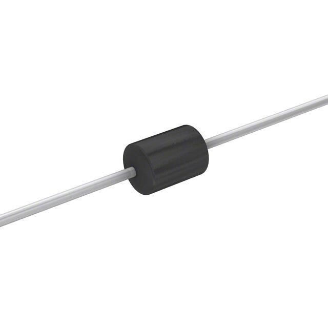

    插件,D2.3xL3mm
    贴片电容(MLCC) 轴向 1nF ±20% 100V X7R
SA051C102MAC 数据手册
Axial Leads/SpinGuard® GENERAL INFORMATION Dimensions: Millimeters (Inches) AVX SA Series Conformally Coated Axial Leaded MLC Temperature Coefficients: C0G (NP0), X7R, X5R, Z5U 10, 50, 100, 200 Volts .445 ± .0127 (.0175" ± .0005") 2.30 (.090") Max. Case Material: Epoxy (Flame Retardant to UL Bulletin 492, Par. 280) Lead Material: Solderable 3.00 (.118") Max. 25.4 (1.00") Min. HOW TO ORDER SA10 5 Conformal Axial Size Voltage SA05 SA10 SA11 SA20 SA30 SA40 E Dielectric Z = 10V 5 = 50V 1 = 100V 2 = 200V A = C0G (NP0) C = X7R D = X5R E = Z5U 104 Z A Capacitance Capacitance Tolerance Failure Rate First two digits are the significant figures of capacitance. Third digit indicates the additional number of zeros. For example, order 100,000 pF as 104. (For values below 10pF use “R” in place of decimal point, e.g., 1R4 = 1.4pF.) C0G (NP0): C = ±.25pF D = ±.5pF F = ±1% G = ±2% J = ±5% K = ±10% X7R: J = ±5% K = ±10% M = ±20% SA105E104ZAA LOT CODE/DATE CODE =810AB TOLERANCE (Z = +80%, -20%) Z 1 0 4 8 A B YEAR (2008) VOLTAGE (5 = 50V) TC (E = Z5U) AVX SA055E104ZAA LOT CODE/DATE CODE =8AB CAP CODE AND MULTIPLIER Please select correct termination style. SA10, 11, 20, 30, 40 SA05 AVX Leads Standard (Solderable) R = RoHS Compliant X5R: K = ±10% M = ±20% MARKING (EXAMPLE) A A = Not Applicable Z5U: M = ±20% Z = +80% -20% SpinGuard marking includes full date code/lot code identification. A first in the industry, this format provides complete traceability to all manufacturing processes involving the basic chip and final assembly. Total Shipment traceability is also provided. R TOLERANCE (Z = +80, -20%) LOT CODE A 5 E 1 0 4 Z A B 8 1 0 YEAR (2008) PACKAGING REQUIREMENTS A = Standard Reels (see Page 49) B = 1000 piece reels (distributors only, tight tolerance only) C = Ammo Pack (see Page 49) D thru J = See Special Lead Configurations (Page 41) M = 26mm tape and reel N = 26mm ammo pack R = RoHS, Standard reels (See page 49) 38 051319 WEEK (10th) CAP CODE AND MULTIPLIER ALPHA-ALPHA, LOT CODE AB=LOT #2 IN WEEK Axial Leads/SpinGuard® C0G (NP0) Dielectric SIZE AND CAPACITANCE SPECIFICATIONS Dimensions: Millimeters (Inches) AVX Style Length (L) Diameter (D) Cap. in. pF 1.0* Lead Diameter SA05 3.00 (.118") 2.30 (.090") .445 (.0175") SA10 4.32 (.170") 2.54 (.100") .445 (.0175") SA11 4.32 (.170") 3.05 (.120") .445 (.0175") SA20 6.60 (.260") 2.54 (.100") .445 (.0175") SA30 7.37 (.290") 3.81 (.150") .445 (.0175") .445 (.0175") Lead Length 25.4 (1.00") 25.4 (1.00") 25.4 (1.00") 25.4 (1.00") 25.4 (1.00") 25.4 (1.00") WVDC 100 50 WVDC 100 50 WVDC 100 50 WVDC 100 50 Typical AVX Part Nos. SA102A1R0DAR  9.1* 10 12 15 18 22 27 33 39 47 56 68 82 100 120 150 180 220 270 330 390 470 560 680 820 1000 1200 1500 1800 2200 2700 3300 3900 4700 5600 6800 8200 10,000 12,000 WVDC 100 50 200 WVDC 100 50 SA40 10.16 (.400") 3.81 (.150")  SA102A9R1DAR SA102A100JAR SA102A120JAR SA102A150JAR SA102A180JAR SA102A220JAR SA102A270JAR SA102A330JAR SA102A390JAR SA102A470JAR SA102A560JAR SA102A680JAR SA102A820JAR SA102A101JAR SA102A121JAR SA101A151JAR SA101A181JAR SA101A221JAR SA101A271JAR SA101A331JAR SA101A391JAR SA101A471JAR SA101A561JAR SA101A681JAR SA101A821JAR SA105A102JAR SA201A122JAR SA201A152JAR SA205A182JAR SA301A222JAR SA301A272JAR SA301A332JAR SA301A392JAR SA305A472JAR SA401A562JAR SA401A682JAR SA405A822JAR SA405A103JAR SA405A123JAR For other tolerances see Part No. Codes For other voltages see Part No. Codes AVX Style = Industry preferred values *“C&D” Tolerance Only 39 Axial Leads/SpinGuard® X7R Dielectric SIZE AND CAPACITANCE SPECIFICATIONS Dimensions: Millimeters (Inches) AVX Style Length (L) Diameter (D) Lead Diameter Lead Length Cap. in. pF 220 270 330 390 470 560 680 820 1000 1200 1500 1800 2200 2700 3300 3900 4700 5600 6800 8200 10,000 12,000 15,000 18,000 22,000 27,000 33,000 39,000 47,000 56,000 68,000 82,000 100,000 120,000 150,000 180,000 220,000 270,000 330,000 470,000 1,000,000 SA05 3.00 (.118") 2.30 (.090") .445 (.0175") SA10 4.32 (.170") 2.54 (.100") .445 (.0175") SA11 4.32 (.170") 3.05 (.120") .445 (.0175") SA20 6.60 (.260") 2.54 (.100") .445 (.0175") SA30 7.37 (.290") 3.81 (.150") .445 (.0175") .445 (.0175") 25.4 (1.00") 25.4 (1.00") 25.4 (1.00") 25.4 (1.00") 25.4 (1.00") 25.4 (1.00") WVDC 100 50 WVDC 100 50 WVDC 100 50 WVDC 100 50 WVDC Typical AVX Part Nos. 200 100 50 SA102C221KAR SA102C271KAR SA102C331KAR SA102C391KAR SA102C471KAR SA101C561KAR SA101C681KAR SA101C821KAR SA101C102KAR SA101C122KAR SA101C152KAR SA101C182KAR SA101C222KAR SA101C272KAR SA101C332KAR SA101C392KAR SA101C472KAR SA101C562KAR SA101C682KAR SA105C822KAR SA105C103KAR SA105C123KAR SA105C153KAR SA105C183KAR SA105C223KAR SA105C273KAR SA105C333KAR SA105C393KAR SA105C473KAR SA115C563KAR SA115C683KAR SA115C823KAR SA115C104KAR SA305C124KAR SA305C154KAR SA305C184KAR SA305C224KAR SA305C274KAR SA305C334KAR SA405C474KAR SA305C105KAR 200 WVDC 100 50 For other tolerances see Part No. Codes For other voltages see Part No. Codes AVX Style = Industry preferred values 40 SA40 10.16 (.400") 3.81 (.150") Axial Leads/SpinGuard® Z5U Dielectric SIZE AND CAPACITANCE SPECIFICATIONS Dimensions: Millimeters (Inches) Cap. in. pF 10,000 15,000 22,000 33,000 47,000 68,000 *100,000 150,000 220,000 330,000 470,000 680,000 820,000 1,000,000 AVX Style Length (L) Diameter (D) Lead Diameter Lead Length SA05 3.00 (.118") 2.30 (.090") .445 (.0175") SA10 4.32 (.170") 2.54 (.100") .445 (.0175") SA11 4.32 (.170") 3.05 (.120") .445 (.0175") SA20 6.60 (.260") 2.54 (.100") .445 (.0175") SA30 7.37 (.290") 3.81 (.150") .445 (.0175") SA40 10.16 (.400") .445 (.0175") 25.4 (1.00") 25.4 (1.00") 25.4 (1.00") 25.4 (1.00") 25.4 (1.00") 25.4 (1.00") Typical AVX Part Nos. SA105E103ZAR SA105E153ZAR SA105E223ZAR SA105E333ZAR SA105E473ZAR SA105E683ZAR SA105E104ZAR SA105E154ZAR SA105E224ZAR SA115E334ZAR SA305E474ZAR SA305E684ZAR SA305E824ZAR SA305E105ZAR WVDC 50 WVDC 100 50 WVDC 100 50 WVDC 100 50 WVDC 100 50 WVDC 100 50 3.81 (.150") For other tolerances see Part No. Codes For other voltages see Part No. Codes AVX Style = Industry preferred values *Preferred Industry Decoupling Capacitor — Insertable on .300” centers. SA105E104ZAA 41 Axial Leads/SpinGuard® X7R Dielectric SIZE AND CAPACITANCE SPECIFICATIONS Dimensions: Millimeters (Inches) Cap. in. μF 1.8 2.7 3.3 4.7 AVX Style Length (L) Diameter (D) Lead Diameter Lead Length SA10 4.32 (.170") 2.54 (.100") .445 (.0175") Typical AVX Part Nos. SA10ZD185KAR SA10ZD275KAR SA10ZD335KAR SA10ZD475KAR WVDC 10 25.4 (1.00") For other tolerances see Part No. Codes For other voltages see Part No. Codes AVX Style = Industry preferred values 42 Axial Leads/SpinGuard®/AA Series Automotive GENERAL INFORMATION Dimensions: Millimeters (Inches) AVX AA Series Electrical Characteristics: AA101C103K4R Capacitance @ 25ºC, 1kHz, 1Vrms 0.0100μF Capacitance Tolerance ±10 % Dissipation Factor @ 25ºC 2.5% Max Rated Voltage 100Vdc Dielectric Withstand Voltage 250Vdc Insulation Resistance @ 25ºC @ Rated Voltage 100000 Mohms Temperature Characteristics: X7R (-55 to + 125ºC ± 15% @ 0Vdc) Lead Material: RoHS Compliant 100% Tin .45 ± 0.05 (.0177" ± .002") 2.54 (.100") Max. 4.32 (0.170") Max. 25.4 (1.000") Min. HOW TO ORDER AA10 1 Component Voltage Size Rating C 103 K 4 R Temperature Characteristic Code Capacitance Code Capacitance Tolerance Code Failure Rate RoHS Compliant 4 = Automotive MARKING (EXAMPLE) PACKAGING REQUIREMENTS SpinGuard marking includes full date code/lot code identification. A first in the industry, this format provides complete traceability to all manufacturing processes involving the basic chip and final assembly. Total Shipment traceability is also provided. Tape and Reel Ø 14”: 7500 pieces AA101C103K4R LOT CODE/DATE CODE =1107AB VOLTAGE (1 = 100V) TEMPERATURE CHARACTERISTICS AVX CAPACITANCE TOLERANCE CODE A 1 C 1 0 3 K A B 11 0 7 YEAR (2011) 081816 WEEK (7th) CAP CODE AND MULTIPLIER ALPHA-ALPHA, LOT CODE AB=LOT #2 IN WEEK 43 Axial Leads/SpinGuard®/AA Series Automotive – C0G (NP0) Dielectric SIZE AND CAPACITANCE SPECIFICATIONS Dimensions: Millimeters (Inches) AVX Style Length (L) Diameter (D) Lead Diameter Lead Length Cap. in. pF 100 120 150 180 220 270 330 390 470 560 680 820 1,000 1,200 1,500 1,800 2,200 2,700 3,300 3,900 4,700 5,600 6,800 8,200 10,000 Typical AVX Part Nos. AA-----A101K4R AA-----A121K4R AA-----A151K4R AA-----A181K4R AA-----A221K4R AA-----A271K4R AA-----A331K4R AA-----A391K4R AA-----A471K4R AA-----A561K4R AA-----A681K4R AA-----A821K4R AA-----A102K4R AA-----A122K4R AA-----A152K4R AA-----A182K4R AA-----A222K4R AA-----A272K4R AA-----A332K4R AA-----A392K4R AA-----A472K4R AA-----A562K4R AA-----A682K4R AA-----A822K4R AA-----A103K4R 200 AA10 4.32 (.170") 2.54 (.100") .445 (.0175") AA30 7.37 (.290") 3.81 (.150") .445 (.0175") 25.4 (1.00") 25.4 (1.00") WVDC 100 50 WVDC 100 50 For other voltage and tolerances contact factory. *Other capacitance values available upon special request. 44 081816 Axial Leads/SpinGuard®/AA Series Automotive – X7R Dielectric SIZE AND CAPACITANCE SPECIFICATIONS Dimensions: Millimeters (Inches) AVX Style Length (L) Diameter (D) Lead Diameter Lead Length Cap. in. pF 220 270 330 390 470 560 680 820 1,000 1,200 1,500 1,800 2,200 2,700 3,300 3,900 ,700 5,600 6,800 8,200 10,000 12,000 15,000 18,000 22,000 27,000 33,000 39,000 47,000 56,000 68,000 82,000 100,000 Typical AVX Part Nos. AA-----C221KAR AA-----C271KAR AA-----C331KAR AA-----C391KAR AA-----C471KAR AA-----C561KAR AA-----C681KAR AA-----C821KAR AA-----C102KAR AA-----C122KAR AA-----C152KAR AA-----C182KAR AA-----C222KAR AA-----C272KAR AA-----C332KAR AA-----C392KAR AA-----C472KAR AA-----C562KAR AA-----C682KAR AA-----C822KAR AA-----C103KAR AA-----C123KAR AA-----C153KAR AA-----C183KAR AA-----C223KAR AA-----C273KAR AA-----C333KAR AA-----C393KAR AA-----C473KAR AA-----C563KAR AA-----C683KAR AA-----C823KAR AA-----C104KAR AA10 4.32 (.170") 2.54 (.100") .445 (.0175") AA30 7.37 (.290") 3.81 (.150") .445 (.0175") 25.4 (1.00") 25.4 (1.00") WVDC 100 50 WVDC 100 50 For other voltage and tolerances contact factory. *Other capacitance values available upon special request. 081816 45 Axial Leads/Ceralam® GENERAL INFORMATION AVX SA Series Molded Axial Leaded MLC Temperature Coefficients: C0G (NP0), X7R, Z5U 50V, 100V and 200V Case Material: Molded Epoxy Lead Material: Solderable HOW TO ORDER MA10 5 Molded Axial Size Voltage MA10 MA20 MA30 MA40 MA50 MA60 5 = 50V 1 = 100V 2 = 200V E Dielectric A = C0G (NP0) C = X7R E = Z5U 104 Z A Capacitance Capacitance Tolerance Failure Rate First two digits are the significant figures of capacitance. Third digit indicates the additional number of zeros. For example, order 100,000 pF as 104. (For values below 10pF use “R” in place of decimal point, e.g., 1R4 = 1.4pF.) C0G (NP0): F = ±1% J = ±5% K = ±10% M = ±20% D = ±0.5pF

物料型号: - 该文档描述的是AVX公司生产的一系列轴向引出电容器,包括SA系列、AA系列和Ceralam®系列。
器件简介: - 这些电容器采用环氧树脂封装,具有阻燃特性,符合UL标准。引脚材料为可焊性材料。
引脚分配: - 文档中提供了不同尺寸的电容器的引脚直径和长度信息,例如SA05系列的引脚直径为.0175英寸,长度为1.00英寸。
参数特性: - 电容器的电容值、电压等级、温度系数(C0G (NP0), X7R, X5R, Z5U)以及电容公差等参数特性在文档中有详细说明。
功能详解: - 文档中解释了电容器的标记方式,包括日期代码/批号代码,提供了完整的可追溯性。
应用信息: - 这些电容器适用于多种应用,包括汽车电子等,其中AA系列特别标注为汽车级电容器。
封装信息: - 文档提供了不同系列电容器的尺寸信息,包括长度、直径和引脚规格。
