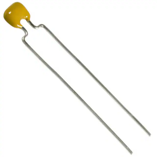

RADIAL LEADS SkyCap®/SR Series GENERAL INFORMATION Dimen sions: Millimeter s (Inche s) SR Series W Max. Conformally Coated Radial Leaded MLC Temperature Coefficients: C0G (NP0), X7R, Z5U H Max. T Max. LL Min. 200, 100, 50 Volts (300V, 400V & 500V also available) See Note L.S. W Max. Styles SR15, SR20, SR30, SR40, SR50 H Max. Styles SR22, SR27 LD Nom. T Max. LL Min. Style SR15 SR20 SR21 SR22 SR27 SR30 SR40 SR50 E A = C0G (NP0) C = X7R E = Z5U 104 M A R Capacitance Capacitance Tolerance Failure Rate Leads First two digits are the significant figures of capacitance. Third digit indicates the additional number of zeros. For example, order 100,000 pF as 104. (For values below 10pF use “R” in place of decimal point, e.g., 1R4 = 1.4pF.) C0G (NP0): C = ±.25pF D = ±.5pF F = ±1% (>50pF only) G = ±2% (>25pF only) J = ±5% K = ±10% MARKING A = Not Applicable R = RoHS TR1 Packaging X7R: J = ±5% K = ±10% M = ±20% Blank: Bulk Packaging 1.0” minimum of lead length T: Trimmed leads .230” ± .030” Bulk packaging TR1: Tape and Reel Packaging AP1: Ammopack packaging Z5U: M = ±20% Z = +80% -20% See packaging specification pages 33-34 PACKAGING REQUIREMENTS Capacitance Code Tolerance Code Voltage Code Temp. Char. Code 14 Style SR21 Drawings are for illustrative purposes only. Actual lead form shape could vary within stated tolerances based on body size. Voltage Temperature 5 = 50V Coefficient 1 = 100V 2 = 200V 9 = 300V 8 = 400V 7 = 500V See Note Note: Coating clean .784 (0.031) min. above seating plane L.S. HOW TO ORDER T Max. LD Nom. LD Nom. L.S. Lead Material: RoHS Compliant, 100% Tin 5 LL Min. 1.52 (0.060) Max. Case Material: Epoxy SR21 W Max. H Max. 3 Digit Date Code SR15, 20, 21, 22, 27, 30 SR40, 50 Lot Code AVX Logo Quantity per Bag 1000 Pieces 500 Pieces Note: SR15, SR20, SR21, SR30, and SR40 available on tape and reel per EIA specifications RS-468. See Pages 33 and 34. The Important Information/Disclaimer is incorporated in the catalog where these specifications came from or available online at www.avx.com/disclaimer/ by reference and should be reviewed in full before placing any order. 081816 – multilayer ceramic leaded capacitors – RADIAL LEADS C0G (NP0) Dielectric SIZE AND CAPACITANCE SPECIFICATIONS EIA Characteristic Dimensions: Millimeters (Inches) Style SR15 SR20 SR21 SR22 SR27 SR30 SR40 “Insertable” SR07 SR29 SR59 N/A N/A SR65 SR75 N/A Width (W) Height (H) 3.81 (.150) 3.81 (.150) 5.08 (.200) 5.08 (.200) 5.08 (.200) 5.08 (.200) 5.08 (.200) 5.08 (.200) 6.604 (.260) 6.35 (.250) 7.62 (.300) 7.62 (.300) 10.16 (.400) 10.16 (.400) 12.70 (.500) 12.70 (.500) Thickness (T) 2.54 (.100) 3.175 (.125) 3.175 (.125) 3.175 (.125) 4.06 (.160) 3.81 (.150) 3.81 (.150) 5.08 (.200) 5.08 (.200) .508 (.020) WVDC 100 50 5.08 (.200) .508 (.020) WVDC 100 50 10.16 (.400) .635 (.025) WVDC 100 50 Lead Spacing (L.S.) Lead Diameter (L.D.) Cap. in.* pF 1.0-9.9 10 15 22 33 39 47 68 100 150 220 330 390 470 680 1000 1500 2200 3900 4700 6800 8200 10,000 15,000 22,000 33,000 39,000 47,000 68,000 100,000 2.54 2.54 5.08 6.35 7.62 (.100) (.100) (.200) (.250) (.300) .508 .508 .508 .508 .508 (.020) (.020) (.020) (.020) (.020) WVDC WVDC WVDC WVDC WVDC Industry Preferred Values in Blue 200 100 50 200 100 50 200 100 50 200 100 50 200 100 50 SR151A1R0DAR SR151A100KAR SR A150KAR SR A220KAR SR A330KAR SR A390KAR SR A470KAR SR A680KAR SR151A101KAR SR A151KAR SR A221KAR SR A331KAR SR A391KAR SR A471KAR SR A681KAR SR211A102KAR SR A152KAR SR A222KAR SR A392KAR SR A472KAR SR A682KAR SR A822KAR SR A103KAR SR A153KAR SR A223KAR SR A333KAR SR A393KAR SR A473KAR SR A683KAR SR A104KAR SR50 For other styles, voltages, tolerances and lead lengths see Part No. Codes or contact factory. *Other capacitance values available upon special request. = Industry preferred values = SR20 only Capacitance ranges available for SR12 and SR07 same as SR15 SR62 and SR59 same as SR21 SR64 and SR65 same as SR30 SR75 same as SR40 SR13 same as SR21 NOTE: For others voltages, tolerances, electrical specifications and NPO typical characteristics, see the KYOCERA AVX Multilayer Ceramic Leaded Capacitors Catalog. The Important Information/Disclaimer is incorporated in the catalog where these specifications came from or available online at www.avx.com/disclaimer/ by reference and should be reviewed in full before placing any order. 081816 – multilayer ceramic leaded capacitors – 15 RADIAL LEADS X7R Dielectric SIZE AND CAPACITANCE SPECIFICATIONS EIA Characteristic Cap. in.* pF 470 1000 1500 2200 3300 4700 6800 10,000 15,000 22,000 33,000 47,000 68,000 100,000 150,000 220,000 330,000 390,000 470,000 1.0 uF 2.2 uF 2.7 uF 4.7 uF 10.0 uF Dimensions: Millimeters (Inches) Style SR15 SR20 SR21 SR22 SR27 SR30 SR40 SR50 “Insertable” SR07 SR29 SR59 N/A N/A SR65 SR75 N/A Width 3.81 5.08 5.08 5.08 6.604 7.62 10.16 12.70 (W) (.150) (.200) (.200) (.200) (.260) (.300) (.400) (.500) Height 3.81 5.08 5.08 5.08 6.35 7.62 10.16 12.70 (H) (.150) (.200) (.200) (.200) (.250) (.300) (.400) (.500) Thickness 2.54 3.175 3.175 3.175 4.06 3.81 3.81 5.08 (T) (.100) (.125) (.125) (.125) (.160) (.150) (.150) (.200) Lead Spacing 2.54 2.54 5.08 6.35 7.62 5.08 5.08 10.16 (L.S.) (.100) (.100) (.200) (.250) (.300) (.200) (.200) (.400) Lead Diameter .508 .508 .508 .508 .508 .508 .508 .635 (L.D.) (.020) (.020) (.020) (.020) (.020) (.020) (.020) (.025) Industry Preferred WVDC WVDC WVDC WVDC WVDC WVDC WVDC WVDC Values in Blue 200 100 50 200 100 50 200 100 50 200 100 50 200 100 50 200 100 50 200 100 50 200 100 50 SR-----C471KAR SR155C102KAR SR-----C152KAR SR-----C222KAR SR-----C332KAR SR-----C472KAR SR-----C682KAR SR215C103KAR SR-----C153KAR SR-----C223KAR SR-----C333KAR SR-----C473KAR SR-----C683KAR SR215C104KAR SR-----C154KAR SR215C224KAR SR-----C334KAR SR-----C394KAR SR305C474KAR SR305C105KAR SR405C225KAR SR505C275KAR SR505C475KAR SR655C106KAR For other styles, voltages, tolerances and lead lengths see Part No. Codes or contact factory. = Industry preferred values = Extended range = Extended range with 0.150” thickness maximum 16 The Important Information/Disclaimer is incorporated in the catalog where these specifications came from or available online at www.avx.com/disclaimer/ by reference and should be reviewed in full before placing any order. 061620 – multilayer ceramic leaded capacitors – RADIAL LEADS Z5U Dielectric SIZE AND CAPACITANCE SPECIFICATIONS EIA Characteristic Cap. in.* pF 10,000 47,000 100,000 150,000 220,000 330,000 470,000 680,000 1.0 μF 1.5 μF 2.2 μF 3.3 μF 4.7 μF Dimensions: Millimeters (Inches) Style SR15 SR20 SR21 SR22 SR27 SR30 SR40 “Insertable” SR07 SR29 SR59 N/A SR65 SR75 N/A Width (W) 3.81 (.150) 5.08 (.200) 5.08 (.200) 5.08 (.200) 7.62 (.300) 10.16 (.400) 12.70 (.500) Height (H) 3.81 (.150) 5.08 (.200) 5.08 (.200) 5.08 (.200) 7.62 (.300) 10.16 (.400) 12.70 (.500) Thickness (T) 2.54 (.100) 3.175 (.125) 3.175 (.125) 3.175 (.125) 3.81 (.150) 3.81 (.150) 5.08 (.200) Lead Spacing (L.S.) 2.54 (.100) 2.54 (.100) 5.08 (.200) 6.35 (.250) 5.08 (.200) 5.08 (.200) 10.16 (.400) .508 (.020) WVDC 100 50 .508 (.020) WVDC 100 50 .508 (.020) WVDC 100 50 .508 (.020) WVDC 100 50 N/A 6.604 (.260) 6.35 (.250) 4.06 (.160) 7.62 (.300) .508 (.020) WVDC 100 50 .508 (.020) WVDC 100 50 .508 (.020) WVDC 100 50 .635 (.025) WVDC 100 50 Lead Diameter (L.D.) Industry Preferred Values in Blue SR155E103ZAR SR-----E473ZAR SR215E104ZAR SR-----E154ZAR SR215E224ZAR SR215E334ZAR SR215E474ZAR SR-----E684ZAR SR-----105ZAR SR30E155ZAR SR30E225ZAR SR30E335ZAR SR30E475ZAR SR50 For other styles, voltages, tolerances and lead lengths see Part No. Codes or contact factory. *Other capacitance values available upon special request. = Industry preferred values = SR20 only Capacitance ranges available for SR12 and SR07 same as SR15 SR62 and SR59 same as SR21 SR64 and SR65 same as SR30 SR75 same as SR40 SR13 same as SR21 500 VOLT SKYCAPS** STYLE* SR29 SR20 SR28 SR59 SR13 SR21 SR30 SR61 SR65 SR40 SR75 SR22 SR27 SR76 NOTE: For others voltages, tolerances, electrical specifications and NPO typical characteristics, see the KYOCERA AVX Multilayer Ceramic Leaded Capacitors Catalog. MAXIMUM CAPACITANCE VALUE C0G (NP0) X7R 900 pF .015 μF 1800 pF .033 μF 900 pF .015 μF 1800 pF .033 μF 7200 pF .12 μF .015 μF .27 μF 1800 pF 1800 pF .015 μF .033 μF .033 μF .27 μF *Consult pages 27 and 28 for style sizes. **Voltage rating based on DWV of 150% of rated voltage. The Important Information/Disclaimer is incorporated in the catalog where these specifications came from or available online at www.avx.com/disclaimer/ by reference and should be reviewed in full before placing any order. 081816 – multilayer ceramic leaded capacitors – 17 RADIAL LEADS SkyCap®/SL Series GENERAL INFORMATION Dimen sions: Millimeter s (Inche s) SL Series W Max. Conformally Coated Radial Leaded MLC H Max. Temperature Coefficients: C0G (NP0), X7R, Z5U T Max. LL Min. 200, 100, 50 Volts (300V, 400V & 500V also available) Styles SL15, SL20, SL30, SL40, SL50 W Max. H Max. Styles SL22, SL27 T Max. LL Min. Style SL21 Drawings are for illustrative purposes only. Actual lead form shape could vary within stated tolerances based on body size. HOW TO ORDER E Voltage Temperature 5 = 50V Coefficient 1 = 100V 2 = 200V 9 = 300V 8 = 400V 7 = 500V See Note Note: Coating clean .784/.031 min. above seating plane L.S. SL15 SL20 SL21 SL22 SL27 SL30 SL40 SL50 See Note L.S. LD Nom. Style T Max. LD Nom. LD Nom. L.S. Lead Material: Solderable Sn/Pb 5 LL Min. 1.52/.060 Max. Case Material: Epoxy SL21 W Max. H Max. A = C0G (NP0) C = X7R E = Z5U 104 M A Capacitance Capacitance Tolerance Failure Rate First two digits are the significant figures of capacitance. Third digit indicates the additional number of zeros. For example, order 100,000 pF as 104. (For values below 10pF use “R” in place of decimal point, e.g., 1R4 = 1.4pF.) C0G (NP0): C = ±.25pF D = ±.5pF F = ±1% (>50pF only) G = ±2% (>25pF only) J = ±5% K = ±10% A = Not Applicable X7R: J = ±5% K = ±10% M = ±20% B TR1 Leads Packaging B = Leads Sn/Pb Blank: Bulk Packaging 1.0” minimum (Tin lead product) of lead length T: Trimmed leads .230” ± .030” Bulk packaging TR1: Tape and Reel Packaging AP1: Ammopack packaging Z5U: M = ±20% Z = +80% -20% See packaging specification pages 33-34 Not RoHS Compliant MARKING Capacitance Code Tolerance Code Voltage Code Temp. Char. Code 18 PACKAGING REQUIREMENTS 3 Digit Date Code SL15, 20, 21, 22, 27, 30 SL40, 50 Lot Code Quantity per Bag 1000 Pieces 500 Pieces Note: SL15, SL20, SL21, SL30, and SL40 available on tape and reel per EIA specifications RS-468. See Pages 33 and 34. AVX Logo The Important Information/Disclaimer is incorporated in the catalog where these specifications came from or available online at www.avx.com/disclaimer/ by reference and should be reviewed in full before placing any order. 081816 – multilayer ceramic leaded capacitors – RADIAL LEADS C0G (NP0) Dielectric SIZE AND CAPACITANCE SPECIFICATIONS EIA Characteristic Cap. in.* pF 1.0-9.9 10 15 22 33 39 47 68 100 150 220 330 390 470 680 1000 1500 2200 3900 4700 6800 8200 10,000 15,000 22,000 33,000 39,000 47,000 68,000 100,000 Dimensions: Millimeters (Inches) Style SL15 SL20 SL21 SL22 SL27 SL30 SL40 “Insertable” SL07 SL29 SL59 N/A N/A SL65 SL75 N/A Width (W) Height (H) 3.81 (.150) 3.81 (.150) 5.08 (.200) 5.08 (.200) 5.08 (.200) 5.08 (.200) 5.08 (.200) 5.08 (.200) 6.604 (.260) 6.35 (.250) 7.62 (.300) 7.62 (.300) 10.16 (.400) 10.16 (.400) 12.70 (.500) 12.70 (.500) Thickness (T) 2.54 (.100) 3.175 (.125) 3.175 (.125) 3.175 (.125) 4.06 (.160) 3.81 (.150) 3.81 (.150) 5.08 (.200) 5.08 (.200) .508 (.020) WVDC 100 50 5.08 (.200) .508 (.020) WVDC 100 50 10.16 (.400) .635 (.025) WVDC 100 50 Lead Spacing 2.54 2.54 5.08 6.35 7.62 (L.S.) (.100) (.100) (.200) (.250) (.300) Lead Diameter .508 .508 .508 .508 .508 (L.D.) (.020) (.020) (.020) (.020) (.020) WVDC WVDC WVDC WVDC WVDC Industry Preferred Values in Blue 200 100 50 200 100 50 200 100 50 200 100 50 200 100 50 SL151A1R0DAB SL151A100KAB SI-----A150KAB SL-----A220KAB SL-----A330KAB SL-----A390KAB SL-----A470KAB SL-----A680KAB SL151A101KAB SI-----A151KAB SI-----A221KAB SI-----A331KAB SI-----A391KAB SI-----A471KAB SI-----A681KAB SL211A102KAB SI-----A152KAB SI-----A222KAB SI-----A392KAB SI-----A472KAB SI-----A682KAB SI-----A822KAB SL305A103KAB SI-----A153KAB SI-----A223KAB SI-----A333KAB SI-----A393KAB SI-----A473KAB SI-----A683KAB SI-----A104KAB SL50 For other styles, voltages, tolerances and lead lengths see Part No. Codes or contact factory. *Other capacitance values available upon special request. = Industry preferred values = SL20 only NOTE:  Capacitance ranges available for SL12 same as SL15 SL62 same as SL21 SL64 same as SL30 SL89 same as SL21 The Important Information/Disclaimer is incorporated in the catalog where these specifications came from or available online at www.avx.com/disclaimer/ by reference and should be reviewed in full before placing any order. 081816 – multilayer ceramic leaded capacitors – 19 RADIAL LEADS X7R Dielectric SIZE AND CAPACITANCE SPECIFICATIONS EIA Characteristic Cap. in.* pF 470 1000 1500 2200 3300 4700 6800 10,000 15,000 22,000 33,000 47,000 68,000 100,000 150,000 220,000 330,000 390,000 470,000 1.0 uF 2.2 uF 2.7 uF 4.7 uF 10.0 uF Dimensions: Millimeters (Inches) Style SL15 SL20 SL21 SL22 SL27 SL30 SL40 “Insertable” SL07 SL29 SL59 N/A N/A SL65 SL75 N/A Width (W) Height (H) 3.81 (.150) 3.81 (.150) 5.08 (.200) 5.08 (.200) 5.08 (.200) 5.08 (.200) 5.08 (.200) 5.08 (.200) 6.604 (.260) 6.35 (.250) 7.62 (.300) 7.62 (.300) 10.16 (.400) 10.16 (.400) 12.70 (.500) 12.70 (.500) Thickness (T) 2.54 (.100) 3.175 (.125) 3.175 (.125) 3.175 (.125) 4.06 (.160) 3.81 (.150) 3.81 (.150) 5.08 (.200) 5.08 (.200) .508 (.020) WVDC 200 100 50 10.16 (.400) .635 (.025) WVDC 200 100 50 Lead Spacing 2.54 2.54 5.08 6.35 7.62 5.08 (L.S.) (.100) (.100) (.200) (.250) (.300) (.200) Lead Diameter .508 .508 .508 .508 .508 .508 (L.D.) (.020) (.020) (.020) (.020) (.020) (.020) WVDC WVDC WVDC WVDC WVDC WVDC Industry Preferred Values in Blue 200 100 50 200 100 50 200 100 50 200 100 200 100 200 100 50 SL-----C471KAB SL155C102KAB SL-----C152KAB SL-----C222KAB SL-----C332KAB SL-----C472KAB SL-----C682KAB SL215C103KAB SL-----C153KAB SL-----C223KAB SL-----C333KAB SL-----C473KAB SL-----C683KAB SL215C104KAB SL-----C154KAB SL215C224KAB SL-----C334KAB SL-----C394KAB SL305C474KAB SL305C105KAB SL405C225KAB SL505C275KAB SL505C475KAB SL655C106KAB For other styles, voltages, tolerances and lead lengths see Part No. Codes or contact factory. = Industry preferred values = Extended range = Extended range with 0.150” thickness maximum 20 The Important Information/Disclaimer is incorporated in the catalog where these specifications came from or available online at www.avx.com/disclaimer/ by reference and should be reviewed in full before placing any order. 081816 – multilayer ceramic leaded capacitors – SL50 RADIAL LEADS Z5U Dielectric SIZE AND CAPACITANCE SPECIFICATIONS EIA Characteristic Cap. in.* pF 10,000 47,000 100,000 150,000 220,000 330,000 470,000 680,000 1.0 μF 1.5 μF 2.2 μF 3.3 μF 4.7 μF Dimensions: Millimeters (Inches) Style SL15 SL20 SL21 SL22 SL27 SL30 SL40 “Insertable” SL07 SL29 SL59 N/A SL65 SL75 N/A Width (W) 3.81 (.150) 5.08 (.200) 5.08 (.200) 5.08 (.200) 7.62 (.300) 10.16 (.400) 12.70 (.500) Height (H) 3.81 (.150) 5.08 (.200) 5.08 (.200) 5.08 (.200) 7.62 (.300) 10.16 (.400) 12.70 (.500) Thickness (T) 2.54 (.100) 3.175 (.125) 3.175 (.125) 3.175 (.125) 3.81 (.150) 3.81 (.150) 5.08 (.200) Lead Spacing (L.S.) 2.54 (.100) 2.54 (.100) 5.08 (.200) 6.35 (.250) 5.08 (.200) 5.08 (.200) 10.16 (.400) .508 (.020) WVDC 100 50 .508 (.020) WVDC 100 50 .508 (.020) WVDC 100 50 .508 (.020) WVDC 100 50 N/A 6.604 (.260) 6.35 (.250) 4.06 (.160) 7.62 (.300) .508 (.020) WVDC 100 50 .508 (.020) WVDC 100 50 .508 (.020) WVDC 100 50 .635 (.025) WVDC 100 50 Lead Diameter (L.D.) Industry Preferred Values in Blue SL155E103ZAB SI-----E473ZAB SL215E104ZAB SL-----E154ZAB SL215E224ZAB SL215E334ZAB SL215E474ZAB SL-----E684ZAB SL-----105ZAB SL30E155ZAB SL30E225ZAB SL30E335ZAB SL30E475ZAB SL50 For other styles, voltages, tolerances and lead lengths see Part No. Codes or contact factory. *Other capacitance values available upon special request. = Industry preferred values = SL20 only 500 VOLT SKYCAPS** MAXIMUM CAPACITANCE VALUE STYLE* SL29 SL20 SL28 SL59 SL13 SL21 SL30 SL61 SL65 SL40 SL75 SL22 SL27 SL76 SL50 C0G (NP0) 900 pF 1800 pF X7R .015 μF .033 μF 900 pF .015 μF 1800 pF .033 μF 7200 pF .12 μF .015 μF .27 μF 1800 pF 1800 pF .015 μF .036 μF .033 μF .033 μF .27 μF .59 μF *Consult pages 27 and 28 for style sizes. **Voltage rating based on DWV of 150% of rated voltage. The Important Information/Disclaimer is incorporated in the catalog where these specifications came from or available online at www.avx.com/disclaimer/ by reference and should be reviewed in full before placing any order. 081816 – multilayer ceramic leaded capacitors – 21

1. 物料型号:文档中提到了多个型号,包括但不限于SL15、SL20、SL21、SL22、SL27、SL30、SL40、SL50等,这些型号可能代表不同的电容器规格。
2. 器件简介:文档描述的是多层陶瓷有引线电容器,具有不同的温度系数(C0G (NP0), X7R, Z5U)和电压等级(50V、100V、200V、300V、400V、500V)。
3. 引脚分配:文档中提到了不同的引脚间距(Lead Spacing, L.S.)和引脚直径(Lead Diameter, L.D.),这些参数对于电路设计和组件安装非常重要。
4. 参数特性:包括电容值、电压等级、温度系数和电容公差。电容值的表示方法为前两位数字是电容的主要数字,第三位表示额外的零的数量。例如,100,000 pF表示为104。
5. 功能详解:文档提供了电容器的详细规格,包括尺寸、电容值、电压等级和公差等。例如,C0G (NP0)电介质的电容公差为±.25pF、±.5pF、±1%(仅大于50pF)等。
6. 应用信息:文档中没有直接提供应用信息,但可以推断这些电容器适用于需要稳定电容性能的电路中,如在特定温度范围内工作的电子设备。
7. 封装信息:文档提供了不同型号的封装尺寸,包括宽度(Width, W)、高度(Height, H)和厚度(Thickness, T)。
