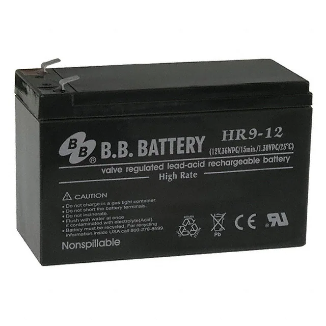

    BATT VRLA 12V 36W/CELL
HR9-12-T2 数据手册
VRLA Rechargeable Battery Measures HR9-12 FEATURES Technology Values Innovation APPLICATION Maintenance free(no water topping-up required). No free acid(Non-spillable battery). Low self-discharge rate, lower than 3% capacity loss per month. Can be used in any orientation(excluding used inverted). The battery is designed for high rate usage. Absorbent Glass Mat technology for efficient gas recombination. The power density at 5 min~15min discharging rate is 30% higher than BP series. UPS Fishing Lights Power Packs Laboratory Equipment Fishing Lights Booster Toy-Cars SPECIFICATIONS Nominal Voltage Nominal Capacity Approx. Weight 12 V 8.0Ah @ 10 hour rate F.V.(1.75V/cell) Terminals Internal Resistance Max. Discharge Current Max. Charge Current T2 (Faston Tab 250) , T1 and B0 are optional 15m (Fully Charged ) 120 A (5 sec.) 2.4 A 2750g(6.06lbs.) Charge 0oC~40oC(32oF~104oF) Discharge -20oC~50oC(-4oF~122oF) Storage. -20oC~40oC(-4oF~104oF) Standard: ABS( UL 94-HB) HR9-12 Optional: Flame Retardant ABS(UL 94-V0) HR9-12FR Operating Temperature Range Container Material DIMENSION(mm/inch) OUTER DIMENSIONS IEC 61056-1 JIS C 8702-1 GB/T 19639.1 TERMINAL TYPE Length Total Height 100±2.0 (3.94±0.08) Constant power discharge characteristics at 25 oC/77 oF F.V. (V/cell) Discharge Time 1.80V 1.70V 1.60V 1.50V 1.40V 1.30V 1.80V 1.70V 1.60V 1.50V 1.40V 1.30V 5.5( 0.22) 1.4(0.06) [M5 BOLT & NUT] Unit: W 10 Min 15 Min 20 Min 30 Min 40 Min 50 Min 60 Min 120 Min 369.0 252.0 182.5 155.7 118.4 90.0 75.2 66.2 36.5 441.0 281.3 198.5 164.9 123.3 93.4 77.6 67.7 37.2 472.5 295.9 207.5 171.0 126.0 95.6 79.2 68.9 37.8 486.0 301.5 212.0 173.7 127.6 96.8 80.1 69.5 38.0 495.0 305.6 214.4 175.3 128.5 97.4 80.8 70.0 38.1 499.5 308.3 216.0 176.4 129.2 97.9 81.2 70.2 38.2 o Constant current discharge characteristics at 25 C/77 F F.V. (V/cell) 7.95(0.31) 10(0.39) 5 Min o Discharge Time 3.4(0.13) Terminal B0 12(0.47) 6.35(0.25) Terminal T2 4.8(0.19) Container Height 94±1.5 (3.70±0.06) 100 2(3.94 0.08) (2.56±0.06) 65 1.5(2.56 0.06) 0.8(0.03) 4.75(0.19) 3.2(0.13) 151 1.5(5.94 0.06) 94 1.5(3.70 0.06) 65±1.5 Terminal T1 0.8(0.03) 6.35(0.25) 151±1.5 (5.94±0.06) Width W Unit: A 5 Min 10 Min 15 Min 20 Min 30 Min 40 Min 50 Min 60 Min 120 Min 32.95 22.11 15.79 13.35 10.03 7.57 6.29 5.52 3.04 40.09 24.68 17.17 14.14 10.45 7.86 6.49 5.64 3.10 42.95 25.96 17.95 14.67 10.68 8.04 6.63 5.74 3.15 44.18 26.45 18.34 14.90 10.81 8.14 6.70 5.79 3.17 45.00 26.81 18.55 15.03 10.89 8.19 6.76 5.83 3.18 45.41 27.04 18.69 15.13 10.95 8.23 6.79 5.85 3.18 All data and artworks shall be changed without prior notice, BB reserves the right to explain and update the information contained hereinto. A/2 REV. Jun. 2013 Powered by B.B. Battery Co., Ltd.
