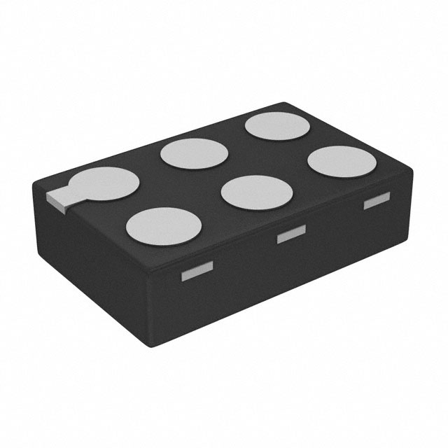

    74LVC1G126 是一款单路、同相缓冲器/总线驱动器,具有三态输出。当向输出使能 (OE) 引脚施加低电平时,输出将进入高阻抗状态
74LVC1G126FX4-7 数据手册
74LVC1G126 SINGLE BUFFER GATE WITH 3-STATE OUTPUT Description Pin Assignments The 74LVC1G126 is a single, non-inverting buffer/bus driver with a 3-state output. The output enters a high-impedance state when a LOW level is applied to the output enable (OE) pin. The device is designed for operation with a power supply range of 1.65V to 5.5V. The inputs are tolerant to 5.5V allowing this device to be used in a mixed-voltage environment. The device is fully specified for partial power down applications using IOFF. The IOFF circuitry disables the OE 1 5 Vcc • • Inputs Accept Up to 5.5V ESD Protection Tested per JESD 22  Exceeds 200V Machine Model (A115)  Exceeds 2000V Human Body Model (A114)  Exceeds 1000V Charged Device Model (C101) Latch-Up Exceeds 100mA per JESD 78, Class I Range of Package Options Direct Interface with TTL Levels Totally Lead-Free & Fully RoHS Compliant (Notes 1 & 2) Halogen and Antimony Free. “Green” Device (Note 3) 4 Y SOT553 4 Y SOT25 / SOT353 ( Top View ) Wide Supply Voltage Range from 1.65V to 5.5V ±24mA Output Drive at 3.3V CMOS Low Power Consumption IOFF Supports Partial-Power-Down Mode Operation 5 Vcc GND 3 GND 3 Features • • • • OE 1 A 2 A 2 output preventing damaging current backflow when the device is powered down. • • • • • ( Top View ) ( Top View ) OE 1 8 Vcc A 2 5 NC GND 3 4 Y X2-DFN1410-6 ( Bottom View ) GND 3 4Y A2 5 NC OE 1 6 Vcc X2-DFN1409-6 Chip Scale Alternative (Top View ) OE A GND 1 6 2 5 3 4 Vcc NC Y X1-DFN1010-6 (Type B) (Top View ) Vcc NC 3 4 Y X2-DFN1010-6 OE A GND 1 6 2 5 (Top View) 5 Vcc OE 1 3 GND A 2 4 Y X2-DFN0808-4 Packages not to scale Applications • • • • Notes: Voltage Level Shifting General Purpose Logic Power Down Signal Isolation Wide Array of Products Such as.  PCs, Networking, Notebooks, Netbooks, PDAs  Tablet Computers, E-Readers  Computer Peripherals, Hard Drives, CD/DVD ROM  TV, DVD, DVR, Set-Top Box  Cell Phones, Personal Navigation/GPS  MP3 Players, Cameras, Video Recorders 1. No purposely added lead. Fully EU Directive 2002/95/EC (RoHS), 2011/65/EU (RoHS 2) & 2015/863/EU (RoHS 3) compliant. 2. See https://www.diodes.com/quality/lead-free/ for more information about Diodes Incorporated’s definitions of Halogen- and Antimony-free, "Green" and Lead-free. 3. Halogen- and Antimony-free "Green” products are defined as those which contain
