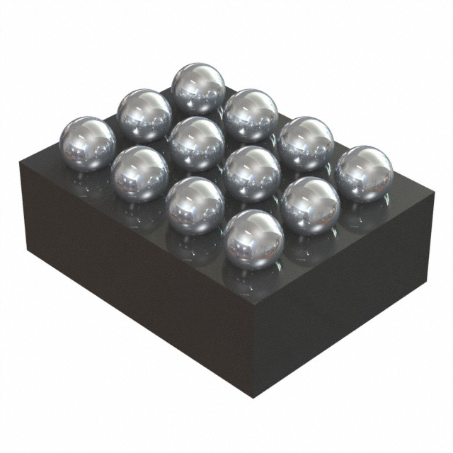

    双路1.5A电流源相机闪光灯LED驱动器
AL3644TTCH12-7 数据手册
AL3644 NEW PRODUCT DUAL 1.5A CURRENT SOURCE CAMERA FLASH LED DRIVER Description Features The AL3644 is a dual LED flash driver that provides a high level of adjustability within a small solution size. The AL3644 utilizes a 2MHz or 4MHz fixed frequency synchronous boost converter to provide power to the dual 1.5A constant current LED sources. The dual 128 level current sources provide the flexibility to adjust the current ratios between LED1 and LED2. An adaptive regulation method ensures the current sources remain in regulation and maximizes efficiency.       Features of the AL3644 are controlled via an I2C-compatible interface. These features include: hardware flash and hardware torch pins (STROBE and TORCH/TEMP), a TX interrupt, and an NTC thermistor monitor. The device offers independently programmable currents in each output leg to drive the LEDs in a Flash or Movie Mode (Torch) condition. The 2MHz or 4MHz switching frequency options, overvoltage protection (OVP), and adjustable current limit allow for the use of tiny, low-profile inductors and (10µF) ceramic capacitors. The device operates over a –40°C to +85°C ambient temperature range.          Dual Independent 1.5A LED Current Source Programmability Accurate and Programmable LED Current Range from 1.4mA to 1.5A Torch Currents up to 360mA (AL3644TT) Flash Timeout Values up to 1.6 seconds (AL3644TT) Optimized Flash LED Current During Low Battery Conditions (Input Voltage Flash Monitor) > 85% Efficiency in Torch Mode (at 100mA) and Flash Mode (at 1A to 1.5A) Grounded Cathode LED Operation for Improved Thermal Management Small Solution Size: < 16mm2 Hardware Strobe Enable (STROBE) Synchronization Input for RF Power Amplifier Pulse Events (TX) Hardware Torch Enable (TORCH/TEMP) Remote NTC Monitoring (TORCH/TEMP) 400kHz I2C-Compatible Interface – AL3644 (I2C Address = 0x63) Totally Lead-Free & Fully RoHS Compliant (Notes 1 & 2) Halogen and Antimony Free. “Green” Device (Note 3) Applications  Notes: Camera Phone White LED Flash 1. No purposely added lead. Fully EU Directive 2002/95/EC (RoHS), 2011/65/EU (RoHS 2) & 2015/863/EU (RoHS 3) compliant. 2. See https://www.diodes.com/quality/lead-free/ for more information about Diodes Incorporated’s definitions of Halogen- and Antimony-free, "Green" and Lead-free. 3. Halogen- and Antimony-free "Green” products are defined as those which contain
