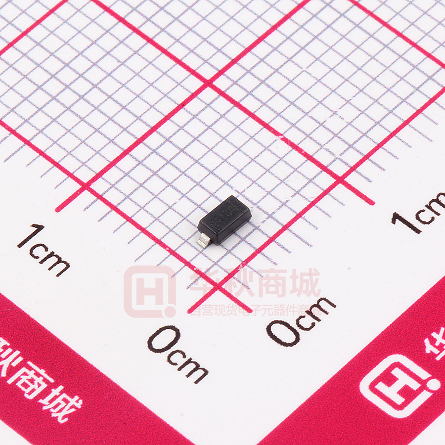

AL5809-20S1-7 数据手册
AL5809 60V Two Terminal Constant Current LED Driver PowerDI Pin Assignments The AL5809 is a constant current linear LED driver and it provides a cost-effective two pin solution. It has an excellent temperature stability of 20ppm/°C and the current accuracy ±5% regulated over a wide voltage and temperature range. The AL5809 comes in various fixed output current versions removing the need for external current setting resistors creating a simple solution for the linear driving of LEDs. It supports both the high-side and low-side driving of LED chains. 1 IN AL5809 XX Y W X Description The AL5809 turns on when the voltage between IN and OUT swings OUT 2 from 2.5V up to 60V enabling it drive long LED chains. The floating ground, 60V Voltage rating between Input and Output pins designed to withstand the high peak voltage incurred in offline applications. The AL5809 is available in either thermally robust package PowerDI123 or SOD-123 package. Features  Applications 2.5V to 60V Operating Voltage Between Two Terminals  Offline LED Lamps  Robust Power Package Up to 1.2W for PowerDI -123  LED Power Supplies  -40°C to +125°C Temperature Range  White Goods  ±5% LED Current Tolerance Over-Temperature  LED Signs  Instrumentation Illumination ®  15mA, 20mA, 25mA, 30mA, 40mA, 50mA, 60mA, 90mA, 100mA, 120mA, and 150mA Available in PowerDI123 Package  15mA, 20mA, 25mA, 30mA, 40mA and 50mA available in SOD123 Package, Other Current Options Available by Request  Constant Current with Low Temperature Drift and High Power Supply Rejection Ratio   Totally Lead-Free & Fully RoHS Compliant (Notes 1 & 2) Halogen and Antimony Free. “Green” Device (Note 3) Notes: 1. No purposely added lead. Fully EU Directive 2002/95/EC (RoHS) & 2011/65/EU (RoHS 2) compliant. 2. See http://www.diodes.com/quality/lead_free.html for more information about Diodes Incorporated’s definitions of Halogen- and Antimony-free, "Green" and Lead-free. 3. Halogen- and Antimony-free "Green” products are defined as those which contain
