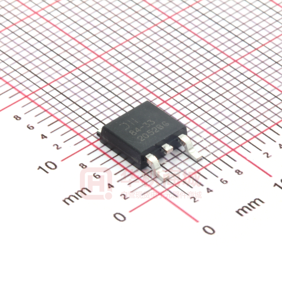

    TO-252(DPAK)
    线性稳压器/LDO 6.58 x 5.57mm 3.3V 3Pins 5A Fixed TO252-3L
