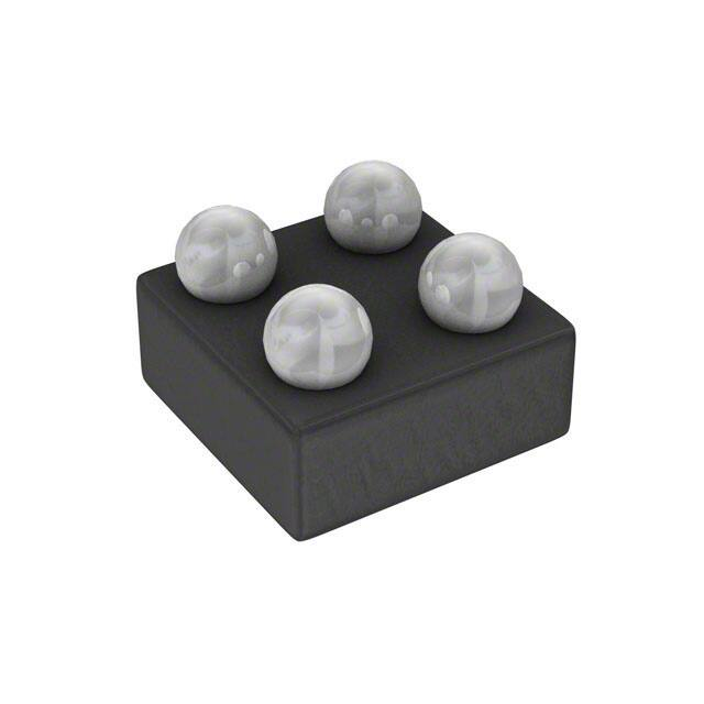

AP22916 1.3V-5.5V, 2A, 60mΩ ULTRA-LOW LEAKAGE LOAD SWITCH Description Pin Assignments The AP22916 is a small, low leakage, single P-channel power MOSFET designed for low-power consumption, load-switching applications. The power MOSFET has a typical RDS(ON) of 60mΩ at 5V, allowing increased X1-WLB0808-4 load current handling capacity with a low forward voltage drop. Multiple voltages correspond to different time options to support various system load conditions. The trigger of the load switch ON pin can be controlled to be enabled or disabled by an external low voltage digital signal for sequence control application. Smart pull down feature is built in the ON pin. Once the enable voltage is higher than VIH, it will disconnect to avoid power loss. VIN and VOUT are isolated during OFF state with the TRCB (Truly Reverse Current Blocking) feature. Top View The AP22916 load switch is designed to operate from 1.3V to 5.5V, making it ideal for 1.3V, 1.8V, 2.5V, 3.6V, and 5V systems. The typical quiescent supply current is only 0.5µA. Bottom View The AP22916 is available in the wafer level chip scale 4-pin, X1WLB0808-4 0.78mm x 0.78mm x 0.455mm, 0.4mm pitch package. The device is characterized for operation over a temperature range of –40°C to +85°C. Features • • • • • Wide Input Voltage Range: 1.3V to 5.5V Low On-Resistance  150mΩ Typical @1.3V  100mΩ Typical @1.8V  70mΩ Typical @3.6V  60mΩ Typical @5.0V Continuous Current Capability up to 2A Truly Reverse Current Blocking (TRCB) Discharging Resistor on VOUT When Disabled • • Ultra Low Quiescent Current 0.5µA Active-high Control Pin  Minimum 1.0V VIH of ON • ESD Protection:  Human Body Model: 2kV  Charged Device Model: 1kV Package:  X1-WLB0808-4 with Backside Laminate • Applications • • • • • • Mobile Devices and Smart Phones Portable Media Devices Wearable Devices Advanced Notebook, UMPC, and MID Portable Medical Devices GPS and Navigation Equipment Part Comparison Table Version Timing Output Discharge Enable AP22916B Fast Yes Active High AP22916C Slow Yes Active High  • • • 0.78mm x 0.78mm, 0.4mm Ball Pitch Totally Lead-Free & Fully RoHS Compliant (Notes 1 & 2) Halogen- and Antimony-Free. “Green” Device (Notes 3) For automotive applications requiring specific change control (i.e. parts qualified to AEC-Q100/101/200, PPAP capable, and manufactured in IATF 16949 certified facilities), please contact us or your local Diodes representative. https://www.diodes.com/quality/product-definitions/ Notes: 1. No purposely added lead. Fully EU Directive 2002/95/EC (RoHS), 2011/65/EU (RoHS 2) & 2015/863/EU (RoHS 3) compliant. 2. See https://www.diodes.com/quality/lead-free/ for more information about Diodes Incorporated’s definitions of Halogen- and Antimony-free, "Green" and Lead-free. 3. Halogen- and Antimony-free "Green” products are defined as those which contain

物料型号:AP22916 - 该型号是一个小尺寸、低漏电的单P沟道功率MOSFET,设计用于低功耗、负载开关应用。
器件简介: - AP22916具有在5V下的典型导通电阻RDS(ON)为60mΩ,允许在低正向电压降下增加负载电流处理能力。 - 该器件具有多种电压响应时间选项,以支持不同系统负载条件。 - 负载开关的ON引脚可以通过外部低电压数字信号控制启用或禁用,适用于序列控制应用。 - ON引脚内置智能下拉功能,一旦使能电压高于VIH,将断开以避免功耗。 - 在关闭状态下,VIN和VOUT之间通过TRCB(真正反向电流阻断)功能实现隔离。
引脚分配: - A(引脚1):电压输出引脚,连接到P沟道MOSFET的漏极,通过0.1uF或1uF电容接地。 - B(引脚2):电压输入引脚,连接到P沟道MOSFET的源极,通过1uF电容接地。 - C(引脚3):地。 - D(引脚4):使能输入。
参数特性: - 宽输入电压范围:1.3V至5.5V。 - 低导通电阻:在不同电压下分别为150mΩ、100mΩ、70mΩ、60mΩ。 - 连续电流能力高达2A。 - 真正的反向电流阻断(TRCB)。 - 禁用时VOUT上的放电电阻。 - 超低静态电流:0.5µA。 - 活动高控制引脚,ON引脚的最小VIH为1.0V。 - ESD保护:人体模型2kV,带电设备模型1kV。 - 封装:X1-WLB0808-4,背面覆膜,0.78mm x 0.78mm,0.4mm球间距,完全无铅且符合RoHS标准。
功能详解: - AP22916设计用于1.3V至5.5V的系统,典型静态供电电流仅为0.5µA。 - 具有快速和慢速两种版本的输出放电功能。 - 封装信息:X1WLB0808-4 0.78mm x 0.78mm x 0.455mm,0.4mm引脚间距。 - 操作温度范围:-40°C至+85°C。
应用信息: - 移动设备和智能手机、便携式媒体设备、可穿戴设备、高级笔记本电脑、UMPC和MID、便携式医疗设备、GPS和导航设备。
封装信息: - 封装类型:X1-WLB0808-4,尺寸为0.78mm x 0.78mm x 0.455mm,0.4mm球间距。 - 封装特点:完全无铅,符合RoHS标准,无卤素和锑,绿色设备。
