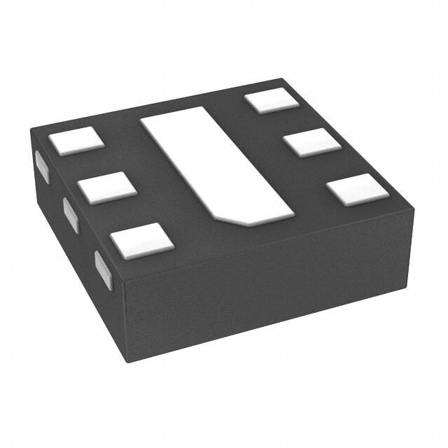

AP7346D-3318FS6-7 数据手册
AP7346 DUAL HIGH ACCURACY CURRENT LIMIT LDO WITH ENABLE Pin Assignments The AP7346 is a dual high accuracy current limit ,low dropout regulator with high output voltage accuracy, low RDS(ON), high PSRR, EN2 6 5 4 1 2 3 GND With its low power consumption and line and load transient response, the AP7346 is well suited for low power handheld communication equipment. VIN Each of regulators includes a voltage reference, error amplifier, current limit circuit and an enable input to turn on/ off output. With the integrated resistor network, fixed output voltage versions can be delivered. VOUT2 NEW PRODUCT low output noise and low quiescent current. This regulator is based on a CMOS process. EN1 Top View VOUT1 Description X2-DFN1212-6 The AP7346 is packaged in X2-DFN1212-6 package and allows for smallest footprint and dense PCB layout. Applications Features  Low VIN and Wide VIN Range: 1.7V to 5.25V   High Accuracy Current Limit: 157mA+/- 25mA VOUT Accuracy: ±1%       Ripple Rejection: 75dB at 1kHz Low Output Noise: 60µVrms from 10Hz to 100kHz Quiescent Current as Low as 35µA VOUT Fixed 1.2V to 3.6V Totally Lead-Free & and Fully RoHS Compliant (Notes 1 & 2) Halogen and Antimony Free, Green Device (Note 3) Notes:         Fingerprint Modular Smart Phone/PAD RF Supply Cameras Portable Video Portable Media Player Wireless Adapter Wireless Communication 1. No purposely added lead. Fully EU Directive 2002/95/EC (RoHS) & 2011/65/EU (RoHS 2) compliant. 2. See http://www.diodes.com/quality/lead_free.html for more information about Diodes Incorporated’s definitions of Halogen- and Antimony-free, "Green" and Lead-free. 3. Halogen- and Antimony-free "Green” products are defined as those which contain
