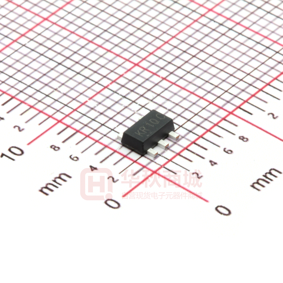

AP7361C-Y5-13 数据手册
AP7361C 1A LOW DROPOUT ADJUSTABLE AND FIXED-MODE REGULATOR WITH ENABLE Description Pin Assignments (Top View) The AP7361C is a 1A, adjustable and fixed output voltage, ultra-low dropout linear regulator with enable. The device includes pass element, error amplifier, band-gap reference, current limit and thermal shutdown circuitry. The device is turned on when EN pin is set to logic high level. OUT 1 (Top View) 8 IN 7 NC ADJ/NC 3 6 NC GND 4 5 EN NC 2 NEW INFORMATION PRODUCT ADVANCE 1 5 OUT GND 2 GND The characteristics of the low dropout voltage and low quiescent current make it suitable for low-to-medium power applications; for example, laptop computers, audio and video applications, and battery-powered devices. The typical quiescent current is approximately 60µA. Built-in current-limit and thermal-shutdown functions prevent IC from damage in fault conditions. EN GND ADJ/NC 3 U-DFN3030-8 (Type E) 4 IN SOT89-5 (Top View) (Top View) The AP7361C is available in U-DFN3030-8 (Type E), SOT89-5, SOT223, TO252 (DPAK) and SO-8EP packages. 3 OUT 3 IN Features 2 GND 2 OUT 1 IN 1 GND • • • • • • • • • • • • • • • • • • • Wide Input Voltage Range: 2.2V to 6.0V Output Voltage Accuracy: ±1% Very Low Dropout Voltage (3.3V): 360mV at 1A Typical Low Quiescent Current (IQ): 60µA Typical Adjustable Output Voltage Range: 0.8V to 5.0V Fixed Output Options: 1.0V, 1.2V, 1.5V, 1.8V, 2.5V, 2.8V and 3.3V High PSRR: 75dB @ 1kHz Current Limit: 1.5A Fold-Back Short Circuit Protection: 400mA Thermal Shutdown Protection Stable with MLCC, E-Cap, Tan-Cap or Solid Capacitor ≥ 2.2µF Ambient Temperature Range: -40°C to +85°C Available in “Green” Molding Compound (No Br, Sb) Moisture Sensitivity: Level 1 Per J-STD-020 Terminals:  SOT89-5/ SOT223/ SO-8EP/ TO252: Finish - Matte Tin Plated Leads, Solderable per MIL-STD202, Method 208  U-DFN3030-8: Finish - NiPdAu over Copper Leads, Solderable per MILSTD-202, Method 208 Weight:  U-DFN3030-8: 0.017 grams (Approximate)  SOT89-5: 0.059 grams (Approximate)  SOT223: 0.113 grams (Approximate)  SO-8EP: 0.081 grams (Approximate)  TO252: 0.33 grams (Approximate) Diodes automotive grade parts (Q-suffix) are suitable for automotive applications requiring specific change control; these parts are AEC-Q100/101/200 qualified, PPAP capable, and manufactured in IATF16949:2016 certified facilities. https://www.diodes.com/quality/product-definitions/ Totally Lead-Free & Fully RoHS Compliant (Notes 1 & 2) Halogen- and Antimony-Free. “Green” Device (Note 3) Notes: SOT223 SOT223R (Top View) (Top View) OUT 1 8 IN OUT 1 8 IN EN 2 7 NC ADJ/NC 2 7 NC NC 3 6 NC GND 3 6 NC GND 4 5 NC NC 4 5 EN SO-8EP SO-8EPR (Top View) (Top View) 3 OUT 3 IN 2 GND 2 OUT 1 IN 1 GND TO252 (DPAK) TO252 (DPAK) R Applications • • • LCD-TV, Monitor Set-Top-Box Home Electrical Appliances 1. No purposely added lead. Fully EU Directive 2002/95/EC (RoHS), 2011/65/EU (RoHS 2) & 2015/863/EU (RoHS 3) compliant. 2. See https://www.diodes.com/quality/lead-free/ for more information about Diodes Incorporated’s definitions of Halogen- and Antimony-free, "Green" and Lead-free. 3. Halogen- and Antimony-free "Green” products are defined as those which contain
AP7361C-Y5-13
物料型号:AP7361C
器件简介:AP7361C是一款1A输出电流、可调输出电压和固定输出电压的超低 dropout 线性稳压器,具有使能控制。它包括通过元件、误差放大器、带隙基准源、电流限制和热关断电路。当EN引脚设置为逻辑高电平时,设备被打开。
引脚分配:AP7361C有8个引脚,包括输入引脚(IN)、输出引脚(OUT)、使能引脚(EN)、地引脚(GND)和调整/无连接引脚(ADJ/NC)。
参数特性: - 宽输入电压范围:2.2V至6.0V - 输出电压精度:±1% - 非常低的dropout电压:在3.3V时典型值为360mV - 低静态电流(IQ):典型值约60µA - 可调输出电压范围:0.8V至5.0V - 固定输出选项:1.0V、1.2V、1.5V、1.8V、2.5V、2.8V和3.3V - 高PSRR:在1kHz时为75dB - 电流限制:1.5A - 短路保护:fold-back型,400mA - 热关断保护
功能详解:AP7361C具有超快启动时间,低静态电流,以及在无负载条件下的稳定性。它还具备过流保护和短路保护功能,以防止因过热而损坏。
应用信息:适用于LCD电视、监视器、机顶盒和家用电器等。
封装信息:AP7361C提供多种封装选项,包括U-DFN3030-8(Type E)、SOT89-5、SOT223、TO252 (DPAK)和SO-8EP。
