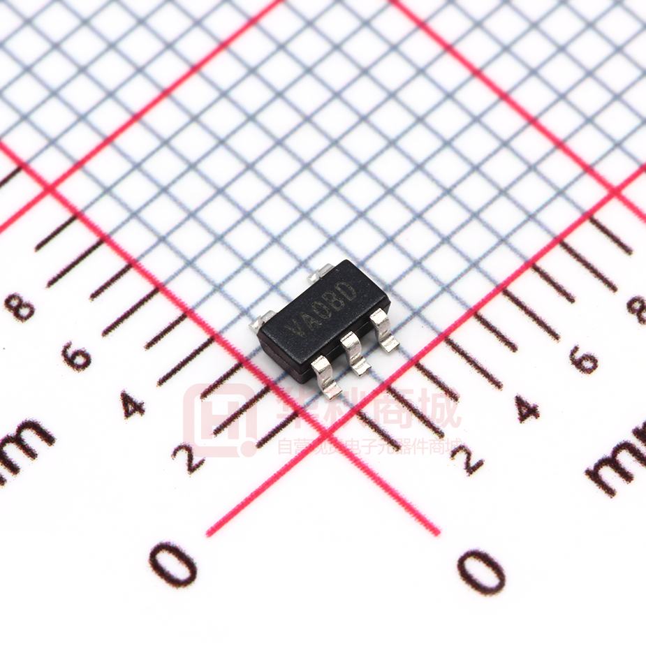

    输出类型:可调 输出极性:正 最大输入电压:6V 输出电压:0.8~5V 输出电流:600mA
AP7365-WG-7 数据手册
NOT RECOMMENDED FOR NEW DESIGN USE AP7366 AP7365 600mA, LOW QUIESCENT CURRENT FAST TRANSIENT LOW DROPOUT LINEAR REGULATOR Description Pin Assignments The AP7365 is a 600mA, adjustable and fixed output voltage, low dropout linear regulator. This device includes pass element, error amplifier, band-gap, current limit and thermal shutdown circuitry. The device is turned on when EN pin is set to logic high level. (Top View ) (Top View) IN 1 This device is available with adjustable output from 0.8V to 5.0V, and fixed version with 0.8V, 1.0V, 1.2V, 1.5V, 1.8V, 2.0V, 2.5V, 2.8V, 3.0V, 3.3V and 3.9V outputs. Please contact your local sales office for other voltage options. The AP7365 is available in SOT25, SOT89, SOT223, and UDFN2020-6 packages. EN 3 600mA Low Dropout Regulator with EN Very Low IQ: 35µA               Wide Input Voltage Range: 2V to 6V Wide Adjustable Output: 0.8V to 5.0V Fixed Output Options: 0.8V to 3.9V (0.1V Step Size Possible) High PSRR: 65dB at 1kHz Fast Start-Up Time: 200µs Stable with Low ESR, 1µF Ceramic Output Capacitor Excellent Load/Line Transient Response Low Dropout: 300mV at 600mA Current Limit and Short Circuit Protection Thermal Shutdown Protection Ambient Temperature Range: -40°C to +85°C Totally Lead-Free & Fully RoHS Compliant (Notes 1 & 2) Halogen and Antimony Free. “Green” Device (Note 3) For automotive applications requiring specific change control (i.e. parts qualified to AEC-Q100/101/200, PPAP capable, and manufactured in IATF 16949 certified facilities), please contact us or your local Diodes representative. https://www.diodes.com/quality/product-definitions/ (W Package) (W Package) (Top View) (Top View) EN 1 6 NC EN 1 GND 2 5 NC GND 2 IN 3 6 ADJ 5 NC IN 3 4 OUT 4 OUT U-DFN2020-6 (Fixed Output) U-DFN2020-6 (ADJ Output) (SN Package) (SN Package) (Top View) (Top View) 3 IN 3 OUT 2 GND (TAB) 2 IN (TAB) 1 OUT 1 GND SOT89 (Fixed output) SOT89 (Fixed output) (Y Package) (YR Package) (Top View) (Top View) 3 IN 3 OUT 2 GND (TAB) 2 IN (TAB) 1 OUT 1 GND SOT223 (Fixed output) SOT223 (Fixed output) (E Package) Servers and Notebook Computers Low and Medium Power Applications FPGA and DSP Core or I/O Power Consumer Electronics Notes: 4 ADJ SOT25 (ADJ Output) Applications     EN 3 4 NC SOT25 (Fixed Output) Features   5 OUT GND 2 GND 2 The characteristics of low dropout voltage and low quiescent current make it suitable for low power applications such as battery powered devices. The typical quiescent current is approximately 35μA. Built-in current-limit and thermal-shutdown functions prevent IC from damage in fault conditions. IN 1 5 OUT (ER Package) (Top View) 3 IN 2 OUT (TAB) 1 GND SOT223 (Fixed output) (EV Package) 1. No purposely added lead. Fully EU Directive 2002/95/EC (RoHS), 2011/65/EU (RoHS 2) & 2015/863/EU (RoHS 3) compliant. 2. See https://www.diodes.com/quality/lead-free/ for more information about Diodes Incorporated’s definitions of Halogen- and Antimony-free, "Green" and Lead-free. 3. Halogen- and Antimony-free "Green” products are defined as those which contain

物料型号:AP7365
器件简介:AP7365是一款最大输出电流为600mA、低静态电流的低压差线性稳压器。它包括通流元件、误差放大器、带隙、电流限制和热关断电路。当EN引脚设置为逻辑高电平时,设备被激活。
引脚分配:AP7365有多种封装,包括SOT25、SOT89、SOT223和UDFN2020-6。每种封装的引脚功能略有不同,但通常包括输入引脚(IN)、地引脚(GND)、使能输入引脚(EN)、输出反馈引脚(ADJ)和输出引脚(OUT)。
参数特性:典型静态电流约为35μA,宽输入电压范围2V至6V,可调输出从0.8V至5.0V,固定输出选项从0.8V至3.9V,高电源抑制比(PSRR)65dB@1kHz,快速启动时间200μs,稳定的低ESR 1μF陶瓷输出电容器,优秀的负载/线路瞬态响应,低压差300mV@600mA,过流保护和短路保护,热关断保护。
功能详解:AP7365具有超低的静态电流,适合电池供电设备等低功耗应用。内置的电流限制和热关断功能可以在故障条件下保护IC。该设备还具有快速的瞬态响应,可以在毫秒级时间内从0到600mA提供稳定的电压供应。
应用信息:适用于服务器、笔记本电脑、低中功率应用、FPGA和DSP核心或I/O电源、消费电子等。
封装信息:AP7365提供SOT25、SOT89、SOT223和UDFN2020-6封装选项。
