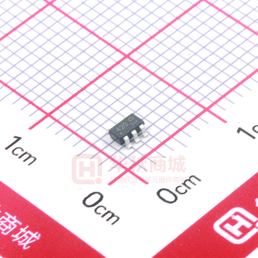

BCR420UW6 / BCR421UW6 LINEAR LED CONSTANT CURRENT REGULATOR IN SOT26 Description Features The BCR420U and BCR421U monolithically integrate transistors, diodes and resistors to function as a Constant Current Regulator (CCR) for linear LED driving. The device regulates with a preset 10mA nominal that can be adjusted with an external resistor up to 350mA. It is designed for driving LEDs in strings and will reduce current at increasing temperatures to self-protect. Operating as a series linear CCR for LED string current control, it can be used in multiple applications, as long as the maximum supply voltage to the device is < 40V.  With the low-side control, the BCR421U has an Enable (EN) pin which can be pulse-width modulated (PWM) up to 25kHz by a microcontroller for LED dimming.     With no need for additional external components, this CCR is fully integrated into an SOT26 (SC74R) minimizing PCB area and component count.    LED Constant Current Regulator using NPN Emitter-Follower with Emitter Resistor to Current Limit IOUT – 10mA ± 10% Constant Current (Preset) IOUT up to 350mA Adjustable with an External Resistor   (BCR421U) VOUT – 40V Supply Voltage PD up to 1W in SOT26 (SC74R)   Low-Side Control Enabling PWM Input < 25kHz (BCR421U) Negative Temperature Coefficient (NTC) Reduces IOUT with Increasing Temperature Parallel Devices to Increase Regulated Current Totally Lead-Free & Fully RoHS Compliant (Notes 1 & 2) Halogen and Antimony Free. “Green” Device (Note 3) Qualified to AEC-Q101 Standards for High Reliability Automotive-Compliant Parts are Available Under Separate Datasheet (BCR420UW6Q/BCR421UW6Q) Mechanical Data Applications   Constant Current Regulation (CCR) in:     Automotive Interior Lighting Emergency Lighting Signage, Advertising, Decorative and Architectural Lighting Retail Lighting in Fridges, Freezer Cases and Vending Machines SOT26 (SC74R) EN    Case: SOT26 (SC74R) Case Material: Molded Plastic. ―Green‖ Molding Compound. UL Flammability Rating 94V-0 Moisture Sensitivity: Level 1 per J-STD-020 Terminals: Finish - Matte Tin Plated Leads. Solderable per MILSTD-202, Method 208 Weight: 0.018 grams (Approximate) OUT BCR420U BCR421U Rext R EXT (Optional) (Optional) EN REXT Pin Name OUT OUT OUT EN OUT GND REXT GND GND Top View Internal Device Schematic Pin Function Regulated Output Current Enable for Biasing Transistor External Resistor for Adjusting Output Current Power Ground Top View Pin-Out Ordering Information (Note 4) Product BCR420UW6-7 BCR421UW6-7 Notes: Compliance AEC-Q101 AEC-Q101 Marking 420 421 Reel Size (inches) 7 7 Tape Width (mm) 8 8 Quantity per Reel 3,000 3,000 1. No purposely added lead. Fully EU Directive 2002/95/EC (RoHS) & 2011/65/EU (RoHS 2) compliant. 2. See http://www.diodes.com/quality/lead_free.html for more information about Diodes Incorporated’s definitions of Halogen- and Antimony-free, "Green" and Lead-free. 3. Halogen- and Antimony-free "Green" products are defined as those which contain 2.0V; VEN = 24V VOUT > 2.0V; VEN = 3.3V VOUT > 2.0V; VEN = 24V VOUT > 2.0V; VEN = 3.3V June 2017 © Diodes Incorporated BCR420UW6 / BCR421UW6 1.4 800 1.2 700 Rth(JA) ( C/W) Max Power Dissipation (W) Typical Thermal Characteristics BCR420/1U (@TA = +25°C, unless otherwise specified.) 50mm * 50mm 1oz Cu 1.0 o 0.8 0.6 0.4 25mm * 25mm 1oz Cu 0.2 600 500 400 300 200 100 0.0 0 50 100 0 150 100 1000 2 o Temperature ( C) Copper Area (mm ) Derating Curve Rth(JA) VS Cu Area 75 50 Maximum Power (W) o T amb=25 C 100 o Thermal Resistance ( C/W) 125 50mm * 50mm 1oz Cu D=0.5 Single Pulse D=0.2 D=0.05 25 D=0.1 0 100μ µ 1m 10m 100m 1 10 100 o T amb=25 C 10 1 100μµ 1m 1k Pulse Width (s) 1 10 100 1k Pulse Power Dissipation 150 o 125 100 Maximum Power (W) o 10m 100m Pulse Width (s) Transient Thermal Impedance Thermal Resistance ( C/W) Single Pulse 50mm * 50mm 1oz Cu T amb=25 C 25mm * 25mm 1oz Cu D=0.5 75 50 D=0.2 Single Pulse D=0.05 25 D=0.1 0 µ 100μ 1m 10m 100m 1 10 100 1k Single Pulse o 10 T amb=25 C 25mm * 25mm 1oz Cu 1 100μµ 1m 10m 100m 1 10 100 Pulse Width (s) Pulse Width (s) Transient Thermal Impedance Pulse Power Dissipation BCR420UW6 / BCR421UW6 Document number: DS37667 Rev. 5 - 2 4 of 13 www.diodes.com 1k June 2017 © Diodes Incorporated BCR420UW6 / BCR421UW6 Typical Electrical Characteristics BCR421U (Cont.) (@TA = +25°C, unless otherwise specified.) 0.20 0.20 VEN=3.3V REXT=6.2 REXT=8.2 VOUT=5.4V 0.15 REXT=10 IOUT (A) IOUT (A) 0.16 0.12 0.08 REXT= 30 REXT=15 VOUT=1.4V 0.10 0.05 0.04 VEN=3.3V REXT=open 0.000 1 2 3 4 5 6 7 8 9 10 11 12 0.00 1 10 100 REXT () VOUT (V) REXT () vs IOUT VOUT vs IOUT 0.18 o -40 C 0.06 0.16 o -40 C 0.05 IOUT (A) IOUT (A) 0.14 0.12 o 25 C 0.10 o 85 C VEN=3.3V 0.08 0.06 0.04 o 25 C o 85 C VEN=3.3V 0.03 REXT=20 REXT=6.2 0 2 4 6 8 10 0.02 0 12 VOUT (V) 2 4 6 VOUT (V) 8 10 12 VOUT vs IOUT VOUT vs IOUT 0.15 0.02 REXT=8.2 VOUT=2V REXT=6.2 REXT=10 o IOUT (A) IOUT (A) -40 C 0.01 o 85 C 0.00 0 2 4 BCR420UW6 / BCR421UW6 Document number: DS37667 Rev. 5 - 2 6 REXT=30 REXT= 60 0.05 REXT= open VEN=3.3V o 25 C 0.10 REXT=open 8 10 12 0.00 0 1 2 3 VOUT (V) VEN (V) VOUT vs IOUT VEN vs IOUT 5 of 13 www.diodes.com 4 5 June 2017 © Diodes Incorporated BCR420UW6 / BCR421UW6 Typical Electrical Characteristics BCR421U (Cont.) (@TA = +25°C, unless otherwise specified.) 0.015 3.0m o -40 C IOUT=0A o o 85 C REXT=open 2.0m IOUT (A) IEN (mA) 2.5m 1.5m 1.0m o 25 C o -40 C 25 C 0.010 o 85 C 0.005 VOUT=2V 500.0μ µ REXT=open 0.0 0 1 2 3 4 0.000 0 5 1 VEN (V) 2 3 4 5 VEN (V) VENvs IOUT VENvs IEN 0.06 0.20 o -40 C o -40 C 0.05 IOUT (A) IOUT (A) 0.15 0.04 o o 85 C 25 C 0.03 o 25 C o 0.10 85 C 0.02 0.01 0.00 VOUT=2V 0.05 VOUT=2V REXT=6.2 REXT= 20 0 1 2 3 4 5 0.00 0 VENvs IOUT BCR420UW6 / BCR421UW6 Document number: DS37667 Rev. 5 - 2 1 2 3 4 5 VEN (V) VEN (V) VEN vs IOUT 6 of 13 www.diodes.com June 2017 © Diodes Incorporated BCR420UW6 / BCR421UW6 Typical Electrical Characteristics BCR420U (Cont.) (@TA = +25°C, unless otherwise specified.) 0.20 0.20 REXT=6.2 0.16 REXT=8.2 VOUT = 5.4V 0.15 REXT=10 IOUT (A) IOUT (A) VEN=24V 0.12 0.08 REXT=15 REXT= 30 0.04 0.10 0.05 VEN=24V REXT=open 0.00 0 1 2 3 4 5 6 7 VOUT (V) 8 VOUT=1.4V 0.00 1 9 10 11 12 10 100 REXT () REXT ()vs IOUT VOUT vs IOUT 0.18 o -40 C 0.06 0.16 o -40 C IOUT (A) IOUT (A) 0.14 0.12 o 25 C 0.10 0.04 o 25 C 85 C VEN=24V VEN=24V 0.03 REXT=20 REXT=6.2 0 2 4 6 8 10 0.02 0 12 VOUT (V) 2 4 6 VOUT (V) 8 10 12 VOUT vs IOUT VOUT vs IOUT 0.15 0.02 VOUT=2V IOUT (A) IOUT (A) 0.01 o o 85 C 4 6 0.10 REXT=open 0.05 REXT=open 8 10 12 0.00 0 5 10 15 20 25 30 VEN (V) VOUT vs IOUT Document number: DS37667 Rev. 5 - 2 REXT=30 REXT=60 VOUT (V) BCR420UW6 / BCR421UW6 Rext=10 VEN=24V 25 C 2 REXT=8 REXT=20 o -40 C 0.00 0 o 85 C o 0.08 0.06 0.05 VEN vs IOUT 7 of 13 www.diodes.com June 2017 © Diodes Incorporated BCR420UW6 / BCR421UW6 Typical Electrical Characteristics BCR420U (Cont.) (@TA = +25°C, unless otherwise specified.) 0.015 3.0m o -40 C IOUT=0A o 2.0m o 85 C REXT=open 1.5m 1.0m o 25 C 25 C 0.010 IOUT (A) IEN (mA) 2.5m o 85 C 0.005 o -40 C VOUT=2V 500.0μ µ 0.0 0 REXT=open 5 10 15 20 25 30 35 40 0.000 0 5 10 VEN (V) 15 20 25 30 VEN (V) VENvs IEN VENvs IOUT 0.06 0.20 o -40 C o -40 C 0.05 o 85 C 25 C 0.03 0.02 VOUT=2V 0.01 0.00 0 o 25 C o IOUT (A) IOUT (A) 0.15 0.04 0.10 o 85 C VOUT=2V 0.05 REXT=6.2 REXT=20 5 10 15 20 VEN (V) 25 30 0.00 0 Document number: DS37667 Rev. 5 - 2 10 15 VEN (V) 20 25 30 VENvs IOUT VENvs IOUT BCR420UW6 / BCR421UW6 5 8 of 13 www.diodes.com June 2017 © Diodes Incorporated BCR420UW6 / BCR421UW6 Application Information The BCR420/1 are designed for driving low current LEDs with typical LED currents of 10mA to 350mA. They provide a cost-effective way for driving low current LEDs compared with more complex switching regulator solutions. Furthermore, they reduce the PCB board area of the solution as there is no need for external components like inductors, capacitors and switching diodes. Figure 1 shows a typical application circuit diagram for driving an LED or string of LEDs. The device comes with an internal resistor (RINT) of typically 95Ω, which in the absence of an external resistor, sets an LED current of 10mA (typical) from a VEN = 3.3V and VOUT = 1.4V for BCR421; or VEN = 24V and VOUT = 1.4V for BCR420. LED current can be increased to a desired value by choosing an appropriate external resistor, REXT. REXT (Optional) The REXT vs IOUT graphs should be used to select the appropriate resistor. Choosing a low tolerance REXT will improve the overall accuracy of the current sense formed by the parallel connection of RINT and REXT. REXT (Optional) Figure 1 Typical Application Circuit for Linear Mode Current Sink LED Driver Two or more BCR420/1s can be connected in parallel to construct higher current LED strings as shown in Figure 2. Consideration of the expected linear mode power dissipation must be factored into the design, with respect to the BCR420/1’s thermal resistance. The maximum voltage across the device can be calculated by taking the maximum supply voltage and subtracting the voltage across the LED string. VOUT = VS – VLED PD = (VOUT × ILED) + (VEN × IEN) REXT (Optional) REXT (Optional) As the output current of BCR420/1 increases, it is necessary to provide appropriate thermal relief to the device. The power dissipation supported by the device is dependent upon the PCB board material, the copper area and the ambient temperature. The maximum dissipation the device can handle is given by: PD = ( TJ(MAX) - TA) / RθJA Figure 2 Application Circuit for Increasing LED Current BCR420UW6 / BCR421UW6 Document number: DS37667 Rev. 5 - 2 Refer to the thermal characteristic graphs on Page 4 for selecting the appropriate PCB copper area. 9 of 13 www.diodes.com June 2017 © Diodes Incorporated BCR420UW6 / BCR421UW6 Application Information (Cont.) PWM dimming can be achieved by driving the EN pin. Dimming is achieved by turning the LEDs ON and OFF for a portion of a single cycle. The PWM signal can be provided by a micro-controller or analog circuitry; typical circuit is shown in Figure 3. Figure 4 is a typical response of LED current vs. PWM duty cycle on the EN pin. PWM up to 25kHz with duty cycle of 0.5% (dimming range 200:1). This is above the audio band minimizing audible power supply noise. REXT (Optional) Figure 3 Application Circuits for LED Driver with PWM Dimming Functionality using BCR421U Figure 4 Typical LED Current Response vs. PWM Duty Cycle for 25kHz PWM Frequency (Dimming Range 200:1) BCR420UW6 / BCR421UW6 Document number: DS37667 Rev. 5 - 2 10 of 13 www.diodes.com June 2017 © Diodes Incorporated BCR420UW6 / BCR421UW6 Application Information (Cont.) To remove the potential of incorrect connection of the power supply damaging the lamp’s LEDs, many systems use some form of reverse polarity protection. One solution for reverse input polarity protection is to simply use a diode with a low VF in line with the driver/LED combination. The low VF increases the available voltage to the LED stack and dissipates less power. A circuit example is presented in Figure 5 which protects the light engine although it will not function until the problem is diagnosed and corrected. An SDM10U45LP (0.1A/45V) is shown, providing exceptionally low VF for its package size of 1mm x 0.6mm. Other reverse voltage ratings are available from Diodes Incorporated’s website such as the SBR02U100LP (0.2A/100V) or SBR0220LP (0.2A/20V). While automotive applications commonly use this method for reverse battery protection, an alternative approach shown in Figure 6, provides reverse polarity protection and corrects the reversed polarity, allowing the light engine to function. REXT (Optional) The BAS40BRW incorporates four low VF Schottky diodes in a single package, reducing the power dissipated and maximizes the voltage across the LED stack. Figure 7 shows an example configuration for 350mA operation using BCR421U. In such higher current configurations adequate enable current is provided by increasing the enable voltage. Figure 5 Application Circuit for LED Driver with Reverse Polarity Protection REXT (Optional) Figure 6 Application Circuit for LED Driver with Assured Operation Regardless Of Polarity BCR420UW6 / BCR421UW6 Document number: DS37667 Rev. 5 - 2 REXT = 2.1 Figure 7 Example for 350mA Operation using BCR421U 11 of 13 www.diodes.com June 2017 © Diodes Incorporated BCR420UW6 / BCR421UW6 Package Outline Dimensions Please see http://www.diodes.com/package-outlines.html for the latest version. SOT26 (SC74R) D E1 SOT26 (SC74R) Dim Min Max Typ A1 0.013 0.10 0.05 A2 1.00 1.30 1.10 A3 0.70 0.80 0.75 b 0.35 0.50 0.38 c 0.10 0.20 0.15 D 2.90 3.10 3.00 e 0.95 e1 1.90 E 2.70 3.00 2.80 E1 1.50 1.70 1.60 L 0.35 0.55 0.40 a 8° a1 7° All Dimensions in mm E b a1 e1 A2 A3 A1 Seating Plane e L c a Suggested Pad Layout Please see http://www.diodes.com/package-outlines.html for the latest version. SOT26 (SC74R) C1 Y1 G Dimensions Value (in mm) C 2.40 C1 0.95 G 1.60 X 0.55 Y 0.80 Y1 3.20 C Y X BCR420UW6 / BCR421UW6 Document number: DS37667 Rev. 5 - 2 12 of 13 www.diodes.com June 2017 © Diodes Incorporated BCR420UW6 / BCR421UW6 IMPORTANT NOTICE DIODES INCORPORATED MAKES NO WARRANTY OF ANY KIND, EXPRESS OR IMPLIED, WITH REGARDS TO THIS DOCUMENT, INCLUDING, BUT NOT LIMITED TO, THE IMPLIED WARRANTIES OF MERCHANTABILITY AND FITNESS FOR A PARTICULAR PURPOSE (AND THEIR EQUIVALENTS UNDER THE LAWS OF ANY JURISDICTION). Diodes Incorporated and its subsidiaries reserve the right to make modifications, enhancements, improvements, corrections or other changes without further notice to this document and any product described herein. Diodes Incorporated does not assume any liability arising out of the application or use of this document or any product described herein; neither does Diodes Incorporated convey any license under its patent or trademark rights, nor the rights of others. Any Customer or user of this document or products described herein in such applications shall assume all risks of such use and will agree to hold Diodes Incorporated and all the companies whose products are represented on Diodes Incorporated website, harmless against all damages. Diodes Incorporated does not warrant or accept any liability whatsoever in respect of any products purchased through unauthorized sales channel. Should Customers purchase or use Diodes Incorporated products for any unintended or unauthorized application, Customers shall indemnify and hold Diodes Incorporated and its representatives harmless against all claims, damages, expenses, and attorney fees arising out of, directly or indirectly, any claim of personal injury or death associated with such unintended or unauthorized application. Products described herein may be covered by one or more United States, international or foreign patents pending. Product names and markings noted herein may also be covered by one or more United States, international or foreign trademarks. This document is written in English but may be translated into multiple languages for reference. Only the English version of this document is the final and determinative format released by Diodes Incorporated. LIFE SUPPORT Diodes Incorporated products are specifically not authorized for use as critical components in life support devices or systems without the express written approval of the Chief Executive Officer of Diodes Incorporated. As used herein: A. Life support devices or systems are devices or systems which: 1. are intended to implant into the body, or 2. support or sustain life and whose failure to perform when properly used in accordance with instructions for use provided in the labeling can be reasonably expected to result in significant injury to the user. B. A critical component is any component in a life support device or system whose failure to perform can be reasonably expected to cause the failure of the life support device or to affect its safety or effectiveness. Customers represent that they have all necessary expertise in the safety and regulatory ramifications of their life support devices or systems, and acknowledge and agree that they are solely responsible for all legal, regulatory and safety-related requirements concerning their products and any use of Diodes Incorporated products in such safety-critical, life support devices or systems, notwithstanding any devices- or systems-related information or support that may be provided by Diodes Incorporated. Further, Customers must fully indemnify Diodes Incorporated and its representatives against any damages arising out of the use of Diodes Incorporated products in such safety-critical, life support devices or systems. Copyright © 2017, Diodes Incorporated www.diodes.com BCR420UW6 / BCR421UW6 Document number: DS37667 Rev. 5 - 2 13 of 13 www.diodes.com June 2017 © Diodes Incorporated
