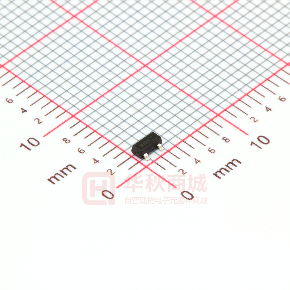

    N沟道 VDS=20V VGS=±8V ID=4.2A P=780mW
DMG3414U-7 数据手册
DMG3414U N-CHANNEL ENHANCEMENT MODE MOSFET Features Mechanical Data     Low On-Resistance 25mΩ @ VGS = 4.5V 29mΩ @ VGS = 2.5V 37mΩ @ VGS = 1.8V          Low Input Capacitance Fast Switching Speed Low Input/Output Leakage Totally Lead-Free & Fully RoHS Compliant (Notes 1 & 2) Halogen and Antimony Free. “Green” Device (Note 3) Qualified to AEC-Q101 Standards for High Reliability An Automotive-Compliant Part is Available Under Separate Datasheet (DMG3414UQ)     Case: SOT23 Case Material: Molded Plastic, “Green” Molding Compound. UL Flammability Classification Rating 94V-0 Moisture Sensitivity: Level 1 per J-STD-020D Terminals: Finish – Matte Tin Annealed over Copper Leadframe. Solderable per MIL-STD-202, Method 208 e3 Terminals Connections: See Diagram Below Weight: 0.008 grams (Approximate) Drain D Gate Internal Schematic Top View S G Source Top View Ordering Information (Note 4) Part Number DMG3414U-7 Notes: Case SOT23 Packaging 3,000/Tape & Reel 1. No purposely added lead. Fully EU Directive 2002/95/EC (RoHS) & 2011/65/EU (RoHS 2) compliant. 2. See https://www.diodes.com/quality/lead-free/ for more information about Diodes Incorporated’s definitions of Halogen- and Antimony-free, "Green" and Lead-free. 3. Halogen- and Antimony-free "Green” products are defined as those which contain
DMG3414U-7
物料型号:DMG3414U
器件简介: - 这是一款N沟道增强型MOSFET,具有低导通电阻、低输入电容和快速开关速度等特点。
引脚分配: - 根据文档中的“Top View Internal Schematic”图,引脚从左到右依次为:源极(S)、栅极(G)、漏极(D)。
参数特性: - 导通电阻(RDS(ON))在不同VGS下的典型值分别为:4.5V时为25mΩ,2.5V时为29mΩ,1.8V时为37mΩ。 - 输入电容(CISS)典型值为829.9pF。 - 栅极阈值电压(VGS(TH))典型值为0.9V。
功能详解: - 该MOSFET设计用于需要高可靠性的应用,如汽车电子,并符合AEC-Q101标准。 - 完全符合RoHS指令,无铅且不含卤素和锑,是一种“绿色”设备。
应用信息: - 适用于需要低导通电阻和快速开关的应用,如DC-DC转换器、电机驱动等。
封装信息: - 封装类型为SOT23,具体尺寸和布局请参考Diodes公司网站提供的封装轮廓图。
