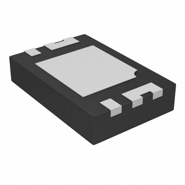

DMN2028UFU DUAL N-CHANNEL ENHANCEMENT MODE MOSFET Features V(BR)DSS RDS(ON) Max 20V 20.2m @ VGS = 4.5V 23.5m @ VGS = 2.5V        ID TA = +25°C 7.5A 7.0A Description This new generation MOSFET is designed to minimize the on-state resistance (RDS(ON)) and yet maintain superior switching performance, making it ideal for high efficiency power management applications. Applications    Low On-Resistance Low Gate Threshold Voltage Low Input Capacitance Fast Switching Speed ESD Protected Gate Totally Lead-Free & Fully RoHS Compliant (Notes 1 & 2) Halogen and Antimony Free. “Green” Device (Note 3) Mechanical Data      Power Management Functions Battery Pack Load Switch Case: U-DFN2030-6 Case Material: Molded Plastic, “Green” Molding Compound. UL Flammability Classification Rating 94V-0 Moisture Sensitivity: Level 1 per J-STD-020 Terminal Connections: See Diagram Below Weight: 0.012 grams (Approximate) D2 D1 U-DFN2030-6 G2 G1 Gate Protection Diode ESD PROTECTED Top View Bottom View S1 Gate Protection Diode S2 Equivalent Circuit Ordering Information (Note 4) Part Number DMN2028UFU-7 DMN2028UFU-13 Notes: Case U-DFN2030-6 U-DFN2030-6 Packaging 3000 / Tape & Reel 10000 / Tape & Reel 1. No purposely added lead. Fully EU Directive 2002/95/EC (RoHS) & 2011/65/EU (RoHS 2) compliant. 2. See http://www.diodes.com/quality/lead_free.html for more information about Diodes Incorporated’s definitions of Halogen- and Antimony-free, "Green" and Lead-free. 3. Halogen- and Antimony-free "Green” products are defined as those which contain

物料型号:DMN2028UFU 器件简介:新一代MOSFET,旨在降低导通电阻(RDS(ON))同时保持优越的开关性能,适合高效率电源管理应用。
引脚分配:S1为源极,D1/D2为漏极,G1/G2为栅极。
参数特性:导通电压(V(BR)DSS)为20V,最大导通电阻(RDS(ON) Max)为20.2mΩ @Vas=4.5V,最大电流为7.5A。
功能详解:低导通电阻、低栅极阈值电压、低输入电容、快速开关速度、ESD保护栅极、完全无铅和RoHS合规、无卤素和锑的“绿色”器件。
应用信息:适用于电源管理功能、电池包负载开关等。
封装信息:U-DFN2030-6封装,重量约为0.012克。
