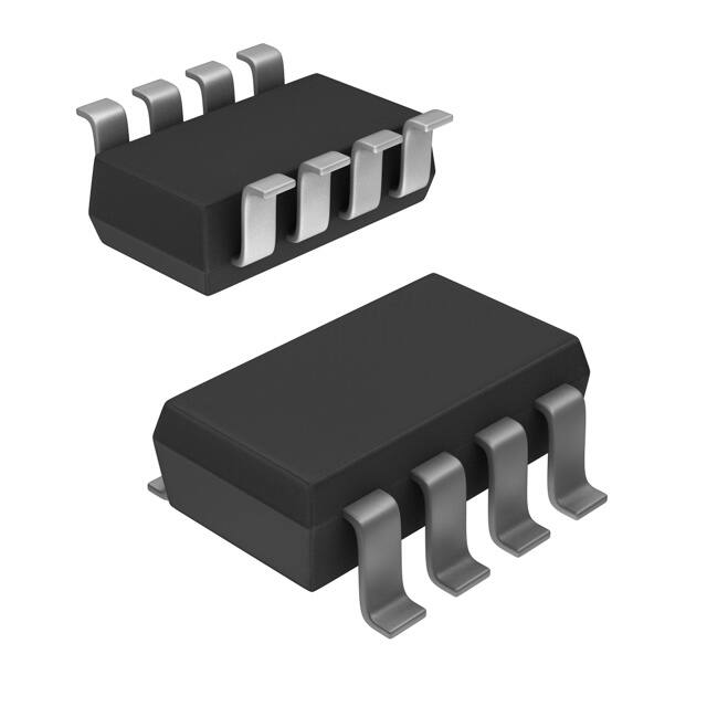

4.85 VOLT ULTRA LOW DROPOUT REGULATOR ZLDO485 ISSUE 2 - MAY 1997 DEVICE DESCRIPTION FEATURES • • • • • • • • • • • The ZLDO Series low dropout linear regulators operate with an exceptionally low dropout voltage, typically only 30mV with a load current of 100mA. The regulator series features output voltages in the range 2.7 to 18 volts, this device provides an output voltage of 4.85 volts. The ZLDO485 consumes a typical quiescent current of only 1mA and is rated to supply load currents up to 300mA. A battery low flag is available to indicate potential power fail situations. If the input voltage falls to within 200mV of the regulated output voltage then the error output pulls low. The device also features an active high disable control. Once disabled the ZLDO quiescent current falls to typically 11µA. Very low dropout voltage 6mV dropout at 10mA output 30mV dropout at 100mA output 100mV dropout at 300mA output 4.85 volt fixed output Other voltages available Low quiescent current 1mA quiescent (typ) at 300mA output Low battery flag Shutdown control Surface mount package APPLICATIONS • • • • • The ZLDO devices are packaged in Zetex SM8 8 pin small outline surface mount package, ideal for applications where space saving is important. The device low dropout voltage, low quiescent current and small size make it ideal for low power and battery powered applications. Battery powered circuits can make particular use of the low battery flag and shutdown features. Battery powered devices Portable instruments Portable communications Laptop/Palmtop computers Electronic organisers Low Battery Flag Vin LOW BATTERY COMPARATOR THERMAL SHUTDOWN Vo OUTPUT DRIVE BIAS Shutdown Control CIRCUIT Cs SHUTDOWN BANDGAP REFERENCE Shaping Gnd 4-71 ZLDO485 ABSOLUTE MAXIMUM RATING Input Supply Voltage Range Shutdown Input Voltage Range Low Battery Output Voltage Range Output Current Operating Temperature Storage Temperature Power Dissipation (Tamb=25°C) -0.3 to 20V -0.3 to Vin -0.3 to 20V 300mA -40 to 85°C -55 to 150°C 2W (Note 1) ELECTRICAL CHARACTERISTICS TEST CONDITIONS (Unless otherwise stated) Tamb =25°C,IL=10mA,Cs=10pF,Cout =1µF Parameter SYMBOL CONDITIONS MIN. Output voltage Vo Vin=5.85V 4.75 Vo Output voltage temperature coefficient ∆T TYP. MAX. UNITS 4.85 4.95 V Vin=5.85V (Note 2, Note 4) 100 250 ppm/°C Line regulation ∆Vo Vin=5.85 to 20V 20 69 mV/V Load regulation ∆Vo IL=10 to 300mA Vin=5.85V 68 119 mV Dropout voltage (Note3) Vin-Vo IL=10mA IL=100mA IL=300mA 6 30 100 10 75 200 mV Quiescent current Iq Vin=5.85V, IL=0 0.63 1 mA Quiescent current at shutdown Iqs Vin=5.85V, IL=0, Vshdn=Vin 11 30 µA Shutdown control input Iins current Vshdn=Vin=5.85V 2 10 µA Shutdown control threshold voltage Vin=5.85V low(on) high(off) 0.4 V 100 nA Vts 1.5 Output current in shutdown mode (Note4) ILs Vin=20V Vo=Gnd 50 Output noise voltage (Note4) en Vin=5.85V f=10Hz to100kHz, IL=100mA 190 Low battery detect voltage Vin(bld) Low battery flag output voltage Vbl Ibl=100µA, VinVo+400mV Vo + 0.2V 4-72 µV RMS Vo + 0.4V V 0.16 0.4 V 0.1 1 µA ZLDO485 NOTES. 1. Maximum power dissipation of the device is calculated assuming the package is mounted on a PCB measuring 2 inches square. 2 Output voltage temperature coefficient is calculated as:- VO change x 1000000 VO x temperature change 3. Dropout voltage is defined as the input to output voltage differential at which the circuit ceases to regulate. The value is measured when the output voltage has dropped by 100mV from V out measured at the nominal input Vin = Vout + 1V 4. Guaranteed by design. FUNCTIONAL DESCRIPTION The ZLDO is a high performance, ultra low dropout, low quiescent regulator. Available in SM8 surface mount packaging, the device is able to dissipate 2W(note 1) allowing complete design flexibility with an input span upto 20V and 300mA output current. The device quiescent is 1mA (typ) at 300mA load current. A low battery comparator signifies impending battery failure, whilst a shutdown function reduces quiescent current to a mere 11µA (typ). A precision bandgap reference gives ± 2.5% output tolerance and good temperature characteristics over the range -40 to +85°C. AC performance is enhanced via the use of a small external capacitor. PIN DEFINITIONS Pin 1 LBF - Low Battery Flag. An open collector NPN output which pulls low on failing input supply. Pin 2 SC - Shutdown Control. This high impedance logic compatible input disables the regulator when taken high. It includes a diode wired to Vin and so will pass current if taken more than 0.5V above Vin. Pin 3 Vin - Voltage Input. The power supply to the regulator. The permissible input voltage range is -0.3 to 20V. An input capacitor is not mandatory but will be useful in reducing the coupling of noise from input to output and minimising the effect of sudden changes in load current on the input voltage. Pin 4 N/C - Not Connected. Not internally connected and so can be left open or wired to any pin without affecting the performance of the regulator. Pin 5 Vout - Voltage Output. The output of the regulator. An output capacitor of 1uF or greater and having low ESR should be wired in close proximity to the regulator to ensure stability for all loads. Pin 6 D/C - Do Not Connect. This pin is wired to an internal circuit node of the regulator. No external connection should be made to this pin. Pin 7 Gnd - Ground. The ground connection of the regulator against which the output voltage is referenced. Pin 8 Spg - Shaping. The shaping node for the error amplifier of the regulator. A capacitor of 10pF wired from this pin to the output pin (pin 5) gives optimum stability. Improved AC can be achieved by reducing the value of this capacitor but stability may be impaired for some load conditions. 4-73 ZLDO485 TYPICAL CHARACTERISTICS 1800 45 C(out)= 1µF C(out)= 1µF 40 Ripple Rejection (dB) Output Impedance (mΩ ) 1600 1400 1200 10pF 4.7pF 2.2pF 1000 800 600 400 35 10pF 4.7pF 2.2pF 30 25 20 15 10 200 5 0 100 1K 10K 100 100K 1K Output Impedance vs. Frequency 4.89 720 Io= 10mA V(in)= 7V V(in)= 7V 700 Quiescent Current (µA) Output Voltage (V) 100K Ripple Rejection vs. Frequency 4.88 4.87 4.86 4.85 4.84 4.83 680 660 640 620 600 580 560 540 -40 4.82 -40 -20 0 20 40 60 80 100 -20 0 Temperature ( ° C) 18 40 60 80 100 Quiescent Current vs. Temperature 5.15 L.B.F. Operation Voltage (V) V(in)= 7V 16 14 12 10 8 6 -40 20 Temperature ( ° C) Output Voltage Temperature Coefficient Shutdown Current (µA) 10K Frequency (Hz) Frequency (Hz) V(in)= 7V Io= 10mA 5.14 5.13 5.12 5.11 5.10 5.09 -20 0 20 40 60 80 100 -40 -20 0 20 40 60 80 Temperature ( ° C) Temperature ( ° C) Shutdown Current vs. Temperature Low Battery Flag Operating Point 4-74 100 ZLDO485 TYPICAL CHARACTERISTICS 220 Output Voltage Deviation (V) V(in)=7V Dropout Voltage (mV) 200 180 160 140 120 85 °C 25 °C -40 °C 100 80 60 40 20 Io=100mA V(in)=12V V(in)=7V 1 Output Voltage Deviation 0 -1 0 0.1 1.0 10 1000 100 0 200 400 600 800 1000 Time (µs) Load Current (mA) Dropout Voltage vs. Load Current Line Transient Response SINGLE PULSE TEST Tamb =25 °C DC 1s 0.1s 10ms Io=100mA Load Current (A) Output Voltage Deviation (V) 1.0 V(in)=7V Io=0mA 0.5 Output Voltage Deviation 0 DC 0.1 -0.5 0.01 0 200 400 600 800 1000 1 2 5 10 20 Input-Output Differential Voltage (V) Time (µs) Safe Operating Area Load Transient Response Operation in shaded area is not guaranteed 4-75 ZLDO485 APPLICATIONS 1). Operation From A Low Voltage Battery Pack Fig.1 shows the ZLDO485 regulator being used to stabilise the output of a 6V battery pack. The ultra low dropout voltage of only 100mV at full load (300mA) given by the regulator allows the minimum number of cells to be used in the pack and also maximises the energy that can be removed from the battery before the output of the regulator starts to fail. ZLDO485 LBF Spg SC Gnd Vin D/C C1 10pF + 4.85V N/C Vout C3 100nF 6V C2 1uF Output 0V Figure 1 At a load current of 100mA the dropout voltage falls to around 30mV. The endurance of the battery pack is not only dependent on dropout voltage. When operating, some low dropout regulators can consume high quiescent Voltage Feedback currents, sometimes approaching as much as a tenth of their maximum load current specification when approaching dropout conditions. Despite its 300mA output rating, when enabled the ZLDO485 consumes typically only 630uA regulating normally and 3mA when the input falls too low for regulation. 2). Post Converter Regulation A common problem with multiple output switch mode converters is that only one output can be used in the feedback control loop of the switching regulator. Thus only one output is fully regulated. All other outputs are prone to tracking errors that occur if the load on any output change significantly. By ensuring close coupling of all transformer windings and minimising the impedance of all outputs, these errors can be reduced but never eliminated. A simple way round this problem is to wind the switching regulator transformer to give a slightly higher voltage than required and regulate down from this to the desired voltage with a linear regulator. This is indicated in Figure 2. To keep losses low and so maintain the advantages of a switch mode supply, it is important that the voltage drop across this regulator is kept as low as possible, i.e. just high enough to compensate for the poor D1 +12V Out TR1 Switching Regulator C4 220uF D2 ZLDO485 LBF Spg SC Gnd Vin D/C C1 10pF +4.85V Out N/C Vout C5 C2 1uF 220uF Figure 2 0V Out 4-76 ZLDO485 APPLICATIONS output impedance of the switching power supply but no higher. The low dropout voltage of the ZLDO485 allows this circuit technique to be implemented very effectively, giving a highly stable and accurate low noise supply. 3). Logic Controlled Power Supply Fig.3 shows all that is necessary to allow a microprocessor to control a power supply based on the ZLDO485 The Shutdown Control pin (pin 2), is a logic compatible input that disables the regulator when a voltage in excess of 1.5V is applied. The current required to drive this input is less than 10µA. When the regulator 4). Over Temperature Shutdown The ZLDO485 regulator includes an over temperature shutdown circuit that disables the regulator if its chip temperature should exceed 125°C for any reason. Although intended to provide a limited guard against excessive internal power dissipation, this circuit will shut down the regulator if its ambient rises above 125°C. Thus, the regulator could be used to disable a circuit in the event of the ambient temperature within which the circuit is mounted becoming too high. Any internal power dissipation caused as a result of + 6.7V to 20V Vin Vout Gnd IC2 ZLDO485 IC1 ZSR500 LBF Spg Microproc. System Supply Input SC Gnd Vin D/C C1 10pF N/C Vout C3 100nF + 4.85V C2 1uF Switched Output 0V 0V Figure 3 is shutdown in this way, the quiescent current of the ZLDO485 falls to around 11µA. This makes the regulator suitable for a wide range of battery powered applications where intermittent operation occurs. The shutdown control pin should not be taken to a voltage higher than Vin if low quiescent supply current is important. The shutdown control is a high impedance input and so if not required, should be wired to the ground pin (pin 7). supplying load current, will reduce the ambient temperature at which shutdown occurs. Note that to achieve the extremely low dropout voltage and high current performance provided by the ZLDO485 devices, the parts can be damaged by sustained output shorts or excessive loads when combined with high input supply voltages. To ensure reliable operation, keep loads within the SOA graph b o u nd a r i e s I nd i ca te d i n t he t yp i cal characteristics. 4-77 ZLDO485 APPLICATIONS 5). Low Battery Flag The ZLDO485 provides an output called Low Battery Flag (LBF). Unlike many regulators that only signal that they are falling out of regulation, the LBF output of the ZLDO485 series indicates that the voltage drop across the regulator has fallen to less than typically 300mV and so supply failure is imminent. This improved warning gives both more time for the system suppl ied to shutdown gracefully and maintains regulation while this happens. This could be a vital point if measurements are under way and must be completed accurately for instance. The LBF output is driven by an open collector NPN transistor which pulls low when the supply to the regulator is failing. Fig.4 shows this output being used. Note that resistor R1 is necessary only if the interrupt logic does not include a pull-up resistor. ZLDO485 LBF Spg SC Gnd Vin D/C C1 10pF + 4.85V N/C Vout 6V C3 100nF C2 1uF Figure 4 R1 100k Microproc. System 0V 4-78 Interrupt Input ZLDO485 CONNECTION DIAGRAM SM8 Package Suffix – T8 Top View – Pin 6 must be left floating SEE PIN DEFINITIONS ORDERING INFORMATION Part Number Package Part Mark ZLDO485T8 SM8 ZLDO485 4-79
