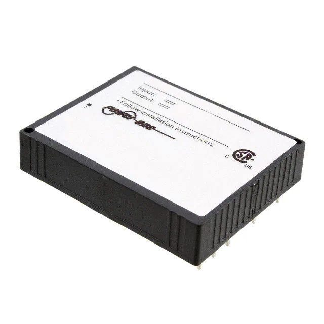

IMX15 / IMY15 / IMS15 Series 15 Watt DC-DC Converter Features 40.6 1.6" 51 2.0" 10.5 0.42" • Wide input voltage ranges up to 150 VDC • 1 or 2 isolated outputs up to 48 V • RoHS lead-free-solder and lead-solder-exempted products are available. • 5 year warranty for RoHS lead-free-solder products with temperature index -8 • 1500 to 3000 VAC I/O voltage withstand test • Emissions EN 55011, group 1, level A • Immunity to EN 50155 and EN 50121-3-2 • High efficiency (typ. 86%) • Input undervoltage lockout • Shutdown input, adjustable output voltages • Flex power: Flexible load distribution on outputs • Outputs no-load, overload, and short-circuit proof • Operating ambient temperature –40 to 85 °C • Thermal protection • Dimensions 51.0 x 10.5 x 40.6 mm (2.0 x 1.6 x 0.42 in) • Basic insulation: 20/40IMX15 models; Double or re­in­forced insulation: 110IMY15 models • Safety-approved to the latest edition of UL/CSA 60950-1, comply with IEC/EN 62368-1 standard 1 1 110IMY15 models Table of Contents Description............................................................................2 Model Selection.....................................................................2 Functional Description...........................................................4 Electrical Input Data..............................................................5 Electrical Output Data...........................................................8 Auxiliary Functions..............................................................14 Electromagnetic Compatibility (EMC)..................................16 Immunity to Environmental Conditions................................18 Mechanical Data..................................................................19 Safety and Installation Instructions......................................20 Description of Options.........................................................21 Accessories.........................................................................22 belfuse.com/power-solutions BCD20008-G Rev AJ, 29 September 2021 IMX15 / IMY15 /IMS15 Series 15 Watt DC-DC Converter Description The IMX15, IMS15, and IMY15 Series of board mountable 15 Watt DC-DC converters have been designed according to the latest industry requirements and standards. The converters are particularly suitable for use in mobile or stationary applications in transport, railways, industry, or telecommu­nication, where variable input voltages or high transient voltages are prevalent. Covering a total input voltage range from 8.4 up to 150 V with different models, the converters are available with single and electrically-isolated double outputs from 3.3 up to 48 V, exter­nally adjustable, with flexible load distribution on double-output models. A shutdown input allows for remote on/off. Features include efficient input and output filtering and consistently high efficiency over the entire input voltage range, high reliability, and excellent dynamic response to load and line changes. The converters have been approved by CSA. 20IMS/20IMX15 and 40IMS/40IMX15 models exhibit a basic in­sulation. The 110IMY15 models provide double insulation and are CE marked. They may be connected to a rectified 110 VAC source or a 110 V battery without any further insulation barrier. The circuitry is comprised of integrated planar magnetics. All components are automatically assembled and solidly soldered onto a single PCB without any wire connection. Magnetic feedback ensures maximum reliability and repeatability in the control loop over all operating conditions. Careful con­si­deration of possible thermal stress ensures the absence of hot spots providing long life in environments, where temperature cycles are frequent. The thermal design allows operation at full load up to an ambient temperature of 71 °C in free air without using any potting material. For extremely high vibration environments the case has holes for screw fastening. Model Selection Table 1: Model Selection Output 1 Output 2 Output Power Input voltage Efficiency 6 Model Options 2 Vo nom [VDC] Io nom [mA] Vo nom [VDC] Io nom [mA] Po nom [W] Vi min to Vi max [VDC] η min [%] η max [%] 3.3 3.3 3.3 3.3 4.5 4.0 4.5 4.5 - - 14.9 13.2 14.9 14.9 8.4 to 36 5 16.8 to 75 3 16.8 to 75 3 50 to 150 4 80 78 81 77 82 80 83 79 20IMX15-03-8RG-G SR 40IMX15-03-8RG 40IMX15-03-8RG-G SR 110IMY15-03-8RG-G SR i, Z, non-G non-G i, Z, non-G i, Z, non-G 5.1 5.1 5.1 3.5 3.5 3.5 - - 17.5 17.5 17.5 8.4 to 36 5 16.8 to 75 3 50 to 150 4 83 85 79.5 86 87 82 20IMX15-05-8RG-G SR 40IMX15-05-8RG-G SR 110IMY15-05-8RG-G SR i, Z, non-G i, Z, non-G i, Z, non-G 5.1 5.1 5.1 5.1 2.3 2.7 2.5 2.5 - - 11.7 13.8 12.8 12.8 8.4 to 36 5 14 to 36 16.8 to 75 3 50 to 150 4 82 81.5 81.5 78 84 84 83 81 20IMX15-05-8R-G 24IMS15-05-9R 40IMX15-05-8R-G 110IMY15-05-8R-G 5.1 5.1 5.1 5.1 5.1 1.35 1.6 1.5 1.6 1.5 3.3 3.3 3.3 3.3 3.3 1.35 1.6 1.5 1.6 1.5 11.3 13.5 12.6 13.5 12.6 8.4 to 36 5 14 to 36 16.8 to 75 3 36 to 75 50 to 150 4 82 81 82 79 79 84 83 84 82 82 20IMX15-0503-8RG 24IMS15-0503-9R 40IMX15-0503-8RG 48IMS15-0503-9R 110IMY15-0503-8RG i, Z, non-G --i, Z, non-G --i, Z, non-G 5 5 5 5 1.3 1.4 1.4 1.4 5 5 5 5 1.3 1.4 1.4 1.4 13.0 14.0 14.0 14.0 8.4 to 36 5 14 to 36 16.8 to 75 3 50 to 150 4 82 81 81 80 85 84 84 82 20IMX15-05-05-8G 24IMS15-05-05-9 40IMX15-05-05-8G 110IMY15-05-05-8G i, Z, non-G --i, Z, non-G i, Z, non-G 12 12 12 12 0.65 0.7 0.7 0.7 12 12 12 12 0.65 0.7 0.7 0.7 15.6 16.8 16.8 16.8 8.4 to 36 5 14 to 36 16.8 to 75 3 50 to 150 4 83 83 84 82 86 86 87 85 20IMX15-12-12-8G 24IMS15-12-12-9 40IMX15-12-12-8G 110IMY15-12-12-8G i, Z, non-G --i, Z, non-G i, Z, non-G 15 15 15 15 0.5 0.56 0.56 0.56 15 15 15 15 0.5 0.56 0.56 0.56 15.0 16.8 16.8 16.8 8.4 to 36 5 14 to 36 16.8 to 75 3 50 to 150 4 85 83 83 82 88 86 86 85 20IMX15-15-15-8G 24IMS15-15-15-9 40IMX15-15-15-8G 110IMY15-15-15-8G i, Z, non-G --i, Z, non-G i, Z, non-G 24 24 24 24 0.32 0.35 0.35 0.35 24 24 24 24 0.32 0.35 0.35 0.35 15.4 16.8 16.8 16.8 8.4 to 36 5 14 to 36 16.8 to 75 3 50 to 150 4 83 84 84 82 86 87 86 85 20IMX15-24-24-8G 24IMS15-24-24-9G 40IMX15-24-24-8G 110IMY15-24-24-8G i, Z, non-G non-G i, Z, non-G i, Z, non-G 1 1 Z, non-G ----Z, non-G Flexible load distribution on dual and double outputs possible; up to 75% of the total output power Po nom on one of the 2 outputs. IMX/IMY15-0503 models have reduced load distribution flexibility; 1.8 A max. on one of the 2 outputs. The total output power should not exceed Po nom. 2 See Description of Options. 3 Short-time operation down to Vi = 14.4 V possible (Po reduced to approx. 85% of Po nom) 4 Short-time operation down to Vi = 43.2 V possible (Po reduced to approx. 85% of Po nom) and up to 154 V 5 Initial start-up at 9 V, main output voltage regulation down to 8.4 V 6 Efficiency at TA = 25 °C, Vi nom, I o nom. SR Models with synchronous rectifier. For the RoHS version of such models, add -G ! 1 NFND: Not for new designs. Preferred for new designs. Replace 24IMS15 models by 20IMX15 and 48IMS15 by 40IMX15; Replace 20IMX15-05, 40IMX15-05, 110IMY15-05 by models with synchronos rectifier SR; for new designs, chose always the RoHS version ! tech.support@psbel.com belfuse.com/power-solutions BCD20008-G Rev AJ, 29 September 2021 © 2021 Bel Power Solutions & Protection Page 2 of 22 IMX15 / IMY15 /IMS15 Series 15 Watt DC-DC Converter RoHS-Compliant Models The type designation of RoHS-compliant models (compliant for the restriction of all six substances) for the IMX/IMY15 Series ends with "G". However, in single-output models with 3.3 V or 5.1 V output an extra hyphen (-) is added after the existing "G", which already signifies a synchronous rectifierSR. This is an exception to our normal nomenclature to identify this type of product, since G was already used to designate products for higher output current fitted with a synchronous rectifier. Some examples – 20IMX15-05-8R-G designates a standard version with RoHS compliance for all six substances. – 20IMX15-05-8RG designates a synchronous rectifierSR version which is not RoHS-compliant. – 20IMX15-05-8RG-G designates a synchronous rectifierSR version and RoHS compliant for all six substances. – 20IMX15-05-05-8G designates a double-output model with RoHS compliance for all six substances – 110IMY15-24-24-8RG designates a double-output model with RoHS compliance for all six substances. Part Number Description 40 IMX15 - 05 - 8 R G Z -G Input voltage range Vi 8.4 to 36 V....................................................... 20 14 to 36 V......................................................... 24 16.8 to 75 V...................................................... 40 36 to 75 V......................................................... 48 50 to 150 V..................................................... 110 Series IMX15, IMS15, IMY15 Output voltage of output 1............................. 03, 05, 12, 15, 24 Hyphen designating double-output models with two electrically isolated outputs................................. - 1 Output voltage of output 2............................. 03, 05, 12, 15, 24 Operating ambient temperature range TA – 40 6 to 85 °C ................................................... -8 6 – 40to  71 °C .................................................... -9 2 Options and features: R input and magnetic feedback....................... R 3 Synchronous rectification.................................. G Inhibit.................................................................. i 4 Open frame........................................................ Z RoHS-compliant for all 6 substances......G or -G 5 1 3 4 5 2 6 Not applicable to -0503 models. They have a common ground. IMS15 models are not recommended for new designs. Standard for single-output and -0503 models Option i replaces the standard shutdown function; see Description of Options. RoHS models with synchronous rectifier are ending with -G, as an exception. Only –25 °C for older -8RGSR models (Rev. < BA); see table 7a. Note: The sequence of options must follow the order above ! Examples: 20IMX15-05-05-8G: DC-DC converter, input 9 to 36 V, 2 galvanically isolated outputs each providing 5 V, 1.3 A, RoHS-compliant. 110IMY15-0503-8RG: DC-DC converter, input 50 to 150 V, 2 outputs with common return providing +5.1 V, 1.5 A and +3.3 V, 1.5 A, RoHS-com­pliant. Converter fitted with magnetic feed­back for tight output voltage regulation. Product Marking The converters without option Z are marked with basic type designation, input and output voltages and currents, applicable safety approval and recognition marks, company logo, date code, and serial number. tech.support@psbel.com belfuse.com/power-solutions BCD20008-G Rev AJ, 29 September 2021 © 2021 Bel Power Solutions & Protection Page 3 of 22 IMX15 / IMY15 /IMS15 Series 15 Watt DC-DC Converter Functional Description The IMX15/IMS15/IMY15 Series of DC-DC converters are magnetic feedback-controlled flyback converters using current mode PWM (Pulse Width Modulation). The -05- and -0503-output voltage models exhibit an active magnetic feedback loop via a pulse transformer, resulting in very tight regulation of the output voltage (see the block diagrams). The output voltages of these models can be adjusted via the R-input. The R-input is referenced to the secondary side and allows for programming the output voltages in the range of approximately 80 to 105% of Vo nom, using either an external resistor or an external voltage source. Several single-output models with 3.3 or 5.1 V output exhibit a synchronous rectifier to improve the efficiency. The voltage regulation on the double-output models is achieved with an auxiliary winding of the main transformer. The output voltages can be adjusted via the Trim input, which is referenced to the primary side and allows for programming the output voltage in the range of 100 to 105% of Vo nom via an external resistor, or within 75 to 105% if using an external voltage source. The load regulation output characteristic allows for paralleling of one or more double-output models with equal output voltage. Current limitation is provided by the primary circuit, thus limiting the total output power of double-output models. The shutdown input allows remote converter on/off. Overtemperature protection will disable the converter under excessive overload conditions with automatic restart. 03089a 03039a Vi+ 1 13 Vo+ PWM SD 4 SD 4 15 Vo– n.c. Vi+ 1 13 Vo1+ 15 Go PWM n.c. 3 11 Vo2+ Vi – 2 12 Go 2 x 2200 pF 1500 V V i– 2 17 R 2 x 2200 pF 17 R Fig. 1 Block diagram of single-output models Fig. 2 Block diagram of -0503-models 03090a Vi+ 1 SD 4 11 Vo1+ 12 Vo1– PWM Trim 3 13 Vo2+ Vi – 2 15 Vo2– 2 x 2200 pF 17 n.c. Fig. 3 Block diagram of double-output models tech.support@psbel.com belfuse.com/power-solutions BCD20008-G Rev AJ, 29 September 2021 © 2021 Bel Power Solutions & Protection Page 4 of 22 IMX15 / IMY15 /IMS15 Series 15 Watt DC-DC Converter Electrical Input Data General conditions: – TA = 25 °C, unless TC is specified. – Shut-down pin left open-circuit. – Trim or R input left open-circuit. Table 2a: Input data of IMX15 and IMY15 models Model 20IMX15 Characteristics Conditions min TA min – TA max, 9 typ 40IMX15 max max min 75 50 typ max Operating input voltage Vi nom Nominal input voltage Io = 0 – Io nom Vi sur Repetitive surge voltage Abs. max input (3 s) tstart-up Converter start-up time 2 trise Rise time 2 Ii o No-load input current Io = 0, Vi min – Vi max 65 45 15 mA Ii rr Reflected ripple current Io = 0 – I o nom 30 30 20 mApp Ii inr p Inrush peak current 3 Vi = Vi nom Ci Input capacitance For surge calculation VSD Shutdown voltage RSD Shutdown input resistance ISD Input current, when disabled fs Switching frequency Switch on SD high Worst case condition at Vi min, Io = Io nom 5, 7 20 16.8 typ Unit Vi 1 36 min 110IMY15 5, 6 40 110 40 0.25 0.5 100 0.25 0.1 Vi nom, resistive load 5 I o nom, capacitive load 10 0.5 0.5 0.8 0.1 5 10 20 8 1.5 V 168 0.1 5 20 150 8 5 10 9 0.75 20 10 0.35 -10 to 0.7 -10 to 0.7 -10 to 0.7 Converter operating open or 2 – 20 open or 2 – 20 open or 2 – 20 approx. 10 approx. 10 approx. 10 10 SD connected to ViVi min – Vi max, Io = 0 – I o nom approx. 300 3 approx. 300 A V kΩ 1 approx. 300 ms µF Converter disabled Vi min – Vi max, s mA kHz If Vo is set above Vo nom by use of the R or Trim input, Vi min will be proportionately increased. Measured with resistive and max. admissible capacitive load. Valid for models with rev. AI or greater. 3 Source impedance according to ETS 300132-2, version 4.3. 4 Double-output models with both outputs in parallel. External filter as in fig. 6, table 6. 5 Input undervoltage lockout at typ. 80% of Vi min. 6 Short time operation down to Vi min >14.4 V possible. Po reduced to approx. 85% of Po nom. 7 Initial start-up at Vi = 9 V, main output voltage regulation down to 8.4 V 8 Short time operation up to 154 V possible for 2 s. 1 2 tech.support@psbel.com belfuse.com/power-solutions BCD20008-G Rev AJ, 29 September 2021 © 2021 Bel Power Solutions & Protection Page 5 of 22 IMX15 / IMY15 /IMS15 Series 15 Watt DC-DC Converter Table 2b: Input Data of IMS15 models; general conditions as in table 2a Model 24IMS15 Conditions min Vi Characteristics Operating input voltage 1 TA min – TA max, 14 Vi nom Nominal input voltage Io = 0 – Io nom Vi sur Repetitive surge voltage Abs. max input (3 s) tstart-up Converter start-up time 2 trise Rise time 2 Ii o Switch on SD high typ 48IMS15 max min 36 36 typ max 75 24 48 V 50 0.25 Worst case condition at Vi min, Io = Io nom Unit 100 0.5 0.25 0.5 0.1 0.1 Vi nom, resistive load 5 I o nom, capacitive load 10 20 10 20 No-load input current Io = 0, Vi min – Vi max 20 40 10 20 Ii rr Reflected ripple current Io = 0 – I o nom 30 Ii inr p Inrush peak current 3 Vi = Vi nom Ci Input capacitance For surge calculation VSD Shutdown voltage RSD Shutdown input resistance ISD Input current, when disabled fs Switching frequency 5 30 4.5 4 2 Converter disabled -10 to 0.7 -10 to 0.7 Converter operating open or 2 – 20 open or 2 – 20 approx. 10 approx. 10 1.2 SD connected to ViVi min – Vi max, Io = 0 – I o nom 3 approx. 300 ms mA mApp 5 Vi min – Vi max, s A µF 1.2 V kΩ 3 approx. 300 mA kHz If Vo is set above Vo nom by use of the R or Trim input, Vi min will be proportionately increased. Measured with resistive and max. admissible capacitive load. 3 Source impedance according to ETS 300132-2, version 4.3. 4 Double-output models with both outputs in parallel. External filter as in fig. 6, table 6. 5 Input undervoltage lockout at typ. 80% of Vi min. 1 2 Inrush Current The inrush current has been made as low as possible by choosing a very small input capacitance. A series resistor may be installed in the input line to further reduce this current. A 04022b 4 Vo trise Vo nom 3 04008b 2 1 0 20 40 60 80 t 100 µs Fig. 4 Typical inrush current at Vi nom, Po nom versus time (40IMX15). Source impedance according to ETS 300132-2 at Vi nom. tstartup t Fig. 5 Converter start-up and rise time tech.support@psbel.com belfuse.com/power-solutions BCD20008-G Rev AJ, 29 September 2021 © 2021 Bel Power Solutions & Protection Page 6 of 22 IMX15 / IMY15 /IMS15 Series 15 Watt DC-DC Converter Input Undervoltage Lockout A special feature of these converters is the accurate undervoltage lockout protection, which protects against large currents caused by operation at low voltages. This ensures easier start-up in distributed power systems. Tab. 3: Turn on and turn off voltage Model Turn on min Turn off max Unit min max 20IMX15 7.5 8 7 7.5 24IMS15 12.5 13.5 12 13 40IMX15 12.5 13.5 12 13 48IMS15 31.5 32.5 31 32 110IMY15 40 42.5 38 40.5 V Fuse and Reverse Polarity Protection The built-in suppressor diode also provides for reverse polarity protection at the input by conducting current in the reverse direction. An external fuse is required to limit this current. Table 4: Recommended external fuses Model Fuse type 20IMX15 F 4.0 A 24IMS15 F 3.15 A 40IMX15, 48IMS15 F 2.0 A 110IMY15 F 1.0 A Input Transient Voltage Protection A built-in suppressor diode provides effective protection against input transients, which typically occur in many installations. Table 5: Built-in transient voltage suppressor Model Breakdown voltage VBR nom Peak power at 1 ms PP Peak pulse current IPP 20IMX15 40 V 1500 W 22 A 24IMS15 53 V 600 W 7.7 A 40IMX15 100 V 1500 W 9.7 A 48IMS15 100 V 600 W 4.1 A 110IMY15 168 V 600 W 0.5 A For very high energy transients as for example to achieve compliance to IEC/EN 61000-4-5 (see table Electro­magnetic Immunity), an external inductor and a capacitor are required, see Fig. 6. The components are specified in table 6. Table 6: Components for external circuitry for IEC/EN 61000-4-5, level 3 compliance. Model Inductor (L) Capacitor (C) Diode (D) 20IMX15 1 mH, 3.5 A 330 μF, 63 V 1.5k E47A 24IMS15 1 mH, 2.5 A 330 μF, 63 V --- 40IMX15 1 mH, 2.5 A 330 μF, 100 V --- 48IMS15 1 mH, 1.5 A 330 μF, 100 V --- 110IMY15 1 mH, 1.5 A 330 μF, 200 V --- Vi+ L C + C + IMX15 D Vi– Fig. 6 Example for external circuitry to achieve better transient immunity and required EMC performance tech.support@psbel.com belfuse.com/power-solutions BCD20008-G Rev AJ, 29 September 2021 © 2021 Bel Power Solutions & Protection Page 7 of 22 IMX15 / IMY15 /IMS15 Series 15 Watt DC-DC Converter Electrical Out put Data We recommend connecting an external 1 µF ceramic capacitor across the output pins. General conditions: – TA = 25 °C, unless TC is specified – Shutdown pin and Trim or R pin left open-circuit (not connected) Table 7a: Output data for single-output models -03-8RG 1 and 05-8RG 1 Output 3.3 V Characteristics Vo Output voltage Io nom Output current Io L Current limit 2 ∆Vo Line / load regulation 20IMX 40IMX / 110IMY Conditions min Vi nom, I o = 0.5 I o nom 3.25 Vi min to Vi max Vi nom, TC = 25 °C,Vo ≤ 93% Vo typ 5V max min 3.35 5.05 typ Unit max 5.15 4.5 3.5 4.5 3.5 6.0 4.6 V A nom Vo Output voltage noise Vo L Output overvoltage limit.3 Co ext Admissible capacitive load Vo d to d Dynamic load regulation αVo Temperature coefficient ∆Vo / ∆TC Vi min to Vi max , (0.1 to 1) I o nom ±0.5 ±0.5 Vi min to Vi max 4 100 100 I o = I o nom 5 60 60 Voltage deviation Vi nom, I o nom ↔ 1/2 I o nom Recovery time IEC/EN 61204 Vi min to Vi max , (0.1 to 1) I o nom 115 130 0 4000 6 ±250 115 130 0 4000 % mVpp % 6 ±250 µF mV 1 1 ms ±0.02 ±0.02 %/K SR Models -8RG (synchr. rectifier) have a minimum case and operating temperature of –25 °C. If the revision is BA (or later), it is –40 °C. The current limit is primary side controlled. In the event of a sustained overload condition the thermal protection may cause the converter to shut down (automatic restart after cooling down). 3 The overvoltage protection is via a primary side second regulation loop. It is not tracking with R control. 4 BW = 20 MHz 5 Measured with a probe according to EN 61204 6 For 110IMY15 models with synchr. rectifier, Co ext is limited to 1000 µF. 1 2 tech.support@psbel.com belfuse.com/power-solutions BCD20008-G Rev AJ, 29 September 2021 © 2021 Bel Power Solutions & Protection Page 8 of 22 IMX15 / IMY15 /IMS15 Series 15 Watt DC-DC Converter Table 7b: Output data for -05-8R and -0503-8R models; general conditions as in table 7a Output 5.1 V Characteristics V o, V o1, V o2 Output voltage Io nom Output current Conditions min Vi nom, I o = 0.5 I o nom 5.05 20IMX 1 Current limit 2 Io L, Io1L, Io2L 5.12 3.46 2.0 4 40IMX / 110IMY 2.5 2 x 1.5 1.8 4 20IMX 3.2 2.7 3.8 3.5 3.0 3.8 3.6 2.9 4.0 24IMS / 48IMS Vi nom, Vo ≤ 93% Vo nom 40IMX / 110IMY 5.1 V Vi min – Vi max , (0.1 to 1) I o nom ±0.5 5.1 V 3.3 V Output overvoltage limit.7 Co ext Admissible capacitive load - ±4.5 80 I o = I o nom 6 40 40 IEC/EN 61204 αVo Temperature coefficient ∆Vo / ∆TC +3 / -5 70 Recovery time to d - 5 Vi nom, I o nom ↔ 1/2 I o nom Vi min – Vi max , (0.1 to 1) I o nom V A Vi min to Vi max Voltage deviation Dynamic load regulation 3 4 5 6 7 max 2 x 1.6 Vo L 2 typ 2.7 24IMS / 48IMS Vi min – Vi max Output voltage noise 1 5.15 5.0 3.13 1.6 4 Vo1/2 Vo d min 2 x 1.35 Line / load regulation ∆Vo max Unit 2.3 Io L, Io1L, Io2L Io L, Io1L, Io2L typ 5.1 V / 3.3 V % mVpp 115 130 115 130 % 0 4000 0 4000 3 µF ±250 ±150 mV 1 1 ms ±0.02 ±0.02 %/K Flexible load distribution: Io max for one of the 2 outputs; however the total load should not exceed Po nom specified in the table Model Selection. The current limit is primary-side controlled. For -0503-models: total capacitive load of both outputs. For -0503-models: Conditions for specified output. Other output loaded with constant current Io = 0.5 Io nom. BW = 20 MHz Measured with a probe according to EN 61204 The overvoltage protection is via a primary side second regulation loop. It is not tracking with R control. tech.support@psbel.com belfuse.com/power-solutions BCD20008-G Rev AJ, 29 September 2021 © 2021 Bel Power Solutions & Protection Page 9 of 22 IMX15 / IMY15 /IMS15 Series 15 Watt DC-DC Converter Table 7c: Output data for double-output models; general conditions as in table 7a Output 2x5V Characteristics V o1 Output 1 V o2 Output 2 Io nom Conditions min ∆Vo1 ∆Vo2 min typ 2 x 15 V max min typ 2 x 24 V max min typ Unit max 4.95 5.05 11.88 12.12 14.85 15.15 23.70 24.30 other models 4.95 5.05 11.90 12.10 14.88 15.12 23.80 24.20 4.94 5.06 11.84 12.16 14.80 15.20 23.64 24.36 5.06 11.88 12.12 14.85 15.15 23.75 24IMS / 48IMS Vi nom, I o = 0.5 I o nom other models 20IMX Output current 1 Current limit 2, 4 2 x 12 V max 24IMS / 48IMS other models 4.94 Vi min – Vi max 20IMX Io L typ 24IMS / 48IMS Vi nom, 40IMX / Vo1 ≤ 93% Vo nom 110IMY Output 1 Vi min – Vi max , I o nom Line / load regulation 8 Vo1/2 Output voltage noise Vo L Output overvoltage limit.7, 8 Co ext Admissible capacitive load 3 Vo d to d Dynamic load regulation αVo Temperature coefficient ∆Vo / ∆TC 24.25 2 x 1.3 2 x 0.65 2 x 0.50 2 x 0.32 2 x 1.4 2 x 0.70 2 x 0.56 2 x 0.35 3.0 1.6 1.3 0.85 3.5 1.9 1.6 0.95 3.2 1.7 1.4 0.90 ±1 ±1 ±1 ±1 Output 2 Vnom, (0.1 – 1) I o nom A ±3 +3 +3 +3 Vi min – Vi max 5 80 120 150 240 I o = I o nom 6 40 60 70 120 Min. load 1% Voltage deviation Vi nom, Recovery time I o nom ↔ 1/2 I o nom Vi min – Vi max , (0.1 to 1) I o nom V % mVpp 115 130 115 130 115 130 115 130 % 0 4000 0 680 0 470 0 180 µF ±250 ±300 ±300 mV ±600 1 1 1 1 ms ±0.02 ±0.02 ±0.02 ±0.02 %/K Flexible load distribution: Each output of double-output models is capable of delivering 75% of the total output power; however the total load should not exceed Po nom specified in the table Model Selection. 2 The current limit is primary-side controlled. 3 Measured with both outputs connected in parallel. 4 Conditions for specified output. Other output loaded with constant current Io = 0.5 Io nom. 5 BW = 20 MHz 6 Measured with a probe according to EN 61204 7 The overvoltage protection is via a primary side second regulation loop, not tracking with Trim or R control. 8 At start-up occurs a short overshoot at the output. 1 tech.support@psbel.com belfuse.com/power-solutions BCD20008-G Rev AJ, 29 September 2021 © 2021 Bel Power Solutions & Protection Page 10 of 22 IMX15 / IMY15 /IMS15 Series 15 Watt DC-DC Converter Thermal Considerations If a converter, mounted on a PCB, is located in free, quasi-stationary air (convection cooling) at the indicated maximum ambient temperature TA max (see table Temperature specifications) and is operated at its nominal input voltage and output power, the case temperature measured at the measuring point of case temperature TC (see Mechanical Data) will approach the indicated value TC max after the warm-up phase. However, the relationship between TA and TC depends heavily on the conditions of operation and integration into a system. The thermal conditions are influenced by input voltage, output current, airflow, temperature of surrounding components and surfaces, and the properties of the printed circuit board. TA max is therefore only an indicative value. Caution: The case temperature TC measured at the measuring point of case temperature TC (see Mechanical Data) may under no circumstances exceed the specified maximum value. The installer must ensure that under all operating conditions TC remains within the limits stated in the table Temperature specifications. Po /Po max JM017 1.0 0.8 0.5 m/s = 100 LFM 0.6 natural cooling 0.4 0.2 0 20 40 60 80 100 °C TA Fig. 7 Maximum output power versus ambient temperature Overtemperature Protection The converters are protected from possible overheating by means of an internal temperature monitoring circuit. It shuts down the converter above the internal temperature limit, and attempts to automatically restart in short intervals. This feature helps protect against excessive internal temperatures, which could occur during heavy overload cond­itions. Output Overvoltage Protection The output of single-output models as well as -0503- and -05-05-models are protected against overvoltage by a second control loop. In the event of an overvoltage on one of the outputs, the converter will shut down and attempt to restart in short intervals. Doubel-output models (except -0503- and -05-05-models) are protected against overvoltage by a Zener diode across the second output. Under worst case conditions the Zener diode will become a short circuit. Since with double-output models both outputs track each other, the protection diode is only provided in one of the outputs. The main purpose of this feature is to protect against possible overvoltage, which could occur due to a failure in the control logic. This protection circuit is not designed to withstand externally applied overvoltages. Short Circuit Behavior The current limit characteristic shuts down the converter, whenever a short circuit is applied to its output. It acts self-protecting, and automatically recovers after removal of the overload condition (hiccup mode). Parallel and Series Connection The outputs of one or several single- or double-output models can be connected in series without any precautions, taking into consideration that the highest output voltage should remain below 42 V to ensure that the output remains SELV. Both outputs of the same converter with equal voltage (e.g. 5 V / 5 V) can be connected in parallel and will share their output currents equally. Parallel operation of single or double outputs of two or more converters with the same output voltage may cause start-up problems at initial start-up. This is only advisable in applications, where one converter is able to deliver the full load current as, for example, required in true redundant systems. Note: If the 2nd output of double-output models (except 0503) is not used, connect it in parallel to the 1st output. tech.support@psbel.com belfuse.com/power-solutions BCD20008-G Rev AJ, 29 September 2021 © 2021 Bel Power Solutions & Protection Page 11 of 22 IMX15 / IMY15 /IMS15 Series 15 Watt DC-DC Converter Vo [%] overload condition 100 switch-off 05041c 70 0 t 0.3 s Fig. 8 Overload switch-off (hiccup mode); typical values Typical Performance Curves General conditions: – TA = 25 ºC, unless TC is specified. – Shutdown pin left open-circuit. – Trim or R input not connected. Vo [V] V 5.25 5.0 12 4.75 11 10 4.5 9 4.25 4.0 05020a 13 05056b 0 0.1 0.2 0.3 0.4 0.5 0.6 0.7 0.8 8 Io 0.9 1.0 A Fig. 9 Vo versus Io (typ) of converters with Vo = 5.1 V (110IMY15-05-8R) 7 0 0.2 0.4 0.6 0.8 1.0 1.2 1.4 1.6 1.8 A Io Fig. 10 Vo versus Io (typ.) of double-output models (2 x 12 V), with both outputs in parallel (110 IMY15-12-12-8) Vo1 [V] V 05058a 16.5 14 16 15.5 13 Io2 = 140 mA 12 15 Io2 = 14 mA 14.5 14 05039-X15b Io1 0 20 40 60 80 100 120 140 mA Fig. 11 Cross load regulation Vo1 versus Io1 (typ.) for various Io2 (2 x 12 V) Vo2 Vo1 11 10 0 0.25 0.5 0.75 1 1.25 1.5 Io1/Io1 nom Fig. 12 Flexible load distribution on double-outputs models with option R (110IMY15-12-12-8R): Load variation from 0 to 150% of Io1 nom on output 1; output 2 loaded with 50% of Io2 nom. tech.support@psbel.com belfuse.com/power-solutions BCD20008-G Rev AJ, 29 September 2021 © 2021 Bel Power Solutions & Protection Page 12 of 22 IMX15 / IMY15 /IMS15 Series 15 Watt DC-DC Converter % % 90 80 05167a Vi min 90 Vi nom 80 Vi max 70 70 60 0.25 0.5 1 Po/Po nom 0.75 Fig. 13a Efficiency versus input voltage and load. Typical values (40IMX15-12-12-8). 05168a Vi min Vi nom Vi max 60 0.25 0.5 0.75 1 Po/Po nom Fig. 13b Efficiency versus input voltage and load. Typical values (110IMY15-12-12-8) % 05040a 90 Vi nom Vi max Vi min 80 70 60 50 0.25 0.5 0.75 1 Io1/Io1 nom Fig. 13c Efficiency versus input voltage and load. Typical values (48IMS15-12-12-9) tech.support@psbel.com belfuse.com/power-solutions BCD20008-G Rev AJ, 29 September 2021 © 2021 Bel Power Solutions & Protection Page 13 of 22 IMX15 / IMY15 /IMS15 Series 15 Watt DC-DC Converter Auxiliary Functions Shutdown Function The outputs of the converters may be enabled or disabled by means of a logic signal (TTL, CMOS, etc.) applied to the shut- down pin. If this function is not required, the shut-down pin should be left open-circuit. • Converter operating:   2.0 to 20 V • Converter disabled: –10 to +0.7 V Adjustable Output Voltage • R input for single-output models and -0503-models • Trim input for double-output models As a standard feature, the single- and double-output models offer adjustable output voltage(s) by using the control input R or Trim. If the control input is left open-circuit, the output voltage is set to Vo nom. For output voltages Vo > Vo nom, the minimum input voltage Vi min (see Electrical Input Data) increases proportionally to Vo/Vo nom. Single-output models with synchronous rectifier (G): The R input is referenced to the secondary side of the converter. Adjustment of the output voltage is possible by means of an external resistor connected between the R pin and either Vo+ or Vo–. Note: For models with synchronous rectifier the logic for Vo adjustment differs from other models with R input. Table 8: Vo versus Vext approximate values 06131a Vi+ Typ. values of Rext1 Typ. values of Rext2 Vo nom [V] Vo [% of Vo nom] Rext1 [kΩ] Vo [% of Vo nom] Rext2 [kΩ] 3.3 5.1 90 95 100 0.47 2.7 ∞ 100 105 110 ∞ 15 6.8 90 95 100 3.3 8.2 ∞ 100 105 110 ∞ 9.1 3.9 Vo+ Rext1 R Rext2 Vi– Vo– Fig. 14 Output voltage control for single-output models with synchronous rectifier. All other models fitted with R-input: The R input is referenced to the secondary side of the converter. Adjustment of the output voltage is possible by means of either an external resistor or a voltage source. a) Adjustment by means of an external resistor Rext. Depending upon the value of the required output voltage, the resistor shall be connected: either: Between the R pin and Vo– to achieve an output voltage adjustment range of Vo ≈ 80 to 100 % of Vo nom. Vo ___________ Rext1 ≈ 4 kΩ • Vo nom – Vo or: Between the R pin and Vo+ to achieve an output voltage range of Vo ≈ 100 to 105 % of Vo nom.                    (V – 2.5V) o ___________________ Rext2                   ≈ 4 kΩ • 2.5 V • (Vo/Vo nom – 1) b) Adjustment by means of an external voltage Vext between Vo– and R pin. The control voltage range is 1.96 to 2.62 V and allows for adjustment in the range of Vo ≈ 80 to 105% of Vo nom.            V • 2.5 V o _________ Vext ≈                             Vo nom Attempting to adjust the output below this range will cause the converter to shut down (hiccup mode). Note: Applying an external control voltage >2.75 V may damage the converter. tech.support@psbel.com belfuse.com/power-solutions BCD20008-G Rev AJ, 29 September 2021 © 2021 Bel Power Solutions & Protection Page 14 of 22 IMX15 / IMY15 /IMS15 Series 15 Watt DC-DC Converter 06029e Vi+ Vo+ Rext2 4 kΩ Vref = 2.5 V R + Control logic + Rext1 Vo– Vi– Vext – Fig. 15 Output voltage control for single-output models, -0503-models, and double-output models by means of the R input. Double-output models with Trim input: The Trim input is referenced to the primary side. The figure below shows the topology. Adjustment is possible trough either an external resistor or an external voltage source Vext. 06089a Vi+ Vo1+ Trim Vo1– + – Vext Rext Vi– Control circuit Vref 2.5 V Vo2+ Vo2– Fig. 16 Output voltage control for double-output models (with Trim input) by means of the Trim input. a) Adjustment by means of an external resistor Rext: Programming of the output voltage by means of an external resistor Rext is possible within 100 to 105% of Vo nom. Rext should be connected between the Trim pin and Vi–. Connection of Rext to Vi+ may damage the converter. Table 9 below indicates suitable resistor values for typical output voltages under nominal conditions (Vi nom, Io = 0.5 Io nom) with either parallel-connected outputs or equal-load conditions on both outputs. Table 9: Rext for Vo > Vo nom; approximate values (Vi nom, Io1, 2 = 0.5 Io1/2 nom ) Table 10: Vo versus Vext for Vo = 75 to 105% Vo nom; typical values (Vi nom, Io1/2 = 0.5 Io1/2 nom) Vo [%Vo nom] Rext [kΩ] Vo [%Vo nom] Vext [V] 105 to 108 (107 typically) 105 104 103 102 101 100 0 1.15 5.6 12 27 68 ∞ ≥105 102 95 85 75 0 1.6 4.5 9 13 b) Adjustment by an external voltage source Vext: For programming the output voltage in the range 75 to 105% of Vo nom, a source Vext (0 to 20 V) is required, connected between the Trim pin and Vi–. Table 10 above indicates values Vo versus Vext (nominal conditions Vi nom, Io = 0.5 Io nom), with either parallelconnected outputs or equal load conditions on both outputs. Applying a control voltage >20 V will set the converter into a hiccup mode. Direct paralleling of the Trim pins of parallel connected converters is possible. tech.support@psbel.com belfuse.com/power-solutions BCD20008-G Rev AJ, 29 September 2021 © 2021 Bel Power Solutions & Protection Page 15 of 22 IMX15 / IMY15 /IMS15 Series 15 Watt DC-DC Converter Electromagnetic Compatibility (EMC) A suppressor diode together with an input filter forms an effective protection against high input transient voltages, which typically occur in many installations, but especially in battery-driven mobile applications. Electromagnetic Immunity Table 11: Electromagnetic immunity (type tests) Phenomenon Basic Standard Electrostatic discharge (to case) R-pin open IEC/EN 61000-4-2 Electromagnetic field  IEC/EN 61000-4-3 Level Coupling mode Value applied Waveform 24 contact discharge ± 6000 Vp 1/50 ns x5 antenna 20 V/m AM 80% / 1 kHz antenna 20 V/m 10 V/m 5 V/m 3V/m AM 80% / 1 kHz 2000 Vp bursts of 5/50 ns; 5 kHz repet. rate; 15 ms burst; 300 ms period 6 Electrical fast transients / burst IEC/EN 61000-4-4 Surges IEC/EN 61000-4-5 31 +i/– i 2 2000 Vp 1000 Vp 1.2 / 50 µs RF Conducted immunity IEC/EN 61000-4-6 38 29 +i/– i 2 10 Vrms 8 3 Vrms 9 AM 80% / 1 kHz 1 3 4 5 6 7 8 9 2 3 7 direct +i/–i 2 Source imped. Test procedure In oper. Perf. crit. 3 330 Ω 150 pF 10 pos. & 10 neg. discharges yes A N/A 80 – 1000 MHz yes A N/A 800 – 1000 MHz 1400 – 2000 MHz 2000 – 2700 MHz 5100 – 6000 MHz yes A 60 s positive 60 s negative transients per coupling mode yes A 5 pos. & 5 neg. surges yes A 0.15 – 80 MHz yes A 50 Ω 42 Ω 0.5 μF 150 Ω External components required; see Fig. 6 and table 6. Corresponds to the railway standard EN 50121-3-2:2016, table 3.3. i = input A = normal operation, no deviation from specs., B = temporary deviation from specs possible. Corresponds to the railway standard EN 50121-3-2:2016, table 5.3 Corresponds to the railway standard EN 50121-3-2:2016, table 5.1. Corresponds to the railway standard EN 50121-3-2:2016, table 5.2. Corresponds to the railway standard EN 50121-3-2:2016, table 3.2. Corresponds to the railway standard EN 50121-3-2:2016, table 3.1. Valid for 24IMS15 and 48IMS15 tech.support@psbel.com belfuse.com/power-solutions BCD20008-G Rev AJ, 29 September 2021 © 2021 Bel Power Solutions & Protection Page 16 of 22 IMX15 / IMY15 /IMS15 Series 15 Watt DC-DC Converter Conducted Emissions Compliance with EN 55011, group 1, class A, and EN 50121-4 was tested with filter on site 7 - fig.6 values according table 6. The resuts are shown in fig. 17, 18, 19. Legend: ______ Peak ______ Average Detector: x - QP + - AV Fig. 17 20IMX15-15-15-8G: Typ. disturbance voltage (peak) measured at Vi nom and Io nom. Legend: ______ Peak ______ Average Detector: + - QP Legend: ______ Peak ______ Average Detector: + - QP x - AV Fig. 18 40IMX15-12-12-8G: Typ. disturbance voltage (peak) measured at Vi nom and Io nom. x - AV Fig. 19 110IMY15-12-12-8 : Typ. disturbance voltage (peak) measured at Vi nom and Io nom. tech.support@psbel.com belfuse.com/power-solutions BCD20008-G Rev AJ, 29 September 2021 © 2021 Bel Power Solutions & Protection Page 17 of 22 IMX15 / IMY15 /IMS15 Series 15 Watt DC-DC Converter Immunity to Environmental Conditions Table 9: Mechanical and climatic stress Test method Standard Test Conditions Ca Damp heat steady state IEC/EN 60068-2-78 MIL-STD-810D section 507.2 Temperature: 40 °C Relative humidity: 93 +2/-3 % Duration: 56 days Shock (half-sinusoidal) IEC/EN 60068-2-27 MIL-STD-810D section 516.3 Acceleration amplitude: 50 gn = 490 m/s2 Bump duration: 11 ms Number of bumps: 18 (3 in each direction) Acceleration amplitude: 0.35 mm (10 – 60 Hz) Ea Fc Fda Kb Vibration (sinusoidal) IEC/EN 60068-2-6 Status ±2 Converter not operating Converter operating 5 gn = 49 m/s2 (60 - 2000 Hz) Random vibration wide band reproducibility high IEC/EN 60068-2-35 Salt mist test (sodium chloride NaCl solution) EN 50155:2007, clause 12.2.10, class ST2 Frequency (1 Oct/min): 10 – 2000 Hz Test duration: 7.5 h (2.5 h in each axis) Acceleration spectral density: 0.05 gn2/Hz Frequency band: 20 to 500 Hz Acceleration magnitude: 4.9 gn rms Converter operating Converter operating Test duration: 3 h (1 h in each axis) Temperature: 35 ±2 °C Duration: 16 h Converter not operating Temperatures Table 13: Temperature specifications, valid for air pressure of 800 to 1200 hPa (800 to 1200 mbar) Model -9 Characteristics TA Ambient temperature TC Case temperature TS Storage temperature Conditions min Operational 1 Non operational typ -8 typ Unit max min max - 40 71 - 40 2, 3 85 - 40 95 - 40 2, 3 105 - 55 85 - 55 85 °C See Thermal Considerations Start-up at –55 °C, except models with synchronous rectifier SR 3 –25 °C for all models with synchronous rectifier SR with Revision lower than BA. 1 2 Reliability Table 14: MTBF Ratings Ground benign Model Standard 20IMX15-12-12-8 MIL-HDBK-217F 20IMX15-15-15-8 Bellcore 48IMS15-05-05-9 MIL-HDBK-217F 110IMY15-05-8R MIL-HDBK-217F Bellcore Ground fixed Ground mobile TC = 40 °C TC = 40 °C TC = 70 °C TC = 50 °C 697 000 366 000 229 000 312 000 2 345 000 1 172 000 632 000 317 000 535 000 283 000 179 000 245 000 485 000 255 000 167 000 223 000 1 547 000 774 000 394 000 206 000 Unit h tech.support@psbel.com belfuse.com/power-solutions BCD20008-G Rev AJ, 29 September 2021 © 2021 Bel Power Solutions & Protection Page 18 of 22 IMX15 / IMY15 /IMS15 Series 15 Watt DC-DC Converter Mechanical Data Dimensions in mm (inches). Tolerances ±0.3 mm, unless otherwise noted. Measuring point of case temperature TC 0.8 (0.03") for holes with 1.6 mm 45.72 (1.8") 3 x 5.08 (0.2") 11 12 13 1 2 3 bottom view 4 ≥5 (0.19") 5.08 (0.2") 40.65 (1.6") 2.54 (0.1") S09011d 15 European Projection 36.83 (1.45") 10.5 ±0.3 (0.41") 17 Fixing holes for M2 or KA 22 self-tapping screws 47 (1.85") 50.8 (2") Fig. 20 Case IMX15, IMS15, IMY15 Material: Fortron 1140L6 Weight: 35 g 10.5 ±0.3 (0.41") 0.8 (0.03") for holes with 1.6 mm 45.72 (1.8") ≥5 (0.19") 11 13 1 2 15 3 4 bottom view 38.8 (1.52") 12 6 x 5.08 (0.2") 3 x 5.08 (0.2") 2.54 (0.1") S90011d 17 48.3 (1.9") Fig. 21 Open frame (option Z) Weight: 26 g tech.support@psbel.com belfuse.com/power-solutions BCD20008-G Rev AJ, 29 September 2021 © 2021 Bel Power Solutions & Protection Page 19 of 22 IMX15 / IMY15 /IMS15 Series 15 Watt DC-DC Converter Safety and Installation Instruction Pin Allocation Table 15: Pin allocation Pin Single Dual -0503- 1 Vi+ Vi+ Vi+ 2 Vi- Vi- Vi- 3 - Trim n.c. 4 SD SD SD 5 - - - 1 6 - - - 2 11 - Vo1+ Vo2+ 3 12 - Vo1- Go 4 13 Vo+ Vo2+ Vo1+ 15 Vo- Vo2- Go 17 R n.c. R 10005 11 12 Bottom view 13 15 17 Fig. 22 Footprint Installation Instructions Installation must strictly follow the national safety regulations in compliance with the enclosure, mounting, creepage, clearance, casualty, markings and segregation requirements of the end-use application. The converter must be connected to a secondary circuit. Do not open the converter. Ensure that a converter failure (e.g., by an internal short-circuit) does not result in a hazardous condition. Input Fuse To prevent excessive current flowing through the input supply lines in case of a malfunction an external fuse should be installed in a non-earthed input supply line; see table 4 . Standards and Approvals The converters are approved according to the latest edition of UL/CSA 60950-1 and comply with IEC/EN 62368-1 standard. 110IMY models are fitted with a CE mark. The converters have been evaluated for: • Building in • Supplementary insulation input to output, based on their maximum input voltage (IMX15, IMS15) • Reinforced insulation input to output, based on their maximum input voltage (IMY15 models) • Pollution degree 2 environment (not option Z) • Connecting the input to a secondary circuit subject to a maximum transient rating of 1500 V (IMX15, IMS15) • Connecting the input to a secondary circuit subject to a maximum transient rating of 2500 V (IMY15) The converters are subject to manufacturing surveillance in accordance with the above mentioned UL standards and with ISO9001:2015. Railway Applications To comply with railway standards, all components are coated with a protective lacquer (except option Z). Protection Degree and Cleaning Liquids The protection degree of the converters is IP 40, except open-frame models (option Z). In order to avoid possible damage, any penetration of cleaning fluids should be prevented, since the power supplies are not hermetical sealed. However, open-frame models (option Z) leave the factory unlacquered; they may be lacquered by the customer, for instance together with the mother board. Cleaning liquids are not permitted – except washing at room temperature with isopropyl alcohol. If necessary, the mother board must be cleaned, before fitting the open-frame converter. Note: Cleaning liquids may damage the adhesive joints of the ferrite cores. tech.support@psbel.com belfuse.com/power-solutions BCD20008-G Rev AJ, 29 September 2021 © 2021 Bel Power Solutions & Protection Page 20 of 22 IMX15 / IMY15 /IMS15 Series 15 Watt DC-DC Converter Isolation The electric strength test is performed in the factory as routine test in accordance with EN 62911 and UL/CSA 60950-1. The Company will not honor any warranty claims resulting from incorrectly executed electric strength field tests. Table 16: Electric strength test voltages Characteristics Input to Output Output to Output Unit IMS15 IMX15 1.2 1.5 1 3.0 0.1 kVAC Equivalent DC test voltage (1.7) (2.1) (4.2) 0.15 kVDC Insulation resistance (500 VDC) >100 > 100 > 100 - MΩ - kV Factory test 10 s Partial discharge extinction voltage IMY15 Consult the Company 1 1.5 kVAC according to UL/CSA 60950-1, sect. 6.2, Telecom equipment; type test with 1.5 kVAC / 60 s (IEE 802.3). IMX15 units produced before 2013 were tested only with 1.2 kVAC. 2 The test voltage between outputs is not applied as routine test. Description of Options Table 17: Survey of options Option -9 Function of Option Characteristics Temperature range, NFND See table Temperatures specifications i Inhibit Replaces the shutdown function with inverted logic Z Open frame See Mechanical Data Option -9 versus -8 IMX15 and IMY15 models with -9 (not for new designs) have a limited temperature range. Standard models with suffix -8 are rated up to TA = 85 °C; see table Temperature specifications. Option i: Inhibit Replaces the shut-down function with inverted logic. The output(s) of the converter may be enabled or disabled by means of a logic signal (TTL, CMOS, etc.) applied to the inhibit pin. No output voltage overshoot will occur, when the converter is turned on. If the inhibit function is not required, the inhibit pin should be connected to Vi – to enable the output (active low logic, fail safe). 06070 Vi+ i Vi– Fig. 23 If the inhibit function is not used, the inhibit pin should be connected to Vi–. Voltage on pin i: Converter operating: Converter inhibited: –10 V to 0.8 V 2.4 V to Vi max (
