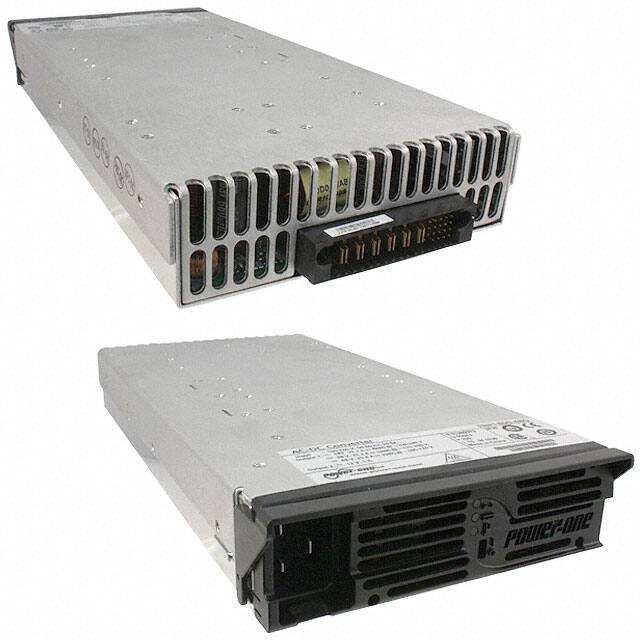

The FNP1500/1800 front-ends are power-factorcorrected (PFC) which (depending on model type) provide a 12 VDC or 48 VDC (1500 or 1800 watt) output, and can be used in hot-swap redundant systems. Their very small dimensions allow configuration of up to three units in a 1U rack. The FNP front-ends have a front-mounted AC receptacle. The highly efficient thermal design with internal-fan cooling permits their use over wide temperature ranges and provides very high reliability.  RoHS compliant for all six substances  High density front-ends 15.2 to 18.3 W/in3  Wide input voltage range 85 to 264 VAC  12 V standby voltage, 1A per front-end  Highly efficient topology reduces operating costs  I2C interface status and control  I2C voltage and current limit setting  Analog output voltage setting  Overtemperature, output overvoltage, and output Status information is provided with front panel LEDs, logic signals, and via an I2C management interface. In addition, the I2C bus can enable the power supply, set high fan speed, adjust the output voltage, and set the output current limit. The FNP1500/1800's meet international safety standards and display the CE-Mark for the European Low Voltage Directive (LVD). FNR-3-12G and FNR-3-48G power-shelf solutions provide rectification, system management, and power distribution, while maintaining high reliability and offering flexibility for future expansion. The power shelves can be configured with up to three hot-swappable 1500 or 1800-watt AC-DC frontends. overcurrent protection  ORing circuits for true redundant operation: Vo1: ORing FETs; Vo2: ORing Diodes  Status LEDs: AC OK, DC OK, and Fan Fail/Overtemperature Fail     Telecom Datacom Servers Distributed power systems North America +1-866.513.2839 Asia-Pacific +86.755.29885888 Europe, Middle East +353 61 225 977 tech.support@psbel.com © 2015 Bel Power Solutions, Inc. BCD.00247_AB1 FNP1500/FNP1800 MODEL FNP1500-12G 3 FNP1500-48G FNP1800-48G INPUT VOLTAGE VAC AUTO SELECTED 1 108 – 264 85 – 105 105 – 264 85 – 105 180 – 264 105 – 180 85 – 105 OUTPUT 1 OUTPUT 2 Vo1 nom Io1 max Vo2 nom Io2 max VDC 12 12 48 48 48 48 48 ADC 129 @ 11.64V 101.8 @ 11.78A 32.2 25.4 39.2 32.2 25.4 VDC 12 12 12 12 12 12 12 ADC 1 1 1 1 1 1 1 RATED POWER W 1512 1212 1512 1212 1812 1512 1212 COMPATIBLE SHELF 2 FNR-3-12G FNR-3-48G FNR-3-48G 1 The available output power is automatically adjusted depending on the input voltage. 1U standard racks are available from Bel Power Solutions. See the Rack (Power Shelf) section of this data sheet for configurations and details. 3 Not recommended for new design. 2 Stress in excess of the absolute maximum ratings may cause performance degradation, adversely affect long-term reliability, or cause permanent damage to the converter. PARAMETER Input Voltage Operating Ambient Temperature Storage Temperature CONDITIONS / DESCRIPTION Continuous Transient, 60 ms max. Vi min-Vi max, Io nom, cooling by internal fan @ 100 % load @ 50 % load Non-Operating MIN MAX 264 300 UNIT VAC VAC 0 0 -40 50 70 85 °C °C °C MIN NOM MAX UNIT 85 230 264 VAC 47 50/60 Specification is valid for input voltage, load, and temperature ranges, unless otherwise stated. PARAMETER CONDITIONS / DESCRIPTION Input Voltage Input Frequency 63 Hz Turn-On Input Voltage Ramping up 79 85 VAC Turn-Off Input Voltage Ramping down 70 78 VAC Inrush Current Limitation 115/230 VAC acc. ETS 300 132-1 < 100 ms Hold-Up Time After last AC line peak ,Vi = 230 VAC, Po nom Power Factor Vi nom, Io nom 0.95 Efficiency Vi = 230 VAC, Io nom, TC = 25 °C 89 1 50 20 Max Input Current Input Connector 1 Apk ms W/VA 90 % 20 Arms 16A – 20 A / 250 VAC; according to IEC320 C19 87% for FNP1500-12 866.513.2839 tech.support@psbel.com © 2015 Bel Power Solutions, Inc. BCD.00247_AB FNP1500/FNP1800 Specification is valid for input voltage, load, and temperature ranges, unless otherwise stated. PARAMETER CONDITIONS / DESCRIPTION Nominal Output Voltage Io = 64.5 A Vi = 230 VAC, Io1 = 65.5 A, TC = 25 °C Output Voltage Set Point Accuracy MIN Nominal Current Output 2 (Factory setting) Adjustable via I2C (Vo1 set) Adjustable via Margin pin (R input) Io1 nom @ Vi =108 VAC – 264 VAC, Po 1.5 kW Io1 nom @ Vi = 85 VAC – 105 VAC, Po 1.2 kW Io1 max @ Vi = 108 VAC – 264 VAC droop hiccup Io1 max @ Vi = 85 VAC – 105 VAC droop hiccup Io2 nom @ Vi = 85 VAC – 265 VAC, Po 12 W Current Limit Output 2 Io2 max @ Vi = 85 VAC – 265 VAC Static Line Regulation Output 1 Vi min - Vi max, 50 % Io nom, Ta = 25 °C Vi = 230 V, 5 - 100 % Io nom Full load to no load [0..129 A] at Vo set = 12V Output Voltage Trimming Nominal Current Output 1 Current Limit Output 1 Static Load Regulation Output 1 (Droop Characteristic) Static Load Regulation Output 2 (Droop Characteristic) 11.93 -0.42 7 6.2 NOM 12 12 12 MAX 12.05 +0.42 13 1 Vo1 set 129.0 101.8 147.4 120.2 1.0 129.0 1.0 1.5 dVo1 over the setting range [7 to 13V] -0.5 11.64 -0.36 Full load to no load @ Vi = 85 VAC – 265 VAC VDC VDC % Vo1 nom VDC VDC ADC ADC ADC ADC ADC ADC 0.5 - 5.58 12 UNITS 12.36 +0.36 0.4 % Vo nom mV/A VDC VDC VDC Load change 50 % 100 % Io nom, dIo/dt =1A/s Voltage deviation (droop + over- or undershoot) Dynamic Load Regulation Current Share Start-Up Time Output Voltage Ripple and Noise (Filter 10nf/10µf) Remote Sense -2 Max. recovery time to within 1% of Vo1 nom Difference in current between two units for Vo1 above 10 % load. Time required for output within regulation after initial application of AC-input (Vi nom, Io nom) after removal of inhibit (Vi nom, Io nom) Vi nom, Io nom, 20 MHz bandwidth Vo1 Vo2 Total compensation for cable losses 2 % Vo nom 400 s 12.9 ADC 1.5 s ms 120 120 500 mVpp mVpp mV 100 866.513.2839 tech.support@psbel.com © 2015 Bel Power Solutions, Inc. BCD.00247_AB FNP1500/FNP1800 Specification is valid for input voltage, load, and temperature ranges, unless otherwise stated. PARAMETER CONDITIONS / DESCRIPTION MIN NOM MAX UNITS Nominal output voltage Vo1 Io = 16.1 A 48 VDC Nominal output voltage Vo2 Io = 0.5 A Vi = 230 VAC, Io1 =16.1 A, TC = 25 °C 12 VDC Output voltage set point accuracy Output voltage trimming (via I2C or with external resistor) (47.8 - 48.2 VDC) Adjustable (44.16 to 51.84 VDC) Nominal current output 2 Io1 nom @ Vi =105 VAC – 264 VAC, Io1 nom @ Vi = 85 VAC – 105 VAC, Io1 nom @ Vi =180 VAC – 264 VAC, Io1 nom @ Vi =105 VAC – 180 VAC, Io1 nom @ Vi = 85 VAC – 105 VAC, Io1 max @ Vi = 105 VAC – 264 VAC Io1 max @ Vi = 85 VAC – 105 VAC Io1 max @ Vi = 180 VAC – 264 VAC Io1 max @ Vi = 105 VAC – 180 VAC Io1 max @ Vi = 85 VAC – 105 VAC Io2 nom @ Vi = 85 VAC – 264 VAC, Current limit output 2 Io2 max @ Vi = 85 VAC – 264 VAC Static line regulation output 1 Vi min - Vi max, 50 % Io nom Vi = 230 V, 5-100 % Io nom Vo : full load (32.2 ADC) to no load Vi = 230 V, 5-100 % Io nom Vo : full load (32.2 ADC) to no load Vi = 230 V, 5-100 % Io nom Vo : full load (32.2 ADC) to no load Load change 50 % 100 % Io nom, dIo/dt =1 A/s FNP1500-48G Nominal current output 1 FNP1800-48G FNP1500-48G Current limit output 1 FNP1800-48G Static load regulation output 1 (droop characteristic) FNP1500-48G FNP1800-48G Static load regulation output 2 (droop characteristic) -0.5 +0.5 % Vo1 nom -8 +8 % Vo1 nom Po 1.5 kW Po 1.2 kW Po 1.8 kW Po 1.5 kW Po 1.2 kW 32.2 25.4 39.2 32.2 25.4 36.8 30 43.8 36.8 30 1.0 droop hiccup droop hiccup droop hiccup droop hiccup droop hiccup Po 12 W 39.2 1.0 1.5 -0.5 46.54 45.91 ADC 0.5 90.1 48 90.1 48 ADC ADC ADC ADC ADC ADC ADC ADC ADC ADC ADC 49.44 49.44 0.4 % Vo nom mV/A VDC mV/A VDC VDC % Vo nom Voltage deviation (droop + over- or undershoot) Dynamic load regulation FNP1500-48G -5 5 % Vo nom FNP1800-48G -5.7 5.7 % Vo nom 400 s 3.2 ADC 3.9 ADC 1.5 s ms 480 120 500 mVpp mVpp mV MAX UNIT All models Current Share Max. recovery time to within 1 % of Vo1 nom Difference in current between two units for Vo1 above 10 % load. FNP1500-48G FNP1800-48G Start-up time Output voltage ripple and noise (Filter 10 nF/10 µF) Remote sense PARAMETER Input fuse Time required for output within regulation after initial application of AC-input (Vi nom, Io nom) after removal of inhibit (Vi nom, Io nom) Vi nom, Io nom, 20 MHz bandwidth 100 Vo1 Vo2 Total compensation for cable losses CONDITIONS/DESCRIPTION MIN 25A, fast blow Tracking Absolute for 48V models Absolute for 12V models Automatic power shutdown at TC No-load -, short circuit - and overload proof 122 % Vo nom 115 59.5 V 16.85 V 95 °C Inrush current limitation With NTCs Output Overvoltage protection latching1 Overtemperature protection 1 NOM Not user accessible Remove input voltage to reset. 866.513.2839 tech.support@psbel.com © 2015 Bel Power Solutions, Inc. BCD.00247_AB FNP1500/FNP1800 Specification is valid for input voltage, load, and temperature ranges, unless otherwise stated. PARAMETER CONDITIONS / DESCRIPTION Status Indication LEDs: DC OK (green), AC OK (green); fan fail and overtemperature (amber) I2C Digital Bus Monitors alarm functions and sets parameters PS Present Pin Contact closure to logic ground ( internal pull-down resistor of 1 kΩ) PS Remote Shutdown / Inhibit Pin Power Supply OK (I2C)1 DC Current Fail (I2C)1 AC Fail / Power Down Warning (I2C & OC)2 DC fail / Output Voltage Fault (I2C & OC)2 Temperature Warning (I2C & OC)2 DC Voltage Monitoring (I2C)1 DC Current Monitoring (I2C)1 DC Voltage Trimming (I2C or external resistor)1 Fan speed control (I2C)1 Fan OK (I2C & OC)2 Synch. Startup Pin 1 2 TTL compatible signal, inhibited when open contact, high or at TTL logic “1”. Signal referenced to logic return (LRTN) AC OK & DC OK & no overcurrent & no overtemperature & fans working Overcurrent on Io1 Provides a warning that the input power has failed at least 5 ms before the output falls out of regulation ( 110% of Vo1 set, measured in front of the ORing FETs. A green LED on the front panel indicates normal operation. The LED will flash if in parallel operation Vo1 is OK, but the unit is disabled. I2C critical temperature warning: Indicates that the operating temperature has reached [Tshut-down – 10K] I2C & OC overtemperature warning: Indicates if the unit is in overtemperature shutdown. Open collector signal with 20 mA pull-down capability, referenced to logic return (LRTN). The OC-output will go low 100 ms before an overtemperature condition shuts down the unit. An amber LED on the front panel indicates overtemperature or fan fail. Monitors the voltage Vo1 at the output connector. Accuracy ± 0.45 V over setting range, temperature and load. Monitors the output current Io1 : Accuracy ± 0.4A over the load range. Output voltage trimming Vo1: ± 8 % of Vo set Setting accuracy over I2C: ± 50mV at Vo nom, ± 150 mV over setting range Two fan speed levels automatically set depending on the internal temperature. The fan speed can be set to full speed or automatic control. Indicates if the fans are operating or have failed. Overcurrent signal which can be used for synchronous startup of units in parallel or to recover from an overload condition. (See application note). Detailed I2C information is available from the model’s I2C Manual found on the Bel Power Solutions web site. Provided over the I2C interface and as an open collector signal on the output connector (OC). PARAMETER Altitude Relative Humidity, Non-Condensing CONDITIONS / DESCRIPTION Operating Non-Operating Operating MIN Storage Temperature Coefficient 0 °C to 70 °C (after 15 min warm-up) Shock IEC/EN 60068-2-27, 11 ms IEC/EN 60068-2-6 2-8 Hz 8-200 Hz 200-500 Hz 10-2000 Hz Calculated per Bellcore (SR-332, Issue 1): GB 25 °C GB 25 °C (FNP1500-12G) Demonstrated Sinusoidal Vibration Random Vibration MTBF NOM 10 MAX 10 k 40 k 90 UNIT ASL Ft. ASL Ft. % RH 5 95 % RH 0.02 %/K 40 gpk 7.5 2 4 6.15 230 TBD 250 mil gpk gpk grms kh kh kh 866.513.2839 tech.support@psbel.com © 2015 Bel Power Solutions, Inc. BCD.00247_AB FNP1500/FNP1800 Maximum electric strength testing is performed in the factory according to EN 550116, IEC/EN 60950, and UL 60950. Input-to-output electric strength tests should not be repeated in the field. Bel Power Solutions will not honor any warranty claims resulting from electric strength field tests. PARAMETER Agency Approvals Insulation Safety Rating Electric Strength Test Voltage 1 CONDITIONS / DESCRIPTION UL60950, (UL) CSA 60950 (cUL), EN 60950(TÜV), CE Mark for LVD Input to case Input to output Output to case Input to case Input to output Output to case Output 1 to output 2 MIN NOM MAX UNIT Basic Reinforced Functional 2121 4242 1 500 100 VDC Subassemblies are pre-tested with 4.2 kVDC in accordance with EN50116 and IEC/EN60950. PARAMETER DESCRIPTION Electrostatic Discharge IEC/EN 61000-4-2, level 4 Electromagnetic Field IEC/EN 61000-4-3, level 3 Performance criterion A Electrical Fast Transients/Burst IEC/EN 61000-4-4, level 3 Performance criterion B Surge IEC/EN 61000-4-5, level 3 Performance criterion B Voltage Dips and Interruptions IEC/EN 61000-4-11 RF Conducted Immunity IEC/EN 61000-4-6 Emissions Conducted CISPR 22/EN 55022/EN 61204 Performance criterion B or better 10 VAC, AM 80 %, 1 kHz Performance criterion A Class B Emissions Radiated CISPR 22/EN 55022/EN 61204 Class A Harmonics IEC/EN 61000-3-2 Class B Voltage Fluctuation and Flicker IEC/EN 61000-3-3 Pass Voltage Sag SEMI F47-0200 (High Line 230V) Pass OUTPUT CONNECTOR DESCRIPTION PIN LOCATION Overtemperature / Fan Fail U1 AC Fail / Power down warning U2 Power Supply Present U3 DC Fail / Output voltage fault U4 Internal ground U5 ADDR0, I2C address bus T1 ADDR1, I2C address bus T2 ADDR2, I2C address bus T3 ADDR3, I2C address bus T4 ADDR4, I2C address bus T5 CRITERION Performance criterion B TYPE OC-output, protected by 16 V Zener diode and a 10 Ω resistor in series, referenced to logic GND OC-output, protected by 16 V Zener diode and a 10 Ω resistor in series, referenced to logic GND Resistor (1 kΩ) connected to logic GND OC-output, protected by 16 V Zener diode and a 10 Ω resistor in series, referenced to logic GND Internal ground (Vo1– line before the output filter). Do not connect the internal grounds in systems with several units. DIP switch or wire to internal ground, Internally pull up to 5V (10 kΩ). DIP switch or wire to internal ground, Internally pull up to 5V (10 kΩ). DIP switch or wire to internal ground, Internally pull up to 5V (10 kΩ). DIP switch or wire to internal ground, Internally pull up to 5V (10 kΩ). DIP switch or wire to internal ground, Internally pull up to 5V (10 kΩ). LOW LEVEL HIGH LEVEL < 0.4 V @ 20 mA Pull up < 0.4 V @ 20 mA Pull up Open Pull up < 0.4 V @ 20 mA Pull up VMAX IMAX 15 V 20 mA 15 V 20 mA 10 V 10 mA 15 V 20 mA Switch closed Switch open Switch closed Switch open Switch closed Switch open Switch closed Switch open Switch closed Switch open 5V 5V 5V 5V 5V 866.513.2839 tech.support@psbel.com © 2015 Bel Power Solutions, Inc. BCD.00247_AB FNP1500/FNP1800 DATA, I2C data line S1 CLOCK, I2C clock line S2 Vo2 + output S3 Vo2 – output S4 Logic ground S5 Output inhibit R1 V sense + R2 V sense - R3 12V model I2C compatible signal referenced to logic GND I2C compatible signal referenced to logic GND Auxiliary power pin, insulated from main output PS active when pulled low (DC-DC stage off when left open) Referenced to logic GND Open or connected to Vo1+ at the load (Internally connected to Vo1+ over 100 Ω) Open or connected to Vo1- at the load (Internally connected to Vo1- over 100 Ω) Open or connected over resistor to internal ground. Do not connect the margin pins in systems with several units. Open or connected to internal ground (+8 % Vo1) or V sense+ (-8 % Vo1) Do not connect the margin pins in systems with several units. Open or connected to synch startup circuit, referenced to Vo1 - at the output connector Open or connected to synch startup circuit, referenced to Vo1 - at the output connector Output margin R4 12V model Synch. startup 48V models R5 Vo1 + output 12V model Vo1 – output 12V model R5 P2, P4, P6, P8, P10, P12 P1, P3, P5, P7, P9, P11 Vo1 + output 48V models Vo1 – output 48V models P1, P3, P5 Main output – pins Power Supply is inhibited Input AC is low Input AC is low or missing 10 V 3.5 mA dU < 3 Vpp 30 mA dU < 3 Vpp 30 mA 3 VDC 60 VDC 12V 3mA 12V 2mA Main output – pins Main output + pins Normal Operation < 0.8 V > 2.0 V Main output + pins P2, P4, P6 CONDITION 5 V or 3.3 V logic Auxiliary ground pin, insulated from main output Internally connected over 10 Ω to Auxiliary GND. Wire separately form Auxiliary - and main output GND to minimize noise on signals and I2C. Leave open if not used. R4 48V models 5 V or 3.3 V logic POWER FAIL (AC OK) Green OUTPUT GOOD (DC OK) Green FAN FAIL AND OVER - TEMPERATURE OFF Green OFF Amber OFF OFF Amber OFF OFF Amber/OFF Over-temperature Green OFF Amber Output overload (In regulation) Green Green OFF Output Overloaded (Out of Regulation) Green OFF OFF Fan Fault (No overtemperature shutdown) Green Green Amber Fan Fault (With overtemperature shutdown) Green OFF Amber OFF OFF OFF/ Amber Power Supply Failed AC OK DC OK Fan fail / OT Enable Switch 866.513.2839 tech.support@psbel.com © 2015 Bel Power Solutions, Inc. BCD.00247_AB FNP1500/FNP1800 Mechanical Data (H x W x D): 5.6” (141.2mm) x 1.6” (40.5mm) x 11” (279.4mm) FNP1500/1800 12V Model Output Connector Descriptions Rear View Female Connector: FCI (51732-026 LF) Mates with: 90° output connector type: 180° output connector type: Part No. FCI (manufacturer): 51762-11202000AA LF Part No. FCI (manufacturer): 51742-11202000AA LF Locate information on availability of FCI connectors at http://www.stkcheck.com/evs/fcielectronics/fcisearch.asp IEC AC power cord with C19 connector VDE 16A: Interpower Components Ltd. 70009110250 IEC AC power cord with C19 connector UL 20A: Interpower Components Ltd. 70025110250 866.513.2839 tech.support@psbel.com © 2015 Bel Power Solutions, Inc. BCD.00247_AB FNP1500/FNP1800 Mechanical Data (H x W x D): 5.6” (141.2mm) x 1.6” (40.5mm) x 11” (279.4mm) FNP1500/1800 48V Model Output Connector Descriptions Rear View Female Connector: FCI (51732-020 LF) Mates with: 90° output connector type: 180° output connector type: Part No. FCI (manufacturer): 51762-10602000AA LF; Bel Power Solutions Part No.: ZES258-G Part No. FCI (manufacturer): 51742-10602000AA LF Locate information on availability of FCI connectors at http://www.stkcheck.com/evs/fcielectronics/fcisearch.asp IEC AC power cord with C19 connector VDE 16A: Interpower Components Ltd. 70009110250 IEC AC power cord with C19 connector UL 20A: Interpower Components Ltd. 70025110250 866.513.2839 tech.support@psbel.com © 2015 Bel Power Solutions, Inc. BCD.00247_AB FNP1500/FNP1800 For parallel use in minimal configuration systems, only the inhibit pins must be shorted to logic GND. All other pins can be left open. The power supplies will share the output current automatically (droop current share). For parallel applications without I2C bus, but the use of all other features, it is recommended to connect all logic GND’s on a backplane together, to connect all Vo2 -, all V o2 + and to leave the internal GND’s open. The sense wires can be left open or connected to a common load point, the synch-start pin can be left open or connected to a synch-start circuit, the inhibit pins can be connected together or used individually. All I2C signals (T1-T5, S1, and S2) can be left open. Use of a small foil capacitor > 3µF directly at the power outputs of each unit is recommended in order to prevent voltage drops at the hot plug. For additional information on paralleling see the following Rack (Power Shelf) section. To achieve best cooling results sufficient airflow through the unit must be ensured. Do not block or obstruct the airflow at the rear of the unit by placing large components directly at the output connector. 866.513.2839 tech.support@psbel.com © 2015 Bel Power Solutions, Inc. BCD.00247_AB FNP1500/FNP1800 Each rack (power shelf) is 1U high with backplane and designed for up to three front-end models in parallel or in n+1 operation. Each power shelf has:  Massive copper bus bars for low-loss current distribution.  Output terminals with two M4-screws on each power tab.  Two fast-on contacts for system earthing.  Address coding over five pole DIP switch on each unit, 37-pin D-Sub connector with I2C-lines, monitoring signals and support functions.  Provides a start-up synchronization circuit and EMV filters. FNR-3-12G and FNR-3-48G Power Shelf Front View Overall Mechanical Dimensions (W x H x D): 17.7” (449.6 mm) x 1.7” (43.1 mm) x 13” (330.2 mm) 866.513.2839 tech.support@psbel.com © 2015 Bel Power Solutions, Inc. BCD.00247_AB FNP1500/FNP1800 A B C D E F G H I LOCATION DESCRIPTION A 5-Bit DIP switch for I2C addressing of PSU 1 B Earth connection C Earth connection D Earth connection E Output 1 minus F Output 1 plus G 5-Bit DIP switch for I2C addressing of PSU 2 H 37-pin SUB-D connector, controlling and auxiliary power (output 2) I 5-Bit DIP switch for I2C addressing of PSU 3 PIN LOCATION TYPE Overtemperature / Fan Fail PSU1 1 OC-output, protected by 16 V Zener diode and a 10 Ω resistor in series, referenced to logic GND Power Supply Present PSU 1 2 Resistor (1 kΩ) connected to logic GND Power Supply Present PSU 2 3 Resistor (1 kΩ) connected to logic GND Open 4 Overtemperature / Fan Fail PSU 3 5 AC Fail / Power down warning PSU 3 6 Power Supply Present PSU 3 7 DC Fail / Output voltage fault PSU 3 8 Overtemperature / Fan Fail PSU 2 9 Synch._Start_A 10 Open 11 OUTPUT CONNECTOR DESCRIPTION OC-output, protected by 16 V Zener diode and a 10 Ω resistor in series, referenced to logic GND OC-output, protected by 16 V Zener diode and a 10 Ω resistor in series, referenced to logic GND Resistor (1 kΩ) connected to logic GND OC-output, protected by 16 V Zener diode and a 10 Ω resistor in series, referenced to logic GND OC-output, protected by 16 V Zener diode and a 10 Ω resistor in series, referenced to logic GND Sync_start_A , Active high The signals of several racks can be connected together in such a way that all supplies will be inhibited until the last supply has recovered from its overcurrent condition, referenced to logic GND LOW LEVEL HIGH LEVEL
