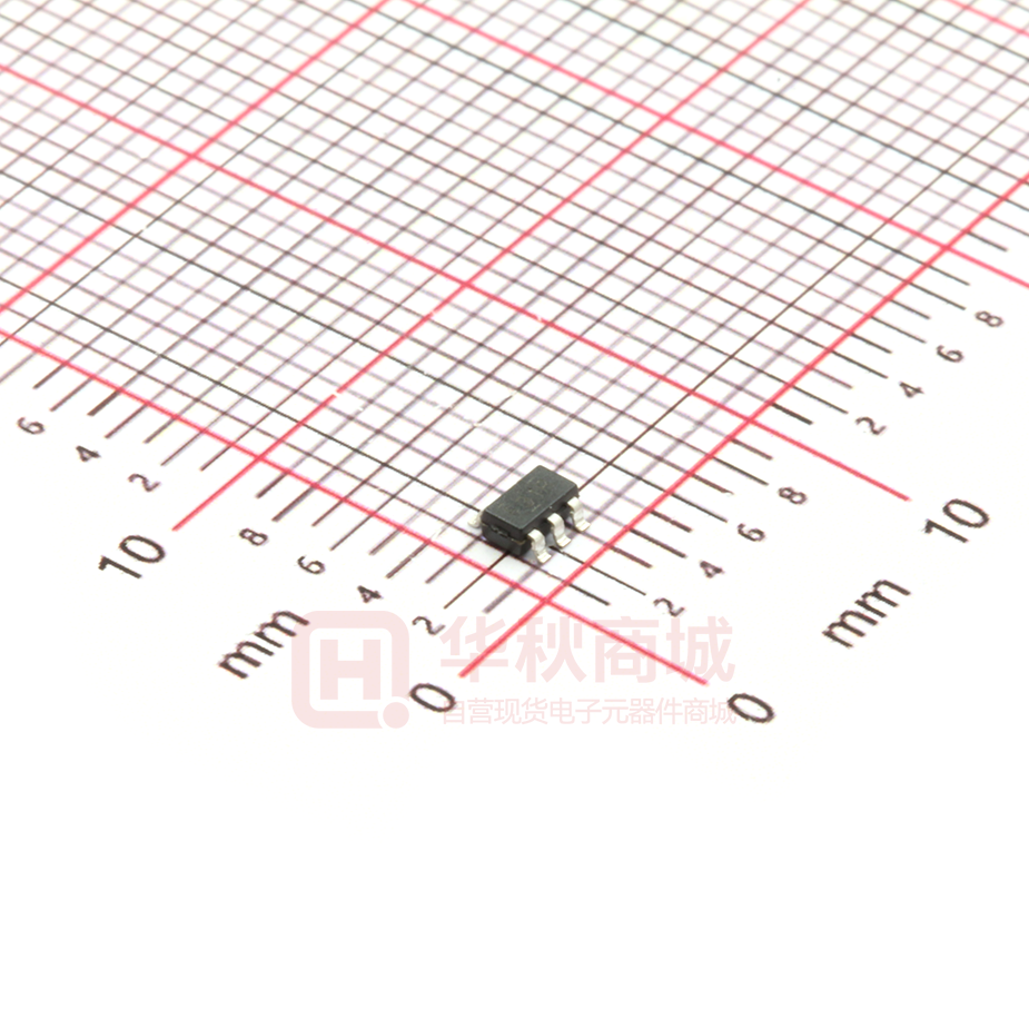

BL8568 500mA High PSRR, Linear Regulator, w. Output Discharge DESCRIPTION FEATURES BL8568 series is a group of positive voltage output, low power consumption, low dropout voltage regulator.  Output voltage range: 1.0V~4.5V (customized on command every 0.1V step)  Low power consumption: 35uA (Typ.)  Low output noise (47uVRMS)  Shutdown mode: 0.1uA  Low dropout voltage: 300mV@300mA (Typ.)  High ripple rejection:70dB@1KHz (Typ.)  Low temperature coefficient: ±100ppm/C  Excellent line regulation: 0.05%/V  Build-in 1.5K discharge resistor when CE low  Highly accurate: ±2%  Output current limit  Fold-back output short circuit protection BL8568 can provide output value in the range of 1.0V~4.5V every 0.1V step. It also can be customized on command. BL8568 can also work under a wide input voltage ranging from 2.0V to 6V. BL8568 includes high accuracy voltage reference, error amplifier, current limit circuit and output driver module. BL8568 has excellent load and line transient response and good temperature characteristics, which can assure the stability of chip and power system. And it uses trimming technique to guarantee output voltage accuracy within ±2%. APPLICATIONS    BL8568 is available in SOT-23-3, SOT-23-5, SC-70-5 and DFN1x1-4 packages which is lead free.   TYPICAL APPLICATION ELECTRICAL CHARACTERISTICS Vout Vin Vin 1uF CE BL8568 LC1476 Vss Vout 1uF CE NOTE: Input capacitor (Cin=1uF) and Output capacitor (Cout=1uF) are recommended in all application circuit. www.belling.com.cn Power source for cellular phones and various kind of PCSs Battery Powered equipment Power Management of MP3, PDA, DSC, Mouse, PS2 Games Voltage Reference Regulation after Switching Power 1 BL8568 ORDERING INFORMATION BL8568 □ 1 □ 2 □ 3 □ 4 Code PIN CONFIGURATION Product Classification Description Temperature&Rohs: C:-40~85C ,Pb Free Rohs Std. Package type: A5:SC-70-5 B3:SOT-23-3 B5A:SOT-23-5 KE:DFN1x1-4 Packing type: TR:Tape&Reel (Standard) Output voltage: e.g. 15=1.5V 18=1.8V 44=4.4V 1 □ 2 □ 3 □ 4 □ : Product Code X: Output Voltage ZZ: Date Code Product Classification X: Output Voltage ZZ: Date Code MARKING DESCRIPTON : Product Code Vout 1.0V 0 1.1V Code Vout Code 2.3V 3 3.6V 6 1 2.4V 4 3.7V 7 1.2V 2 2.5V 5 3.8V 8 1.3V 3 2.6V 6 3.9V 9 1.4V 4 2.7V 7 4.0V 0 1.5V 5 2.8V 8 4.1V 1 1.6V 6 2.9V 9 4.2V 2 1.7V 7 3.0V 0 4.3V 3 1.8V 8 3.1V 1 4.4V 4 1.9V 9 3.2V 2 4.5V 5 2.0V 0 3.3V 3 2.1V 1 3.4V 4 2.2V 2 3.5V 5 X: Output Voltage ZZ: Date Code Product Classification BL8568CKETR□ □ XX: Output Voltage Vss Vin Vout CE NC XX: Output Voltage (for DFN1X1-4).”18”stands for 1.8V,”28” stands for 2.8V,and “2 8 ” stands for 2.85V. Z: The Year of manufacturing,”1” stands for year 2011,”2” stands for year 2012, and ”8” stands for year 2018. Z: The week of manufacturing. ”A” stands for week 1,”Z” stands for week 26,” A ” stands for week 27,” Z ” stands for week 52. www.belling.com.cn BL8568CB5ATR□ □ : Product Code X: Output Voltage Code (for SC70-5, SOT23-3, SOT23-5) Code BL8568CB3TR□ □ F: Product Code Product Classification Vout BL8568CA5TR□□ 2 Ground Pin Supply Voltage Input Output Voltage Chip Enable No Connection BL8568 ABSOLUTE MAXIMUM RATING Parameter Value Max Input Voltage Operating Junction Temperature(Tj) Output Current Ambient Temperature(Ta) SC70-5 SOT-23-3 Power Dissipation SOT-23-5 DFN1x1-4 Storage Temperature(Ts) Lead Temperature & Time 8V 125C 500mA -40C –85C 250mW 250mW 250mW 600mW -40C -150C 260C,10S Note: Heat Sink Area of PCB for DFN1x1-4 is recommended at least 2.5mmx4mm. Exceed these limits to damage to the device. Exposure to absolute maximum rating conditions may affect device reliability. RECOMMENDED WORK CONDITIONS Item Min Recommended Max. Unit Input Voltage Range 2 6 V Ambient Temperature* -40 85 C *The operation ambient temperature range is verified on several test samples. Not a test condition for volume production whose test is only performed under 25C. ELECTRICAL CHARACTERISTICS (Test Conditions: Cin=1uF,Cout=1uF,TA=25C, unless otherwise specified. ) BL8568, For Arbitrary Output Voltage Symbol Parameter Vin Input Voltage Output Voltage Vout Iout (Max.) Vdrop Vout>1.5V Vout
