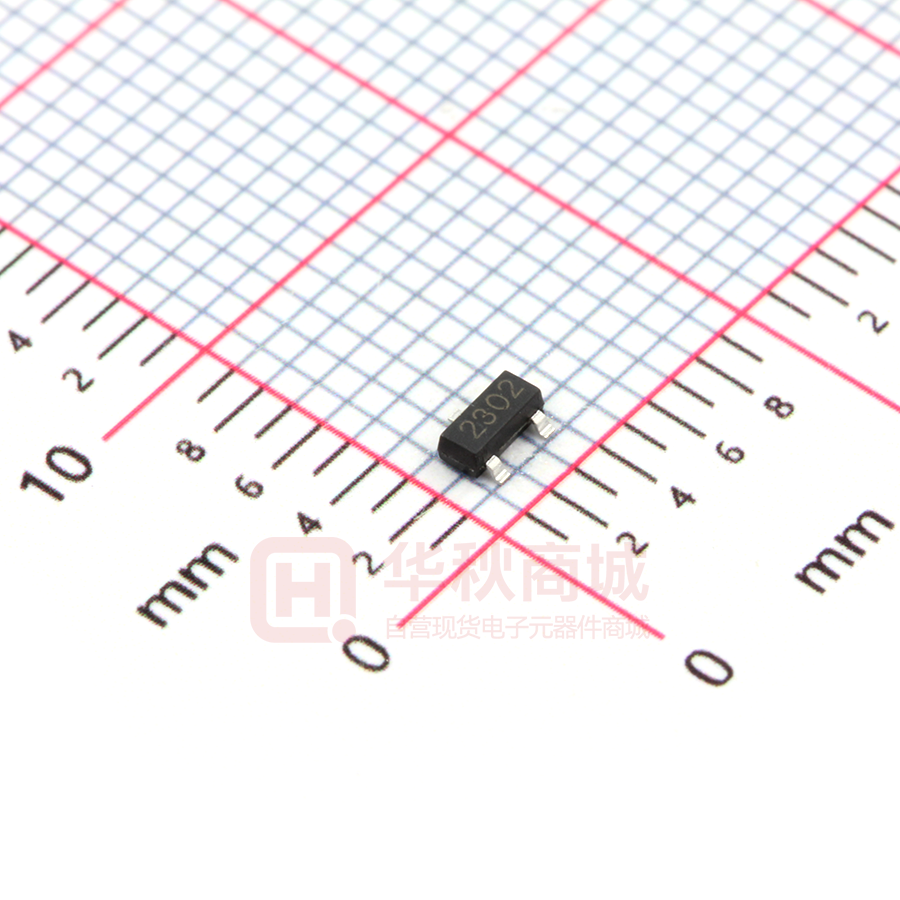

    N沟道增强型功率MOSFET SOT23 VGS=±10V VDS=20V,ID=2.9A
BLM2302 数据手册
Pb Free Product BLM2302 N-Channel Enhancement Mode Power MOSFET DESCRIPTION D The BLM2302 uses advanced trench technology to provide excellent RDS(ON), low gate charge and operation with gate G voltages as low as 2.5V. This device is suitable for use as a Battery protection or in other Switching application. S GENERAL FEATURES Schematic diagram ● VDS = 20V,ID = 2.9A 3 RDS(ON) < 59mΩ @ VGS=2.5V D 2302 RDS(ON) < 45mΩ @ VGS=4.5V ● High Power and current handing capability G 1 ● Lead free product is acquired ● Surface Mount Package 2 S Marking and pin Assignment Application ●Battery protection ●Load switch ●Power management SOT-23 top view Package Marking And Ordering Information Device Marking Device Device Package Reel Size Tape width Quantity 2302 BLM2302 SOT-23 Ø180mm 8 mm 3000 units Absolute Maximum Ratings (TA=25℃unless otherwise noted) Parameter Symbol Drain-Source Voltage VDS Gate-Source Voltage VGS Drain Current-Continuous ID Drain Current-Pulsed (Note 1) IDM Maximum Power Dissipation PD Operating Junction and Storage Temperature Range TJ,TSTG Limit Unit 20 V ±10 V 2.9 A 10 A 1 W -55 To 150 ℃ 125 ℃/W Thermal Characteristic Thermal Resistance,Junction-to-Ambient (Note 2) RθJA Electrical Characteristics (TA=25℃unless otherwise noted) Parameter Symbol Condition Min Typ Max Unit Off Characteristics Drain-Source Breakdown Voltage BVDSS VGS=0V ID=250μA 20 22 - V Zero Gate Voltage Drain Current IDSS VDS=20V,VGS=0V - - 1 μA Page1 www.belling.com.cn V2.0 Pb Free Product BLM2302 Gate-Body Leakage Current IGSS VGS=±10V,VDS=0V - - ±100 nA Gate Threshold Voltage VGS(th) VDS=VGS,ID=250μA 0.5 0.75 1.2 V Drain-Source On-State Resistance RDS(ON) VGS=2.5V, ID=2.5A - 37 59 mΩ VGS=4.5V, ID=2.9A - 30 45 mΩ VDS=5V,ID=2.9A - 8 - S - 300 - PF - 120 - PF - 80 - PF - 10 15 nS On Characteristics (Note 3) Forward Transconductance gFS Dynamic Characteristics (Note4) Input Capacitance Clss Output Capacitance Coss Reverse Transfer Capacitance Crss VDS=10V,VGS=0V, F=1.0MHz Switching Characteristics (Note 4) Turn-on Delay Time td(on) Turn-on Rise Time tr VDD=10V,ID=2.9A - 50 85 nS td(off) VGS=4.5V,RGEN=6Ω - 17 45 nS - 10 20 nS - 4.0 10 nC - 0.65 - nC - 1.2 - nC - 0.75 1.2 V - - 2.9 A Turn-Off Delay Time Turn-Off Fall Time tf Total Gate Charge Qg Gate-Source Charge Qgs Gate-Drain Charge Qgd VDS=10V,ID=2.9A, VGS=4.5V Drain-Source Diode Characteristics Diode Forward Voltage (Note 3) VSD Diode Forward Current (Note 2) IS VGS=0V,IS=2.9A Notes: 1. Repetitive Rating: Pulse width limited by maximum junction temperature. 2. Surface Mounted on FR4 Board, t ≤ 10 sec. 3. Pulse Test: Pulse Width ≤ 300μs, Duty Cycle ≤ 2%. 4. Guaranteed by design, not subject to production Page2 www.belling.com.cn V2.0 Pb Free Product BLM2302 TYPICAL ELECTRICAL AND THERMAL CHARACTERISTICS Vdd Vgs Rgen td(on) Rl Vin D ton tr td(off) 90% Vout VOUT G toff tf 90% INVERTED 10% 10% 90% S VIN 50% 50% 10% PULSE WIDTH Figure 2:Switching Waveforms PD Power(W) ID- Drain Current (A) Figure 1:Switching Test Circuit TJ-Junction Temperature(℃) TJ-Junction Temperature(℃) Figure 4 Drain Current ID- Drain Current (A) Rdson On-Resistance(mΩ ) Figure 3 Power Dissipation Vds Drain-Source Voltage (V) ID- Drain Current (A) Figure 5 Output CHARACTERISTICS Page3 Figure 6 Drain-Source On-Resistance www.belling.com.cn V2.0 Pb Free Product ID- Drain Current (A) Normalized On-Resistance BLM2302 Vgs Gate-Source Voltage (V) TJ-Junction Temperature(℃) Figure 8 Drain-Source On-Resistance C Capacitance (pF) Rdson On-Resistance(mΩ ) Figure 7 Transfer Characteristics Vgs Gate-Source Voltage (V) Vds Drain-Source Voltage (V) Figure 10 Capacitance vs Vds Vgs Gate-Source Voltage (V) Is- Reverse Drain Current (A) Figure 9 Rdson vs Vgs Qg Gate Charge (nC) Figure 11 Gate Charge Page4 Vsd Source-Drain Voltage (V) Figure 12 Source- Drain Diode Forward www.belling.com.cn V2.0 Pb Free Product ID- Drain Current (A) BLM2302 Vds Drain-Source Voltage (V) Safe Operation Area r(t),Normalized Effective Transient Thermal Impedance Figure 13 Square Wave Pluse Duration(sec) Figure 14 Normalized Maximum Transient Thermal Impedance Page5 www.belling.com.cn V2.0 Pb Free Product BLM2302 SOT-23 PACKAGE INFORMATION Dimensions in Millimeters (UNIT:mm) Symbol A A1 A2 b c D E E1 e e1 L L1 θ Dimensions in Millimeters MIN. MAX. 0.900 1.150 0.000 0.100 0.900 1.050 0.300 0.500 0.080 0.150 2.800 3.000 1.200 1.400 2.250 2.550 0.950TYP 1.800 2.000 0.550REF 0.300 0.500 0° 8° NOTES 1. All dimensions are in millimeters. 2. Tolerance ±0.10mm (4 mil) unless otherwise specified 3. Package body sizes exclude mold flash and gate burrs. Mold flash at the non-lead sides should be less than 5 mils. 4. Dimension L is measured in gauge plane. 5. Controlling dimension is millimeter, converted inch dimensions are not necessarily exact. Page6 www.belling.com.cn V2.0
