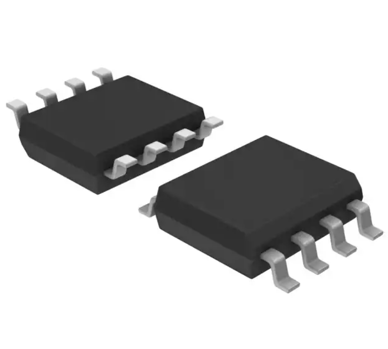

    P沟道 VDS = -30V,ID = -9.1A SOP-8
BLM4435 数据手册
Pb Free Product BLM4435 P-Channel Enhancement Mode Power MOSFET D DESCRIPTION The BLM4435 uses advanced trench technology to provide G excellent RDS(ON), low gate charge and operation with gate voltages as low as 4.5V. S GENERAL FEATURES Schematic diagram ● VDS = -30V,ID = -9.1A RDS(ON) < 35mΩ @ VGS=-4.5V RDS(ON) < 20mΩ @ VGS=-10V ● High Power and current handing capability ● Lead free product is acquired ● Surface Mount Package Marking and pin Assignment Application ●Battery Switch ●Load switch ●Power management SOP-8 top view Package Marking And Ordering Information Device Marking Device Device Package Reel Size Tape width Quantity 4435 BLM4435 SOP-8 Ø330mm 12mm 2500 units Absolute Maximum Ratings (TA=25℃ ℃unless otherwise noted) Parameter Symbol Drain-Source Voltage VDS Gate-Source Voltage VGS Drain Current-Continuous ID Drain Current-Pulsed (Note 1) IDM Maximum Power Dissipation PD Operating Junction and Storage Temperature Range TJ,TSTG Limit Unit -30 V ±20 V -9.1 A -50 A 3.1 W -55 To 150 ℃ 40 ℃/W Thermal Characteristic Thermal Resistance,Junction-to-Ambient (Note 2) RθJA Electrical Characteristics (TA=25℃unless otherwise noted) Parameter Symbol Condition Min Typ Max Unit -30 -33 - V Off Characteristics Drain-Source Breakdown Voltage Page1 BVDSS VGS=0V ID=-250µA www.belling.com.cn V2.0 Pb Free Product BLM4435 Zero Gate Voltage Drain Current IDSS VDS=-30V,VGS=0V - - -1 µA Gate-Body Leakage Current IGSS VGS=±20V,VDS=0V - - ±100 nA Gate Threshold Voltage VGS(th) VDS=VGS,ID=-250µA -1 -1.5 -3 V Drain-Source On-State Resistance RDS(ON) VGS=-10V, ID=-9.1A - 15 20 mΩ VGS=-4.5V, ID=-6.9A - 21 35 mΩ VDS=-15V,ID=-9.1A 10 - - S - 1600 - PF - 350 - PF On Characteristics (Note 3) Forward Transconductance gFS Dynamic Characteristics (Note4) Input Capacitance Clss Output Capacitance Coss Reverse Transfer Capacitance Crss - 300 - PF Turn-on Delay Time td(on) - 10 - nS Turn-on Rise Time tr VDD=-15V, ID=-1A, - 15 - nS td(off) VGS=-10V,RGEN=6Ω - 110 - nS 70 - nS - 30 - nC - 5.5 - nC - 8 - nC - - -1.2 V VDS=-15V,VGS=0V, F=1.0MHz Switching Characteristics (Note 4) Turn-Off Delay Time Turn-Off Fall Time tf Total Gate Charge Qg Gate-Source Charge Qgs Gate-Drain Charge Qgd VDS=-15V,ID=-9.1A VGS=-10V Drain-Source Diode Characteristics Diode Forward Voltage (Note 3) VSD VGS=0V,IS=-2.1A Notes: 1. Repetitive Rating: Pulse width limited by maximum junction temperature. 2. Surface Mounted on FR4 Board, t ≤ 10 sec. 3. Pulse Test: Pulse Width ≤ 300µs, Duty Cycle ≤ 2%. 4. Guaranteed by design, not subject to production Page2 www.belling.com.cn V2.0 Pb Free Product BLM4435 TYPICAL ELECTRICAL AND THERMAL CHARACTERISTICS ton tr td(on) toff tf td(off) 90% VOUT 90% INVERTED 10% 10% 90% VIN 50% 50% 10% PULSE WIDTH Figure 2:Switching Waveforms PD Power(W) ID- Drain Current (A) Figure 1:Switching Test Circuit TJ-Junction Temperature(℃) TJ-Junction Temperature(℃) Figure 4 Drain Current ID- Drain Current (A) Rdson On-Resistance(Ω) Figure 3 Power Dissipation Vds Drain-Source Voltage (V) ID- Drain Current (A) Figure 5 Output CHARACTERISTICS Page3 Figure 6 Drain-Source On-Resistance www.belling.com.cn V2.0 Pb Free Product ID- Drain Current (A) Normalized On-Resistance BLM4435 Vgs Gate-Source Voltage (V) TJ-Junction Temperature(℃) Figure 8 Drain-Source On-Resistance C Capacitance (pF) Rdson On-Resistance(Ω) Figure 7 Transfer Characteristics Vgs Gate-Source Voltage (V) Vds Drain-Source Voltage (V) Figure 10 Capacitance vs Vds Vgs Gate-Source Voltage (V) Is- Reverse Drain Current (A) Figure 9 Rdson vs Vgs Qg Gate Charge (nC) Figure 11 Gate Charge Page4 Vsd Source-Drain Voltage (V) Figure 12 Source- Drain Diode Forward www.belling.com.cn V2.0 Pb Free Product ID- Drain Current (A) BLM4435 Vds Drain-Source Voltage (V) Safe Operation Area r(t),Normalized Effective Transient Thermal Impedance Figure 13 Square Wave Pluse Duration(sec) Figure 14 Normalized Maximum Transient Thermal Impedance Page5 www.belling.com.cn V2.0 Pb Free Product BLM4435 SOP-8 PACKAGE IN FORMATION Page6 www.belling.com.cn V2.0
