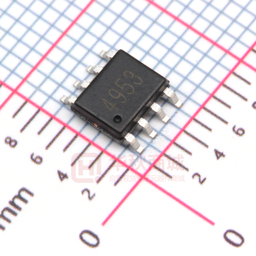

    SOP-8
    P沟道增强型功率MOSFET SOP8 VGS=±12V VDS=30V,ID=5.1A
BLM4953 数据手册
Pb Free Product BLM4953 P-Channel Enhancement Mode Power MOSFET DESCRIPTION D1 The BLM4953 uses advanced trench technology to prov ide excellent RDS(ON), low gate charge and operation with gate D2 G1 G2 voltages as low as 4.5V. This device is suitable for use as a load switch or in PWM applications. S1 S2 Schematic diagram GENERAL FEATURES ● VDS = -30V,ID = -5.1A RDS(ON) < 105mΩ @ VGS=-4.5V RDS(ON) < 55mΩ @ VGS=-10V ● High Power and current handing capability ● Lead free product is acquired Marking and pin Assignment ● Surface Mount Package Application ●PWM applications ●Load switch SOP-8 top view ●Power management Package Marking And Ordering Information Device Marking 4953 Device Device Package Reel Size Tape width BLM4953 SOP-8 Ø330mm 12mm Absolute Maximum Ratings (TA=25℃ ℃unless otherwise noted) Parameter Symbol Drain-Source Voltage VDS Gate-Source Voltage VGS Drain Current-Continuous ID Drain Current-Pulsed (Note 1) IDM Maximum Power Dissipation PD Operating Junction and Storage Temperature Range TJ,TSTG Quantity 2500 units Limit Unit -30 V ±20 V -5.1 A -20 A 2.5 W -55 To 150 ℃ 50 ℃/W Thermal Characteristic Thermal Resistance,Junction-to-Ambient (Note 2) Page1 RθJA www.belling.com.cn V2.0 Pb Free Product BLM4953 Electrical Characteristics (TA=25℃unless otherwise noted) Parameter Symbol Condition Min Typ Max Unit Off Characteristics Drain-Source Breakdown Voltage BVDSS VGS=0V ID=-250µA -30 -33 - V Zero Gate Voltage Drain Current IDSS VDS=-24V,VGS=0V - - -1 µA Gate-Body Leakage Current IGSS VGS=±20V,VDS=0V - - ±100 nA Gate Threshold Voltage VGS(th) VDS=VGS,ID=-250µA -1 -1.6 -3 V Drain-Source On-State Resistance RDS(ON) VGS=-10V, ID=-5.1A - 48 55 mΩ VGS=-4.5V, ID=-4.2A - 73 105 mΩ VDS=-15V,ID=-4.5A 4 7 - S - 520 - PF - 130 - PF On Characteristics (Note 3) Forward Transconductance gFS Dynamic Characteristics (Note4) Input Capacitance Clss Output Capacitance Coss Reverse Transfer Capacitance Crss - 70 - PF Turn-on Delay Time td(on) - 15 - nS Turn-on Rise Time tr VDD=-15V, ID=-1A, - 13 - nS td(off) VGS=-10V,RGEN=6Ω - 58 - nS VDS=-15V,VGS=0V, F=1.0MHz Switching Characteristics (Note 4) Turn-Off Delay Time Turn-Off Fall Time tf - 21 - nS Total Gate Charge Qg - 12 - nC Gate-Source Charge Qgs - 2.2 - nC Gate-Drain Charge Qgd - 3 - nC - - -1.2 V VDS=-15V,ID=-5.3A,VGS=-10V Drain-Source Diode Characteristics Diode Forward Voltage (Note 3) VSD VGS=0V,IS=-1.7A Notes: 1. Repetitive Rating: Pulse width limited by maximum junction temperature. 2. Surface Mounted on FR4 Board, t ≤ 10 sec. 3. Pulse Test: Pulse Width ≤ 300µs, Duty Cycle ≤ 2%. 4. Guaranteed by design, not subject to production Page2 www.belling.com.cn V2.0 Pb Free Product BLM4953 TYPICAL ELECTRICAL AND THERMAL CHARACTERISTICS ton tr td(on) toff tf td(off) 90% VOUT 90% INVERTED 10% 10% 90% VIN 50% 50% 10% PULSE WIDTH Figure 2:Switching Waveforms PD Power(W) ID- Drain Current (A) Figure 1:Switching Test Circuit TJ-Junction Temperature(℃) TJ-Junction Temperature(℃) Figure 4 Drain Current ID- Drain Current (A) Rdson On-Resistance(mΩ) Figure 3 Power Dissipation Vds Drain-Source Voltage (V) ID- Drain Current (A) Figure 5 Output CHARACTERISTICS Page3 Figure 6 Drain-Source On-Resistance www.belling.com.cn V2.0 Pb Free Product ID- Drain Current (A) Normalized On-Resistance BLM4953 Vgs Gate-Source Voltage (V) TJ-Junction Temperature(℃) Figure 8 Drain-Source On-Resistance C Capacitance (pF) Rdson On-Resistance(mΩ) Figure 7 Transfer Characteristics Vgs Gate-Source Voltage (V) Vds Drain-Source Voltage (V) Figure 10 Capacitance vs Vds Vgs Gate-Source Voltage (V) Is- Reverse Drain Current (A) Figure 9 Rdson vs Vgs Qg Gate Charge (nC) Figure 11 Gate Charge Page4 Vsd Source-Drain Voltage (V) Figure 12 Source- Drain Diode Forward www.belling.com.cn V2.0 Pb Free Product ID- Drain Current (A) BLM4953 Vds Drain-Source Voltage (V) Safe Operation Area r(t),Normalized Effective Transient Thermal Impedance Figure 13 Square Wave Pluse Duration(sec) Figure 14 Normalized Maximum Transient Thermal Impedance Page5 www.belling.com.cn V2.0 Pb Free Product BLM4953 SOP-8 PACKAGE IN FORMATION Page6 www.belling.com.cn V2.0
