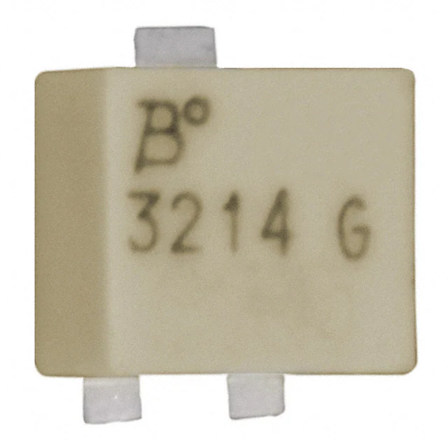

    可调电阻/电位器 100Ω ±10% 250mW SMD ±100ppm/℃
3214G-1-101E 数据手册
Features n Surface Mount 4 mm Square / Multiturn Cermet / Industrial / Sealed n Halogen free** with date code 114 n Sealed to withstand board wash processing n Pick and place centering design, with flush adjustment 100 3214W 811C Electrical Characteristics Standard Resistance Range ...........................10 ohms to 2 megohms (see standard resistance table) Resistance Tolerance................ ±10 % std. Absolute Minimum Resistance ....... 1 % or 2.0 ohms (whichever is greater) Contact Resistance Variation ................................ 3 % or 3 ohms max. Resolution...................... Essentially Infinite Insulation Resistance.................... 500 vdc. 100 megohms min. Dielectric Strength Sea Level................... 600 vac (1 minute) Adjustment Angle....................5 turns nom. Environmental Characteristics Power Rating (300 volts max.) 85 °C......................................... 0.25 watt 150 °C............................................ 0 watt Temperature Range........ -65 °C to +150 °C Temperature Coefficient........ ±100 ppm/°C Seal Test.......85 °C Fluorinert†/60 seconds Humidity............ MIL-STD 202 Method 106 TRS ±2 %; IR 10 megohms Vibration...........20 G TRS±1 %; VRS ±1 % Shock.............100 G TRS ±1 %; VRS±1 % Load Life ............@ 85 °C rated power 1,000 hours TRS 3 ohms or 3 % (whichever is greater Rotational Cycling......................200 cycles TRS 3 ohms or 3 % (whichever is greater) Thermal Shock...............................5 cycles TRS ±2 %; VRS ±1 % Moisture Sensitivity Level......................1 ESD Classification.................................2 Physical Characteristics Mechanical Stop....................... Wiper idles Torque..................................180 g-cm max. Weight.................... Approximately 0.01 oz. Marking...................... Manufacturer’s code, resistance code and date code Solderability....................Per MIL-STD-202, Method 208 Wiper.................... 50 % (Actual TR) ±10 % Flammability................................... UL94V0 Pushover Strength J, G.............................................. 4.4 lbs. W, X................................................... 1 lb. Adjustment Tool...................................H-91 MM DIMENSIONS: (INCHES) 0.25 TOLERANCES: ± EXCEPT WHERE NOTED (.010) 2 CCW 3 1 CLOCKWISE WARNING Cancer and Reproductive Harm www.P65Warnings.ca.gov CW SMD standard trimmer footprint n RoHS compliant* - see processing information on RoHS compliant surface mount trimmers n For trimmer applications/processing guidelines, click here 3214 - 5-Turn Trimpot® Trimming Potentiometer Product Dimensions 3214J Side Adjust 1.5 DIA. (.060) 1.2 (.047) 3214G Side Adjust 1.5 DIA. (.060) 1 2 1 2 1.2 (.047) 4.8 (.190) 4.8 (.190) 2.6 (.102) 3 2.4 (.095) 5.0 (.195) ADJUSTMENT SLOT 0.6 WIDE (.022) 0.5 DEEP X (.020) 2.0 (.079) 1.3 2 PLCS. (.050) 1.0 (.039) 2 PLCS. 2.3 (.090) 1.3 (.050) 0.5 (.020) 3 1.3 (.050) 5.1 (.200) 1.2 (.047) 2.5 (.100) 0.5 TYP. (.02) 1.3 (.050) 0.5 (.020) 1.3 2.3 (.050) (.090) 2 PLCS. 0.8 2 PLCS (.032) 0.9 (.034) 2 PLCS. 0.2 (.007) 1 1.3 2 PLCS. (.050) 2.9 (.114) 5.3 (.208) ADJUSTMENT SLOT 0.6 WIDE (.022) X 0.7 (.028) 4.8 (.190) 1.2 (.047) 3 1.0 3 PLCS. (.040) ADJUSTMENT SLOT 0.6 WIDE (.022) 0.5 DEEP X (.020) 1.3 (.050) 2 1.5 DIA. (.060) 2.6 (.102) .0.5 DEEP (.020) 1.0 3 PLCS. (.040) 3.9 (.155) 5.3 (.208) 5.7 (.225) 1.3 2 PLCS. (.050) 0.8 (.032) 0.2 .008 5.1 (.200) 2.0 (.079) 0.2 (.008) 1.9 TYP. (.075) 2.5 (.100) 2.5 (.100) 5.1 (.200) 3.5 (.139) 4.8 (.190) 2 2.0 (.079) 0.13 (.005) 3214X Top Adjust 3.5 (.139) 1 3.9 (.152) 5.2 (.205) 2.0 (.079) 3214W Top Adjust 3.9 (.155) 4.6 (.180) 1.3 3 PLCS. (.050) 0.9 (.034) 2 PLCS. 0.2 (.007) 2.3 (.090) 6.0 (.236) 0.8 (.032) 1.14 (.045) (.157) 3 ADJUSTMENT SLOT 0.6 WIDE (.022) 0.5 DEEP X (.020) 3.71 (.146) 2.0 3 PLCS (.079) 4.0 2.4 (.095) 2.7 (.108) 2.3 (.090) 4.6 (.180) 0.2 (.007) 1.6 3 PLCS. (.061) WIPER n 4 mm design meets EIA/EIAJ/IPC/VECI 0.8 2 PLCS. (.032) 2.5 (.100) DIMENSIONS: MM (INCHES) 0.8 2 PLCS. (.032) * RoHS Directive 2015/863, Mar. 31, 2015 and Annex ** Bourns follows the prevailing definition of “halogen free” in the industry. Bourns considers a product to be “halogen free” if (a) the Bromine (Br ) content is 900 ppm or less; (b) the Chlorine ( Cl ) content is 900 ppm or less; and (c) the total Bromine (Br) and Chlorine (Cl) content is 1500 ppm or less. “Trimpot” is a trademark of Bourns, Inc. †“Fluorinert” is a registered trademark of 3M Co. Specifications are subject to change without notice. Users should verify actual device performance in their specific applications. The products described herein and this document are subject to specific legal disclaimers as set forth on the last page of this document, and at www.bourns.com/docs/legal/disclaimer.pdf. ® 3214 -- 5-Turn Trimming Potentiometer 3312 2 mm Trimpot SMD Trimming Potentiometer Packaging Specifications J & G Styles .04 MAX. (.002) 4.5 MAX. (.177) W Style X Style 6.09 MAX. (.240) 5.52 ± .05 (.217 ± .002) 5.55 ± .10 (J) (.219 ± .004) 6.25 ± .10 (G) (.246 ± .004) 1.5 + .10/ –.00 DIA. (.059 + .004/ –.000) 4.00 ± .20 (.157 ± .008) 1.5 + .10/ –.00 DIA. (.059 + .004/ –.000) 4.90 ± .10 (.193 ± .004) 5.10 ± .10 (.201 ± .004) 12.00 ± .30 (.472 ± .012) 1.78 ± .25 EQUAL SPACED 3 PLCS. (.070 ± .010) 13.0 ± .51 DIA. (.512 ± .020) 4.00 (.157) 1.75 ± .10 (.069 ± .004) TAPE 16.0 ± 0.30 (.630 ± .012) How To Order 2.67 ± .25 (.105 ± .010) 59.18 ± 2.03 (2.330 ± .080) 16.4 + 1.81/ -.000 (.646 ± .070/ -.000) 330.2 ± 2.0 DIA.** (13.00 ± .008) REEL 12.4 + 2.01/ -.000 (.488 + .079/ -.000) REEL * Embossed Tape Designator "E" **Embossed Tape Designator "G" (See How To Order chart for further information.) Cover tape peel strength: Meets EIA specification 481. * Embossed Tape Designator "E" **Embossed Tape Designator "G" (See How To Order chart for further information.) 8.6 (.339) TAPE 3214 J - 1 - 502 E Standard or Modified Product Indicator -1 = IR Reflow (standard) †-2 = Wave Solderable -FW5 = .070” ± .010” Shaft Extension Resistance Code Embossed Tape Designator E = Style J, G: 500 pcs./7 ” reel (standard) Style W: 250 pcs./7 ” reel (standard) Style X: 200 pcs./7 ” reel (standard) G = Style J, G: 1500 pcs./13 ” reel (standard) Style W: 1000 pcs./13 ” reel (standard) Style X: 850 pcs./13 ” reel (standard) G = Style J, G: 1500 pcs./13 ” reel (FW5) Style W, X: 600 pcs./13 ” reel (FW5) Consult factory for other available options. † -2 has a treated stainless steel shaft Tape and reel material meets Antistatic ANSI/ ESD 5541-2003 packaging standards. Cover tape peel strength: Meets EIA specification 481. Standard Resistance Table Resistance Resistance (Ohms) Code 10 100 20 200 50 500 100 101 200 201 500 501 1,000 102 2,000 202 12.00 (.472) 1.75 (.069) 16.00 ± .30 (.630 ± .012) Model Style 178 ± 2.0 DIA.* (7.00 ± .008) 6.70 (.264) 12.00 ± .10 (.472 ± .004) W & X Style Reel 21.01 ± .79 DIA. (.827 ± .031) 1.5 + .10/ –.00 DIA. (.059 + .004/ –.000) 2.00 (.079) 8.00 ± .10 (.315 ± .004) TAPE 7.50 (.295) 4.05 ± .12 (.159 ± .005) 2.00 ± .05 (.079 ± .002) 1.75 ± .10 (.069 ± .004) .35 MAX (.014) 7.50 ± .05 (.295 ± .002) 4.00 ± .20 (.157 ± .008) 2.00 ± .05 (.079 ± .002) 6.35 (.250) MAX. .05 MAX. (.002) Resistance Resistance (Ohms) Code 5,000 502 10,000 103 20,000 203 50,000 503 100,000 104 200,000 204 500,000 504 1,000,000 105 2,000,000 205 Popular distribution values listed in boldface. Special resistances available. Specifications are subject to change without notice. Users should verify actual device performance in their specific applications. The products described herein and this document are subject to specific legal disclaimers as set forth on the last page of this document, and at www.bourns.com/docs/legal/disclaimer.pdf. REV. 08/19 Legal Disclaimer Notice This legal disclaimer applies to purchasers and users of Bourns® products manufactured by or on behalf of Bourns, Inc. and P[ZHɉSPH[LZJVSSLJ[P]LS`¸)V\YUZ¹ Unless otherwise expressly indicated in writing, Bourns® products and data sheets relating thereto are subject to change ^P[OV\[UV[PJL
