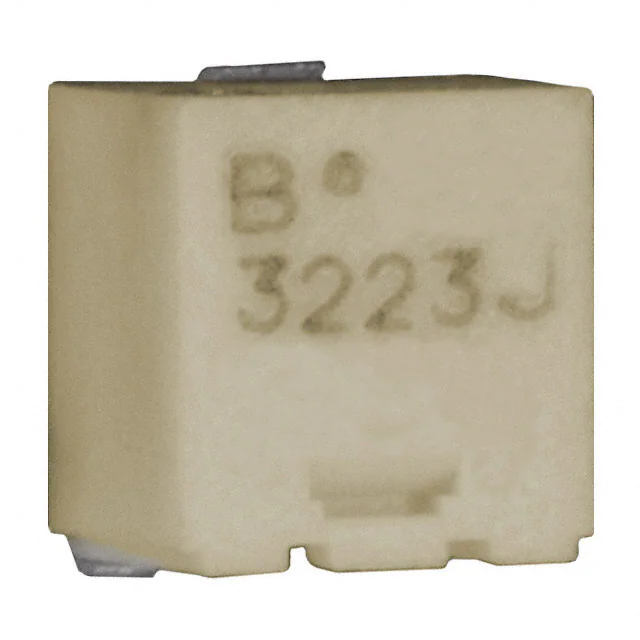

    可调电阻/电位器 100Ω ±20% 125mW SMD-3P,4x4mm ±100ppm/℃
3223J-1-101E 数据手册
Features n Surface Mount 3 mm Square / Multiturn Cermet / Industrial / Sealed n Sealed to withstand standard board wash processing n Pick and place centering design for automated placement compatibility n Flush adjustment screw 839C 100 W 3223 - 3 mm SMD Trimpot® Trimming Potentiometer Product Dimensions 2.77 (.109) ELECTRICAL ADJUSTMENT SLOT ELECTRICAL ADJUSTMENT SLOT 0.38 0.30 0.38 0.30 WIDE X WIDE XDEEP DEEP (0.014) (0.014)(0.011) (0.011) 0.77 0.99 0.77 0.99 (.030) (.039) 2.77(.030) (.039) (.109) 100 3223J 100 3223J 3 0.78 4.47 (.031)(.176) 4.47 0.88 (.176)(.035) 1.4 (.055) 2 PLCS. 2 PLCS. 0.94.4 0.9 1.4 (.035) (.035) (.173) (.055) 2.8 (.110) 2.8 (.110) C C 836 100 3223W 836 DIMENSIONS: TOLERANCES: CCW 4.34 (.171) 1.00 1.00 (.039) (.039) 2 PLCS. 2 PLCS. 1.00 1.00 3.43 (.039) (.039) (.135) 2 PLCS. 2 PLCS. LEAD LEAD FOOTPRINT FOOTPRINT REF. REF. MM (INCHES) WIPER 3 CW CLOCKWISE 3223 W - 1 - 502 E Model Style Standard Product Indicator -1 = IR Reflow (Standard) Resistance Code Embossed Tape Designator E = 500 pcs./7 ” Reel (Standard) Tape and reel material meets Antistatic ANSI/ ESD 5541-2003 packaging standards. WARNING Cancer and Reproductive Harm www.P65Warnings.ca.gov *RoHS Directive 2015/863, Mar 31, 2015 and Annex. †“Fluorinert” is a registered trademark of 3M Co. 1.25 (.049) 1.3 1.3 (.051) (.051) 2.0 2.0 (.079) (.079) 1 How To Order 4.34 (.171) 5.32 1.25 (.209) (.049) 0.25 EXCEPT WHERE NOTED (.010) 2 (0.014) (0.014)(0.011) (0.011) RECOMMENDED LAND PATTERN RECOMMENDED LAND PATTERN 4.4 (.173) 2.0 (.079) 2.0 (.079) 1 0.76 0.76 Mechanical Stop................... Wiper idles 2.44 2.44 (.030) (.030) Torque............................. 2.50 oz-in. max (.096) (.096) REF. REF. Weight................ Approximately 0.01 oz. 0.13 0.13 1.27 1.27 (.005) (.005) Marking Manufacturer’s code, (.050) (.050) resistance code and date code 2.79 2.79 Solderability................Per MIL-STD-202, (.110) (.110) 1.27 1.27 0.76 0.76 Method 208 (.050) (.050) 0.89 (.030) (.030) 0.89 Wiper................ 50 % (Actual TR) ±10 % 1.55 1.55 2 PLCS. 2 PLCS. (.035) (.035) 3.43 Flammability..............................UL94V-02 PLCS. 2 PLCS. (.061) (.061) (.135) Adjustment Tool........................... H-92-1 1.25 5.32 (.049) (.209) 0.13 (.005) RECOMMENDED LAND PATTERN RECOMMENDED LAND PATTERN 3 100 3223W Physical Characteristics 0.3 (.012) 1.25 0.56 (.049) (.022) 0.3 (.012) 0.56 (.022) 4.0 (.158) 4.0 (.158) 0.13 (.005) 0.88 (.035) Power Rating (200 volts max.) RECOMMENDED LAND PATTERN RECOMMENDED LAND PATTERN 70 °C................................... 0.125 watt 2 PLCS. 2 PLCS. 0.94.0 0.9 4.0 150 °C........................................ 0 watt 1.4 1.4 (.035) (.035) (.157) (.157) LEAD LEAD (.055) (.055) Temperature Range.... -65 °C to +150 °C FOOTPRINT FOOTPRINT REF. REF. Temperature Coefficient.... ±100 ppm/°C 2.8 2.8 Seal Test...85 °C Fluorinert†/60 seconds (.110) (.110) 1.3 1.3 Humidity........MIL-STD-202 Method 106 (.051) (.051) 1.6 1.6 1.6 1.6 TRS ±3 %; IR 10 megohms (.063) (.063)(.063) (.063) Vibration......20 G TRS ±1 %; VRS ±1 % Shock........100 G TRS ±1 %; VRS ±1 % Load Life Top Adjust 2.31 2.31 3223W3223W Top Adjust (.090) (.090) .........@ 70 °C rated power 1000 hours 3.96 3.96 1.96 1.96 CRV.............................. 4 ohms or 4 % (.156) (.156) (.077) (.077) (whichever is greater) 3 Rotational Cycling..................200 cycles 4.0 4.0 CRV.............................. 4 ohms or 4 % (.158) (.158) 2 2 (whichever is greater) 1 0.98 0.98 Thermal Shock...........................5 cycles 2.76 2.76 (.039) (.039)3.18 3.18 ELECTRICAL ELECTRICAL (.125) (.125) TRS ±2 %; VRS ±2 % (.109) (.109) ADJUSTMENT SLOT ADJUSTMENT SLOT 0.56 0.56 0.38 0.30 0.38 0.30 ESD Classification.................................2 PLCS. 2 PLCS. (.022) WIDE X WIDE XDEEP 2 DEEP (.022) C 3 836 1 2 C 1 2 836 0.78 (.031) 0.56 (.022) 3.96 (.156) 3.96 (.156) 3.18 (.125) 3.18 (.125) C C 0.56 (.022) Environmental Characteristics Side Adjust 3223G3223G Side Adjust 836 836 Standard Resistance Range Side Adjust Side Adjust .......................10 ohms to 2 megohms 3223J3223J 0.40 3.960.40 3.96 3.18 3.18 (see standard resistance table) (.016) (.016) (.156) (.156) (.125) (.125) Resistance Tolerance............ ±20 % std. 1 1 Absolute Minimum Resistance ............................ 1 % or 3 ohms max. 2 2 4.0 4.0 (.158) (.158) (whichever is greater) 3 3 Contact Resistance Variation ............................ 3 % or 3 ohms max. ELECTRICAL ADJUSTMENT SLOT ELECTRICAL ADJUSTMENT SLOT 0.38 0.30 0.38 0.30 WIDE X WIDE XDEEP (whichever is greater) DEEP (0.014) (0.014)(0.011) (0.011) Resolution.................. Essentially infinite 2.77 2.77 0.72 0.72 0.62 0.62 (.109) Insulation Resistance................500 VDC (.109) (.028) (.028) (.024) (.024) 0.13 0.13 100 megohms min. (.005) (.005) Dielectric Strength Sea Level.............. 600 VAC (1 minute) 0.99 0.3 0.99 0.3 Adjustment Angle..............11 turns nom. (.039) (.039) (.012) (.012) 100 3223G Electrical Characteristics 100 3223G 3223 n Meets EIA/EIAJ/IPC/VECI SMD standard trimmer footprint n Top and side adjust n RoHS compliant* - see processing information on RoHS compliant surface mount trimmers n For trimmer applications/processing guidelines, click here Specifications are subject to change without notice. Users should verify actual device performance in their specific applications. The products described herein and this document are subject to specific legal disclaimers as set forth on the last page of this document, and at www.bourns.com/docs/legal/disclaimer.pdf. 1.75 ± .10 (.069 ± .004) M 100 3223G 236 1.5 + .10/ –.00 (.059 + .004/ –.000) DIA. 4) 1.5 MIN. (.059) 2.00 ± .05 (.079 ± .002) 5 ± .10 ± .004) 4.00 ± .10 (.157 ± .004) 4.26 ± .10 (.168 ± .004) 3223 - 3 mm SMD Trimpot® Trimming Potentiometer 4.75 MAX. (.187) 4.5 ± 0.1 .04 (.177 ± .004) MAX. (.002) 12.00 ± .30 (.472 ± .012) 4.05 MAX. (.159) 1.75 ± .10 (.069 ± .004) 5.5 ± .05 (.217 ± .002) 4.42 ± 0.1 (.174 ± .004) 12.00 ± .30 1.5 + .10/ –.00 (.472 ± .012) (.059 + .004/ –.000) DIA. 1.75 ± .10 5.5 ± .05 (.217 ± .002) 1.5 MIN. (.059) (.069 ± .004) 2.00 ± .05 (.079 ± .002) 1.5 MIN. (.059) 3.85 ± .10 (.152 ± .004) 2.00 ± .05 (.079 ± .002) 8.00 ± .10 (.315 ± .004) 8.00 ± .10 (.315 ± .004) 8.00 ± .10 (.315 ± .004) 3.85 ± .10 (.152 ± .004) TAPE 1.78 ± .25 EQUAL SPACED 3 PLCS. (.070 ± .010) 21.01 ± .79 DIA. (.827 ± .031) 12.00 ± .30 (.472 ± .012) 5.5 ± .05 (.217 ± .002) 1.75 ± .10 178 ± 2.0 DIA. (.069 ± .004) (7.008 ± .079) 1.5 + .10/ –.00 (.059 + .004/ –.000) DIA. 2.67 ± .25 (.105 ± .010) 6.35 MAX. (.250) .04 MAX. (.002) 59.18 ± 2.03 (2.330 ± .080) 4.5 ± 0.1 (.177 ± .004) 4.81 MAX. (.189) 12.4 + 2.01/ -.000 (.488 + .079/ -.000) REEL 1.5 MIN. 2.00 ± .05 (.059) Cover tape peel strength: Meets EIA specification 481. (.079 ± .002) (.069 ± .004) 1.5 + .10/ –.00 (.059 + .004/ –.000) DIA. 1.5 MIN. (.059) 2.00 ± .05 (.079 ± .002) 4.00 ± .10 (.157 ± .004) 13.0 ± .51 DIA. (.512 ± .020) 21.01 ± .79 DIA. (.827 ± .031) 4.05 4.05 MAX. MAX. (.159) (.159) 12.00 ± .30 12.00 ± .30 (.472 ± .012) (.472 ± .012) 1.75 ± .10 1.75 ± .10 (.069 ± .004) (.069 ± .004) 178 ± 2.0 DIA. (7.008 ± .079) 1.5 + .10/ –.00 59.18 ± 2.03 5.3 ± 0.1 4.42 ± 0.1 (2.330 ± .080) (.209 ± .004) (.174 ± .004) 4.75 MAX. (.187) 5.5 ± .05 5.5 ± .05 (.217 ± .002) (.217 ± .002) .04 MAX. (.002) 4.05 MAX. (.159) 12.4 + 2.01/ -.000 (.488 + .079/ -.000) M (.315 ± .004) 12.00 ± .30 (.472 ± .012) 1.5 + .10/ –.00 (.059 + .004/ –.000) DIA. 2.00 ± .05 (.079 ± .002) 4.00 ± .10 (.157 ± .004) REV. 04/20 5.5 ± .05 (.217 ± .002) 1.75 ± .10 (.069 ± .004) M MM 8.00 ± .10 (INCHES)8.00 ± .10 (.315 ± .004) 4.42 ± 0.1 (.174 ± .004) 236 1.5 + .10/ –.00 (.059 + .004/ –.000) (.059 + .004/ –.000) DIA. 1.5 DIA. MIN. 2.00 ± .05 1.5 REEL (.059) MIN. 2.00 ± .05 (.079 ± .002) (.059) (.079 ± .002) 4.00 ± .10 Cover tape peel strength: Meets EIA specification 481. 4.00 ± .10 (.157 ± .004) (.157 ± .004) 4.26 ± .10 DIMENSIONS: 4.26 ± .10 (.168 ± .004) (.168 ± .004) TAPE 5.64 MAX. 4.75 2.67 ± .25 MAX. (.222) (.187)(.105 ± .010) .04 MAX. .04 MAX. (.002) (.002) M 3.85 ± .10 (.152 ± .004) 1.78 ± .25 EQUAL SPACED 3 PLCS. (.070 ± .010) 236 8.00 ± .10 (.315 ± .004) 8.00 ± .10 (.315 ± .004) TAPE 236 4.00 ± .10 (.157 ± .004) 5.5 ± .05 4.26 ± .10 (.168 ± .004) 100 3223G 13.0 ± .51 DIA. (.512 ± .020) (.472 ± .012) Popular values listed in boldface. Consult factory (.217 ± .002) 1.75 ± .10 for special resistances. M 4.26 ± .10 (.168 ± .004) 1.5 MIN. (.059) 1.5 MIN. (.059) Resistance Resistance (Ohms) Code 10 100 20 200 50 500 100 101 200 201 500 501 1,000 102 2,000 2025.64 5,000 502(.222) MAX. 10,000 103 20,000 203 .04 MAX. 50,000 503 (.002) 100,000 104 4.05 MAX. 200,000 204 5.3 ± 0.1 (.159) 500,000 504 (.209 ± .004) 1,000,000 105 2,000,000 205 12.00 ± .30 236 4.00 ± .10 (.157 ± .004) (.472 ± .012) 12.00 ± .30 1.75 ± .10 (.472 ± .012) (.069 ± .004) 1.75 ± .10 (.069 ± .004) 1.5 + .10/ –.00 (.059 + .004/ –.000) 1.5 + .10/ –.00 DIA. (.059 + .004/ –.000) 2.00 ± .05 DIA. (.079 ± .002) 2.00 ± .05 4.00 ± .10 (.079 ± .002) (.157 ± .004) 4.00 ± .10 (.157 ± .004) 4.26 ± .10 (.168 ± .004) M M 8.00 ± .10 (.315 ± .004) 4.05 MAX. (.159) 4.81 MAX. (.189) 12.00 ± .30 236 236 4.00 ± .10 1.5 + .10/ –.00 (.157 ± .004) (.059 + .004/ –.000) DIA. 5.64 MAX. (.222) 6.35 MAX. .04 (.250) MAX. (.002) .04 MAX. (.002) 5.3 ± 0.1 (.209 ± .004) 4.5 ± 0.1 (.177 ± .004) 5.5 ± .05 (.217 ± .002) 5.5 ± .05 (.217 ± .002) 100 3223G 4.81 MAX. (.189) 100 3223J -.000 -.000) Standard Resistance Table .04 MAX. (.002) 100 3223J 8 ± 2.03 0 ± .080) 6.35 MAX. Packaging Specifications (.250) 100 3223G 7 ± .25 ± .010) 100 3223J 8.00 ± .10 (.315 ± .004) 1.5 MIN. (.059) “Trimpot” is 1.78 ± .25 a registeredEQUAL SPACED trademark of Bourns, Inc. 3 PLCS. (.070 ± .010) Specifications are subject to change without notice. 4.26 ± .10 8.00 ± .10 Users should verify actual device performance in their specific applications. 21.01 ± .79 DIA. 13.0 ± .51 (.315 ± .004) The products described and this document are subject to specific legal disclaimers as set forth on the last page of this document, and(.168 ± .004) at www.bourns.com/docs/legal/disclaimer.pdf. DIA. herein(.827 ± .031) (.512 ± .020) 2.67 ± .25 (.105 ± .010) Legal Disclaimer Notice This legal disclaimer applies to purchasers and users of Bourns® products manufactured by or on behalf of Bourns, Inc. and its affiliates (collectively, “Bourns”). Unless otherwise expressly indicated in writing, Bourns® products and data sheets relating thereto are subject to change without notice. Users should check for and obtain the latest relevant information and verify that such information is current and complete before placing orders for Bourns® products. The characteristics and parameters of a Bourns® product set forth in its data sheet are based on laboratory conditions, and statements regarding the suitability of products for certain types of applications are based on Bourns’ knowledge of typical requirements in generic applications. The characteristics and parameters of a Bourns® product in a user application may vary from the data sheet characteristics and parameters due to (i) the combination of the Bourns® product with other components in the user’s application, or (ii) the environment of the user application itself. The characteristics and parameters of a Bourns® product also can and do vary in different applications and actual performance may vary over time. Users should always verify the actual performance of the Bourns® product in their specific devices and applications, and make their own independent judgments regarding the amount of additional test margin to design into their device or application to compensate for differences between laboratory and real world conditions. Unless Bourns has explicitly designated an individual Bourns® product as meeting the requirements of a particular industry standard (e.g., ISO/TS 16949) or a particular qualification (e.g., UL listed or recognized), Bourns is not responsible for any failure of an individual Bourns® product to meet the requirements of such industry standard or particular qualification. Users of Bourns® products are responsible for ensuring compliance with safety-related requirements and standards applicable to their devices or applications. Bourns® products are not recommended, authorized or intended for use in nuclear, lifesaving, life-critical or life-sustaining applications, nor in any other applications where failure or malfunction may result in personal injury, death, or severe property or environmental damage. Unless expressly and specifically approved in writing by two authorized Bourns representatives on a case-by-case basis, use of any Bourns® products in such unauthorized applications might not be safe and thus is at the user’s sole risk. Life-critical applications include devices identified by the U.S. Food and Drug Administration as Class III devices and generally equivalent classifications outside of the United States. Bourns expressly identifies those Bourns® standard products that are suitable for use in automotive applications on such products’ data sheets in the section entitled “Applications.” Unless expressly and specifically approved in writing by two authorized Bourns representatives on a case-by-case basis, use of any other Bourns® standard products in an automotive application might not be safe and thus is not recommended, authorized or intended and is at the user’s sole risk. If Bourns expressly identifies a sub-category of automotive application in the data sheet for its standard products (such as infotainment or lighting), such identification means that Bourns has reviewed its standard product and has determined that if such Bourns® standard product is considered for potential use in automotive applications, it should only be used in such sub-category of automotive applications. Any reference to Bourns® standard product in the data sheet as compliant with the AEC-Q standard or “automotive grade” does not by itself mean that Bourns has approved such product for use in an automotive application. Bourns® standard products are not tested to comply with United States Federal Aviation Administration standards generally or any other generally equivalent governmental organization standard applicable to products designed or manufactured for use in aircraft or space applications. Bourns expressly identifies Bourns® standard products that are suitable for use in aircraft or space applications on such products’ data sheets in the section entitled “Applications.” Unless expressly and specifically approved in writing by two authorized Bourns representatives on a case-by-case basis, use of any other Bourns® standard product in an aircraft or space application might not be safe and thus is not recommended, authorized or intended and is at the user’s sole risk. The use and level of testing applicable to Bourns® custom products shall be negotiated on a case-by-case basis by Bourns and the user for which such Bourns® custom products are specially designed. Absent a written agreement between Bourns and the user regarding the use and level of such testing, the above provisions applicable to Bourns® standard products shall also apply to such Bourns® custom products. Users shall not sell, transfer, export or re-export any Bourns® products or technology for use in activities which involve the design, development, production, use or stockpiling of nuclear, chemical or biological weapons or missiles, nor shall they use Bourns® products or technology in any facility which engages in activities relating to such devices. The foregoing restrictions apply to all uses and applications that violate national or international prohibitions, including embargos or international regulations. Further, Bourns® products and Bourns technology and technical data may not under any circumstance be exported or re-exported to countries subject to international sanctions or embargoes. Bourns® products may not, without prior authorization from Bourns and/or the U.S. Government, be resold, transferred, or re-exported to any party not eligible to receive U.S. commodities, software, and technical data. To the maximum extent permitted by applicable law, Bourns disclaims (i) any and all liability for special, punitive, consequential, incidental or indirect damages or lost revenues or lost profits, and (ii) any and all implied warranties, including implied warranties of fitness for particular purpose, non-infringement and merchantability. For your convenience, copies of this Legal Disclaimer Notice with German, Spanish, Japanese, Traditional Chinese and Simplified Chinese bilingual versions are available at: Web Page: http://www.bourns.com/legal/disclaimers-terms-and-policies PDF: http://www.bourns.com/docs/Legal/disclaimer.pdf C1753 05/17/18R
3223J-1-101E
- 物料型号: 3223W - 器件简介: 3mm方形表面贴装多圈Cermet工业级密封可调电位器,符合EIA/EIAJ/IPC/VECI SMD标准尺寸,RoHS兼容。 - 引脚分配: 文档中提供了详细的引脚布局和调整槽尺寸信息。 - 参数特性: - 标准电阻范围:10欧姆至2兆欧姆 - 电阻公差:±20% - 绝对最小电阻:1%或3欧姆(取较大值) - 接触电阻变化:3%或3欧姆(取较大值) - 分辨率:基本上是无限的 - 绝缘电阻:最小100兆欧,500VDC - 耐压:在海平面600VAC(1分钟) - 调整角度:大约11圈 - 功能详解: 提供了调整机制、电气特性、环境特性、物理特性等详细信息。 - 应用信息: 适用于需要精确调整的工业和商业应用。 - 封装信息: 提供了详细的产品尺寸和推荐的焊盘图案。
