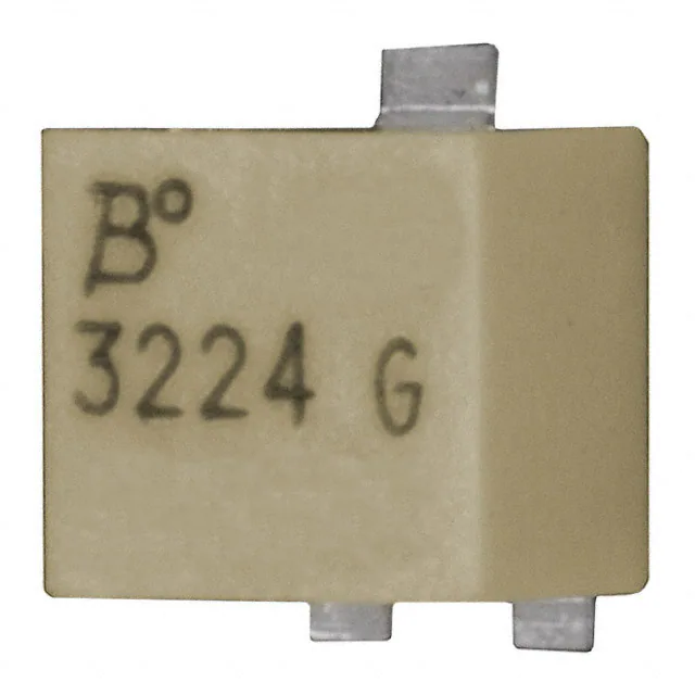

Features n Surface Mount 4 mm Square / Multiturn Cermet / Industrial / Sealed n Halogen free** with date code 114 n Sealed to withstand board wash processing n Pick and place centering design, with flush adjustment 100 3224W 811 C Electrical Characteristics Standard Resistance Range ........................................... 10 to 2 megohm (see standard resistance table) Resistance Tolerance.....................±10 % std. Absolute Min. Resistance......1 % or 2.0 ohms (whichever is greater) Contact Resistance Variation .....................................1 % or 3 ohms max. Resolution...........................Essentially Infinite Insulation Resistance.........................500 vdc. 100 megohms min. Dielectric Strength Sea Level........................ 600 vac (1 minute) Adjustment Angle...................... 12 turns nom. Environmental Characteristics Power Rating (300 volts max.) 85 °C..............................................0.25 watt 150 °C.................................................0 watt Temperature Range.............-65 °C to +150 °C Temperature Coefficient.............±100 ppm/°C Seal Test........... 85 °C Fluorinert†/60 seconds Humidity.................MIL-STD 202 Method 106 TRS ±2 %; IR 10 megohms Vibration............... 20 G TRS±1 %; VRS ±1 % Shock................. 100 G TRS ±1 %; VRS±1 % Load Life..... @ 85 °C rated power 1,000 hours TRS........3 ohms or 3 % (whichever is greater) Rotational Cycling.......................... 200 cycles TRS........3 ohms or 3 % (whichever is greater) Thermal Shock................................... 5 cycles TRS±2 %; VRS±1 % Moisture Sensitivity Level.......................... N/A ESD Classification......................................... 2 Physical Characteristics Mechanical Stop............................Wiper idles Torque...................................... 180 g-cm max. Weight.........................Approximately 0.01 oz. Marking.......................... Manufacturer’s code, resistance code and date code Solderability........................ Per MIL-STD-202, Method 208 Wiper.........................50 % (Actual TR) ±10 % Flammability........................................UL94V0 Pushover Strength J, G...................................................4.4 lbs. W, X.......................................................1 lb. Adjustment Tool....................................... H-91 MM DIMENSIONS: (INCHES) 0.25 TOLERANCES: ± EXCEPT WHERE NOTED (.010) 2 CCW WIPER 1 CW SMD standard trimmer footprint n Low CRV - 1 % n RoHS compliant* - see processing information on RoHS compliant surface mount trimmers n For trimmer applications/processing guidelines, click here 3224 - 4 mm SMD Trimpot® Trimming Potentiometer Product Dimensions 1.5 DIA. (.060) 1.5 DIA. (.060) 1 2 1.2 (.047) 1 2 1.2 (.047) 4.8 (.190) 4.8 (.190) 2.6 (.102) 2.4 (.095) ADJUSTMENT SLOT 0.6 WIDE (.022) X 2.0 3 PLCS (.079) 4.0 3.9 (.155) 2.3 (.090) 1.3 (.050) 5.1 (.200) 1.5 (.060) DIA. 2.6 (.103) ADJUSTMENT SLOT 0.6 WIDE (.022) 0.5 DEEP X (.020) 1.0 3 PLCS. (.040) 5.3 (.208) 0.7 (.028) 0.8 (.032) 2.9 (.114) 1.6 (.061) 3 PLCS. 0.13 (.005) 1.3 3 PLCS. (.050) 0.5 TYP. (.020) 5.2 (.205) 1.3 (.050) 0.5 (.020) 1.3 2.3 (.050) (.090) 2 PLCS. 0.8 2 PLCS (.032) 1 3.5 (.139) 1.3 (.050) 0.9 (.034) 2 PLCS. 0.2 (.007) 2.5 (.100) 5.1 (.200) 4.8 (.190) 2 1.2 (.047) ADJUSTMENT SLOT 0.6 WIDE (.022) 0.5 DEEP X (.020) 3.9 (.155) 1.0 3 PLCS. (.040) 5.3 (.208) 5.7 (.225) 1.3 2 PLCS. (.050) 2.0 (.079) 2.3 (.090) 3.9 (.152) 4.8 (.190) 2 3 6.0 (.236) 4.6 (.180) ADJUSTMENT SLOT 0.6 WIDE (.022) 0.5 DEEP X (.020) 2.0 (.079) 0.9 (.034) 2 PLCS. 0.2 (.007) 1.2 (.047) 2.5 (.100) 3 1.3 (.050) 0.5 (.020) 3.5 (.139) 1 1.0 (.039) 2 PLCS. 1.14 (.045) (.157) 1.3 2 PLCS. (.050) 0.8 (.032) 0.2 (.007) 2.4 (.095) 2.7 (.108) 2.3 (.090) 3.71 (.146) 0.5 DEEP (.020) 2.0 (.079) 3 5.0 (.195) 4.6 (.180) 2.5 (.100) 0.2 (.007) 0.8 2 PLCS. (.032) 3 n 4mm design meets EIA/EIAJ/IPC/VECI DIMENSIONS: MM (INCHES) 1.3 2 PLCS. (.050) 2.5 (.100) 1.9 TYP. (.075) 0.2 (.007) 5.1 (.200) 2.0 (.079) 0.8 2 PLCS. (.032) CLOCKWISE WARNING Cancer and Reproductive Harm www.P65Warnings.ca.gov * RoHS Directive 2015/863, Mar. 31, 2015 and Annex ** Bourns follows the prevailing definition of “halogen free” in the industry. Bourns considers a product to be “halogen free” if (a) the Bromine (Br ) content is 900 ppm or less; (b) the Chlorine ( Cl ) content is 900 ppm or less; and (c) the total Bromine (Br) and Chlorine (Cl) content is 1500 ppm or less. “Trimpot” is a trademark of Bourns, Inc. †“Fluorinert” is a registered trademark of 3M Co. Specifications are subject to change without notice. Users should verify actual device performance in their specific applications. The products described herein and this document are subject to specific legal disclaimers as set forth on the last page of this document, and at www.bourns.com/docs/legal/disclaimer.pdf. Additional Features n Top and side adjust styles n J-hook, and gull-wing ® 3224 -- 42 mm Trimming Potentiometer 3312 mmSMD SMDTrimpot Trimming Potentiometer Packaging Specifications J & G Styles .04 MAX. (.002) 4.5 MAX. (.177) W Style X Style 6.09 MAX. (.240) 5.52 ± .05 (.217 ± .002) 5.55 ± .10 (J) (.219 ± .004) 6.25 ± .10 (G) (.246 ± .004) 1.5 + .10/ –.00 DIA. (.059 + .004/ –.000) 4.00 ± .20 (.157 ± .008) 2.00 ± .05 (.079 ± .002) 4.90 ± .10 (.193 ± .004) 12.00 ± .30 (.472 ± .012) TAPE 13.0 ± .51 DIA. (.512 ± .020) 21.01 ± .79 DIA. (.827 ± .031) 1.5 + .10/ –.00 DIA. (.059 + .004/ –.000) 4.00 (.157) 2.00 (.079) 1.75 ± .10 (.069 ± .004) TAPE 16.0 ± 0.30 (.630 ± .012) How To Order 2.67 ± .25 (.105 ± .010) 16.4 + 1.81/ -.000 (.646 ± .070/ -.000) REEL 330.2 ± 2.0 DIA.** (13.00 ± .008) REEL * Embossed Tape Designator "E" **Embossed Tape Designator "G" (See How To Order chart for further information.) Cover tape peel strength: Meets EIA specification 481. * Embossed Tape Designator "E" **Embossed Tape Designator "G" (See How To Order chart for further information.) TAPE 3224 J - 1 - 502 E Standard or Modified Product Indicator -1= IR Reflow (standard) †-2= Wave Solderable -FW5= .070 ” ± .010 ” Shaft Extension Resistance Code Embossed Tape Designator E = Style J, G: 500 pcs./7 ” reel (standard) Style W: 250 pcs./7 ” reel (standard) Style X: 200 pcs./7 ” reel (standard) G = Style J, G: 1500 pcs./13 ” reel (standard) Style W: 1000 pcs./13 ” reel (standard) Style X: 850 pcs./13 ” reel (standard) Blank = Style J, G: 1500 pcs./13 ” reel (FW5) Style W, X: 600 pcs./13 ” reel (FW5) Consult factory for other available options. † -2 has a treated stainless steel shaft. Cover tape peel strength: Meets EIA specification 481. Standard Resistance Table Resistance Resistance (Ohms) Code 10 100 20 200 50 500 100 101 200 201 500 501 1,000 102 2,000 202 8.6 (.339) Style 59.18 ± 2.03 (2.330 ± .080) 12.4 + 2.01/ -.000 (.488 + .079/ -.000) 12.00 (.472) 1.75 (.069) 16.00 ± .30 (.630 ± .012) Model 178 ± 2.0 DIA.* (7.00 ± .008) 6.70 (.264) 12.00 ± .10 (.472 ± .004) W & X Style Reel 1.78 ± .25 EQUAL SPACED 3 PLCS. (.070 ± .010) 7.50 (.295) 4.05 ± .12 (.159 ± .005) 2.00 ± .05 (.079 ± .002) 8.00 ± .10 (.315 ± .004) 1.75 ± .10 (.069 ± .004) .35 MAX (.014) 7.50 ± .05 (.295 ± .002) 1.5 + .10/ –.00 DIA. (.059 + .004/ –.000) 4.00 ± .20 (.157 ± .008) 5.10 ± .10 (.201 ± .004) 6.35 (.250) MAX. .05 MAX. (.002) Tape and reel material meets Antistatic ANSI/ ESD 5541-2003 packaging standards. Resistance Resistance (Ohms) Code 5,000 502 10,000 103 20,000 203 50,000 503 100,000 104 200,000 204 500,000 504 1,000,000 105 2,000,000 205 Popular distribution values listed in boldface. Special resistances available. REV. 08/19 “Trimpot” is a registered trademark of Bourns, Inc. Specifications are subject to change without notice. Users should verify actual device performance in their specific applications. The products described herein and this document are subject to specific legal disclaimers as set forth on the last page of this document, and at www.bourns.com/docs/legal/disclaimer.pdf. Legal Disclaimer Notice This legal disclaimer applies to purchasers and users of Bourns® products manufactured by or on behalf of Bourns, Inc. and P[ZHɉSPH[LZJVSSLJ[P]LS`¸)V\YUZ¹ Unless otherwise expressly indicated in writing, Bourns® products and data sheets relating thereto are subject to change ^P[OV\[UV[PJL
3224G-2-103E
物料型号:3224J、3224G、3224W、3224X
器件简介:这是一系列4mm SMD(表面贴装)Trimpot®(可调电位器)Trimming Potentiometer,由Bourns公司生产,符合RoHS标准,适用于工业用途,并且是密封的,能够承受板洗处理。
引脚分配:文档中没有明确指出具体的引脚分配图,但通常SMD可调电位器会有3个引脚:两个固定引脚和一个可调引脚。
参数特性: - 标准电阻范围:10到2兆欧(具体值见标准电阻表) - 电阻公差:±10% - 绝对最小电阻:1%或2.0欧姆(取较大值) - 接触电阻变化:最大1%或3欧姆 - 分辨率:基本上是无限的 - 绝缘电阻:最小500伏直流,100兆欧 - 耐压:在海平面600伏交流(1分钟)
功能详解:这些可调电位器可以进行12圈的调节,具有侧向调整和顶部调整两种方式,适用于需要精确调整的场合。
应用信息:适用于工业和表面贴装应用,文档中提到了RoHS合规性,适合需要符合环保要求的产品。
封装信息:提供了详细的产品尺寸和公差,以及不同封装样式(如W、J、G、X)的包装规格,包括卷带和盘装。
