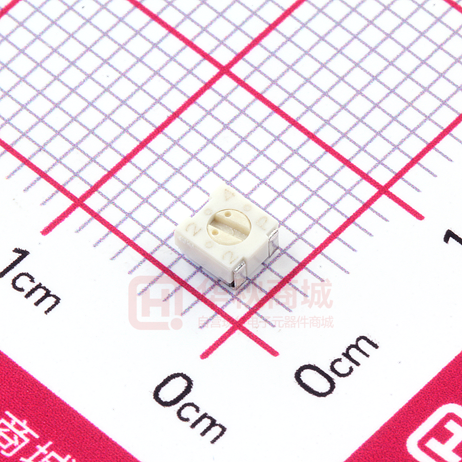

Features
■ Plastic housing for RF applications
■ Surface Mount 3 mm Square
■ Reverse pin layout option (Model 3313X)
Single-Turn Cermet / Sealed
■ Compatible with surface mount
manufacturing processes
(not recommended for wave soldering)
■ Rotor stop for “in-circuit” adjustment
■ 100 cycle rotational and seal life
■ RoHS compliant* - see processing
information on RoHS compliant surface
mount trimmers
■ For trimmer applications/processing
guidelines, click here
■ Halogen free models available**
3313 - 3 mm Trimpot® Trimming Potentiometer
Electrical Characteristics
Standard Resistance Range
......................10 ohms to 2 megohms
(see standard resistance table)
Resistance Tolerance ........... ±20 % std.
End Resistance ..... 1 % or 3 ohms max.
(whichever is greater)
Contact Resistance Variation
.................................... 3 % or 3 ohms
Adjustability
Voltage Divider ........................ ±0.1 %
Rheostat .................................. ±0.2 %
Resolution ...................................
Insulation Resistance ............... 500 vdc.
100 megohms min.
Dielectric Strength
Sea Level................................ 500 vac
70,000 Feet ............................ 350 vac
Adjustment Angle .................. 220° nom.
Environmental Characteristics
Max. Soldering Exposure
............................. 250 °C/10 seconds
Power Rating (200 volts max.)
70 °C .................................. 0.125 watt
125 °C ....................................... 0 watt
Operating Temp. Range
............................... -55 °C to +125 °C
T
.................. ≤100 ohms ±150 ppm/°C;
................... >100 ohms ±100 ppm/°C
Seal Test ..85 °C Fluorinert†/60 seconds
Humidity ...... MIL-STD 202, Method 106
(no vibration) TRS ±3 %;
IR 10 megohms
Vibration .....20 G TRS ±1 %; VRS ±1 %
Shock .......100 G TRS ±1 %; VRS ±1 %
Load Life...............................1000 hours
@ 70 °C Rated Power;TRS ± 3 %
Rotational Life ..... 100 cycles TRS ±3 %
Thermal Shock ..........................5 cycles
TRS ±2 %; VRS ±1 %
Physical Characteristics
Mechanical Angle ................. 250 ° nom.
Torque...............................50 g-cm max.
Stop Strength ..................200 g-cm min.
Pushover Strength (“S” Style only)
........ 1.6 Kilograms (3.5 lbs) minimum
Flammability ..........................U.L. 94V-0
Weight ......................... Approx. 0.01 oz.
Marking........................ Resistance code
and date code
Wiper ............... 50 % (Actual TR) ±10 %
Standard Packaging
J, X Styles (MSL-1) ....1000 pcs./7 ” reel
S Style (MSL-1).......... 200 pcs./7 ” reel
Adjustment Tool..............................H-91
