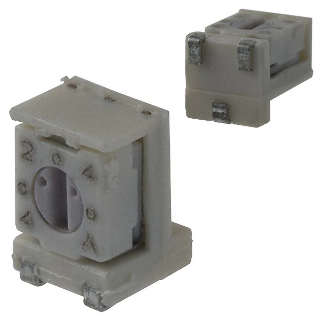

    可调电阻/电位器 100KΩ ±20% 125mW SMD,3.71x3.61mm ±100ppm/℃
3313S-2-104E 数据手册
HA *Ro L O HS G C AV EN OM A I F R PL LA EE IA BL M NT E OD EL S Features n Plastic housing for RF applications n Reverse pin layout option (Model 3313X) n RoHS compliant* n Halogen free models available n AEC-Q200 Qualified Grade 1 3313 - 3 mm Trimpot® Trimming Potentiometer *R oH S CO M PL IA NT ** n Surface Mount 3 mm Square Single-Turn Cermet / Sealed n Compatible with surface mount manufacturing processes (not recommended for wave soldering) n Rotor stop for “in-circuit” adjustment n 100 cycle rotational and seal life Environmental Characteristics Max. Soldering Exposure .............................. 250 °C/10 seconds Power Rating (200 volts max.) 70 °C................................... 0.125 watt 125 °C........................................ 0 watt Operating Temp. Range ................................ -55 °C to +125 °C Temperature Coefficient ................... ≤100 ohms ±150 ppm/°C; .................... >100 ohms ±100 ppm/°C Seal Test...85 °C Fluorinert†/60 seconds Humidity....... MIL-STD 202, Method 106 (no vibration) TRS ±3 %; IR 10 megohms Vibration......20 G TRS ±1 %; VRS ±1 % Shock........100 G TRS ±1 %; VRS ±1 % Load Life................................1000 hours @ 70 °C Rated Power;TRS ± 3 % Rotational Life...... 100 cycles TRS ±3 % Thermal Shock...........................5 cycles TRS ±2 %; VRS ±1 % Physical Characteristics Mechanical Angle.................. 250 ° nom. Torque................................50 g-cm max. Stop Strength...................200 g-cm min. Pushover Strength (“S” Style only) ......... 1.6 Kilograms (3.5 lbs) minimum Flammability...........................U.L. 94V-0 Weight.......................... Approx. 0.01 oz. Marking......................... Resistance code and date code Wiper................ 50 % (Actual TR) ±10 % Standard Packaging J, X Styles (MSL-1).....1000 pcs./7 ” reel S Style (MSL-1)........... 200 pcs./7 ” reel Adjustment Tool...............................H-91 WARNING Cancer and Reproductive Harm www.P65Warnings.ca.gov Product Dimensions 3313J-1 EE 2 FR AD 3.5 ± 0.2 (.138 ± .008) 1 3 3313J-2 3.2 +0.4/-0.2 (.126 +.016/-.008) ADJ. SLOT 0.52 WIDE (.020) 1.93 LONG X (.076) 0.51 DEEP X (.020) 3313S-1 3.5 ± 0.2 (.138 ± .008) 3 1 1.1 ± 0.1 (.043 ± .004) ADJ. CROSS SLOT 0.45 WIDE (.018) 0.51 DEEP X (.020) 3.02 (.119) 3 3313S-2 1 SOLDERABLE AREA 0.5 (.020) 3 PLCS. 2.3 ± 0.2 (.091 ± .008) 3 0.66 ± 0.10 2 PLCS (.026 ± .004) 2.39 (.094) 0.6 (.024) 3313X-2 (Reverse Pin Layout) 1 1.15 TYP (.045) 4.5 (.177) 1.1 (.043) DIMENSIONS: 0.25 TOLERANCES: ± (.010) 1.30 (.051) 0.71 ± 0.20 TYP (.028 ± .008) 0.65 (.026) 3 3.71 (.146) 0.15 ± 0.03 (.006 ± .001) RECOMMENDED LAND PATTERN 1.6 1.6 (.063) (.063) 2 1 ADJ. SLOT .45 ± 0.03 WIDE (.018 ± .001) ± 0.03 LONG 1.93 X (.076 ± .001) X .51 ± 0.06 DEEP (.020 ± .002) 5.35 (.211) 0.15 (.006) 1.60 (.063) 1.1 (.043) 0.6 (.024) 2 2.77 (.109) 2.2 ± 0.2 (.087 ± .008) ADJ. SLOT .52 ± 0.03 WIDE (.020 ± .001) X 1.93 ± 0.03 LONG (.076 ± .001) X .51 ± 0.06 DEEP (.020 ± .002) Position Rotor As Shown Within ±11° Of Centerline Of Terminal 2 3.61 (.142) 3.02 (.119) 1.50 ± 0.15 (.059 ± .006) 2 PLCS 1 2 1.42 1.68 (.056) (.066) 1.47 ± 0.15 (.058 ± .006) 3313X-1 (Reverse Pin Layout) Position Rotor As Shown Within ±11° Of Centerline Of Terminal 2 3.61 ± .20 (.142 ± .008) 3.2 +0.4/-0.2 (.126 +.016/-.008) 2 Ro VER LEA HS SI D F CO ON RE M SA E PL R IA E NT * LE Electrical Characteristics Standard Resistance Range .......................10 ohms to 2 megohms (see standard resistance table) Resistance Tolerance............ ±20 % std. End Resistance...... 1 % or 3 ohms max. (whichever is greater) Contact Resistance Variation ..................................... 3 % or 3 ohms Adjustability Voltage Divider......................... ±0.1 % Rheostat................................... ±0.2 % Resolution.................................... Infinite Insulation Resistance................ 500 vdc. 100 megohms min. Dielectric Strength Sea Level................................ 500 vac 70,000 Feet............................. 350 vac Adjustment Angle................... 220° nom. 2 RECOMMENDED LAND PATTERN 1.57 1.57 (.062) 3 PLCS (.062) 2.62 (.103) MM (INCHES) EXCEPT WHERE NOTED 1.12 2 PLCS (.044) 2.39 (.094) 3 2 CCW WIPER 3 1 CW CLOCKWISE * RoHS Directive 2015/863, Mar. 31, 2015 and Annex. ** Halogen free product is identified by a black housing color. Bourns follows the prevailing definition of “halogen free” in the industry. Bourns considers a product to be “halogen free” if (a) the Bromine (Br) content is 900 ppm or less; (b) the Chlorine (Cl) content is 900 ppm or less; and (c) the total Bromine (Br) and Chlorine (Cl) content is 1500 ppm or less. †“Fluorinert” is a registered trademark of 3M Co. Specifications are subject to change without notice. Users should verify actual device performance in their specific applications. The products described herein and this document are subject to specific legal disclaimers as set forth on the last page of this document, and at www.bourns.com/docs/legal/disclaimer.pdf. Features (Continued) n See processing information on RoHS compliant surface mount trimmers n For trimmer applications/processing guidelines, click here 3313 - 3 mm Trimpot® Trimming Potentiometer Standard Resistance Table Resistance Part Marking Resistance (Ohms) Code Code 10 A1 100 20 21 200 50 51 500 100 A2 101 200 22 201 500 52 501 1,000 A3 102 2,000 23 202 5,000 53 502 10,000 A4 103 20,000 24 203 50,000 54 503 100,000 A5 104 200,000 25 204 500,000 55 504 1,000,000 A6 105 2,000,000 26 205 Popular distribution resistance values listed in boldface. Special resistances available. How To Order Model 3313J, X Packaging Specifications 3.9 ± 0.10 (.154 ± .004) 2.50 ± 0.10 (.098 ± .004) .30 ± 0.10 (.012 ± .004) 2.0 ± 0.10 (.079 ± .004) Embossed Tape 1000 pcs. / 7 ” Reel (J, X Styles - MSL-1) 200 pcs. / 7 ” Reel (S Style - MSL-1) Tape and reel material meets Antistatic ANSI/ ESD 5541-2003 packaging standards. 7.50 ± 0.10 (.295 ± .004) 12.00 ± 0.10 (.472 ± .004) 4.00 ± .10 (.157 ± .004) 1.5 ± .10 (.059 ± .004) 3.65 ± 0.10 (.144 ± .004) 1.5 ± 0.20 (.059 ± .008) TAPE 3313 J - 1 - 502 E Resistance Code 5° ± 2° 4.20 ± .020 (.165 ± .008) 2.00 ± .010 (.079 ± .004) 1.75 ± 0.10 (.069 ± .004) Standard or Modified Product Indicator -1 = Standard Single Slot -2 = Standard Cross Slot -GK2 = Halogen Free Single Slot (Black Housing Color) -GL5 = Halogen Free Cross Slot (Black Housing Color) 5.80 ± 0.10 (.228 ± .004) .40 MAX. (.016) 5.50 ± 0.05 (.216 ± .002) 4.0 ± 0.10 (.157 ± .004) 177.8 ± 2.03 DIA. (7.000 ± .080) Style 3313S Packaging Specifications EQUAL SPACED 1.5 (.059) 3 PLCS MIN. 13.0 ± 0.2 DIA. (.512 ± .008) Meets EIA 481 12.0 ± 0.20 (.472 ± .008) 1.5 ± 0.20 DIA. (.059 ± .008) 16.00 ± .30 (.630 ± .012) 18.39 (.724) MAX. 50.0 (1.969) MIN. 20.2 (.795) MIN. REEL 1.5 ± .10 DIA. (.059 ± .004) 12.40 + 2.00/ -.000 (.488 + .078/ -.000) 4.10 ± 0.20 (.161 ± .008) TAPE 177.8 ± 2.03 DIA. (7.000 ± .080) EQUAL SPACED 1.5 (.059) 3 PLCS MIN. 13.00 ± 0.20 DIA. (.512 ± .008) 22.4 (.882) MAX. 50.0 (1.969) MIN. 20.2 (.795) MIN. 16.40 + 1.78/ -.000 (.646 + .070/ -.000) REEL MM DIMENSIONS: (INCHES) 0.25 TOLERANCES: ± EXCEPT WHERE NOTED (.010) Asia-Pacific: Tel: +886-2 2562-4117 • Email: asiacus@bourns.com Europe: Tel: +36 88 885 877 • Email: eurocus@bourns.com The Americas: Tel: +1-951 781-5500 • Email: americus@bourns.com www.bourns.com REV. 08/19 “Trimpot” is a registered trademark of Bourns, Inc. Specifications are subject to change without notice. Users should verify actual device performance in their specific applications. The products described herein and this document are subject to specific legal disclaimers as set forth on the last page of this document, and at www.bourns.com/docs/legal/disclaimer.pdf. Legal Disclaimer Notice This legal disclaimer applies to purchasers and users of Bourns® products manufactured by or on behalf of Bourns, Inc. and P[ZHɉSPH[LZJVSSLJ[P]LS`¸)V\YUZ¹ Unless otherwise expressly indicated in writing, Bourns® products and data sheets relating thereto are subject to change ^P[OV\[UV[PJL
3313S-2-104E
物料型号:3313系列
器件简介:3313系列是一个3毫米方形的单圈Cermet/密封微调电位器,兼容表面贴装制造工艺,具有塑料外壳,适用于射频应用,提供反向引脚布局选项,并符合RoHS标准。
引脚分配:文档提供了两种反向引脚布局(3313X-1和3313X-2)的详细引脚分配图。
参数特性:包括标准电阻范围(10欧姆至2兆欧姆),电阻公差(±20%标准值),端电阻(最大1%或3欧姆),接触电阻变化(3%或3欧姆),可调性(电压分压±0.1%,变阻器±0.2%),分辨率(无限),绝缘电阻(最小100兆欧姆,500伏直流),耐压(标准大气压下500伏交流,70,000英尺高度350伏交流)。
功能详解:文档详细描述了电位器的电气特性和环境特性,包括最大焊接暴露温度、功率等级、工作温度范围、温度系数、密封测试、湿度、振动、冲击、负载寿命和旋转寿命。
应用信息:适用于需要精确调整的场合,如音频设备、测试设备、医疗设备等。
封装信息:提供了详细的产品尺寸和推荐的焊盘图案,以及包装规格,如7英寸卷装标准和防静电要求。
