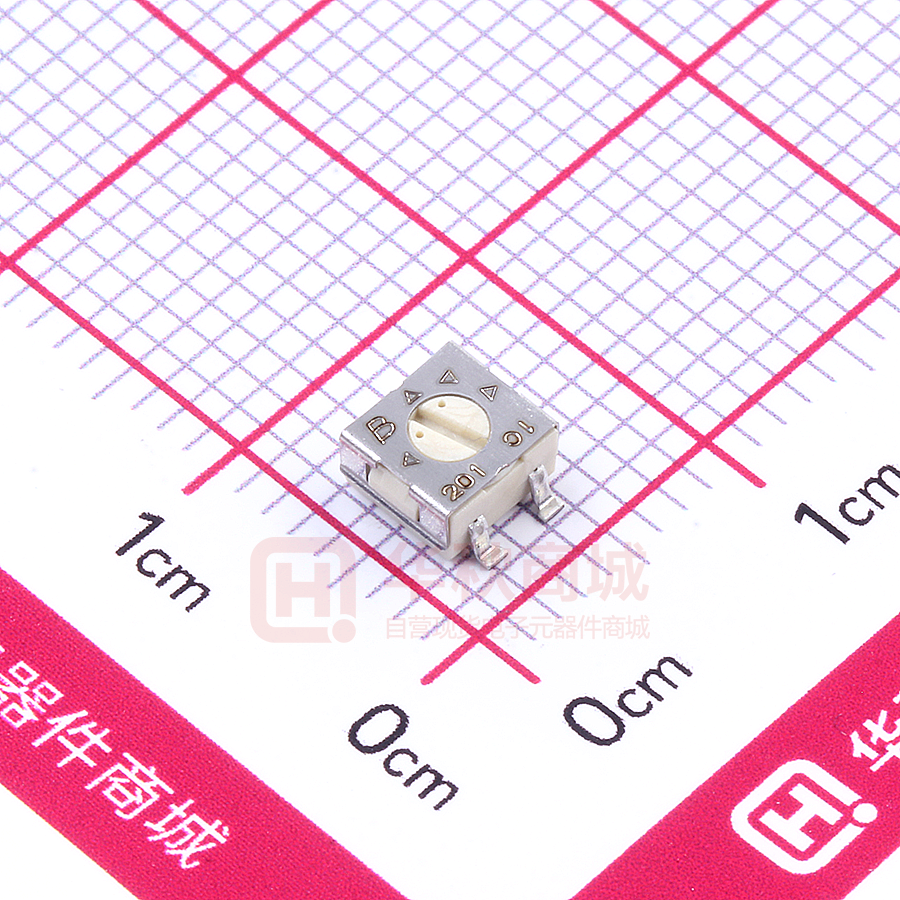

    可调电阻/电位器 200Ω ±20% 250mW SMD-3P,4.5x4.5mm ±100ppm/℃
3314G-1-201E 数据手册
R 0.13 (.005) MAX. TYP. (.059 + .0 RECOMMENDED PCB LAYOUT 2.3 2.35 (.090) Meets SMD standard (.092) EIA/EIAJ/IPC/VECI 0.80 ± 0.10 1.3 trimmer designs(.031 ± .004) (.051) 2 PLCS. 2 PLCS. 2.00 (.079 3 Features n Surface Mount / Single Turn / Cermet Industrial / Sealed n Compatible with surface mount manufacturing processes n Compatible with popular vacuum pick-and-place equipment n J-hook, gull-wing & pinned configurations Electrical Characteristics Standard Resistance Range ......................10 ohms to 2 megohms (see standard resistance table) Resistance Tolerance............ ±20 % std. (tighter tolerance available) End Resistance...... 1 % or 2 ohms max. (whichever is greater) Contact Resistance Variation ..................................... 3 % or 3 ohms Resolution.................................... Infinite Insulation Resistance................ 500 vdc. 100 megohms min. Dielectric Strength Sea Level............... 500 vac (1 minute) Adjustment Angle.................. 210 ° nom. Environmental Characteristics Power Rating (300 volts max. for Style G, J & H; 50 volts max. for Style R) 70 °C..................................... 0.25 watt 125 °C........................................ 0 watt Temperature Range.... -55 °C to +125 °C Temperature Coefficient.... ±100 ppm/°C Seal Test...85 °C Fluorinert†/60 seconds Humidity.............................90-98 % RH, 10 cycles, 240 hours TRS ±2 %; IR 10 megohms Vibration......20 G TRS ±1 %; VRS ±1 % Shock........100 G TRS ±1 %; VRS ±1 % Load Life .....(@ 70 °C Rated Power 1000 Hours) TRS ±3 % Rotational Life........................100 cycles TRS ±3 % Thermal Shock..........................5 cycles TRS ±2 %; VRS ±1 % Physical Characteristics Mechanical Angle.................. 240 ° nom. Torque..............................180 g-cm max. Stop Strength...................300 g-cm min. Pushover Strength (S & Z Style) .................1.6 kilograms (3.5 lbs.) min. Weight................ Approximately 0.01 oz. Marking..................Manufacturer’s code, resistance code and date code Wiper................ 50 % (Actual TR) ±10 % Flammability...........................U.L. 94V-0 Standard Packaging J, G and R....500 pcs./7 ” reel (MSL-1) S and Z.........200 pcs./7 ” reel (MSL-1) H.....................................100 pcs./tube Adjustment Tool...............................H-90 1 TYP. 0.20 (.008) n Side adjust available n n RoHS compliant* - see processing DIA. information on lead 3.2 free surface mount (.126) 6.20 trimmers 5.5 THRU. n(.244) For trimmer applications/processing(.216) guidelines, click here 2.0 3314 - 4 mm Square Trimpot® Trimming Potentiometer 1.30 ± 0.10 (.079) (.051 ± .004) Product Dimensions 4.50 (.177) 2 3314J-1, G-1, R-1, H-1 (Bourns Marking, 4.50 Straight Slot) 2.55 (.100) 3 3 1 RECOMMENDED PCB LAYOUT 2.35 (.093) 2.3 (.091) 1.3 (.051) 2 PLCS. 0.8 ± 0.1 (.031 ± .004) 2 PLCS. 1.0 (.040) 3 PLCS. 5.00 (.197) 1.30 ± 0.1 (.051 ± .004) 5.00 (.197) 3314G-1 2.0 (.079) 3 PLCS. 3314J-2, G-2, R-2, H-2 (Bourns Marking, Cross 5.00 ± 0.10 Slot) 3314J-3, G-3, R-3, H-3 (Reverse Marking, Straight3 Slot)1 4.50 (.177) 2 2.55 (.100) 4.50 (.177) TYP. COMMON DIMENSIONS - (.100) COMMON DIMENSIONS (.157) ALL PIN STYLES: ALL PIN STYLES: CROSS STRAIGHT 2 2 ADJ. SLOT ADJ. SLOT 2.41 LONG 2.452.55 LONG 2.55 (.100) (.095) (.096) .51(.100) .51 0.6 ± 0.1 WIDE X WIDE X (.020) (.020) (.024 ± .004) .51 .51 3 PLCS. 3 1 1 DEEP X DEEP X (.020) (.020) 3 5.00 (.197) 2.0 (.079) 0.80 (.031) DIA. TYP. 3 1 1 2.35 (.093) 6.20 (.244) 5.00 (.197) 5.00 (.197) 4.50 (.177) 2 0.20 (.008) TYP. 2.55 (.100) 4.50 (.177) 5° MAX. TYP. 0.6 TYP. (.024) 0.20 (.008) TYP. 3 RECOMMENDED PCB LAYOUT 2.3 RECOMMENDED PCB (.091) 0.8 ± 0.1 LAYOUT 1.3 (.031 ± .004) 2.3 (.051) 0.8 ± 0.1 2 PLCS. (.091) 2 PLCS. (.031 ± .004) 1.3 2 PLCS. (.051) 2 PLCS. 5.5 (.217) 1.0 1.3 4.00 (.040) (.051) (.157) 3 PLCS. COMMON DIMENSIONS - ALL PIN STYLES: STRAIGHT 2 ADJ. SLOT 2.45 LONG (.096) .51 WIDE X (.020) .51 1 3 DEEP X (.020) COMMON DIMENSIONS ALL PIN STYLES: CROSS 2 ADJ. SLOT 2.41 LONG (.095) .51 WIDE X (.020) .51 1 DEEP X (.020) COMMON DIMENSIONS ALL PIN STYLES: STRAIGHT 2 ADJ. SLOT 2.45 LONG (.096) .51 WIDE X (.020) .51 3 1 DEEP X (.020) COMMON DIMENSIONS ALL PIN STYLES: CROSS ADJ. SLOT 2.41 LONG (.095) .51 WIDE X (.020) 2.35 (.093) 1.30 ± 0.1 1.30 ± 0.1 (.051 ± .004) (.051 ± .004) 2.0 (.079) 3 PLCS. 2.55 (.100) WARNING Cancer and Reproductive Harm - www.P65Warnings.ca.gov 2.0 (.079) 2.0 (.079) 0.20 (.008) TYP. 3 2 1 X .51 DEEP (.020) MM DIMENSIONS: (INCHES) 0.30 TOLERANCES: ± EXCEPT WHERE NOTED (.012) *RoHS Directive 2002/95/EC Jan. 27, 2003 including annex and RoHS Recast 2011/65/EU June 8, 2011. †“Fluorinert” is a registered trademark of 3M Co. 4.50 Specifications are subject to change without notice. 0.6 TYP. (.177) (.024) Users should verify actual device performance in their specific applications. The products described herein and this document are subject to specific legal disclaimers as set forth on the last page of this document, and at www.bourns.com/docs/legal/disclaimer.pdf. 5° MAX. TYP. REEL 13.0 ± 0.5 (.512 ± .02 DIA. 3314J-4, G-4, R-4, H-4 (Reverse Marking, Cross 2.55 Slot) 4.00 5.00 (.197) 4.50 (.177) 2 3 4.00 (.157) 12 (.4 (.177) (.197 ± .004) COMMON DIMENSIONS - COMMON DIMENSIONS 2 OUTSIDE WHEN ALL PIN STYLES: ALL PIN STYLES: PINS ARE PARALLEL STRAIGHT CROSS 2 2 ADJ. SLOT ADJ. SLOT 2.45 LONG 6.30 2.41 LONG (.096) (.095) 0.20 (.248) .51 4.50 .51 (.008) WIDE WIDE X X (.020) (.177) (.020) TYP. .51 .51 1 3 1 DEEP DEEP X X (.020) (.020) 0.20 (.008) TYP. 4.50 (.177) 1.7 (.06 1.3 (.051) 2 PLCS. 5.00 (.197) 3314J-1 4.00 (.157 * Embos ** Embos (See H Meets EIA 3314 - 4 mm Square Trimpot® Trimming Potentiometer Product Dimensions 5.00 (.197) 2 2.55 (.100) 6.20 (.244) 4.50 (.177) 3 .30 MAX. (.012) R 0.13 (.005) MAX. TYP. TYP. 0.20 (.008) 0.80 ± 0.10 (.031 ± .004) 2 PLCS. 1.30 ± 0.10 (.051 ± .004) 5.00 (.197) 8.00 ± 0.20 (.315 ± .008) DIA. 1.50 + 0.10/ - 0.00 (.059 + .004/ - .000) 12.00 ± 0.30 ROTOR POSITIONED AS SHOWN (.472 ± .012) WITHIN ± 22 ° OF CENTERLINE OF TERMINAL 2 1.75 ± 0.10 (.069 ± .004) 2 5.00 ± 0.10 (.197 ± .004) 0.51 ± 0.12 OUTSIDE WHEN (.020 ± .005) PINS ARE PARALLEL 3 PLCS. 6.70 (.264) 6.30 (.248) 0.51 ± 0.13 4.50 (.020 ± .005) 4.50 (.177) TYP. (.177) 3 3 1 1 0.20 (.008) TYP. 0.20 (.008) MAX. 4.00 TYP. 4 PLCS. (.157) R 5 ° 2.55 MAX. 3 (.100) PLCS. RECOMMENDED PCB LAYOUT 2.55 2.31 2.55 (.100) (.091) (.100) 0.80 ± 0.10 0.6 ± 0.1 1.3 (.031 ± .004) (.024 ± .004) (.051) 2 PLCS. 3 PLCS. 2 PLCS. DIA. 3.2 5.00 (.126) (.197) 6.25 THRU0.80 (.246) HOLE (.031) 2.35 (.093) 5.00 (.197) 0.25 ± 0.10 (.010 ± .004) 5.61 (0.221) 1.05 (0.041) 1.50 + 0.10/ - 0.00 (.059 + .004 - .00) DIA. 4.5 (0.177) 5.52 ± 0.05 (.217 ± .002) 6 ° ± 2 ° 1. (.0 0.61 (.024) 3.30 (0.130) 1.78 (0.70) 0.50 (.020) 1.75 ± 0.10 (.068 ± .004) 1.42 REF. 5.26 ± 0.10 (.056) (.207 ± .004) 4.95 ± 0.13 (0.193 ± 0.005) 1.50 + 0.10/ - 0.00 3.13 (.059 + .004 - .000) (0.123) DIA. 5.81 ± 0.13 (0.229 ± 0.005) LEAD FOOTPRINT 2.0 (.079) 1.3 3 PLCS. (.051) 1.5 + (0.59 + 4.00 ± (.157 ± 12.00 ± 0.30 (4.72 ± .012) 20.2 (.795) MIN. DIA. 1 2 3 ROTOR POSITIONED AS SHOWN WITHIN ± 22 ° OF CENTERLINE OF TERMINAL 2 177.8 ± 2.03 DIA.* (7.00 ± .080) 330.2 ± 2.0 DIA.** (13.00 ± .079) 1 2 3 18.4 (.724) MAX. (MEASURED AT HUB) 50.00 (1.969) MIN. 12.4 + 2.01/ -.000 (.488 + .079/ - .000) (MEASURED AT HUB) * Embossed Tape Designator "E" ** Embossed Tape Designator "G" (See How To Order chart for further information.) Meets EIA specification 481. ROTOR POSITIONED AS SHOWN WITHIN ± 22 ° OF CENTERLINE OF TERMINAL 2 1.50 EQUAL SPACED 3 PLCS. (.059) ORIENTATION FEATURE 20.2 18.4 (.795) 13.0 ± 0.51 (.724) MIN. DIA. (.512 ± .020) MAX. RECOMMENDED PCB LAYOUT DIA. (MEASURED AT 3.5 HUB) (0.138) 1.1 (0.043) 50.00 1.2 (1.969) 1.2 MIN. (0.047) (0.047) 1.75 (0.069) 1.15 (0.045) MIN. 177.8 ± 2.03 DIA.* 5.8 (7.00 ± .080) (.228) 330.2 ± 2.0 DIA.** (13.00 ± .079) REEL 13.0 ± 0 (.512 ± . DIA 12.4 + 2.01/ -.000 (.488 + .079/ - .000) (MEASURED AT HUB) 1.15 (0.045) * Embossed Tape Designator "E" 1.6 1.75 ** Embossed Tape Designator "G" (0.063) (0.069) (See How To Order chart for further information.) Meets EIA specification 481. MM DIMENSIONS: (INCHES) 0.30 TOLERANCES: ± EXCEPT WHERE NOTED (.012) DIA. TYP. 0.27 ± 0.10 (.050 ± .004) 7 (.2 6.48 ± 0.10 (.255 ± .004) 4.00 ± 0.10 (.157 ± .004) 5.01 2.00 ± 0.05 (.197) (.079 ± .002) 0.50 (.020 REEL 1.50 EQUAL SPACED 3 PLCS. (.059) 13.0 ± 0.51 (.512 ± .020) DIA. 5.00 4.50 (.197) (.177) 22 2.54 (0.10) 1.273.5 ± 0.10 (0.05) (.138 ± .004) 3 REEL MIN. 1.3 (.051) 2 PLCS. 1 TAPE 1.42 ± 0.13 (0.056 ± 0.005) 5.26 ± 0.10 (.207 ± .004) 2.00 ± 0.05 (.079 ± .020) 5.5 (.216) 2.0 (.079) 5.50 ± 0.5 (.217 ± .020) DIA. 1 2 3 5.26 ± 0.10 (J) 1.50 + 0.10/ - 0.00 ROTOR POSITIONED AS SHOWN (.207 ± .004) (.059 + .004/ - .000) WITHIN ± 22 ° OF CENTERLINE 6.45 ± 0.10 (G) (.254 ± .004) 4.00 ± 0.10OF TERMINAL 2 (.157 ± .004) RECOMMENDED PCB LAYOUT 2.3 (.090) 1.3 (.051) 2 PLCS. DIA. 3.2 (.126) THRU. 6.20 (.244) 2.74 ± 0.10 (.108 ± .004) 0.51 ± 0.13 (.020 ± .005) TYP. 1 2.35 (.092) TAPE TAPE 0.51 ± 0.13 (.020 ± .005) TYP. Specifications are subject to change without notice. Users should verify actual device performance in their specific applications. The products described herein and this document are subject to specific legal disclaimers as set forth on the last page of this document, and at www.bourns.com/docs/legal/disclaimer.pdf. * Embo ** Embo (See Meets E 3314 - 4 mm Square Trimpot® Trimming Potentiometer Product Dimensions Packaging Specifications 1.27 (0.50) 1 2 2 3 ROTOR POSITIONED AS SHOWN WITHIN ± 22 ° OF CENTERLINE OF TERMINAL 2 2.55 (.100) 6.20 2.54 (.244) (0.10) 1.19 (0.047) 3.48 (.137) 2 2.01 (.051) (.079) 2 PLCS. 5.00 ± 0.10 (.197 ± .004) OUTSIDE WHEN PINS ARE PARALLEL 3 6.30 (.248) 4.50 (.177) 2 CCW 1 3 2 2.55 (.100) 0.6 ± 0.1 (.024 ± .004) 3 PLCS. 3 ROTOR POSITIONED AS SHOWN WITHIN ± 22 ° OF CENTERLINE OF TERMINAL 2 4.00 ± 0.10 (.157 ± .004) 1.50 + 0.10/-0.0 (0.59 +.004/-.0) DIA. 2.00 ± 0.05 4.00 ± 0.10 (.079 ± .020) (.157 ± .004) 5.50 ± 0.5 (.217 ± .020) 5.26 ± 0.10 (J) (.207 ± .004) 6.45 ± 0.10 (G) (.254 ± .004) 3.5 (.138 1.50 + 0.1 (.059 + .0 DIA 4.0 (.15 12.00 (.472) 5.26 ± 0.10 (.207 ± .004) 2.0 (.07 5.50 ± 0.10 (.217 ± .004) 2.00 ± 0.10 (.079 ± .004) 8.00 ± 0.20 (.315 ± .008) DIA. 1.50 + 0.10/ - 0.00 1.50 DIA. MIN. (.059 + .004/ - .000) (.059) 1.75 ± 0.10 (.069 ± .004) 5.50 ± 0.10 12.00 ± 0.30 (.217 ± .004) (.472 ± .012) REEL 1 (. REEL 1.50 EQUAL SPACED 3 PLCS. (.059) 5.59 ± 0.10 20.2(.220 ± .004) 18.4 (.795) REEL 13.0 ± 0.51 (.724) MIN. DIA. (.512 ± .020) 1.50 MAX. MIN. EQUAL SPACED 3 PLCS. DIA. (.059) (MEASURED AT 20.2 HUB) 22.4 (.795) 13.0 ± 0.51 (.882) MIN. DIA. (.512 ± .020) 50.00 MAX. DIA. (MEASURED (1.969) AT MIN. HUB) MIN. 4.00 TYP. (.157) 2.55 (.100) 177.8 ± 2.03 DIA.* (7.00 ± .080) 330.2 ± 2.0 DIA.** (13.00 ± .079) 12.4 + 2.01/ -.000 (.488 + .079/ - .000) (MEASURED AT HUB) 177.8 ± 2.03 DIA.* (7.00 ± .080) * Embossed Tape Designator "E" 16.4 + 2.0/ -.000 330.2 ± 2.0 ** Embossed Tape Designator "G" (.646 + .079/ - .000) DIA.** (13.00 ± .079) (See How To Order chart for further information.) (MEASURED AT HUB) Meets EIA specification 481. * Embossed Tape Designator "E" ** Embossed Tape Designator "G" (See How To Order chart for further information.) MM (INCHES) 0.30 TOLERANCES: ± EXCEPT WHERE NOTED (.012) Meets EIA specification 481. DIMENSIONS: 0.80 (.031) DIA. TYP. 13.0 ± 0. (.512 ± .0 DIA. 50.00 (1.969) MIN. CW 5.00 (.197) 5.00 (.197) 7.5 (.295) DIA. 1.50 + 0.10/ - 0.00 1.75 (.059 + .004/ - .000) (.069) CLOCKWISE 2.55 (.100) 1 0.20 (.008) TYP. WIPER 1 3 16.00 (.630) 5 ° MAX. 2.0 (.079) 1.30 ± 0.10 0.21 (.051 ± .004)(.008) 1.3 4.50 (.177) 2 ROTOR POSITIONED AS SHOWN WITHIN ± 22 ° OF CENTERLINE OF TERMINAL 2 TAPE .30 MAX. (.012) 2.74 ± 0.10 (.108 ± .004) 0.51 ± 0.13 (.020 ± .005) TYP. R 0.13 (.005) 3 1 MAX. 0.20 0.61 TYP. 5.56 TYP. (.008) (.024) (0.219) 5.01 0.96 (.197) 3.08 (.038) (0.121) 3.18 RECOMMENDED PCB (.125) 5.76 LAYOUT (0.227) 2.3 2.35 (.090) (.092) 0.80 ± 0.10 1.3 (.031 ± .004) (.051) RECOMMENDED PCB LAYOUT 2 PLCS. 2 PLCS. 2.54 DIA. (0.10) 3.2 1.3 2.01 (.126) (0.051) (.079) 5.5 6.20 THRU. 0.26 (.216) (.244) (.010) 5.00 2.01 (.197) (.079) 1 TAPE TAPE 0.40 MAX. (.016) 0.51 ± 0.13 3.32 (.020 ± .005) (0.131) TYP. 4.50 (.177) 1.29 (0.051) 3 ROTOR POSITIONED AS SHOWN WITHIN ± 22 ° OF CENTERLINE OF TERMINAL 2 1 5.00 (.197) 2 Specifications are subject to change without notice. Users should verify actual device performance in their specific applications. The products described herein and this document are subject to specific legal disclaimers as set forth on the last page of this document, and at www.bourns.com/docs/legal/disclaimer.pdf. * Embos ** Embos (See H Meets EIA 3314 - 4 mm Square Trimpot® Trimming Potentiometer Packaging Specifications TAPE ) TAPE MAX. 5 0) ± 0.10 (J) ± .004) ± 0.10 (G) ± .004) 0.25 ± 0.10 (.010 ± .004) 3.5 ± 0.10 (.138 ± .004) 6 ° ± 2 ° 1 2 3 5.26 ± 0.10 (.207 ± .004) 2.00 ± 0.05 (.079 ± .002) 1.50 + 0.10/ - 0.00 (.059 + .004 - .000) DIA. 00 ± 0.20 15 ± .008) 1.75 ± 0.10 1 2 3 (.068 ± .004) ROTOR POSITIONED AS SHOWN12.00 ± 0.30 WITHIN ± 22 ° OF CENTERLINE (4.72 ± .012) 4.5 (0.177) 16.00 ± 0.3 (.630 ± 0.012) 7.50 ± 0.10 (.295 ± .004) 4.00 (.157) 1.75 ± 0.10 (.069 ± .004) 0.61 (.024) 5.01 2.00 (.197) (.079) 1.78 (0.70) 1.75 (.069) 16.00 (.630) REEL 18.4 (.724) MAX. MEASURED AT HUB) 50.00 (1.969) MIN. 1/ -.000 9/ - .000) D AT HUB) 1.50 EQUAL SPACED 3 PLCS. (.059) 20.2 (.795) MIN. DIA. 13.0 ± 0.51 (.512 ± .020) DIA. 1 2 3 ROTOR POSITIONED AS SHOWN WITHIN ± 22 ° OF CENTERLINE OF TERMINAL 2 177.8 ± 2.03 DIA.* (7.00 ± .080) 330.2 ± 2.0 DIA.** (13.00 ± .079) 18.4 (.724) MAX. (MEASURED AT HUB) 50.00 (1.969) MIN. 12.4 + 2.01/ -.000 (.488 + .079/ - .000) (MEASURED AT HUB) * Embossed Tape Designator "E" ** Embossed Tape Designator "G" (See How To Order chart for further information.) 1 2 Meets EIA specification 481. 1.5 + 0.1/-0.0 (0.59 +.004/-0.0) DIA. (INCHES) 0.30 EXCEPT WHERE NOTED (.012) 12.00 ± 0.10 (.472 ± .004) 4.00 ± 0.10 (.157 ± .004) 5.5 8.3 (.217) (.327) 2.00 ± 0.10 (.079 ± .004) 7.5 (.295) 1.5 DIA. MIN. (.059) 5.30 ± 0.10 (.209 ± .004) 7.30 (.287) ORIENTATION FEATURE LABEL REEL MIN. RECOMMENDED PCB LAYOUT 3.5 (0.138) 1.2 (0.047) 0.5 R TYP. (.020) 1.1 (0.043) 1.2 (0.047) 178.0 1.75 DIA. (7.00) (0.069) 1.15 (0.045) 1.50 EQUAL SPACED 3 PLCS. (.059) 20.2 (.795) MIN. DIA. 13.0 ± 0.51 (.512 ± .020) DIA. 22.4 (.882) MAX. (MEASURED AT HUB) 50.00 (1.969) MIN. 5.8 (.228) 1.6 (0.063) 1.15 (0.045) 1.75 (0.069) 177.8 ± 2.03 DIA.* (7.00 ± .080) 330.2 ± 2.0 DIA.** (13.00 ± .079) 3 ROTOR POSITIONED AS SHOWN WITHIN ± 22 ° OF CENTERLINE MM OF TERMINAL 2 DIMENSIONS: TOLERANCES: ± 1.42 REF. (.056) 4.95 ± 0.13 (0.193 ± 0.005) 8.00 3.13 (.315) (0.123) 5.81 ± 0.13 (0.229 ± 0.005) 3.30 (0.130) OF TERMINAL 2 MIN. 0.50 ± 0.05 (.020 ± .002) DIA. 1.5 (.059) 0.50 (.020) DIA. 10/ - 0.00 04/ - .000) 0.33 (.013) 5.61 (0.221) 0.3 1.05 (.012) (0.041) 5.52 ± 0.05 (.217 ± .002) 1.50 + 0.10/ - 0.00 ROTOR POSITIONED AS SHOWN (.059 + .004 - .00) WITHIN ± 22 ° OF CENTERLINE 6.48 ± 0.10 DIA. OF TERMINAL 2 (.255 ± .004) 4.00 ± 0.10 (.157 ± .004) 26 ± 0.10 07 ± .004) 2.54 (0.10) 1.27 (0.05) TAPE 0.22 2 PLCS. (.009) 3.5 1.42 ± 0.13 (.138) (0.056 ± 0.005) 16.4 + 2.0/ -.000 (.646 + .079/ - .000) (MEASURED AT HUB) * Embossed Tape Designator "E" ** Embossed Tape Designator "G" (See How To Order chart for further information.) Meets EIA specification 481. Specifications are subject to change without notice. Users should verify actual device performance in their specific applications. The products described herein and this document are subject to specific legal disclaimers as set forth on the last page of this document, and at www.bourns.com/docs/legal/disclaimer.pdf. 9) 3314 - 4 mm Square Trimpot® Trimming Potentiometer Packaging Specifications How To Order TAPE 0.40 MAX. (.016) 16.00 (.630) 7.5 (.295) 1.75 (.069) 0.96 (.038) 1.50 + 0.10/-0.0 (0.59 +.004/-.0) DIA. 12.00 (.472) 4.00 ± 0.10 (.157 ± .004) 5.50 ± 0.10 (.217 ± .004) 2.00 ± 0.10 (.079 ± .004) .26 010) 1.50 DIA. MIN. (.059) 5.50 ± 0.10 (.217 ± .004) 3314 J - 1 - 502 E Model Style Standard or Modified Product Indicator (Styles J, G, H & S) -1 = Single Slot -2 = Cross Slot -3 = Single Slot w/Reverse Marking -4 = Cross Slot w/Reverse Marking Product Indicator (Style R only) -GM5 = Cross Slot w/Extended Lead Frame -1 = Single Slot -2 = Cross Slot -3 = Single Slot w/Reverse Marking -4 = Cross Slot w/Reverse Marking Product Indicator (Style Z only) -GA4 = Single Slot -1 = Cross Slot -3 = Single Slot w/Reverse Marking -4 = Cross Slot w/Reverse Marking Resistance Code Embossed Tape Designator (MSL-1)** E = Styles J, G and R: 500 pcs./7 ” reel Styles S and Z: 200 pcs./7 ” reel G = Styles J and G: 3000 pcs./13 ” reel Style R: 2500 pcs./13 ” reel Styles S and Z: 1000 pcs./13 ” reel **Style H is available in tube packaging only. Standard Resistance Table Resistance Resistance (Ohms) Code 10 100 20 200 50 500 100 101 200 201 500 501 1,000 102 2,000 202 5,000 502 10,000 103 20,000 203 50,000 503 100,000 104 200,000 204 250,000 254 500,000 504 1,000,000 105 2,000,000 205 Popular distribution values listed in boldface. Special resistances available. Tape and reel material meets Antistatic ANSI/ ESD 5541-2003 packaging standards. 5 ° MAX. 1 9) 5.59 ± 0.10 (.220 ± .004) REEL MIN. 1.50 EQUAL SPACED 3 PLCS. (.059) 20.2 (.795) MIN. DIA. 13.0 ± 0.51 (.512 ± .020) DIA. 22.4 (.882) MAX. (MEASURED AT HUB) 50.00 (1.969) MIN. 177.8 ± 2.03 DIA.* (7.00 ± .080) 330.2 ± 2.0 DIA.** (13.00 ± .079) 16.4 + 2.0/ -.000 (.646 + .079/ - .000) (MEASURED AT HUB) * Embossed Tape Designator "E" ** Embossed Tape Designator "G" (See How To Order chart for further information.) Meets EIA specification 481. MM DIMENSIONS: (INCHES) 0.30 TOLERANCES: ± EXCEPT WHERE NOTED (.012) REV. 05/19 Specifications are subject to change without notice. Users should verify actual device performance in their specific applications. The products described herein and this document are subject to specific legal disclaimers as set forth on the last page of this document, and at www.bourns.com/docs/legal/disclaimer.pdf. Legal Disclaimer Notice This legal disclaimer applies to purchasers and users of Bourns® products manufactured by or on behalf of Bourns, Inc. and its affiliates (collectively, “Bourns”). Unless otherwise expressly indicated in writing, Bourns® products and data sheets relating thereto are subject to change without notice. Users should check for and obtain the latest relevant information and verify that such information is current and complete before placing orders for Bourns® products. The characteristics and parameters of a Bourns® product set forth in its data sheet are based on laboratory conditions, and statements regarding the suitability of products for certain types of applications are based on Bourns’ knowledge of typical requirements in generic applications. The characteristics and parameters of a Bourns® product in a user application may vary from the data sheet characteristics and parameters due to (i) the combination of the Bourns® product with other components in the user’s application, or (ii) the environment of the user application itself. The characteristics and parameters of a Bourns® product also can and do vary in different applications and actual performance may vary over time. Users should always verify the actual performance of the Bourns® product in their specific devices and applications, and make their own independent judgments regarding the amount of additional test margin to design into their device or application to compensate for differences between laboratory and real world conditions. Unless Bourns has explicitly designated an individual Bourns® product as meeting the requirements of a particular industry standard (e.g., ISO/TS 16949) or a particular qualification (e.g., UL listed or recognized), Bourns is not responsible for any failure of an individual Bourns® product to meet the requirements of such industry standard or particular qualification. Users of Bourns® products are responsible for ensuring compliance with safety-related requirements and standards applicable to their devices or applications. Bourns® products are not recommended, authorized or intended for use in nuclear, lifesaving, life-critical or life-sustaining applications, nor in any other applications where failure or malfunction may result in personal injury, death, or severe property or environmental damage. Unless expressly and specifically approved in writing by two authorized Bourns representatives on a case-by-case basis, use of any Bourns® products in such unauthorized applications might not be safe and thus is at the user’s sole risk. Life-critical applications include devices identified by the U.S. Food and Drug Administration as Class III devices and generally equivalent classifications outside of the United States. Bourns expressly identifies those Bourns® standard products that are suitable for use in automotive applications on such products’ data sheets in the section entitled “Applications.” Unless expressly and specifically approved in writing by two authorized Bourns representatives on a case-by-case basis, use of any other Bourns® standard products in an automotive application might not be safe and thus is not recommended, authorized or intended and is at the user’s sole risk. If Bourns expressly identifies a sub-category of automotive application in the data sheet for its standard products (such as infotainment or lighting), such identification means that Bourns has reviewed its standard product and has determined that if such Bourns® standard product is considered for potential use in automotive applications, it should only be used in such sub-category of automotive applications. Any reference to Bourns® standard product in the data sheet as compliant with the AEC-Q standard or “automotive grade” does not by itself mean that Bourns has approved such product for use in an automotive application. Bourns® standard products are not tested to comply with United States Federal Aviation Administration standards generally or any other generally equivalent governmental organization standard applicable to products designed or manufactured for use in aircraft or space applications. Bourns expressly identifies Bourns® standard products that are suitable for use in aircraft or space applications on such products’ data sheets in the section entitled “Applications.” Unless expressly and specifically approved in writing by two authorized Bourns representatives on a case-by-case basis, use of any other Bourns® standard product in an aircraft or space application might not be safe and thus is not recommended, authorized or intended and is at the user’s sole risk. The use and level of testing applicable to Bourns® custom products shall be negotiated on a case-by-case basis by Bourns and the user for which such Bourns® custom products are specially designed. Absent a written agreement between Bourns and the user regarding the use and level of such testing, the above provisions applicable to Bourns® standard products shall also apply to such Bourns® custom products. Users shall not sell, transfer, export or re-export any Bourns® products or technology for use in activities which involve the design, development, production, use or stockpiling of nuclear, chemical or biological weapons or missiles, nor shall they use Bourns® products or technology in any facility which engages in activities relating to such devices. The foregoing restrictions apply to all uses and applications that violate national or international prohibitions, including embargos or international regulations. Further, Bourns® products and Bourns technology and technical data may not under any circumstance be exported or re-exported to countries subject to international sanctions or embargoes. Bourns® products may not, without prior authorization from Bourns and/or the U.S. Government, be resold, transferred, or re-exported to any party not eligible to receive U.S. commodities, software, and technical data. To the maximum extent permitted by applicable law, Bourns disclaims (i) any and all liability for special, punitive, consequential, incidental or indirect damages or lost revenues or lost profits, and (ii) any and all implied warranties, including implied warranties of fitness for particular purpose, non-infringement and merchantability. For your convenience, copies of this Legal Disclaimer Notice with German, Spanish, Japanese, Traditional Chinese and Simplified Chinese bilingual versions are available at: Web Page: http://www.bourns.com/legal/disclaimers-terms-and-policies PDF: http://www.bourns.com/docs/Legal/disclaimer.pdf C1753 05/17/18R
