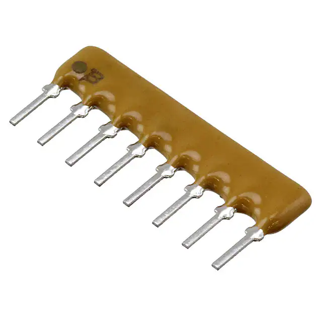

    排阻/电阻网络 SIP-8 510Ω ±2% 300mW ±100ppm/℃
4608X-AP2-511LF 数据手册
Features n RoHS compliant* n Low profile is compatible with DIPs n Marking on contrasting background for permanent identification n Wide assortment of pin packages enhances design flexibility n Ammo-pak packaging available n Recommended for rosin flux and solvent clean or no clean flux processes Product Characteristics Resistance Range ..................... 10 ohms to 10 megohms Maximum Operating Voltage..........100 V Temperature Coefficient of Resistance 50 Ω to 2.2 megohms......±100 ppm/°C below 50 Ω......................±250 ppm/°C above 2.2 megohms.......±250 ppm/°C TCR Tracking.........................50 ppm/°C maximum; equal values Resistor Tolerance................ See circuits Insulation Resistance ................. 10,000 megohms minimum Dielectric Withstanding Voltage ............................................200 VRMS Operating Temperature .................................-55 °C to +125 °C Environmental Characteristics TESTS PER MIL-STD-202....... ∆R MAX. Short Time Overload..................±0.25 % Load Life.....................................±1.00 % Moisture Resistance...................±0.50 % Resistance to Soldering Heat ................................................±0.50 % Terminal Strength.......................±0.25 % Thermal Shock...........................±0.25 % Physical Characteristics Flammability......... Conforms to UL94V-0 Body Material....................... Epoxy resin Standard Packaging ................... Bulk, Ammo-pak available How To Order 46 06 X - 101 - 222 __ LF Model (46 = Conformal SIP) Number of Pins Physical Configuration (X = Thick Film Low Profile) Electrical Configuration • 101 = Bussed • 102 = Isolated • 104 = Dual Terminator • AP1 = Bussed Ammo** • AP2 = Isolated Ammo** • AP4 = Dual Ammo** Resistance Code • First 2 digits are significant • Third digit represents the number of zeros to follow. Resistance Tolerance • Blank = ±2 % (see “Resistance Tolerance” on next page for resistance range) • F = ±1 % (100 ohms - 5 megohms) Terminations • All electrical configurations EXCEPT 104 & AP4: LF = Sn/Ag/Cu-plated (RoHS compliant) • ONLY electrical configurations 104 & AP4: L = Sn/Ag/Cu-plated (RoHS compliant) Consult factory for other available options. **Available for packages with 10 pins or less. 4600X Series - Thick Film Conformal 4600X SIPs PACKAGE POWER TEMPERATURE Package Power Temp. Derating Curve DERATING CURVE Product Dimensions A MAXIMUM 3.50 3.00 PIN #1 REF. MAX. 1.24 BOTH ENDS (.049) 0.50 ± 0.10 TYP. (.020 ± .004) 2.50 WATTS 2.00 1.50 1.00 .50 0 4614X 2.54 ± .07 (.100 ± .003*) TYP. NON-ACCUM. 4612X 4610X 4608X 4606X 4604X 25 2.49 MAX. (.098) 70 125 AMBIENT TEMPERATURE ( ϒC ) Package Power Ratings (Watts) Ambient Ambient Temp. Temp. Pkg. 70 °C Pkg. 70 °C 4604X 0.50 4610X 1.25 4605X 0.63 4611X 1.38 4606X 0.75 4612X 1.50 4607X 0.88 4613X 1.63 4608X 1.00 4614X 1.75 4609X 1.13 Typical Part Marking Represents total content. Layout may vary. Part Number Marking 4606X-101-RC 6X-1-RC 4608X-102-RC 8X-2-RC 4610X-104-RC/RC 10X-4-RC/RC .254 ± .050 MAX. (.010 ± .002) 5.08 (.200) MAX. 3.3 +0.5/-0.3 (.130 +.020/ -.012) Pin Count 4 5 6 7 8 9 10 11 12 13 14 A Maximum mm (Inches) 10.11 (.398) 12.65 (.498) 15.19 (.598) 17.73 (.698) 20.27 (.798) 22.81 (.898) 25.35 (.998) 27.89 (1.098) 30.43 (1.198) 32.97 (1.298) 35.51 (1.398) Maximum package length is equal to 2.54mm (.100") times the number of pins, less .005mm (.002"). Governing dimensions are in metric. Dimensions in parentheses are inches and are approximate. *Terminal centerline to centerline measurements made at point of emergence of the lead from the body. For Standard Values Used in Capacitors, Inductors, and Resistors, click here. RC = ohmic value, 3-digit resistance code. NUMBER OF PINS CIRCUIT 6X-2-222 YYWW PIN ONE INDICATOR RESISTANCE CODE DATE CODE MANUFACTURER'S TRADEMARK WARNING Cancer and Reproductive Harm - www.P65Warnings.ca.gov *RoHS Directive 2015/863, Mar 31, 2015 and Annex. Specifications are subject to change without notice. Users should verify actual device performance in their specific applications. The products described herein and this document are subject to specific legal disclaimers as set forth on the last page of this document, and at www.bourns.com/docs/legal/disclaimer.pdf. For information on specific applications, download Bourns’ application notes: n DRAM Applications n Dual Terminator Resistor Networks n R/2R Ladder Networks n SCSI Applications 4600X Series - Thick Film Conformal SIPs Isolated Resistors (102 Circuit) Model 4600X-102-RC 4, 6, 8, 10, 12, 14 Pin 102 CIRCUIT ISOLATED RESISTORS Bussed Resistors (101 Circuit) Model 4600X-101-RC 4 through 14 Pin 101 CIRCUIT BUSSED RESISTORS ... 1 4 6 12 1 14 Dual Terminator (104 Circuit) Model 4600X-104-R1/R2 4DUAL TERMINATOR through 14 Pin R2 R2 R2 R2 R2 R2 R1 R1 R1 R1 R1 R1 104 CIRCUIT 14 1 These models incorporate 3 to 13 thick-film resistors of equal value, each connected between a common bus (pin 1) and a separate pin. Resistance Tolerance 10 ohms to 49 ohms.................... ±1 ohm 50 ohms to 5 megohms................. ±2 %* Above 5 megohms..........................±5 % Resistance Tolerance 10 ohms to 49 ohms.................... ±1 ohm 50 ohms to 5 megohms................. ±2 %* Above 5 megohms..........................±5 % Power Rating per Resistor At 70 °C ................................... 0.30 watt Power Rating per Resistor At 70 °C ................................... 0.20 watt Power Temperature Derating Curve Power Temperature Derating Curve .60 .60 .50 .50 .40 .40 .30 .20 0 Power Rating per Resistor At 70 °C ................................... 0.20 watt .60 .50 .30 .40 .20 0 25 70 125 AMBIENT TEMPERATURE ( ϒC ) Resistance Tolerance Below 100 ohms........................ ±2 ohms 100 ohms to 5 megohms............... ±2 %* Above 5 megohms..........................±5 % Power Temperature Derating Curve .10 .10 The 4608X-104 (shown above) is an 8pin configuration and terminates 6 lines. Pins 1 and 8 are common for ground and power, respectively. Twelve thickfilm resistors are paired in series between the common lines (pins 1 and 8). WATTS WATTS WATTS These models incorporate 2 to 7 isolated thick-film resistors of equal value, each connected between two pins. 8 25 70 125 AMBIENT TEMPERATURE ( ϒC ) .30 .20 .10 0 Popular Resistance Values (101, 102 Circuits)** Ohms 10 22 27 33 39 47 56 68 82 100 120 150 Code 100 220 270 330 390 470 560 680 820 101 121 151 Ohms 180 220 270 330 390 470 560 680 820 1,000 1,200 1,500 Code 181 221 271 331 391 471 561 681 821 102 122 152 Ohms 1,800 2,000 2,200 2,700 3,300 3,900 4,700 5,600 6,800 8,200 10,000 12,000 Code 182 202 222 272 332 392 472 562 682 822 103 123 Ohms 15,000 18,000 20,000 22,000 27,000 33,000 39,000 47,000 56,000 68,000 82,000 100,000 Code 153 183 203 223 273 333 393 473 563 683 823 104 Ohms 120,000 150,000 180,000 220,000 270,000 330,000 390,000 470,000 560,000 680,000 820,000 1,000,000 Code 124 154 184 224 274 334 394 474 564 684 824 105 25 70 125 AMBIENT TEMPERATURE ( ϒC ) Popular Resistance Values (104 Circuit)** R1 160 180 220 220 330 330 3,000 Ohms Resistance R2 240 390 270 330 390 470 6,200 R1 161 181 221 221 331 331 302 Code R2 241 391 271 331 391 471 622 * ±1 % tolerance is available by adding suffix code “F” after the resistance code. **Non-standard values available, within resistance range. REV. 10/1/20 Specifications are subject to change without notice. Users should verify actual device performance in their specific applications. The products described herein and this document are subject to specific legal disclaimers as set forth on the last page of this document, and at www.bourns.com/docs/legal/disclaimer.pdf. Legal Disclaimer Notice This legal disclaimer applies to purchasers and users of Bourns® products manufactured by or on behalf of Bourns, Inc. and its affiliates (collectively, “Bourns”). Unless otherwise expressly indicated in writing, Bourns® products and data sheets relating thereto are subject to change without notice. Users should check for and obtain the latest relevant information and verify that such information is current and complete before placing orders for Bourns® products. The characteristics and parameters of a Bourns® product set forth in its data sheet are based on laboratory conditions, and statements regarding the suitability of products for certain types of applications are based on Bourns’ knowledge of typical requirements in generic applications. The characteristics and parameters of a Bourns® product in a user application may vary from the data sheet characteristics and parameters due to (i) the combination of the Bourns® product with other components in the user’s application, or (ii) the environment of the user application itself. The characteristics and parameters of a Bourns® product also can and do vary in different applications and actual performance may vary over time. Users should always verify the actual performance of the Bourns® product in their specific devices and applications, and make their own independent judgments regarding the amount of additional test margin to design into their device or application to compensate for differences between laboratory and real world conditions. Unless Bourns has explicitly designated an individual Bourns® product as meeting the requirements of a particular industry standard (e.g., ISO/TS 16949) or a particular qualification (e.g., UL listed or recognized), Bourns is not responsible for any failure of an individual Bourns® product to meet the requirements of such industry standard or particular qualification. Users of Bourns® products are responsible for ensuring compliance with safety-related requirements and standards applicable to their devices or applications. Bourns® products are not recommended, authorized or intended for use in nuclear, lifesaving, life-critical or life-sustaining applications, nor in any other applications where failure or malfunction may result in personal injury, death, or severe property or environmental damage. Unless expressly and specifically approved in writing by two authorized Bourns representatives on a case-by-case basis, use of any Bourns® products in such unauthorized applications might not be safe and thus is at the user’s sole risk. Life-critical applications include devices identified by the U.S. Food and Drug Administration as Class III devices and generally equivalent classifications outside of the United States. Bourns expressly identifies those Bourns® standard products that are suitable for use in automotive applications on such products’ data sheets in the section entitled “Applications.” Unless expressly and specifically approved in writing by two authorized Bourns representatives on a case-by-case basis, use of any other Bourns® standard products in an automotive application might not be safe and thus is not recommended, authorized or intended and is at the user’s sole risk. If Bourns expressly identifies a sub-category of automotive application in the data sheet for its standard products (such as infotainment or lighting), such identification means that Bourns has reviewed its standard product and has determined that if such Bourns® standard product is considered for potential use in automotive applications, it should only be used in such sub-category of automotive applications. Any reference to Bourns® standard product in the data sheet as compliant with the AEC-Q standard or “automotive grade” does not by itself mean that Bourns has approved such product for use in an automotive application. Bourns® standard products are not tested to comply with United States Federal Aviation Administration standards generally or any other generally equivalent governmental organization standard applicable to products designed or manufactured for use in aircraft or space applications. Bourns expressly identifies Bourns® standard products that are suitable for use in aircraft or space applications on such products’ data sheets in the section entitled “Applications.” Unless expressly and specifically approved in writing by two authorized Bourns representatives on a case-by-case basis, use of any other Bourns® standard product in an aircraft or space application might not be safe and thus is not recommended, authorized or intended and is at the user’s sole risk. The use and level of testing applicable to Bourns® custom products shall be negotiated on a case-by-case basis by Bourns and the user for which such Bourns® custom products are specially designed. Absent a written agreement between Bourns and the user regarding the use and level of such testing, the above provisions applicable to Bourns® standard products shall also apply to such Bourns® custom products. Users shall not sell, transfer, export or re-export any Bourns® products or technology for use in activities which involve the design, development, production, use or stockpiling of nuclear, chemical or biological weapons or missiles, nor shall they use Bourns® products or technology in any facility which engages in activities relating to such devices. The foregoing restrictions apply to all uses and applications that violate national or international prohibitions, including embargos or international regulations. Further, Bourns® products and Bourns technology and technical data may not under any circumstance be exported or re-exported to countries subject to international sanctions or embargoes. Bourns® products may not, without prior authorization from Bourns and/or the U.S. Government, be resold, transferred, or re-exported to any party not eligible to receive U.S. commodities, software, and technical data. To the maximum extent permitted by applicable law, Bourns disclaims (i) any and all liability for special, punitive, consequential, incidental or indirect damages or lost revenues or lost profits, and (ii) any and all implied warranties, including implied warranties of fitness for particular purpose, non-infringement and merchantability. For your convenience, copies of this Legal Disclaimer Notice with German, Spanish, Japanese, Traditional Chinese and Simplified Chinese bilingual versions are available at: Web Page: http://www.bourns.com/legal/disclaimers-terms-and-policies PDF: http://www.bourns.com/docs/Legal/disclaimer.pdf C1753 05/17/18R
