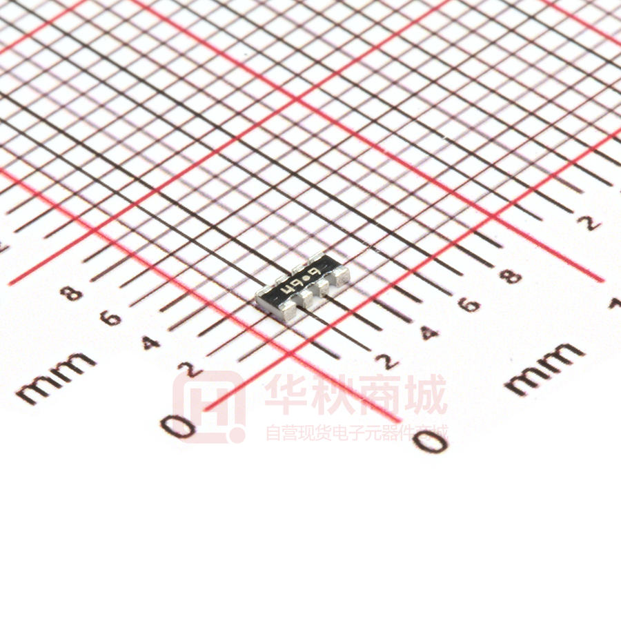

    排阻/电阻网络 0603x4 49.9Ω ±1% 62.5mW ±200ppm/℃
CAY16-49R9F4LF 数据手册
Features n RoHS compliant* n Convex and concave terminals n 4 isolated elements n Resistance tolerance ±1 % and ±5 % n Resistance range: 10 ohms to 1 megohm CAT/CAY 16 Series - Chip Resistor Arrays Specifications Requirement Characteristics Short Time Overload ±2 % +0.1 ohm Soldering Heat ±2 % +0.1 ohm Temperature Cycling (5) ±1 % + 0.1 ohm Moisture Load Life ±3 % +0.1 ohm Load Life ±3 % +0.1 ohm Test Method Rated Voltage X 2.5, 5 seconds 260 °C ±5 °C, 10 seconds ±1 second 125 °C (30 minutes) - normal (15 minutes) -55 °C (30 minutes) - normal (15 minutes) 1000 hours 1000 hours Characteristics How To Order Characteristics CA Y 16 - 103 J 4 LF CAT16/CAY16 Number of Elements 4 (F4, J4) Power Rating Per Resistor @ 70 °C 0.0625 W Package Power Rating @ 70 °C 0.250 W Temperature Coefficient of Resistance ±200 PPM/°C Resistance Tolerance ±1 %, ±5 % Resistance Range: E24 (J), E96 + E24 (F) Zero-Ohm Jumper < 0.05 ohm 10 ohms - 1 megohm Max. Working Voltage 50 V Max. Overload Voltage 100 V Operating Temp. Range -55 °C - 125 °C Soldering Profile for RoHS Compliant Chip Resistors and Arrays 275 Maximum of 20 seconds between +255 °C and +260 °C 260 °C peak 255 °C Temperature (°C) 225 220 °C 190 °C 60 - 90 seconds 175 Ramp Down 6 °C/second 150 °C 125 Chip Arrays Type • CAT16 = Concave Terminations • CAY16 = Convex Terminations Resistance Code • For 1 % Tolerance:
CAY16-49R9F4LF
物料型号:CAT16/CAY16
器件简介:这是一系列芯片电阻阵列,具有RoHS合规性,凸形和凹形端子,4个隔离元件,电阻公差为±1%和±5%,电阻范围从10欧姆到1兆欧。
引脚分配:文档中没有明确提供引脚分配的详细信息,但提到了4个隔离元件(F4, J4)。
参数特性: - 短时过载:+2%+0.1欧姆 - 焊接热:260°C 5°C, 10秒1秒 - 温度循环:+1%+0.1欧姆 - 湿度负载寿命:+3%+0.1欧姆,1000小时 - 负载寿命:+3%+0.1欧姆,1000小时
功能详解: - 元件数量:4 - 每个电阻的功率额定值(70°C):0.0625W - 70°C时的封装功率额定值:0.250W - 电阻的温度系数:+200 PPM/C - 电阻公差:±1%, ±5% - 电阻范围:E24 (J), E96+E24(F) Zero-Ohm Jumper<0.05 ohm,10欧姆 - 1兆欧 - 最大工作电压:50V - 最大过载电压:100V - 工作温度范围:-55°C - 125°C
应用信息:文档中没有提供具体的应用案例,但提到了组件放置和焊接的注意事项,以减少机械应力并防止焊接桥接。
封装信息:F4, J4封装尺寸为1206。还提供了详细的尺寸图表,包括模型、A、A'、B、C、D、E和F的尺寸。
