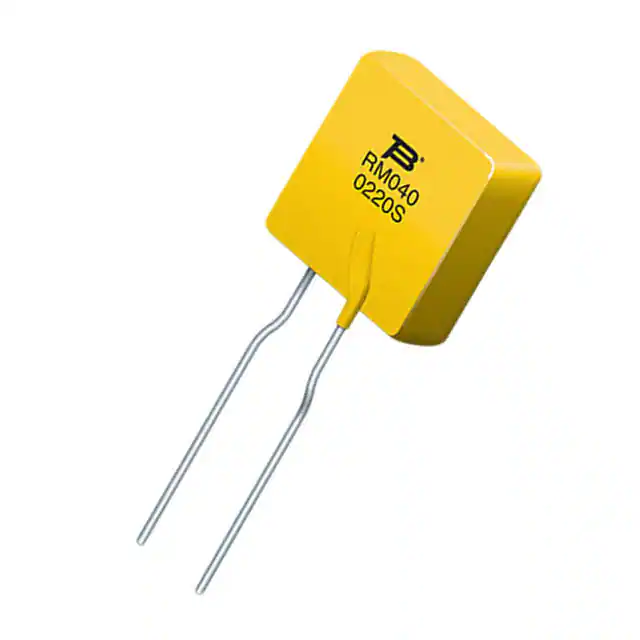

MF-RM040/240-2 数据手册
CO M G E & PL I AN N FR T* EE ** Applications ■ Radial leaded devices ■ Cured, flame retardant epoxy polymer ■ ■ ■ ■ LO HA Ro HS Features ■ ■ ■ ■ insulating material meets UL 94V-0 requirements Bulk packaging, tape and reel available Resettable circuit protection Agency recognition: RoHS compliant* and halogen free** Food blenders, coffee machines HVAC Electric fans, blowers AC adaptors MF-RM Series - Line Voltage PTC Resettable Fuses Electrical Characteristics Maximum Voltage Max. I Current hold Itrip Model 1 Hour Initial Post-Trip Resistance Resistance R1max Max. Time To Trip Tripped Power Dissipation Oper. Inter. Imax at 23 °C Min. at 23 °C Max. at 23 °C at 23 °C Typ. at 23 °C VAC VAC Amps Amps Ohms Ohms Amps Seconds Watts Agency Recognition cUL TÜV E174545 50232433 MF-RM005/240 240 265 1.0 0.05 0.12 18.5 65.0 0.25 10.0 0.9 ✓ ✓ MF-RM008/240 240 265 1.2 0.08 0.19 7.4 26.0 0.40 10.0 0.9 ✓ ✓ MF-RM012/240 240 265 1.2 0.12 0.30 3.0 12.0 0.60 15.0 1.0 ✓ ✓ MF-RM016/240 240 265 2.0 0.16 0.37 2.5 7.80 0.80 15.0 1.4 ✓ ✓ MF-RM025/240 240 265 3.5 0.25 0.56 1.3 3.80 1.25 18.5 1.5 ✓ ✓ MF-RM033/240 240 265 4.5 0.33 0.74 0.77 2.60 1.65 21.0 1.7 ✓ ✓ MF-RM040/240 240 265 5.5 0.40 0.90 0.60 1.90 2.00 24.0 2.0 ✓ ✓ MF-RM055/240 240 265 7.0 0.55 1.25 0.45 1.45 2.75 26.0 3.4 ✓ ✓ Environmental Characteristics Item Additional Information Condition Criteria Operating Temperature -20 °C to +85 °C Recommended Storage +40 °C max. / 70 % R.H. max. Passive Aging +85 °C, 1000 hours ±20 % typical resistance change Humidity Aging +85 °C, 85 % R.H. 1000 hours ±20 % typical resistance change Thermal Shock -40 °C to +85 °C, 10 times ±15 % typical resistance change Solvent Resistance MIL-STD-202, Method 215 No change (marking still legible) Vibration MIL-STD-883C, Method 2007.1 Condition A No change (Rmin ≤ R ≤ R1max) Moisture Sensitivity Level (MSL) See Note ESD Classification Class 6 (per AEC-Q200-2, HBM) WARNING Cancer and Reproductive Harm www.P65Warnings.ca.gov Click these links for more information: PRODUCT TECHNICAL INVENTORY SAMPLES SELECTOR LIBRARY CONTACT * RoHS Directive 2015/863, Mar 31, 2015 and Annex. ** Bourns considers a product to be “halogen free” if (a) the Bromine (Br) content is 900 ppm or less; (b) the Chlorine (Cl) content is 900 ppm or less; and (c) the total Bromine (Br) and Chlorine (Cl) content is 1500 ppm or less. Specifications are subject to change without notice. Users should verify actual device performance in their specific applications. The products described herein and this document are subject to specific legal disclaimers as set forth on the last page of this document, and at www.bourns.com/docs/legal/disclaimer.pdf. Advantages Benefits ■ Resettable feature with overtemperature and overcurrent protection ■ Reduced repair and replacement costs can save expensive components from having to be replaced after tripping, e.g., transformers with built in thermal fuses ■ Reduced nuisance tripping ■ Combined overcurrent and overtemperature protector in one device ■ Faster than bimetallic switch designs that take on average approximately 30 seconds to cool down and reset ■ Generally lower electromagnetic interference than bimetallic switches MF-RM Series - Line Voltage PTC Resettable Fuses Test Procedures and Requirements Item Test Conditions Accept/Reject Criteria Visual/Mechanical Verify dimensions and materials Per MF physical description Resistance In still air @ 23 °C Rmin ≤ R ≤ Rmax Time to Trip At specified current, Vmax, 23 °C, still air T ≤ max. time to trip (seconds) Hold Current 30 min. at Ihold, still air No trip Trip Cycle Life Operating voltage, Imax, 100 cycles No arcing or burning Trip Endurance A Operating voltage, Imax, 24 hours No arcing or burning Trip Endurance B Interrupt voltage, Imax, 30 minutes No arcing or burning Solderability 245 °C ± 5 °C, 5 seconds 95 % min. coverage Thermal Derating Table - Ihold (Amps) Ambient Operating Temperature Model MF-RM005/240 MF-RM008/240 MF-RM012/240 MF-RM016/240 MF-RM025/240 MF-RM033/240 MF-RM040/240 MF-RM055/240 -20 ºC 0 ºC 23 ºC 40 ºC 50 ºC 60 ºC 70 ºC 85 ºC 0.08 0.12 0.18 0.24 0.38 0.50 0.61 0.80 0.06 0.10 0.15 0.20 0.32 0.42 0.51 0.68 0.05 0.08 0.12 0.16 0.25 0.33 0.40 0.55 0.04 0.07 0.10 0.13 0.21 0.27 0.33 0.46 0.04 0.06 0.09 0.11 0.18 0.23 0.28 0.40 0.03 0.05 0.07 0.10 0.15 0.20 0.24 0.35 0.03 0.04 0.06 0.08 0.13 0.17 0.20 0.29 0.02 0.03 0.04 0.05 0.09 0.11 0.14 0.22 Typical Time to Trip at 23 ˚C MF - RM 005 / 240 - 2 - 17 100 A Time to Trip (Seconds) How to Order B C D F G H E Multifuse® Product Designator A = MF-RM005/240 B = MF-RM008/240 C = MF-RM012/240 D = MF-RM016/240 E = MF-RM025/240 F = MF-RM033/240 G = MF-RM040/240 H = MF-RM055/240 10 1 0.1 0.1 Series RM = Radial Leaded Line Voltage Component Hold Current, Ihold 005-055 (0.05 A - 0.55 A) Operating Voltage, Vmax 240 = 240 Vac Packaging Options - 0 = Bulk Packaging - 2 = Tape and Reel per EIA-468 1 10 Fault Current (Amps) Part Number Suffix Option - 17 = Straight Leads where Kinked Leads are Standard The Time to Trip curves represent typical performance of a device in a simulated application environment. Actual performance in specific customer applications may differ from these values due to the influence of other variables. Specifications are subject to change without notice. Users should verify actual device performance in their specific applications. The products described herein and this document are subject to specific legal disclaimers as set forth on the last page of this document, and at www.bourns.com/docs/legal/disclaimer.pdf. MF-RM Series - Line Voltage PTC Resettable Fuses Product Dimensions Model MF-RM005/240 MF-RM008/240 MF-RM012/240 MF-RM016/240 MF-RM025/240 MF-RM033/240 MF-RM040/240 MF-RM055/240 C A Max. B Max. Nom. Tol. ± D Min. E Max. 8.3 (0.327) 8.3 (0.327) 8.3 (0.327) 9.9 (0.390) 10.0 (0.394) 11.4 (0.449) 11.5 (0.453) 14.0 (0.551) 12.9 (0.508) 12.9 (0.508) 12.9 (0.508) 13.8 (0.543) 20.0 (0.787) 20.0 (0.787) 20.9 (0.823) 22.4 (0.882) 5.1 (0.201) 5.1 (0.201) 5.1 (0.201) 5.1 (0.201) 5.1 (0.201) 5.1 (0.201) 5.1 (0.201) 5.1 (0.201) 0.7 (0.028) 0.7 (0.028) 0.7 (0.028) 0.7 (0.028) 0.7 (0.028) 0.7 (0.028) 0.7 (0.028) 0.7 (0.028) 7.6 (0.299) 7.6 (0.299) 7.6 (0.299) 7.6 (0.299) 7.6 (0.299) 7.6 (0.299) 7.6 (0.299) 7.6 (0.299) 3.8 (0.150) 3.8 (0.150) 3.8 (0.150) 3.8 (0.150) 3.8 (0.150) 3.8 (0.150) 3.8 (0.150) 4.1 (0.161) Physical Characteristics Style 1 1 1 1 2 2 2 2 Lead Dia. Material 0.51 (0.020) 0.51 (0.020) 0.51 (0.020) 0.51 (0.020) 0.65 (0.026) 0.65 (0.026) 0.65 (0.026) 0.81 (0.032) Sn/Cu Sn/Cu Sn/Cu Sn/Cu Sn/Cu Sn/Cu Sn/Cu Sn/Cu DIMENSIONS: Style 1 Style 2 A Typical Part Marking A E E Represents total content. Layout may vary. MANUFACTURER'S TRADEMARK PART IDENTIFICATION B LEAD DIA. DATE CODE (FIRST DIGIT = LAST DIGIT OF YEAR; NEXT THREE DIGITS = DAY OF YEAR) B D C MM (INCHES) RM055 0220S COUNTRY OF MANUFACTURE (S = CHINA) D LEAD DIA. C Also available with straight leads (see How to Order). Packaging Quantity Packaging options Models Unit Quantity (Pcs.) Unit Bulk All models MF-RM005/240 ~ MF-RM040/240 MF-RM055/240 500 2000 1000 Bag Tape & Reel Reel Specifications are subject to change without notice. Users should verify actual device performance in their specific applications. The products described herein and this document are subject to specific legal disclaimers as set forth on the last page of this document, and at www.bourns.com/docs/legal/disclaimer.pdf. MF-RM Series Tape and Reel Specifications Devices taped using EIA-468/IEC 60286-2 standards. See table below and figures for details. IEC Mark Dimension Description EIA Mark Dimensions Tolerance +1.0/-0.5 (+.039/-.020) min. Carrier tape width W W 18 (.709) Hold down tape width W0 W0 5 (.197) Hold down tape No protrusion Adhesive tape position W2 W2 3 (.118) max. Sprocket hole position W1 W1 9 (.354) +0.75/-0.5 (+.030/-.020) Sprocket hole diameter D0 D0 4 (.157) ±0.2 (±.0078) Height to seating plane (straight lead) H H 18 ~ 20 (.709 ~ .787) Height to seating plane (formed lead) H0 H0 16 (.630) ±0.5 (±.020) Overall height above abscissa: MF-RM005/240 ~ RM016/240 H1 H1 38.5 (1.516) max. Overall height above abscissa: MF-RM025/240 ~ RM055/240 H1 H1 48.0 (1.890) max. L 11 (.433) max. Cutout length Sprocket hole pitch P0 P0 12.7 (.500) ±0.3 (±.012) Device pitch: MF-RM005/240 ~ MF-RM040/240 P P 12.7 (.500) ±0.3 (±.012) Device pitch: MF-RM055/240 P P 25.4 (1.00) ±0.3 (±.012) 20 consecutive ±1 (±.039) Pitch tolerance Composite tape thickness t t 0.9 (.035) max. Overall tape and lead thickness: MF-RM005/240 ~ MF-RM040/240 t1 t1 2.0 (.079) max. Overall tape and lead thickness: MF-RM055/240 t1 t1 2.3 (.091) max. 0 ±0.3 (±.012) Splice sprocket hole alignment Front-to-back deviation Δh Δh 0 ±1.0 (±.039) Side-to-side deviation Δp Δp 0 ±1.3 (±.051) Ordinate to adjacent component lead P1 P1 3.81 (.150) ±0.7 (±.028) Lead spacing F F 5.08 (.200) +0.6/-0.2 (+.024/-.008) — Continued on next page — DIMENSIONS: MM (INCHES) Specifications are subject to change without notice. Users should verify actual device performance in their specific applications. The products described herein and this document are subject to specific legal disclaimers as set forth on the last page of this document, and at www.bourns.com/docs/legal/disclaimer.pdf. MF-RM Series Tape and Reel Specifications Devices taped using EIA-468/IEC 60286-2 standards. See table below and figures for details. IEC Mark Dimension Description EIA Mark Dimensions Tolerance 62.0 (2.44) max Reel width including flanges and hub W4 w2 Dimension between flanges (measured at hub) W3 w1 A a Reel diameter Space between flanges (at hub, excluding device) allow proper reeling and unreeling 370.0 (14.57) max. 4.75 (.187) ±3.25 (±.128) Arbor hole diameter C c 26.0 (1.024) ±12.0 (±.472) Core diameter N n 80 (3.15) min. 62 x 372 x 372 (2.44 x 14.6 x 14.6) max. 3 max. Box dimensions Consecutive missing places Empty places per reel Less than 0.1 % Taped Component Dimensions per EIA Mark h Figure 1 p h p Reference plane P1 H1 A L H0 B P0 W0 D0 Reel Dimensions - per EIA Mark Figure 2 H1 W2 F H W1 W User direction of feed t1 Cross section A - B t Reel Upper side n a c User direction of feed Tape Lower side w1 w2 MF-RM SERIES, REV. G, 05/21 Specifications are subject to change without notice. Users should verify actual device performance in their specific applications. The products described herein and this document are subject to specific legal disclaimers as set forth on the last page of this document, and at www.bourns.com/docs/legal/disclaimer.pdf. Bourns PPTC Resettable Fuses 3312 - ®2 Multifuse mm SMD® Trimming Potentiometer Application Notice • Users are responsible for independent and adequate evaluation of Bourns® Multifuse® Polymer PTC devices in the user’s application, including the PPTC device characteristics stated in the applicable data sheet. • Polymer PTC devices must not be allowed to operate beyond their stated maximum ratings. Operation in excess of such maximum ratings could result in damage to the PTC device and possibly lead to electrical arcing and/or fire. Circuits with inductance may generate a voltage above the rated voltage of the polymer PTC device and should be thoroughly evaluated within the user’s application during the PTC selection and qualification process. • Polymer PTC devices are intended to protect against adverse effects of temporary overcurrent or overtemperature conditions up to rated limits and are not intended to serve as protective devices where overcurrent or overvoltage conditions are expected to be repetitive or prolonged. • In normal operation, polymer PTC devices experience thermal expansion under fault conditions. Thus, a polymer PTC device must be protected against mechanical stress, and must be given adequate clearance within the user’s application to accommodate such thermal expansion. Rigid potting materials or fixed housings or coverings that do not provide adequate clearance should be thoroughly examined and tested by the user, as they may result in the malfunction of polymer PTC devices if the thermal expansion is inhibited. • Exposure to lubricants, silicon-based oils, solvents, gels, electrolytes, acids, and other related or similar materials may adversely affect the performance of polymer PTC devices. • Aggressive solvents may adversely affect the performance of polymer PTC devices. Conformal coating, encapsulating, potting, molding, and sealing materials may contain aggressive solvents including but not limited to xylene and toluene, which are known to cause adverse effects on the performance of polymer PTCs. Such aggressive solvents must be thoroughly cured or baked to ensure their complete removal from polymer PTCs to minimize the possible adverse effect on the device. • Recommended storage conditions should be followed at all times. Such conditions can be found on the applicable data sheet and on the Multifuse® Polymer PTC Moisture/Reflow Sensitivity Classification (MSL) note: https://www.bourns.com/docs/RoHS-MSL/msl_mf.pdf MFAN 12/18 Specifications are subject to change without notice. Users should verify actual device performance in their specific applications. The products described herein and this document are subject to specific legal disclaimers as set forth on the last page of this document, and at www.bourns.com/docs/legal/disclaimer.pdf. Legal Disclaimer Notice This legal disclaimer applies to purchasers and users of Bourns® products manufactured by or on behalf of Bourns, Inc. and P[ZHɉSPH[LZJVSSLJ[P]LS`¸)V\YUZ¹ Unless otherwise expressly indicated in writing, Bourns® products and data sheets relating thereto are subject to change ^P[OV\[UV[PJL
