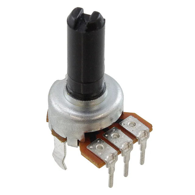

    可调电阻/电位器 10KΩ ±20% 80mW 插件
PDB12-H4251-103BF 数据手册
T PL IA N M CO *R oH S Features Applications ■ Single gang panel control ■ Audio/TV sets ■ RoHS compliant* ■ Amplifiers/mixers/drum machines/ synthesizers ■ Carbon element ■ Center detent option ■ PCs/monitors ■ Wide range of resistance tapers ■ Appliances ■ Insulated shaft styles ■ Assortment of pin layouts PDB12 Series - 12 mm Rotary Potentiometer Product Dimensions Electrical Characteristics Taper .................................... Linear, audio Standard Resistance Range ......................... 1K ohms to 1M ohms Standard Resistance Tolerance.....±20 % Residual Resistance ..........10 ohms max. Environmental Characteristics Power Rating Linear ...................................0.08 watt Audio ....................................0.04 watt Maximum Operating Voltage Linear ........................................ 150 V Audio ......................................... 100 V Sliding Noise ........................ 47 mV max. Operating Temperature..-10 °C to +70 °C PDB12-H PDB12-G L 2.6 (.102) 12.4 (.488) DIA. 8.7 (.342) DIA. 6.0 (.24) F 9.0 (.354) 4.6 (.181) 10.0 (.393) 12.4 DIA. (.488) Mechanical Characteristics 4.5 (.177) 4.0 (.157) 30 ° 1.5 (.059) 1 2 3 7.5 (.295) 12.4 (.488) 1 Derating Curve 100 2.5 (.098) 80 3 7.5 (.295) 2 RECOMMENDED PCB LAYOUT Rating Power Ratio (%) 4.5 (.177) 1.5 (.059) Mechanical Angle .....................300 ° ±5 ° Rotational Torque ............20 to 200 g-cm Stop Strength ..................... 3 kg-cm min. Rotational Life ................... 15,000 cycles Soldering Condition ............300 °C max. within 3 seconds Hardware .............. No hardware supplied 60 40 33 20 0 1.5 (.059) 2.6 (.102) 3.0 4.5 (.118) (.177) 6.0 (.236) 30 ° DIA. 6.0 (.24) F 4.5 (.177) 1.5 (.059) 3.2 (.125) L 3.7 (.145) 14.0 (.551) 12.6 (.496) 2.7 (.106) RECOMMENDED PCB LAYOUT 0 10 20 30 40 50 60 70 80 90 100 DIA. 1.0 (.039) 3 PLCS. Ambient Temperature (°C) 7.5 (.295) 4.0 (.157) SHAFT SHOWN IN CCW POSITION 2.7 (.106) 2.0 (.078) 12.0 (.472) SHAFT SHOWN IN CCW POSITION PDB12 Dimensions L 15 (.591) 20 (.787) 25 (.984) 30 (1.181) F 7 (.276) 7 (.276) 12 (.472) 12 (.472) DIMENSIONS: DIA. 1.0 (.039) 3 PLCS. 7.5 (.295) 10.0 (.393) MM (INCHES) 2 3 1 SCHEMATIC WARNING Cancer and Reproductive Harm www.P65Warnings.ca.gov *RoHS Directive 2015/863, Mar 31, 2015 and Annex. Specifications are subject to change without notice. Users should verify actual device performance in their specific applications. The products described herein and this document are subject to specific disclaimers as set forth on the last page of this document, and at www.bourns.com/legal/disclaimer.pdf. PDB12 Series - 12 mm Rotary Potentiometer Product Dimensions How To Order PDB12-F PDB12-M 3.6 2.6 (.141) (.102) L 9.0 (.354) DIA. 6.0 (.24) F 10.0 (.393) 4.5 (.177) 1.5 (.059) 12.8 (.503) PDB12 - H 4 20 1 - 103 A F L Model 3.0 6.5 (.118) (.255) 3.5 (.137) DIA. 6.0 (.24) F 10.0 (.393) 1.5 (.059) 2.0 (.078) 3.5 (.137) 30° 4.5 (.177) 1.5 (.059) 4.5 (.177) 4.5 (.177) Terminal Config. (see individual drawings) H = PC pins, rear facing snap mount G = PC pins, vertical/ down facing/ snap mount M = PC pins, rear facing F = PC pins, vertical/ down facing/ snap mount Option • 2 = Center Detent • 4 = No Detent 3.0 (.118) Standard Shaft Length • 15 = 15 mm • 20 = 20 mm • 25 = 25 mm • 30 = 30 mm 12.8 (.503) 30° Number of Gangs • 1 = Single Gang 1.5 (.059) Resistance Code (See Table) 1 2 Resistance Taper • A = Audio Taper • B = Linear Taper 3 RECOMMENDED PCB LAYOUT 12.6 (.496) Shaft Style • F = Flat Type Insulated Shaft 2.7 (.106) Other styles available. 1 1.6 (.062) 10.0 (.393) DIA. 1.0 (.039) 3 PLCS. 2 3 Standard Resistance Table RECOMMENDED PCB LAYOUT 7.5 (.177) 7.5 (.295) 3.0 (.118) SHAFT SHOWN IN CCW POSITION DIMENSIONS: MM (INCHES) 2.1 (.082) Resistance (Ohms) 1,000 2,000 5,000 10,000 20,000 50,000 100,000 200,000 500,000 1,000,000 DIA. 1.0 (.039) 3 PLCS. 1.6 (.062) 14.4 (.566) SHAFT SHOWN IN CCW POSITION Resistance Code 102 202 502 103 203 503 104 204 504 105 PDB12 Dimensions L 15 (.591) 20 (.787) 25 (.984) 30 (1.181) F 7 (.276) 7 (.276) 12 (.472) 12 (.472) 2 3 1 SCHEMATIC Asia-Pacific: Tel: +886-2 2562-4117 Email: asiacus@bourns.com EMEA: Tel: +36 88 885 877 Email: eurocus@bourns.com The Americas: Tel: +1-951 781-5500 Email: americus@bourns.com www.bourns.com REV. 10/19 Specifications are subject to change without notice. Users should verify actual device performance in their specific applications. The products described herein and this document are subject to specific legal disclaimers as set forth on the last page of this document, and at www.bourns.com/docs/legal/disclaimer.pdf. Legal Disclaimer Notice This legal disclaimer applies to purchasers and users of Bourns® products manufactured by or on behalf of Bourns, Inc. and P[ZHɉSPH[LZJVSSLJ[P]LS`¸)V\YUZ¹ Unless otherwise expressly indicated in writing, Bourns® products and data sheets relating thereto are subject to change ^P[OV\[UV[PJL
PDB12-H4251-103BF
物料型号:PDB12系列
器件简介:单帮面板控制的旋转电位器,符合RoHS标准,适用于音频设备、电视、PC、显示器、鼓机、合成器、家用电器等。
引脚分配:文档中未明确列出具体的引脚分配,但提到了多种引脚布局选项。
参数特性: - 电阻范围:1K欧姆至1M欧姆 - 电阻公差:±20% - 剩余电阻:最大10欧姆 - 功率等级:线性0.08瓦特,音频0.04瓦特 - 最大工作电压:线性150V,音频100V - 滑动噪声:最大47毫伏 - 工作温度:-10°C至+70°C
功能详解: - 机械角度:300°±5° - 旋转扭矩:20至200克-厘米 - 停止强度:最小3千克-厘米 - 旋转寿命:15,000次 - 焊接条件:最大300°C,3秒内
应用信息:适用于音频/电视设备。
封装信息:提供了详细的产品尺寸和推荐PCB布局。
如何订购:提供了型号、端子配置、选项、标准轴长、帮数、电阻代码和电阻梯度的订购指南。
