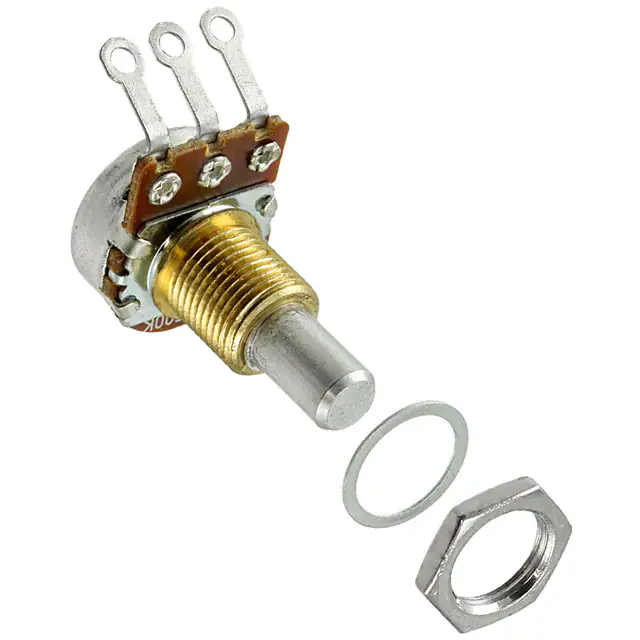

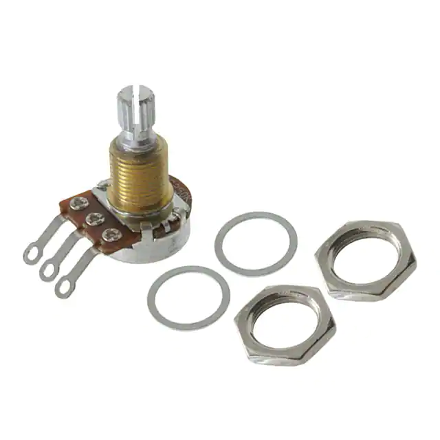

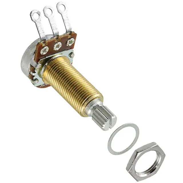

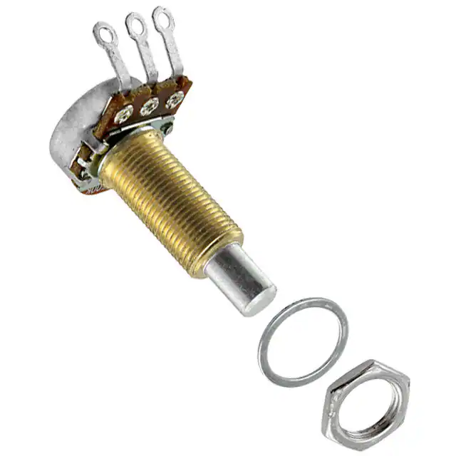

PL IA N T Features CO M ■ Carbon element *R oH S ■ Plain or knurled shaft option ■ Metal bushing ■ Metal shaft ■ Rear solder lugs ■ Compact size ■ Dual gang option PDB181-GTR Series - 17 mm Guitar Potentiometer Product Dimensions Electrical Characteristics Taper.................................. Linear, audio Standard Resistance Range ......................10 K ohms to 1 M ohms Standard Resistance Tolerance....±20 % Residual Resistance ................1 % max. PDB182-GTR01 PDB182-GTR02 PDB181-GTR01 PDB181-GTR02 9.3 (.366) 19.0 (.748) 9.5 (.374) 16.5 (.650) DIA. Rating Power Ratio (%) PLAIN PLAIN 17.0 DIA. (.669) 30 ° ± 10 ° 1 3 SHAFT 2 2 17.0 DIA. (.669) 30 ° ± 10 ° FULL CW 3 1 5.00 (.197) PINOUT FOR “A” AND “B” TAPERS PINOUT FOR “C” TAPER 27.5 (1.083) Hardware 3 PLCS. 2.1 (.083) 3.7 3 PLCS. (.146) 5.00 (.197) DIA. 5.00 (.197) 19.0 (.748) 6.0 (.236) UNDER 1.0 1.0 (.039) (.039) 6.00 (.236) DIA. KNURLED SHAFT (LONG) 12.7 ± 0.5 (.472 ± .020 2.3 ± 0.2 (.091 ± .008) 12.0 ± 0.5 DIA. (.472 ± .020) WARNING Cancer and Reproductive Harm www.P65Warnings.ca.gov PINOUT FOR “A” AND “B” TAPERS PINOUT FOR “C” TAPER 5.00 (.197) PDB18x-GTR03 PDB18x-GTR04 WASHER 3 1 2.0 (.079) 10 20 30 40 50 60 70 80 90 100 9.5 ± 0.3 (.374 ± .012) DIA. 2 2 5.00 (.197) DIA. 3/8”NEF 1 3 FULL CW 5.00 (.197) 3 PLCS. 2.1 (.083) 3.7 3 PLCS. (.146) 5.00 (.197) 80 NUT 6.00 DIA. (.236) SHAFT 2.0 (.079) Ambient Temperature (°C) C0.5 18 TEETH 3/8”NEF 6.00 DIA. (.236) 100 0 1.0 1.5 (.059) (.039) 6.00 (.236) DIA. KNURLED SHAFT C0.5 18 TEETH Derating Curve 60 40 33 20 0 6.0 (.236) KNURLED SHAFT Mechanical Characteristics Mechanical Angle ................... 300 ° ±5 ° Rotational Torque ..........10 to 150 gf-cm Stop Strength..................... 5 kg-cm min. Rotational Life...................15,000 cycles Soldering Condition ............ 260 °C max. within 3 seconds Hardware .............. Two flat washers and two mounting nuts supplied per potentiometer 19.0 (.748) 9.5 (.374) 1.0 1.5 (.059) (.039) 6.00 (.236) DIA. Environmental Characteristics Operating Temperature ..................................-10 °C to +50 °C Power Rating Linear ..................................... 0.2 watt Dual Section ................. 0.125 watt Audio...................................... 0.1 watt Dual Section ................... 0.06 watt Maximum Operating Voltage Linear .........................................200 V Audio..........................................150 V Sliding Noise........................47 mV max. 11.3 (.445) 6.0 (.236) 3/8”NEF 5.00 (.197) TOLERANCES: ±0.5 10.0 ~ 100 ±0.3 10.0 = = (.394 ~ 3.937) (±.020) (.394) (±.012) DIMENSIONS: MM (INCHES) C0.5 18 TEETH 6.00 DIA. (.236) PLAIN SHAFT (LONG) *RoHS Directive 2015/863, Mar 31, 2015 and Annex. Specifications are subject to change without notice. Users should verify actual device performance in their specific applications. The products described herein and this document are subject to specific disclaimers as set forth on the last page of this document, and at www.bourns.com/legal/disclaimer.pdf. Additional Features ■ Variety of resistance values ■ Audio or linear taper option ■ RoHS compliant* PDB181-GTR Series - 17 mm Guitar Potentiometer Taper Charts Circuit A Series Tapers 100 How to Order Single Gang PDB18 1 - GTR 01 - 103 A2 Model 90 Number of Sections 1 = Single Section 2 = Dual Section Terminal 1-2 Output Voltage X 100 (%) Terminal 1-3 Input Voltage 80 70 Guitar Pot Designator Configuration 01 = Knurled Shaft/Solder Lugs 02 = Plain Shaft/Solder Lugs 03 = Knurled Shaft (Long)/Solder Lugs 04 = Plain Shaft (Long)/Solder Lugs 60 1 2 3 50 40 Dual Gang 2 30 20 A3 A): (15 A2 A): 0 1 ( 10 0 10 20 30 40 50 60 70 80 90 R1 1 3 R2 1’ 3’ 100 Resistance Code (See Table) Resistance Taper (See Taper Charts) Standard Resistance Table Rotational Travel (%) 2’ B0 Taper 100 90 Terminal 1-2 Output Voltage X 100 (%) Terminal 1-3 Input Voltage 80 70 60 50 Resistance (Ohms) 10,000 25,000 50,000 100,000 250,000 300,000 500,000 1,000,000 Resistance Code 103 253 503 104 254 304 504 105 40 30 20 10 0 10 20 30 40 50 60 70 80 90 100 Rotational Travel (%) C2 Taper 100 90 Terminal 1-2 Output Voltage X 100 (%) Terminal 1-3 Input Voltage 80 70 60 50 40 30 20 10 0 10 20 30 40 50 60 Rotational Travel (%) 70 80 90 100 Asia-Pacific: Tel: +886-2 2562-4117 • Email: asiacus@bourns.com EMEA: Tel: +36 88 885 877 • Email: eurocus@bourns.com The Americas: Tel: +1-951 781-5500 • Email: americus@bourns.com www.bourns.com REV. 10/19 Specifications are subject to change without notice. Users should verify actual device performance in their specific applications. The products described herein and this document are subject to specific legal disclaimers as set forth on the last page of this document, and at www.bourns.com/docs/legal/disclaimer.pdf. Legal Disclaimer Notice This legal disclaimer applies to purchasers and users of Bourns® products manufactured by or on behalf of Bourns, Inc. and P[ZHɉSPH[LZJVSSLJ[P]LS`¸)V\YUZ¹ Unless otherwise expressly indicated in writing, Bourns® products and data sheets relating thereto are subject to change ^P[OV\[UV[PJL
