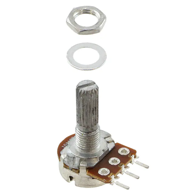

    可调电阻/电位器 10KΩ ±20% 200mW
PDB181-P415K-103B 数据手册
PL IA N T Features CO M ■ Single and dual section control *R oH S ■ Metal shaft styles ■ Carbon element ■ Center and multiple detent options ■ Wide range of resistance tapers ■ Plain or knurled shaft options PDB18 Series - 17 mm Rotary Potentiometer Electrical Characteristics Taper .................................... Linear, audio Standard Resistance Range ....................... 1 K ohms to 1 M ohms Standard Resistance Tolerance.....±20 % Residual Resistance ................. 1 % max. Environmental Characteristics Operating Temperature ...-10 °C to +50 °C Power Rating Linear .....................................0.2 watt Dual Section..................0.125 watt Audio ......................................0.1 watt Dual Section....................0.06 watt Maximum Operating Voltage Linear ........................................ 200 V Audio ......................................... 150 V Sliding Noise ........................ 47 mV max. Product Dimensions PDB181-K PDB181-A L 6.0 DIA. (.236) M7 x P0.75 16.5 DIA. (.649) 6.0 DIA. (.236) A 1.0 (.039) 2.0 (.078) 18 TEETH KNURL 18 TEETH KNURL M7 x P0.75 17.0 (.669) 0.5 (.019) 3.6 (.141) 17.0 DIA. (.669) 8.4 (.330) 13.5 (.531) 30 ° 1.2 (.047) 2.8 (.110) 12.5 (.492) 1 2 4.0 (.157) 5.0 (.196) 80 2.5 (.098) 3.6 (.141) 15.0 (.590) 18.0 ± 0.5 (.708 ± .019) 4.0 (.157) 3 1.0 (.039) 100 2.0 (.078) 9.5 (.374) 1.0 (.039) 2.0 (.078) Derating Curve Rating Power Ratio (%) 6.5 (.255) A Mechanical Characteristics Mechanical Angle .................... 300 ° ±5 ° Rotational Torque .......... 10 to 150 gf-cm Detent Torque ............... 150 to 500 g-cm Stop Strength ..................... 5 kg-cm min. Rotational Life ................... 15,000 cycles Soldering Condition ........... 260 °C max. within 3 seconds Hardware .................One flat washer and mounting nut supplied per potentiometer with bushing 60 40 33 20 0 L 6.5 (.255) 2.0 (.078) 9.5 (.374) 5.0 (.196) 8.4 (.330) 30 ° 1.2 .047) SHAFT SHOWN IN CCW POSITION 0 10 20 30 40 50 60 70 80 90 100 MM (INCHES) DIMENSIONS: Ambient Temperature (°C) 1 2 1 3 2 10.0 (.393) 3 1.0 (.039) SCHEMATIC SHAFT SHOWN IN CCW POSITION WARNING Cancer and Reproductive Harm www.P65Warnings.ca.gov *RoHS Directive 2015/863, Mar 31, 2015 and Annex. Specifications are subject to change without notice. Users should verify actual device performance in their specific applications. The products described herein and this document are subject to specific disclaimers as set forth on the last page of this document, and at www.bourns.com/legal/disclaimer.pdf. Additional Features Applications ■ Linear, audio and reverse audio taper ■ Audio/TV sets options ■ RoHS compliant* ■ Amplifiers/mixers/drum machines/ synthesizers ■ PCs/monitors ■ Appliances PDB18 Series - 17 mm Rotary Potentiometer Product Dimensions PDB181-B 2.0 (.078) 9.5 (.374) PDB181-D PDB181-E L 6.5 (.255) 6.0 DIA. (.236) A L 6.5 (.255) 2.0 (.078) 9.5 (.374) A DIA. 6.0 (.236) 16.5 DIA. (.649) 1.0 (.039) 2.0 (.078) M7 x P0.75 1.0 (.039) 2.0 (.078) 18 TEETH KNURL 7.8 (.307) 30 ° 1.2 (.047) 2.8 (.110) 13.0 (.511) 3.5 (.137) 1 15.0 (.590) 2 5.0 (.196) 3 3.5 (.137) SHAFT SHOWN IN CCW POSITION DIMENSIONS: 8.4 (.330) 30 ° 1.2 (.047) 23.0 ± 0.5 (.905 ± .019) 2.5 (.098) 2.0 1.0 (.078) (.039) M7 x P0.75 18 TEETH KNURL 0.5 (.019) 17.0 DIA. (.669) 8.4 (.330) 1.0 (.039) DIA. 6.0 (.236) 16.5 (.649) DIA. 3.5 (.137) 17.0 DIA. (.669) 9.0 (.354) A 18 TEETH KNURL M7 x P0.75 17.0 (.669) L 6.5 (.255) 2.0 (.078) 9.5 (.374) MM (INCHES) 2.8 (.110) 11.5 (.452) 1 5.0 (.196) 2 3 1.0 5.0 (.039) (.196) SHAFT SHOWN IN CCW POSITION 30 ° 1.2 (.047) 1 2 10.0 (.393) 3 3.5 (.137) SHAFT SHOWN IN CCW POSITION Specifications are subject to change without notice. Users should verify actual device performance in their specific applications. The products described herein and this document are subject to specific legal disclaimers as set forth on the last page of this document, and at www.bourns.com/docs/legal/disclaimer.pdf. PDB18 Series - 17 mm Rotary Potentiometer Product Dimensions L L ± 0.5 6.5 (.255) 2.0 (.078) 9.5 (.370) 6.5 (.255) 2.0 (.078) A DIA. 6.0 (.236) L 6.5 (.255) 2.0 (.078) 11.5 (.452) DIA. 6.0 +0/-0.1 (.236 +0/-.004) F 16.5 DIA. (.649) 1.0 (.039) 2.0 (.078) 3.5 (.137) M7 x P0.75 18 TEETH KNURL M7 x P0.75 11.5 (.452) R2 R1 30 ° 1.2 (.047) 3.5 (.138) 6.0 (.236) R1 3.8 (.149) 5.0 (.196) 17.0 DIA. (.669) 17.0 DIA. (.669) 7.8 (.307) 1.2 (.047) 2.8 (.110) 18 TEETH KNURL M7 x P0.75 R2 7.8 (.307) 1.0 (.039) 2.0 (.078) 4.5 (.177) 13.2 (.519) 17.0 DIA. (.669) DIA. 6.0 (.236) A 8.4 (.330) 30 ° ± 10 ° 30 ° 1.2 (.047) 16.5 (.649) 4.0 (.157) 2.8 (.110) 1 2 23.0 (.906) 3 12.5 (.492) 9.0 (.354) 3.5 (.137) 5.0 (.196) 2.8 (.110) 1 5.0 (.196) SHAFT SHOWN IN CCW POSITION 1 2 3 2.5 (.098) 1.0 (.039) 5.0 (.196) 2 3 1.0 (.039) 6 PLCS. 3.5 (.138) 5.0 (.196) 4.0 (.157) 5.0 (.196) SHAFT SHOWN IN CCW POSITION 5.0 (.196) SHAFT SHOWN IN CCW POSITION 2 R1 1 3 R2 1’ 3’ 2’ SCHEMATIC DIMENSIONS: MM (INCHES) Specifications are subject to change without notice. Users should verify actual device performance in their specific applications. The products described herein and this document are subject to specific legal disclaimers as set forth on the last page of this document, and at www.bourns.com/docs/legal/disclaimer.pdf. PDB18 Series - 17 mm Rotary Potentiometer Product Dimensions Shaft Styles K Type PDB182-D Dual Gang PDB182-E Dual Gang L 6.5 (.255) 6.5 (.255) 2.0 (.078) 11.5 (.452) A 2.0 (.078) 11.5 (.452) DIA. 6.0 (.236) L 15 (.591) 18 (.709) 20 (.787) 25 (.984) 30 (1.181) A 6.5 (.256) 6.5 (.256) 11.5 (.453) 14 (.551) 19 (.748) L A L ± 0.5 (L ± .020) 6.5 (.256) DIA. 6.0 (.236) 30 ° A R2 1.0 (.039) 2.0 (.078) 13.5 (.531) M7 x P0.75 R1 8.0 (.314) 14.0 (.551) 18 TEETH KNURL 11.5 (.453) 16.5 (.649) R1 1.2 (.047) 0.5 (.019) 18 TEETH KNURL 3.5 (.137) 4.5 (.177) 2.8 (.110) 5.0 (.196) 1.0 6 PLCS. (.039) 3 5.0 (.196) SHAFT SHOWN IN CCW POSITION 1 2 5.0 (.196) 3 5.0 (.196) SHAFT SHOWN IN CCW POSITION DIMENSIONS: SLOT SHOWN IN CCW POSITION 25 (.984) 30 (1.181) 6.0 DIA. (.236) 9.7 (.381) 2 20 (.787) L 30 ° 1.2 (.047) 2.8 (.110) 1.0 (.039) 18 TEETH KNURL 6.0 +0/-0.1 DIA. (.236 +0/-.004) P Type 17.0 DIA. (.669) 8.4 (.330) 30 ° 1 2.0 (.078) R2 17.0 DIA. (.669) 8.4 (.330) 1.0 (.039) 2.0 (.078) M7 x P0.75 F Type L 15 (.591) 20 (.787) 25 (.984) 30 (1.181) 35 (1.378) F 7 (.276) 12 (.472) 12 (.472) 12 (.472) 12 (.472) L ± 0.5 (L ± .020) 6.5 (.256) F DIA. 4.5 (.177) DIA. 6.0 +0/-0.1 (.236 +0/-.004) MM (INCHES) Specifications are subject to change without notice. Users should verify actual device performance in their specific applications. The products described herein and this document are subject to specific legal disclaimers as set forth on the last page of this document, and at www.bourns.com/docs/legal/disclaimer.pdf. PDB18 Series - 17 mm Rotary Potentiometer Tapers How To Order PDB18 1 - K 4 25 K - 103 A1 A Series Tapers 100 Model 90 Number of Sections • 1 = Single Section • 2 = Dual Section Terminal 1-2 Output Voltage X 100 (%) Terminal 1-3 Input Voltage 80 70 60 50 40 30 A6 ): ): A5 A (25 : A4 A) (20 A): A3 (15 A2 1 A): (10 5A): A (0 0A (3 20 10 0 10 20 30 40 50 60 70 80 90 100 Rotational Travel (%) B Series Tapers 5 (5B ): B 4 (3B (4B 70 60 50 40 Resistance Code 102 202 502 103 203 503 104 204 504 105 Standard Shaft Length • 15 = 15 mm • 18 = 18 mm • 20 = 20 mm • 25 = 25 mm • 30 = 30 mm 30 20 10 0 10 20 30 40 50 60 70 80 90 100 Rotational Travel (%) C Series Tapers 100 Shaft Style • F = Metal Flatted Shaft • K = Metal Knurled Type Shaft 18 Toothed Serration Type • P = Metal Plain Shaft Resistance Code (See Table) 90 Terminal 1-2 Output Voltage X 100 (%) Terminal 1-3 Input Voltage Resistance (Ohms) 1,000 2,000 5,000 10,000 20,000 50,000 100,000 200,000 500,000 1,000,000 Detent Option • 2 = Center Detent • 4 = No Detents • 5 = 10 Detent / 11 Position • 6 = 20 Detent / 21 Position • 7 = 30 Detent / 31 Position • 8 = 40 Detent / 41 Position ): B 80 Terminal 1-2 Output Voltage X 100 (%) Terminal 1-3 Input Voltage ): B (2B 3 ): B 2 (B ): (1B B ) 90 :B 1 100 Terminal Configuration (Pin Layout) (see individual drawings) • K = PC Pins vertical/ Down Facing (12.5 mm) • A = PC Pins vertical/ Down Facing (18.0 mm) • B = PC Pins vertical Down Facing (23.0 mm) • E = Solder Lugs Rear Facing • P = PC Pins Rear Facing • D = PC Pins Front Facing Standard Resistance Table 80 Resistance Taper (See Taper Charts) Taper Series followed by Curve Number 70 Other styles available. 60 50 40 (3 (25 0C): C C (20 ): C 6 5 (15 C): C ) C4 :C 3 (1 (05 0C) : C) :C C 1 30 20 10 0 10 20 30 40 50 60 Rotational Travel (%) 70 80 90 100 Asia-Pacific: Tel: +886-2 2562-4117 • Email: asiacus@bourns.com EMEA: Tel: +36 88 885 877 • Email: eurocus@bourns.com The Americas: Tel: +1-951 781-5500 • Email: americus@bourns.com www.bourns.com REV. 10/19 Specifications are subject to change without notice. Users should verify actual device performance in their specific applications. The products described herein and this document are subject to specific legal disclaimers as set forth on the last page of this document, and at www.bourns.com/docs/legal/disclaimer.pdf. Legal Disclaimer Notice This legal disclaimer applies to purchasers and users of Bourns® products manufactured by or on behalf of Bourns, Inc. and P[ZHɉSPH[LZJVSSLJ[P]LS`¸)V\YUZ¹ Unless otherwise expressly indicated in writing, Bourns® products and data sheets relating thereto are subject to change ^P[OV\[UV[PJL
PDB181-P415K-103B
物料型号:PDB18系列
器件简介:PDB18系列是17毫米旋转电位器,具有单节和双节控制选项,金属轴样式,碳膜元件,适用于专业音频应用。
引脚分配:文档中提供了多种型号的电位器,包括PDB181-A、PDB181-K、PDB181-P、PDB182-B、PDB182-K、PDB182-D、PDB182-E等,每种型号具有不同的引脚配置。
参数特性: - 标准电阻范围:1K欧姆至1M欧姆 - 标准电阻容差:±20% - 残余电阻:最大1% - 操作温度范围:-10°C至+50°C - 功率等级:线性0.2瓦,双节音频0.125瓦,单节音频0.1瓦,双节0.06瓦 - 最大操作电压:线性200V,音频150V
功能详解: - 机械角度:300°±5° - 旋转扭矩:10至150 gf-cm - 定位扭矩:150至500 g-cm - 停止强度:最小5 kg-cm - 旋转寿命:15,000次
应用信息:适用于音频/电视、放大器/混音器/鼓机/合成器、PC/监视器、家用电器等。
封装信息:提供了详细的产品尺寸和轴样式,包括金属扁平轴、金属带齿轴等。
