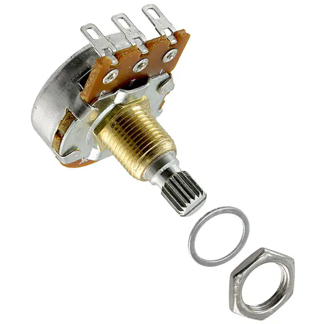

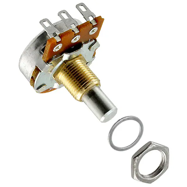

Features n Low torque n Carbon element n Plain or knurled shaft option n Metal bushing n Metal shaft n Rear solder lugs n Audio or linear taper options PDB241-GTR Series - 24 mm Guitar Potentiometer 11.5 (.453) 19.0 (.748) 1.0 (.039) n Variety of resistance values n RoHS compliant* 11.5 (.453) 27.5 (1.083) 1.0 (.039) 6.00 DIA. (.236) Product Dimensions 19.0 6.00 (.748) (.236) PDB241-GTR01 Taper........................................Audio,DIA. linear 18 TEETH 24.0 24.0 Standard Resistance 27.5± 0.5 KNURLED 18 TEETH (.945)11.5 19.0 ± 0.5 1.0 (.945)11.5 SHAFT 1.0 KNURLED DIA.(.453) ......................................10K ohms (1.083 ± .020) to 1M DIA.(.453) (.748 ± .020) (.039) SHAFT (.039)(LONG) Standard Resistance .........±20 % 6.0 19.0Tolerance. ± 0.3 6.00 6.0 6.0 9.5 ± 0.3 DIA. (.236) (.748 ± .012) (.236) (.374 ± .012) (.236) (.236) 3/8”-32UNF Environmental Characteristics 3/8”-32UNF 6.35 18 TEETH DIA. 24.0 24.0 DIA. (.250) KNURLED (.945) 18 TEETH PLAIN (.945) SHAFT Operating Temperature KNURLED 8.0 SHAFT 8.0DIA. DIA. PLAIN(LONG) SHAFT (LONG) (.315) (.315)..................................... -10 °C toSHAFT +70 5.0 °C 6.0 6.35 (.236) (.197) Power Rating................................. 0.25 watt DIA. (.250) Maximum Operating Voltage.............. 250 V M3/8”-32UNF 30M3/8”-32UNF ° FULL CCW 6.35 PLAIN DIA. Rotational Noise......................150 mV max. (.250) SHAFT 8.6 8.6 (LONG) PLAIN (.339) 10.0 (.339) SHAFT Mechanical Characteristics 6.35 (.394) DIA. 10.0 (.250) (.394) Mechanical Angle......................... 300 ° ±5 ° 9.7 DIA. (.382) Rotational Torque...................10 to 45 g-cm 3/8”-32UNF 30 ° FULL CCW Electrical Characteristics 9.5 (.374) Stop Strength.......................... 8 kg-cm min. 16.0 Rotational Life................ 15,000 cycles min. (.630) 9.7 Soldering Condition DIA. (.382) 3/8”-32UNF Manual Soldering 1 2 3 300 PINOUT FOR “A” AND “B” TAPERS ......................... °C within 3 seconds 3 Soldering 2 Wave 1 PINOUT FOR “C” TAPER 6.7 ......................... 260 6.7 °C within 3 seconds (.264) (.264) Hardware.................... Two flat washers and 20.0 2.0 14.0 (.787) two mounting nuts supplied (.079) per potentiometer (.551) Rating Power Ratio (%) 3.6 NUT 2.5 Derating (.142) Curve (.098) 100 3.0 UNDER 80 (.118) 60 40 33 20 0 DIA. WASHER 1.4TOLERANCES: 10.0 ~ 100 ±0.5 10.0 (.055) ±0.3 = = (.394 ~ 3.937) (±.020) (.394) (±.012) 2.0 (.079) NUT 1.0 (.039) 6.00 DIA. (.236) 19.0 ± 0.3 (.748 ± .012) 18 TEETH KNURLED SHAFT (LONG) 5.0 (.197) 24.0 (.945) DIA. M3/8”-32UNF 8.6 (.339) 10.0 (.394) PLAIN SHAFT (LONG) 6.35 DIA. (.250) DIA. 2.0 (.079) 11.5 (.453) 24.0 (.945) DIA. 8.6 (.339) 10.0 (.394) 9.7 (.382) 2 3 PINOUT FOR “A” AND “B” TAPERS TOLERANCES: 3 2 1 PINOUT FOR “C” TAPER 10.0 ~ 100 ±0.5 ±0.3 10.0 6.7 6.7 = = UNDER (.394 ~ 3.937) (±.020) (.264) (.394) (±.012) (.264) 20.0 (.787) 2.0 4.0 (.079) (.157) DIA. DIA. 14.0 (.551) DIA. WASHER 1 NUT 6.7 (.264) UNDER TOLERANCES: 10.0 ~ 100 ±0.5 10.0 ±0.3 = = (.394 ~ 3.937) (±.020) (.394) (±.012) DIMENSIONS: 2.0 (.079) DIA. MM (INCHES) How To Order Ambient Temperature (°C) PDB24 1 - GTR 01 - 504 A2 Model Number of Units 1 = Single Guitar Pot Designator Configuration 01 = Knurled Shaft / Solder Lugs 02 = Plain Shaft / Solder Lugs 03 = Knurled Shaft (Long) / Solder Lugs 04 = Plain Shaft (Long) / Solder Lugs Resistance Code (See Table) Resistance Taper (See Taper Charts) Standard Resistance Table WARNING Cancer and Reproductive Harm 27.5± 0.5 (1.083 ± .020) 14.0 (.551) 16.0 DIA. (.630) WASHER 10 20 30 40 50 60 70 80 90 100 Resistance Resistance (Ohms) Code 10,000 103 25,000 253 50,000 503 100,000 104 250,000 254 300,000 304 500,000 504 1,000,000 105 11.5 (.453) 3/8”-32UNF 2.0 DIA. (.079) 0 PDB241-GTR03 Circuit 1 2 3 www.P65Warnings.ca.gov 2 3 1 *RoHS Directive 2015/863, Mar 31, 2015 and Annex. 2 1 Specifications are subject to change without notice. Users should verify actual device performance in their specific applications. The products described herein and this document are subject to specific legal disclaimers as set forth on the last page of this document, and at www.bourns.com/docs/legal/disclaimer.pdf. 3 Rotational Travel (%) B0 Taper A2 Taper 100 100 90 90 80 Terminal 1-2 Output Voltage X 100 (%) Terminal 1-3 Input Voltage Terminal 1-2 Output Voltage X 100 (%) Terminal 1-3 Input Voltage 80 70 60 50 40 30 PDB241-GTR Series - 24 mm Guitar Potentiometer 20 Taper Charts 10 20 30 40 60 70 80 50 40 30 20 90 0 100 100 90 90 90 80 40 30 20 10 Terminal 1-2 Output Voltage X 100 (%) Terminal 1-3 Input Voltage Terminal 1-2 Output Voltage X 100 (%) Terminal 1-3 Input Voltage 60 50 70 60 50 40 30 20 30 40 50 60 70 80 90 100 50 60 70 80 90 100 70 80 90 100 70 60 50 40 30 20 10 10 20 40 80 80 70 30 C2 Taper B0 Taper 100 10 20 Rotational Travel (%) 100 0 10 Rotational Travel (%) A2 Taper Terminal 1-2 Output Voltage X 100 (%) Terminal 1-3 Input Voltage 50 60 10 10 0 70 0 10 20 Rotational Travel (%) 30 40 50 60 70 80 90 100 B0 Taper 0 10 20 30 40 50 60 Rotational Travel (%) Rotational Travel (%) C2 Taper 100 Other tapers available. 100 90 90 80 Terminal 1-2 Output Voltage X 100 (%) Terminal 1-3 Input Voltage Terminal 1-2 Output Voltage X 100 (%) Terminal 1-3 Input Voltage 80 70 60 50 40 30 20 70 60 50 40 30 20 10 10 0 10 20 30 40 50 60 70 80 90 100 0 Rotational Travel (%) 10 20 30 40 50 60 70 80 90 100 Rotational Travel (%) C2 Taper 100 90 Terminal 1-2 Output Voltage X 100 (%) Terminal 1-3 Input Voltage 80 70 60 50 40 30 20 10 0 10 20 30 40 50 60 70 80 90 100 Rotational Travel (%) REV. 05/20 Specifications are subject to change without notice. Users should verify actual device performance in their specific applications. The products described herein and this document are subject to specific legal disclaimers as set forth on the last page of this document, and at www.bourns.com/docs/legal/disclaimer.pdf. Legal Disclaimer Notice This legal disclaimer applies to purchasers and users of Bourns® products manufactured by or on behalf of Bourns, Inc. and its affiliates (collectively, “Bourns”). Unless otherwise expressly indicated in writing, Bourns® products and data sheets relating thereto are subject to change without notice. Users should check for and obtain the latest relevant information and verify that such information is current and complete before placing orders for Bourns® products. The characteristics and parameters of a Bourns® product set forth in its data sheet are based on laboratory conditions, and statements regarding the suitability of products for certain types of applications are based on Bourns’ knowledge of typical requirements in generic applications. The characteristics and parameters of a Bourns® product in a user application may vary from the data sheet characteristics and parameters due to (i) the combination of the Bourns® product with other components in the user’s application, or (ii) the environment of the user application itself. The characteristics and parameters of a Bourns® product also can and do vary in different applications and actual performance may vary over time. Users should always verify the actual performance of the Bourns® product in their specific devices and applications, and make their own independent judgments regarding the amount of additional test margin to design into their device or application to compensate for differences between laboratory and real world conditions. Unless Bourns has explicitly designated an individual Bourns® product as meeting the requirements of a particular industry standard (e.g., ISO/TS 16949) or a particular qualification (e.g., UL listed or recognized), Bourns is not responsible for any failure of an individual Bourns® product to meet the requirements of such industry standard or particular qualification. Users of Bourns® products are responsible for ensuring compliance with safety-related requirements and standards applicable to their devices or applications. Bourns® products are not recommended, authorized or intended for use in nuclear, lifesaving, life-critical or life-sustaining applications, nor in any other applications where failure or malfunction may result in personal injury, death, or severe property or environmental damage. Unless expressly and specifically approved in writing by two authorized Bourns representatives on a case-by-case basis, use of any Bourns® products in such unauthorized applications might not be safe and thus is at the user’s sole risk. Life-critical applications include devices identified by the U.S. Food and Drug Administration as Class III devices and generally equivalent classifications outside of the United States. Bourns expressly identifies those Bourns® standard products that are suitable for use in automotive applications on such products’ data sheets in the section entitled “Applications.” Unless expressly and specifically approved in writing by two authorized Bourns representatives on a case-by-case basis, use of any other Bourns® standard products in an automotive application might not be safe and thus is not recommended, authorized or intended and is at the user’s sole risk. If Bourns expressly identifies a sub-category of automotive application in the data sheet for its standard products (such as infotainment or lighting), such identification means that Bourns has reviewed its standard product and has determined that if such Bourns® standard product is considered for potential use in automotive applications, it should only be used in such sub-category of automotive applications. Any reference to Bourns® standard product in the data sheet as compliant with the AEC-Q standard or “automotive grade” does not by itself mean that Bourns has approved such product for use in an automotive application. Bourns® standard products are not tested to comply with United States Federal Aviation Administration standards generally or any other generally equivalent governmental organization standard applicable to products designed or manufactured for use in aircraft or space applications. Bourns expressly identifies Bourns® standard products that are suitable for use in aircraft or space applications on such products’ data sheets in the section entitled “Applications.” Unless expressly and specifically approved in writing by two authorized Bourns representatives on a case-by-case basis, use of any other Bourns® standard product in an aircraft or space application might not be safe and thus is not recommended, authorized or intended and is at the user’s sole risk. The use and level of testing applicable to Bourns® custom products shall be negotiated on a case-by-case basis by Bourns and the user for which such Bourns® custom products are specially designed. Absent a written agreement between Bourns and the user regarding the use and level of such testing, the above provisions applicable to Bourns® standard products shall also apply to such Bourns® custom products. Users shall not sell, transfer, export or re-export any Bourns® products or technology for use in activities which involve the design, development, production, use or stockpiling of nuclear, chemical or biological weapons or missiles, nor shall they use Bourns® products or technology in any facility which engages in activities relating to such devices. The foregoing restrictions apply to all uses and applications that violate national or international prohibitions, including embargos or international regulations. Further, Bourns® products and Bourns technology and technical data may not under any circumstance be exported or re-exported to countries subject to international sanctions or embargoes. Bourns® products may not, without prior authorization from Bourns and/or the U.S. Government, be resold, transferred, or re-exported to any party not eligible to receive U.S. commodities, software, and technical data. To the maximum extent permitted by applicable law, Bourns disclaims (i) any and all liability for special, punitive, consequential, incidental or indirect damages or lost revenues or lost profits, and (ii) any and all implied warranties, including implied warranties of fitness for particular purpose, non-infringement and merchantability. For your convenience, copies of this Legal Disclaimer Notice with German, Spanish, Japanese, Traditional Chinese and Simplified Chinese bilingual versions are available at: Web Page: http://www.bourns.com/legal/disclaimers-terms-and-policies PDF: http://www.bourns.com/docs/Legal/disclaimer.pdf C1753 05/17/18R

物料型号:PDB241-GTR系列
器件简介: - 低扭矩设计 - 符合RoHS标准 - 碳膜元素 - 提供平滑或带纹路的轴选项 - 金属衬套 - 后焊片 - 多种电阻值可选 - 音频或线性渐变选项
引脚分配: - 对于“A”和“B”渐变:1-2为输出,1-3为输入 - 对于“C”渐变:1-3为输出,2为输入
参数特性: - 电阻值范围:10K到1M欧姆 - 标准电阻公差:±20% - 操作温度范围:-10°C至+70°C - 功率等级:0.25瓦特 - 最大工作电压:250V - 旋转噪声:最大150毫伏 - 机械角度:300°±5° - 旋转扭矩:10到45克-厘米 - 停止强度:最小8公斤-厘米 - 旋转寿命:最小15,000周期
功能详解: - 提供详细的电阻值和代码对照表 - 电路配置选项,包括轴类型和焊片 - 渐变图表显示了不同渐变类型的输出电压与旋转行程的关系
应用信息: - 适用于音频设备,特别是吉他电位器
封装信息: - 产品尺寸详细列出,包括直径和长度 - 提供两种轴长度选项:标准和长轴 - 包含安装硬件信息,如两个安装螺母和两个平垫圈
