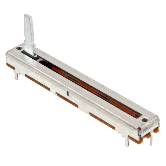

Features n Carbon element n Metal housing n 15-60 mm travel n Single and dual gang n Center detent option n RoHS compliant* Electrical Characteristics Taper..................................... Linear, audio Standard Resistance Range ........................ 1 K ohms to 1 M ohms Standard Resistance Tolerance......±20 % Residual Resistance ........................ 500 ohms or 1 % max. Insulation Resistance ......... Min. 100 megohms at 250 V DC PTA Series - Low Profile Slide Potentiometer Lever Style & Product Dimensions Operating Temperature ....................................-10 °C to +50 °C Power Rating, Linear 15 mm.....0.05 W (0.025 W Dual Gang) 20 mm........................... 0.1 W (0.05 W) 30 mm............................. 0.2 W (0.1 W) 45 mm....................... 0.25 W (0.125 W) 60 mm....................... 0.25 W (0.125 W) Power Rating, Audio 15 mm...0.025 W (0.015 W Dual Gang) 20 mm....................... 0.05 W (0.025 W) 30 mm........................... 0.1 W (0.05 W) 45 mm....................... 0.125 W (0.06 W) 60 mm....................... 0.125 W (0.06 W) Maximum Operating Voltage, Linear 15 mm................................... 100 V DC 20-60 mm.............................. 200 V DC Maximum Operating Voltage, Audio 15 mm..................................... 50 V DC 20-60 mm.............................. 150 V DC Withstand Voltage, Audio ................................ 1 Min. at 300 V AC Sliding Noise................. 100 mV maximum Tracking Error...............3 dB at -40 to 0 dB Click these links for more information: Actuator Styles DP METAL LEVER 4.0 (.157) 3.0 (.118) PRODUCT L 1.0 (.039) 5.0 (.196) 3.0 (.118) 4.0 (.157) 4.0 (.157) 5.0 (.197) L 5.0 (.196) CP METAL LEVER 5.0 (.196) 1.8 (.070) 4.0 (.157) 1.0 (.039) 2.0 (.087) 7.0 (.276) R 0.4 (.016) 2 PLCS. 10.4 (.409) 6.6 (.259) 1.0 (.039) SAMPLES CONTACT PTA 15 4 3 - 2 0 10 DP B 203 6.6 (.259) CI INSULATED LEVER TECHNICAL INVENTORY LIBRARY How To Order 1.0 (.039) Mechanical Characteristics Operating Force....................30 to 250 gf Stop Strength........................... 5 kgf min. Sliding Life.......................... 15,000 cycles Soldering Condition ... 350 °C max. within 3 ± 0.5 seconds Travel..................... 15, 20, 30, 45, 60 mm H 45 Environmental Characteristics Additional Information 1.2 (.047) Model Stroke Length • 15 = 15 mm • 20 = 20 mm • 30 = 30 mm • 45 = 45 mm • 60 = 60 mm Dust Cover Option • 4 = No Dust Cover No. of Gangs • 3 = Single Gang • 4 = Dual Gang Pin Style • 2 = PC Pins Down Facing Center Detent Option • 0 = No Detent • 2 = Center Detent Standard Lever Length (See Table) • 10 = 10 mm • 15 = 15 mm Lever Style • DP = Metal Lever (Refer to Drawing) • CP = Metal Lever (Refer to Drawing) • CI = Insulated Lever (Refer to Drawing) Resistance Taper • A = Audio Taper • B = Linear Taper Resistance Code (See Table) Other styles available. Dimension L H 15 (.591) 10 (.394) 10 (.394) 7 (.276) DIMENSIONS: MM (INCHES) WARNING Cancer and Reproductive Harm - www.P65Warnings.ca.gov *RoHS Directive 2015/863, Mar 31, 2015 and Annex. Specifications are subject to change without notice. Users should verify actual device performance in their specific applications. The products described herein and this document are subject to specific legal disclaimers as set forth on the last page of this document, and at www.bourns.com/docs/legal/disclaimer.pdf. Applications n Audio/TV sets n Amplifiers/mixers/drum machines/synthesizers n PCs/monitors 59 ± 0.5 (2.323 ± .020) n Appliances 8.2 ± 0.2 (.323 ± .008) PTA Series - Low Profile Slide Potentiometer T = NOTE: DUST COVER HAS ADHESIVE BACK. 0.3 ± 0.1 (.0118 ± .004) Product Dimensions PTAxx43 A B M2 x 0.4 2 PLCS. (.016) 9.0 (.354) 6.5 (.255) 5.7 (.224) 0.9 (.035) TRAVEL 4 PLCS. 1.5 ± 0.3 (.059 ± .012) 3.0 (.118) 0.5 (.019) C 3.7 (.146) D E DIA. 4 PLCS. 1.7 MIN. (.067) 1.2 MIN. (.047) 3 DIA. 3 PLCS. E 3.5 (.137) C 1 2 8.5 (.335) 3.5 (.138) 0.8 (.031) 8.5 (.335) 9.4 (.370) DIMENSIONS: MM (INCHES) D Single Gang Dimensions Schematic Model A B C D E Travel PTA1543 30 (1.18) 26 (1.02) 17.8 (.700) 20.2 (.795) 28.5 (1.12) 15 (.59) PTA2043 35 (1.37) 31 (1.22) 22.8 (.897) 25.2 (.992) 33.5 (1.32) 20 (.787) PTA3043 45 (1.77) 41 (1.61) 32.8 (1.29) 35.2 (1.38) 43.5 (1.71) 30 (1.18) PTA4543 60 (2.36) 56 (2.20) 47.8 (1.88) 50.2 (1.97) 58.5 (2.30) 45 (1.77) PTA6043 75 (2.95) 71 (2.79) 62.8 (2.47) 65.2 (2.56) 73.5 (2.89) 60 (2.36) SINGLE GANG 2 1 3 SCHEMATIC Specifications are subject to change without notice. Users should verify actual device performance in their specific applications. The products described herein and this document are subject to specific legal disclaimers as set forth on the last page of this document, and at www.bourns.com/docs/legal/disclaimer.pdf. PTA Series - Low Profile Slide Potentiometer Product Dimensions PTAxx44 A M2 x B 0.4 2 PLCS. (.016) 9.0 (.354) 6.5 (.255) 5.7 (.224) 0.9 (.035) TRAVEL 1.2 (.047) 3.0 (.118) 0.5 (.019) C 3.5 (.138) D 3.7 (.146) E E 3.5 (.137) C 2 1 2 1 8.5 (.335) 9.4 (.370) DIMENSIONS: MM (INCHES) 3 0.95 (.037) F 8.5 (.335) DIA. 4 PLCS. 1.7 MIN. (.067) 1.2 MIN. (.047) 3 DIA. 6 PLCS. 0.8 (.031) D Dual Gang Dimensions Schematic Model A B C D E F Travel PTA1544 30 (1.18) 26 (1.02) 17.8 (.700) 20.2 (.795) 28.5 (1.12) 18 (.708) 15 (.59) PTA2044 35 (1.37) 31 (1.22) 22.8 (.897) 25.2 (.992) 33 (1.29) 23 (.905) 20 (.787) PTA3044 45 (1.77) 41 (1.61) 32.8 (1.29) 35.2 (1.38) 43.5 (1.71) 33 (1.29) 30 (1.18) PTA4544 60 (2.36) 56 (2.20) 47.8 (1.88) 50.2 (1.97) 58.5 (2.30) 48 (1.88) 45 (1.77) PTA6044 75 (2.95) 71 (2.79) 62.8 (2.47) 65.2 (2.56) 73.5 (2.89) 63 (2.48) 60 (2.36) DUAL GANG 2 1 3 1 3 2 SCHEMATIC Specifications are subject to change without notice. Users should verify actual device performance in their specific applications. The products described herein and this document are subject to specific legal disclaimers as set forth on the last page of this document, and at www.bourns.com/docs/legal/disclaimer.pdf. PTA Series - Low Profile Slide Potentiometer Rating Power Ratio (%) Derating Curve 100 80 60 40 33 20 0 0 10 20 30 40 50 60 70 80 90 100 Ambient Temperature (°C) Standard Resistance Table Resistance Resistance (Ohms) Code 1,000 102 2,000 202 5,000 502 10,000 103 20,000 203 50,000 503 100,000 104 200,000 204 500,000 504 1,000,000 105 Tapers Audio Taper 100 90 80 Terminal 1-2 Output Voltage X 100 (%) Terminal 1-3 Input Voltage 70 60 50 40 30 20 10 0 10 20 30 40 50 60 70 80 90 100 70 80 90 100 Rotational Travel (%) Linear Taper 100 90 Terminal 1-2 Output Voltage X 100 (%) Terminal 1-3 Input Voltage 80 70 60 50 40 30 20 10 0 10 20 30 40 50 60 Rotational Travel (%) REV. 04/21 Specifications are subject to change without notice. Users should verify actual device performance in their specific applications. The products described herein and this document are subject to specific legal disclaimers as set forth on the last page of this document, and at www.bourns.com/docs/legal/disclaimer.pdf. Legal Disclaimer Notice This legal disclaimer applies to purchasers and users of Bourns® products manufactured by or on behalf of Bourns, Inc. and its affiliates (collectively, “Bourns”). Unless otherwise expressly indicated in writing, Bourns® products and data sheets relating thereto are subject to change without notice. Users should check for and obtain the latest relevant information and verify that such information is current and complete before placing orders for Bourns® products. The characteristics and parameters of a Bourns® product set forth in its data sheet are based on laboratory conditions, and statements regarding the suitability of products for certain types of applications are based on Bourns’ knowledge of typical requirements in generic applications. The characteristics and parameters of a Bourns® product in a user application may vary from the data sheet characteristics and parameters due to (i) the combination of the Bourns® product with other components in the user’s application, or (ii) the environment of the user application itself. The characteristics and parameters of a Bourns® product also can and do vary in different applications and actual performance may vary over time. Users should always verify the actual performance of the Bourns® product in their specific devices and applications, and make their own independent judgments regarding the amount of additional test margin to design into their device or application to compensate for differences between laboratory and real world conditions. Unless Bourns has explicitly designated an individual Bourns® product as meeting the requirements of a particular industry standard (e.g., ISO/TS 16949) or a particular qualification (e.g., UL listed or recognized), Bourns is not responsible for any failure of an individual Bourns® product to meet the requirements of such industry standard or particular qualification. Users of Bourns® products are responsible for ensuring compliance with safety-related requirements and standards applicable to their devices or applications. Bourns® products are not recommended, authorized or intended for use in nuclear, lifesaving, life-critical or life-sustaining applications, nor in any other applications where failure or malfunction may result in personal injury, death, or severe property or environmental damage. Unless expressly and specifically approved in writing by two authorized Bourns representatives on a case-by-case basis, use of any Bourns® products in such unauthorized applications might not be safe and thus is at the user’s sole risk. Life-critical applications include devices identified by the U.S. Food and Drug Administration as Class III devices and generally equivalent classifications outside of the United States. Bourns expressly identifies those Bourns® standard products that are suitable for use in automotive applications on such products’ data sheets in the section entitled “Applications.” Unless expressly and specifically approved in writing by two authorized Bourns representatives on a case-by-case basis, use of any other Bourns® standard products in an automotive application might not be safe and thus is not recommended, authorized or intended and is at the user’s sole risk. If Bourns expressly identifies a sub-category of automotive application in the data sheet for its standard products (such as infotainment or lighting), such identification means that Bourns has reviewed its standard product and has determined that if such Bourns® standard product is considered for potential use in automotive applications, it should only be used in such sub-category of automotive applications. Any reference to Bourns® standard product in the data sheet as compliant with the AEC-Q standard or “automotive grade” does not by itself mean that Bourns has approved such product for use in an automotive application. Bourns® standard products are not tested to comply with United States Federal Aviation Administration standards generally or any other generally equivalent governmental organization standard applicable to products designed or manufactured for use in aircraft or space applications. Bourns expressly identifies Bourns® standard products that are suitable for use in aircraft or space applications on such products’ data sheets in the section entitled “Applications.” Unless expressly and specifically approved in writing by two authorized Bourns representatives on a case-by-case basis, use of any other Bourns® standard product in an aircraft or space application might not be safe and thus is not recommended, authorized or intended and is at the user’s sole risk. The use and level of testing applicable to Bourns® custom products shall be negotiated on a case-by-case basis by Bourns and the user for which such Bourns® custom products are specially designed. Absent a written agreement between Bourns and the user regarding the use and level of such testing, the above provisions applicable to Bourns® standard products shall also apply to such Bourns® custom products. Users shall not sell, transfer, export or re-export any Bourns® products or technology for use in activities which involve the design, development, production, use or stockpiling of nuclear, chemical or biological weapons or missiles, nor shall they use Bourns® products or technology in any facility which engages in activities relating to such devices. The foregoing restrictions apply to all uses and applications that violate national or international prohibitions, including embargos or international regulations. Further, Bourns® products and Bourns technology and technical data may not under any circumstance be exported or re-exported to countries subject to international sanctions or embargoes. Bourns® products may not, without prior authorization from Bourns and/or the U.S. Government, be resold, transferred, or re-exported to any party not eligible to receive U.S. commodities, software, and technical data. To the maximum extent permitted by applicable law, Bourns disclaims (i) any and all liability for special, punitive, consequential, incidental or indirect damages or lost revenues or lost profits, and (ii) any and all implied warranties, including implied warranties of fitness for particular purpose, non-infringement and merchantability. For your convenience, copies of this Legal Disclaimer Notice with German, Spanish, Japanese, Traditional Chinese and Simplified Chinese bilingual versions are available at: Web Page: http://www.bourns.com/legal/disclaimers-terms-and-policies PDF: http://www.bourns.com/docs/Legal/disclaimer.pdf C1753 05/17/18R
PTA4553-2210DPB104
- 物料型号:PTA系列,包括单帮和双帮,有15mm至60mm行程长度的型号。 - 器件简介:这些是低剖面滑轨电位器,适用于专业音响应用,具有金属外壳和符合RoHS标准的碳元素。 - 引脚分配:文档中提供了单帮和双帮电位器的引脚分配图,但具体的引脚分配信息需要查看图表。 - 参数特性: - 标准电阻范围:1K ohms至1M ohms - 标准电阻容差:±20% - 剩余电阻:最大500 ohms或1% - 绝缘电阻:最小100兆欧姆 - 操作温度范围:-10°C至+50°C - 功率等级:根据行程长度不同,线性功率等级从0.05W至0.25W,音频功率等级从0.025W至0.125W - 最大操作电压:线性50V DC至200V DC,音频15mm 50V DC至150V DC - 功能详解:电位器具有中心定位选项,金属杠杆样式,绝缘杠杆样式,音频和线性电阻曲线。 - 应用信息:适用于音频/电视、放大器、混音器、鼓机、合成器、个人电脑、监视器和家用电器。 - 封装信息:提供了详细的尺寸图表,包括单帮和双帮的尺寸。
