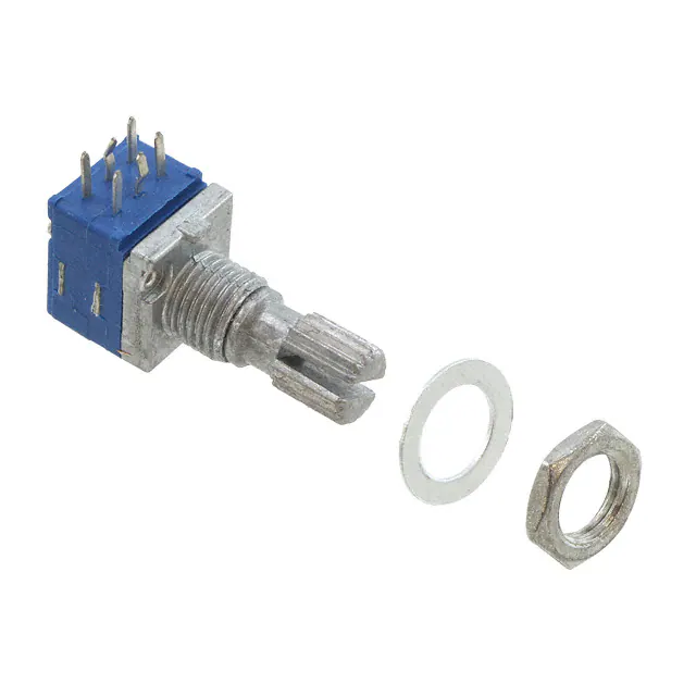

Features n Carbon element n Ganging up to 8 sections available n Knurled and flatted shaft styles n Audio taper option n Tracking error within 3 dB n RoHS compliant* PTD90 Series - 9 mm Multi-Ganged Potentiometer Electrical Characteristics Standard Resistance Range ........................ 1 K ohms to 1 M ohms Total Resistance Tolerance ..................................±10 % or ±20 % Standard Tapers.................Linear & audio Maximum Operating Voltage ................................ 150 VAC, 20 VDC Rated Power Linear Taper........................0.05 watts Audio Taper.......................0.025 watts Noise................................... 100 mV max. Insulation Resistance @ 250 VDC ........................................ 100 M ohms Dielectric Withstanding Voltage ...............................................300 VAC End Resistance..................20 ohms max. Tracking Error (-40 dB to 0 dB)........±3 dB Environmental Characteristics Operating Temperature ..................................-10 °C to +50 °C Rotational Life.................... 15,000 cycles IP Rating........................................... IP 40 Moisture Sensitivity Level........................1 ESD Classification (HBM)................... N/A Product Dimensions PTD901 9.65 ± 0.5 (.380 ± .020) M7XP0.75 M7XP0.75 0.8 ± 0.2 (.031 ± .008) R1 0.7 (.028) 0.3 (.012) R2 0.8 ± 0.2 (.031 ± .008) 5.0 (.197) R1 0.3 (.012) 5.0 (.197) 2.5 (.098) 2 PLCS. 0.7 (.028) 2 PLCS. RECOMMENDED PCB LAYOUT DIA. HOLES 3 PLCS. 1.0 +0.2/-0 (.039 +.008/-0) 5.0 (.197) 3 2 MOUNTING SURFACE 1 5.0 (.197) RECOMMENDED PCB LAYOUT DIA. HOLES 6 PLCS. 1.0 +0.2/-0 (.039 +.008/-0) R1 SCHEMATIC Mechanical Characteristics 5.0 (.197) 2 3 R1 1 DIMENSIONS: MM (INCHES) SCHEMATIC 5.0 (.197) 3 3 2 2 1 1 R2 R1 MOUNTING SURFACE 2.5 (.098) 2 R1 1 3 R2 1' 3' 2' Derating Curve Rating Power Ratio (%) Mechanical Angle....................300 ° ±10 ° Running Torque................10 to 250 g-cm Stop Strength........................... 4.0 kg-cm Shaft Push/Pull Strength........5.0 kgf min. Shaft Wobble......0.6 x L/20 mm p-p max. Mounting Torque.............. 7.0 kg-cm min. Soldering Condition Manual Soldering .........96.5 Sn/3.0 Ag/0.5 Cu solid wire or no-clean rosin cored wire 270 °C max. for 3 seconds Wave Soldering .............. 96.5 Sn/3.0 Ag/0.5 Cu solder with no-clean flux 260 °C max. for 5 seconds Wash Process....... Not recommended Mounting Hardware......... One flat washer and one mounting nut supplied per potentiometer PTD902 7.05 ± 0.5 (.278 ± .020) 100 80 60 40 33 20 0 0 10 20 30 40 50 60 70 80 90 100 Ambient Temperature (°C) Standard Resistance Table Resistance (Ohms) 1,000 2,000 5,000 10,000 20,000 50,000 100,000 200,000 500,000 1,000,000 Resistance Code 102 202 502 103 203 503 104 204 504 105 WARNING Cancer and Reproductive Harm - www.P65Warnings.ca.gov *RoHS Directive 2015/863, Mar 31, 2015 and Annex. Specifications are subject to change without notice. Users should verify actual device performance in their specific applications. The products described herein and this document are subject to specific legal disclaimers as set forth on the last page of this document, and at www.bourns.com/docs/legal/disclaimer.pdf. Applications n Audio/TV sets n Amplifiers/mixers/drum machines/synthesizers/DJ equipment n Multimedia sound systems n Portable electronics PTD90 Series - 9 mm Multi-Ganged Potentiometer Product Dimensions PTD904 PTD906 17.2 ± 0.5 (.677 ± .020) M7XP0.75 R4 R3 R2 R1 2.5 (.098) 2.5 (.098) 3 3 3 2 2 2 2 1 1 1 1 2.5 (.098) 5.0 (.197) 2.5 (.098) DIA. HOLES 2.5 12 PLCS. (.098) 1.0 +0.2/-0 (.039 +.008/-0) 3 3 5.0 (.197) 2.5 (.098) 3 3 3 3 3 2 2 2 2 2 1 1 1 1 1 1 5.0 R6 R5 (.197) R4 R3 2.5 (.098) 3 1 R3 3 DIA. HOLES 18 PLCS. 1.0 +0.2/-0 (.039 +.008/-0) 3 2.5 (.098) 5.0 (.197) 2 2 2 2 2 1 R5 1 R4 1 R3 DIMENSIONS: MM (INCHES) 1 R2 1 R1 3 3 5.0 (.197) 3 3 2 2 2 2 2 2 2 2 1 1 1 1 1 1 1 1 R4 R3 R6 R5 2.5 (.098) 2.5 (.098) 3 3 MOUNTING SURFACE DIA. HOLES 24 PLCS. 1.0 +0.2/-0 2.5 (.039 +.008/-0) (.098) R2 R1 SCHEMATIC 3 3 1 R1 1 R6 5.0 (.197) 3 2.5 (.098) 2 1 R2 M7XP0.75 0.8 ± 0.2 (.031 ± .008) 5.0 (.197) 5.0 (.197) 3 5.0 R8 R7 (.197) 3 3 5.0 (.197) 5.0 (.197) MOUNTING SURFACE R2 R1 2.5 (.098) 2.5 (.098) 2 1 R4 R2 R1 RECOMMENDED PCB LAYOUT 5.0 (.197) 2 3 2 2.5 (.098) 2.5 (.098) 3 3 2 R4 R3 5.0 (.197) SCHEMATIC 2 R6 R5 5.0 (.197) 5.0 (.197) 5.0 (.197) SCHEMATIC 3 2.5 (.098) R8 R7 0.8 ± 0.2 (.031 ± .008) RECOMMENDED PCB LAYOUT MOUNTING SURFACE R2 R1 M7XP0.75 R2 R1 5.0 (.197) 5.0 (.197) 3 32.2 ± 0.5 (1.268 ± .020) R4 R3 2.5 (.098) RECOMMENDED PCB LAYOUT 5.0 (.197) R4 R3 R6 R5 0.8 ± 0.2 (.031 ± .008) 5.0 (.197) 5.0 (.197) PTD908 24.7 ± 0.5 (.972 ± .020) 2 3 3 2 2 1 1 R8 R7 3 3 2 2 2 2 1 1 R6 R5 3 3 1 1 R4 R3 2 1 1 R2 R1 Specifications are subject to change without notice. Users should verify actual device performance in their specific applications. The products described herein and this document are subject to specific legal disclaimers as set forth on the last page of this document, and at www.bourns.com/docs/legal/disclaimer.pdf. PTD90 Series - 9 mm Multi-Ganged Potentiometer How To Order Product Dimensions F 6.0 +0/-0.1 6.0 +0/-0.1 (.236 +0/-.004) (.236 +0/-.004) Pin Style 50 DIA. DIA. 4.8 ± 0.3 4.8 ± 0.3 (.189 ± .012) (.189 ± .012) 6.5 ± 0.3 6.5 ± 0.3 (.256 ± .012) (.256 ± .012) 80 B B A A 15 (.591) 15 20 (.591) (.787) 20 25 (.787)(.984) 25 (.984) 5 (.197) 5 7 (.197) (.276) 7 10 (.276)(.394) 10 (.394) 6 (.236) 6 10 (.236) (.394) 10 12 (.394)(.472) 12 (.472) DIMENSIONS: Terminal 1-2 Output Voltage X 100 (%) Terminal 1-3 Input Voltage L L L B F MM (INCHES) 70 SHAFT SHOWN IN CCW POSITION SHAFT SHOWN IN CCW POSITION 60 50 40 30 15 L (.591) 15 20 25 (.787) (.591) (.984) 20 30 (.787)(1.181) 5 B (.197) 5 7 10 (.276) (.197) (.394) 7 10 (.276)(.394) 7 F (.276) 20 10 0 10 20 6 :A A5 12(30A) (25A)7: 4 12 ): A 0A ): A (.472) (.472) (2(.276) A (15 2 A A): (10 A): A1 (05 30 Tapers 40 50 60 12 12 (.472)(.472) 90 80 90 0 100 30 30 A6 A5 ): : 0A A) (3 (25 A4 A): (20 5A): A (1 A2 A): (10 A): A1 (05 20 10 20 30 40 50 60 70 80 90 :B 5 ): B 4 (3B 50 40 30 30 40 50 60 Rotational Travel (%) B Series Tapers 100 70 80 90 100 40 70 80 90 100 (3 (25 0C): C C (20 ): C 6 C) 5 (15 : C 4 C (10 ): C (05 C): C 2 C) :C 1 30 10 20 90 60 20 10 80 50 10 0 70 70 20 100 60 90 60 Rotational Travel (%) 50 80 ): B 70 40 C Series Tapers Terminal 2-3 Output Voltage X 100 (%) Terminal 1-3 Input Voltage 40 REV. 12/19 20 100 1 50 10 10 Rotational Travel (%) (4B Terminal 1-2 Output Voltage X 100 (%) Terminal 1-3 Input Voltage Terminal 1-2 Output Voltage X 100 (%) Terminal 1-3 Input Voltage 60 0 60 10 ): B (2B 3 ): B 2 (B ): (1B B ) 80 70 0 10 20 30 40 50 60 Rotational Travel (%) 80 (%) ): B (4B (%) (5B ): B 5 4 (3B ): B 3 (2B ): B 2 (B ): (1B B ): B 1 C Series Tapers Specifications are subject to change without notice. 100 100 Users should verify actual device performance in their specific applications. 90 The products described herein and this document are subject to specific90legal disclaimers as set forth on the last page of this document, and at www.bourns.com/docs/legal/disclaimer.pdf. 80 100 Other shaft styles available. 70 (5B 90 80 90 Resistance Code (See Table) 100 90 80 (.394) Resistance 30 Taper (See Taper Charts) 12 Taper Series followed by Curve Number 20 (.472) B Series Tapers A Series Tapers 70 Shaft Styles 50 = Knurled Type Shaft (Metal) 25 •K (.984) 18 Toothed Serration Type • F40 = Flatted Metal Shaft 10 Rotational Travel (%) 100 A) (15 Standard Shaft Length • 15 80 = 15 mm • 20 = 20 mm 70 = 25 mm • 25 • 30 = 30 mm 5.0 (.197) 5.0 (.197) (2 Center Detent Option B Series Tapers • 100 0 = No Detent • 2 = Center Detent 3.5 (.138) 3.5 (.138) PC Pins vertical/(10A): A2: A1 A) (05 down facing and ±20 % 10 20 30 40 50 60 Total Resistance Tolerance Rotational Travel (%) 1 0.8 (.031) A Series Tapers 2.0 (.079) 0.8 (.031) 2.0 (.079) 0.8 (.031) 90 5.0 5.0 (.197) (.197) SHAFT SHOWN IN CCW POSITION SHAFT SHOWN IN CCW POSITION 6.0 0.8 (.236) (.031) • 210 = 0 5 100 3.5 (.138) 3.5 (.138) 6.0 (.236) PC Pins vertical/ down facing and ±10 % 6 :A A5 Total Resistance A) A): 5 30 Tolerance ( (20A): A4: A ): B 0.8 (.031) 2.0 2.0 (.079) (.079) 0.8 0.8 (.031) (.031) • 1 = 40 30 20 ): B (2B 3 ): B 2 (B ): (1B B ): B 9.5 ± 0.3 9.5 ± 0.3 (.374 ± .012) (.374 ± .012) 60 ° 60 ° 4.5 4.5 (.177) (.177) (5B 6.0 +0/-0.1 6.0 +0/-0.1 (.236 +0/-.004) (.236 +0/-.004) DIA. DIA. 30 ° 30 ° 4.8 ± 0.3 4.8 ± 0.3 (.189 ± .012) (.189 ± .012) 6.5 ± 0.3 6.5 ± 0.3 (.256 ± .012) (.256 ± .012) 0.8 (.031) 4.5 (.177) 4.5 (.177) A Series Tapers No.100 of Sections • 1 = 1 Section • 902 = 2 Sections • 3 = 3 Sections • 804 = 4 Sections • 705 = 5 Sections • 6 = 6 Sections • 608 = 8 Sections 4 (3B F 1.0 (.039) 1.0 (.039) 9.5 ± 0.3 9.5 ± 0.3 (.374 ± .012) (.374 ± .012) 6.0 6.0 (.236) (.236) B B Model • PTD90 = No Switch 0.5 0.5 L ± L ± (.020) (.020) ): B B B PTD90 1 - 2 0 20 K - B 203 SHAFT STYLE SHAFT STYLE "F" "F" 0.5 0.5 L ± (.020) (.020) 1.5 1.5 (.059) (.059) 18 TEETH 18 TEETH KNURL A KNURL A (4B L ± Terminal 1-2 Output Voltage X 100 (%) Terminal 1-3 Input Voltage SHAFT STYLE SHAFT STYLE "K" "K" Terminal 1-2 Output Voltage X 100 (%) Terminal 1-3 Input Voltage Legal Disclaimer Notice This legal disclaimer applies to purchasers and users of Bourns® products manufactured by or on behalf of Bourns, Inc. and its affiliates (collectively, “Bourns”). Unless otherwise expressly indicated in writing, Bourns® products and data sheets relating thereto are subject to change without notice. Users should check for and obtain the latest relevant information and verify that such information is current and complete before placing orders for Bourns® products. The characteristics and parameters of a Bourns® product set forth in its data sheet are based on laboratory conditions, and statements regarding the suitability of products for certain types of applications are based on Bourns’ knowledge of typical requirements in generic applications. The characteristics and parameters of a Bourns® product in a user application may vary from the data sheet characteristics and parameters due to (i) the combination of the Bourns® product with other components in the user’s application, or (ii) the environment of the user application itself. The characteristics and parameters of a Bourns® product also can and do vary in different applications and actual performance may vary over time. Users should always verify the actual performance of the Bourns® product in their specific devices and applications, and make their own independent judgments regarding the amount of additional test margin to design into their device or application to compensate for differences between laboratory and real world conditions. Unless Bourns has explicitly designated an individual Bourns® product as meeting the requirements of a particular industry standard (e.g., ISO/TS 16949) or a particular qualification (e.g., UL listed or recognized), Bourns is not responsible for any failure of an individual Bourns® product to meet the requirements of such industry standard or particular qualification. Users of Bourns® products are responsible for ensuring compliance with safety-related requirements and standards applicable to their devices or applications. Bourns® products are not recommended, authorized or intended for use in nuclear, lifesaving, life-critical or life-sustaining applications, nor in any other applications where failure or malfunction may result in personal injury, death, or severe property or environmental damage. Unless expressly and specifically approved in writing by two authorized Bourns representatives on a case-by-case basis, use of any Bourns® products in such unauthorized applications might not be safe and thus is at the user’s sole risk. Life-critical applications include devices identified by the U.S. Food and Drug Administration as Class III devices and generally equivalent classifications outside of the United States. Bourns expressly identifies those Bourns® standard products that are suitable for use in automotive applications on such products’ data sheets in the section entitled “Applications.” Unless expressly and specifically approved in writing by two authorized Bourns representatives on a case-by-case basis, use of any other Bourns® standard products in an automotive application might not be safe and thus is not recommended, authorized or intended and is at the user’s sole risk. If Bourns expressly identifies a sub-category of automotive application in the data sheet for its standard products (such as infotainment or lighting), such identification means that Bourns has reviewed its standard product and has determined that if such Bourns® standard product is considered for potential use in automotive applications, it should only be used in such sub-category of automotive applications. Any reference to Bourns® standard product in the data sheet as compliant with the AEC-Q standard or “automotive grade” does not by itself mean that Bourns has approved such product for use in an automotive application. Bourns® standard products are not tested to comply with United States Federal Aviation Administration standards generally or any other generally equivalent governmental organization standard applicable to products designed or manufactured for use in aircraft or space applications. Bourns expressly identifies Bourns® standard products that are suitable for use in aircraft or space applications on such products’ data sheets in the section entitled “Applications.” Unless expressly and specifically approved in writing by two authorized Bourns representatives on a case-by-case basis, use of any other Bourns® standard product in an aircraft or space application might not be safe and thus is not recommended, authorized or intended and is at the user’s sole risk. The use and level of testing applicable to Bourns® custom products shall be negotiated on a case-by-case basis by Bourns and the user for which such Bourns® custom products are specially designed. Absent a written agreement between Bourns and the user regarding the use and level of such testing, the above provisions applicable to Bourns® standard products shall also apply to such Bourns® custom products. Users shall not sell, transfer, export or re-export any Bourns® products or technology for use in activities which involve the design, development, production, use or stockpiling of nuclear, chemical or biological weapons or missiles, nor shall they use Bourns® products or technology in any facility which engages in activities relating to such devices. The foregoing restrictions apply to all uses and applications that violate national or international prohibitions, including embargos or international regulations. Further, Bourns® products and Bourns technology and technical data may not under any circumstance be exported or re-exported to countries subject to international sanctions or embargoes. Bourns® products may not, without prior authorization from Bourns and/or the U.S. Government, be resold, transferred, or re-exported to any party not eligible to receive U.S. commodities, software, and technical data. To the maximum extent permitted by applicable law, Bourns disclaims (i) any and all liability for special, punitive, consequential, incidental or indirect damages or lost revenues or lost profits, and (ii) any and all implied warranties, including implied warranties of fitness for particular purpose, non-infringement and merchantability. For your convenience, copies of this Legal Disclaimer Notice with German, Spanish, Japanese, Traditional Chinese and Simplified Chinese bilingual versions are available at: Web Page: http://www.bourns.com/legal/disclaimers-terms-and-policies PDF: http://www.bourns.com/docs/Legal/disclaimer.pdf C1753 05/17/18R

物料型号:PTD90系列
器件简介:PTD90系列是9毫米多节电位器,具有碳元素,可串联多达8节,提供有螺纹和平面轴样式,音频渐进选项,跟踪误差在3dB以内,符合RoHS指令。
引脚分配:文档中提供了不同型号的电位器的引脚分配图,例如PTD901和PTD902,展示了不同引脚间的连接方式。
参数特性: - 标准电阻范围:1K欧姆至1M欧姆 - 总电阻公差:±10%或±20% - 标准渐进:线性和音频 - 最大工作电压:150VAC,20VDC - 额定功率:线性渐进0.05瓦,音频渐进0.025瓦 - 噪音:最大100毫伏 - 绝缘电阻:在250VDC下为100M欧姆 - 耐电压:300VAC - 端电阻:最大20欧姆 - 跟踪误差:±3dB
功能详解:电位器可应用于音频/电视、放大器/混音器/鼓机/合成器/DJ设备、多媒体音响系统、便携式电子产品等。
应用信息:适用于音频/电视、放大器/混音器/鼓机/合成器/DJ设备、多媒体音响系统、便携式电子产品等。
封装信息:提供了详细的产品尺寸和推荐PCB布局,包括直径孔、安装表面、推荐PCB布局图和尺寸。
