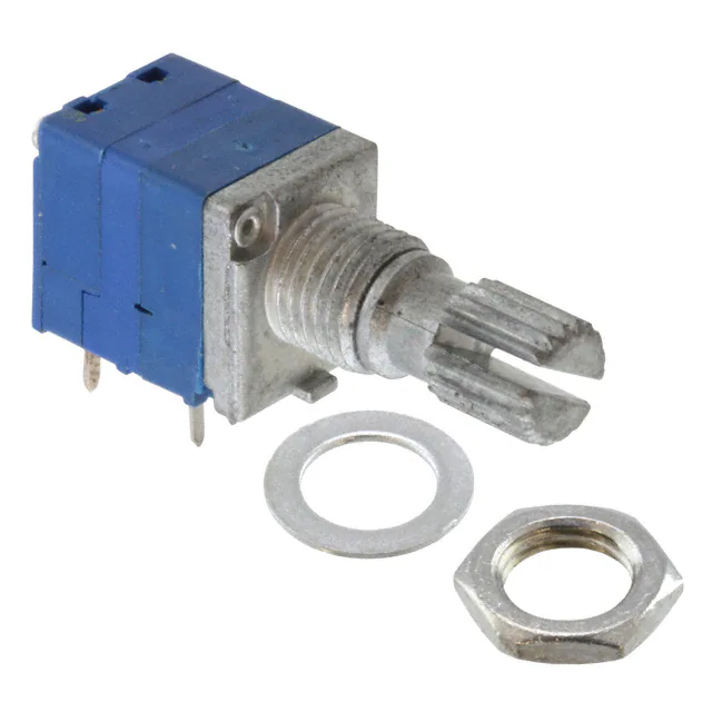

PTR901-2015K-B203
PTR901-2015K-B203
    BOURNS(伯恩斯)
    可调电阻/电位器 20KΩ ±20% 50mW
PTR901-2015K-B203 数据手册
Features n Carbon element n Ganging up to 8 sections available n Knurled and flatted shaft styles n Audio taper option n Tracking error within 3 dB n RoHS compliant* PTR90 Series - 9 mm Multi-Ganged Potentiometer w/Rotary Switch Product Dimensions PTR901 Additional Information PTR902 13.4 ± 0.5 (.528 ± .020) Click these links for more information: 15.8 ± 0.5 (.528 ± .020) PRODUCT TECHNICAL INVENTORY SAMPLES LIBRARY M7XP0.75 0.8 ± 0.2 (.014 ± .007) SW 0.3 (.012) 0.3 (.012) 0.7 (.028) 5.0 (.197) 6.25 (.246) SW 0.3 (.012) 2 PLCS. 0.7 (.028) 2 PLCS. 0.3 (.012) RECOMMENDED PCB LAYOUT 2.5 (.098) 6.25 (.246) 5.0 (.197) 6.25 (.246) M7XP0.75 0.8 ± 0.2 (.014 ± .007) 5.0 (.197) R2 R1 3 2 1 5.0 SW (.197) SCHEMATIC RECOMMENDED PCB LAYOUT MOUNTING SURFACE DIA. HOLES 5 PLCS. 1.0 +0.2/-0 (.039 +.008/-0) 2 2.5 (.098) 6.25 (.246) 5.0 SW (.197) 3 2 2 1 1 SW R2 R1 DIA. HOLES 8 PLCS. 1.0 +0.2/-0 (.039 +.008/-0) SCHEMATIC DIMENSIONS: 3 MM (INCHES) 2 100 80 3 SW 2 1 1 R2 R1 10 20 30 40 50 60 70 80 90 100 Ambient Temperature (°C) WARNING Cancer and Reproductive Harm www.P65Warnings.ca.gov *RoHS Directive 2015/863, Mar 31, 2015 and Annex. **Devices are tested using standard noise reduction filters. For optimum performance, designers should use noise reduction filters in their circuits. Specifications are subject to change without notice. Users should verify actual device performance in their specific applications. The products described herein and this document are subject to specific legal disclaimers as set forth on the last page of this document, and at www.bourns.com/docs/legal/disclaimer.pdf. Environmental Characteristics Operating Temperature ................................. -10 °C to +50 °C Rotational Life....................15,000 cycles IP Rating.......................................... IP 40 Contact Resistance..... 50 milliohms max. Rated Power..................... 3 A @ 16 VDC Detent Torque................... 400 g-cm max. Switch Activation Angle.............50 ° max. Mechanical Characteristics Standard Resistance Table 0 Electrical Characteristics Standard Resistance Range ........................1 K ohms to 1 M ohms Total Resistance Tolerance .................................. ±10 % or ±20 % Standard Tapers................Linear & audio Maximum Operating Voltage ............................... 150 VAC, 20 VDC Rated Power Linear Taper....................... 0.05 watts Audio Taper...................... 0.025 watts Noise...................................100 mV max. Insulation Resistance @ 250 VDC ........................................ 100 M ohms Dielectric Withstanding Voltage...300 VAC End Resistance................. 20 ohms max. Tracking Error (-40 dB to 0 dB)...... ±3 dB Switch Characteristics Derating Curve 60 40 33 20 0 MOUNTING SURFACE 3 R1 1 Rating Power Ratio (%) 3 5.0 (.197) CONTACT Resistance (Ohms) Resistance Code 1,000 2,000 5,000 10,000 20,000 50,000 100,000 200,000 500,000 1,000,000 102 202 502 103 203 503 104 204 504 105 CAUTION Do not store product in high temperature and humidity, direct sunlight and/or places where corrosive gases may be generated. Please use product within 6 months from the date of delivery and promptly after unpacking. Mechanical Angle...................300 ° ±10 ° Running Torque................10 to 250 g-cm Stop Strength........................... 4.0 kg-cm Shaft Push/Pull Strength....... 5.0 kgf min. Shaft Wobble...... 0.6 x L/20 mm p-p max. Mounting Torque............... 7.0 kg-cm min. Soldering Condition Manual Soldering .........96.5 Sn/3.0 Ag/0.5 Cu solid wire ............... or no-clean rosin cored wire ................. 270 °C max. for 3 seconds Wave Soldering ..............96.5 Sn/3.0 Ag/0.5 Cu solder ................................ with no-clean flux ................. 260 °C max. for 5 seconds Wash Process....... Not recommended Mounting Hardware.........One flat washer ...........and one mounting nut supplied ................................per potentiometer Applications n Audio/TV sets n Automotive sound systems n Amplifiers/mixers/drum machines/synthesizers/DJ equipment n Multimedia sound systems n Portable electronics PTR90 Series – 9 mm Multi-Ganged Potentiometer w/Rotary Switch Product Dimensions PTR904 PTR908 PTR906 SW R4 R3 SW M7XP0.75 R2 R1 6.25 (.246) 0.8 ± 0.2 (.014 ± .007) 5.0 (.197) 2.5 (.098) 6.25 (.246) 3 3 3 3 2 2 2 2 1 1 1 1 R4 R3 2.5 (.098) 5.0 (.197) MOUNTING SURFACE R2 R1 DIA. HOLES 14 PLCS. 1.0 +0.2/-0 (.039 +.008/-0) SCHEMATIC SW 3 2 3 3 2 2 3 3 3 3 3 3 2 2 2 2 2 2 1 1 1 1 1 1 2 1 1 1 1 R4 R3 R2 R1 R2 R1 3 2 2 2 1 SW 3 1 R6 R5 DIA. HOLES 20 PLCS. 1.0 +0.2/-0 (.039 +.008/-0) 3 1 R4 R3 DIMENSIONS: 5.0 (.197) 2.5 (.098) MM (INCHES) 1 5.0 (.197) 2.5 (.098) 6.25 (.246) 5.0 (.197) 3 3 3 3 3 3 3 3 2 2 2 2 2 2 2 2 1 1 1 1 1 1 1 1 R8 R7 5.0 (.197) 2 1 2.5 (.098) 2.5 (.098) SW 3 R2 R1 5.0 (.197) 5.0 (.197) MOUNTING SURFACE 2 2 1 5.0 (.197) 2.5 (.098) 2.5 (.098) 5.0 (.197) 3 M7XP0.75 0.8 ± 0.2 (.014 ± .007) R2 R1 RECOMMENDED PCB LAYOUT 2.5 (.098) 3 R4 R3 2.5 (.098) 5.0 (.197) 5.0 (.197) R4 R3 R6 R5 5.0 (.197) 2.5 (.098) R6 R5 R8 R7 6.25 (.246) 2.5 (.098) 2.5 (.098) 5.0 (.197) SCHEMATIC 3 SW 5.0 SW (.197) M7XP0.75 0.8 ± 0.2 (.014 ± .007) 5.0 (.197) R2 R1 RECOMMENDED PCB LAYOUT 2.5 (.098) 5.0 (.197) 2.5 (.098) 6.25 (.246) RECOMMENDED PCB LAYOUT 5.0 (.197) R4 R3 5.0 (.197) 5.0 (.197) 2.5 (.098) R6 R5 6.25 (.246) 2.5 (.098) 2.5 (.098) 5.0 SW (.197) 38.3 ± 0.5 (1.508 ± .020) 30.8 ± 0.5 (1.213 ± .020) 23.3 ± 0.5 (.917 ± .020) R6 R5 SCHEMATIC 3 3 2 SW 3 R4 R3 3 2 2 R2 R1 3 MOUNTING SURFACE DIA. HOLES 26 PLCS. 1.0 +0.2/-0 (.039 +.008/-0) 3 2 2 3 3 2 2 2 1 1 1 1 1 1 1 1 R8 R7 R6 R5 R4 R3 R2 R1 Asia-Pacific: Tel: +886-2 2562-4117 • Email: asiacus@bourns.com EMEA: Tel: +36 88 885 877 • Email: eurocus@bourns.com The Americas: Tel: +1-951 781-5500 • Email: americus@bourns.com www.bourns.com Specifications are subject to change without notice. Users should verify actual device performance in their specific applications. The products described herein and this document are subject to specific legal disclaimers as set forth on the last page of this document, and at www.bourns.com/docs/legal/disclaimer.pdf. PTR90 Series – 9 mm Multi-Ganged Potentiometer w/Rotary Switch Product Dimensions F 6.0 +0/-0.1 6.0 +0/-0.1 (.236 +0/-.004) (.236 +0/-.004) DIA. DIA. 4.8 ± 0.3 4.8 ± 0.3 (.189 ± .012) (.189 ± .012) 6.5 ± 0.3 6.5 ± 0.3 (.256 ± .012) (.256 ± .012) B A 6 (.236) 12 (.472) MM (INCHES) DIMENSIONS: SHAFT SHOWN IN CCW POSITION SHAFT SHOWN IN CCW POSITION 60 50 15 20 (.591)(.787) 5 5 7 B (.197)(.276) (.197) 7 12 7 A6 F ): ): A5 A (.276) (30A ((.276) 25 A4(.472) : L 40B 30 20 25 (.787)(.984) 7 10 (.276)(.394) 12 12 (.472)(.472) L 15 (.591) F A) (20 5A): A (1 A2 A): (10 A): A1 (05 20 10 10 20 30 40 50 60 70 12 (.472) 60 50 40 30 A6 A5 ): : 0A A) (3 (25 A4 A): (20 5A): A (1 A2 A): (10 A): A1 (05 20 10 10 20 30 40 50 60 70 80 90 80 90 0 100 REV. 07/21 10 20 30 5 4 (3B 40 50 60 Rotational Travel (%) B Series Tapers 1 100 70 80 90 100 40 70 80 90 100 (3 (25 0C): C C (20 ): C 6 5 C (15 ): C C) 4 (10 : C (05 C): C 2 C) :C 1 30 10 40 90 60 10 30 80 50 20 20 70 70 20 10 60 90 30 0 50 80 50 100 40 Rotational Travel (%) 60 Rotational Travel (%) :B 10 ): B 70 5 Other shaft styles available. (4B Terminal 1-2 Output Voltage X 100 (%) Terminal 1-3 Input Voltage 70 0 40 C Series Tapers ): B 90 80 100 100 (5B 90 90 Resistance Code (See Table) 20 100 80 80 Resistance Taper (See Taper Charts) Series followed by Curve Number Taper 30 B Series Tapers A Series Tapers 100 70 Shaft60Styles • K = Knurled Type Shaft (Metal) 18 Toothed Serration Type 50 • F = Flatted Metal Shaft Rotational Travel (%) Tapers Terminal 1-2 Output Voltage X 100 (%) Terminal 1-3 Input Voltage 10 (.394) MM (INCHES) DIMENSIONS: 0 25 (.984) Terminal 2-3 Output Voltage X 100 (%) Terminal 1-3 Input Voltage A 5 (.197) 10 (.394) 5.0 (.197) 5.0 (.197) :B 1 B 25 (.984) 90 Standard Shaft Length • 15 = 15 mm 80 • 20 = 20 mm • 25 70 = 25 mm ): B (2B 3 ): B 2 (B ): (1B B ) L 20 25 (.787)(.984) 7 10 (.276)(.394) 10 12 (.394)(.472) Terminal 1-2 Output Voltage X 100 (%) Terminal 1-3 Input Voltage 15 20 (.591) (.787) 5 7 (.197) (.276) 6 10 (.236) (.394) L 15 (.591) 80 70 3.5 (.138) 3.5 (.138) A): (15 Center Detent Option • 0 = No Detent B Series Tapers 100 • 2 = Center Detent 0.8 A(.031) Series Tapers 2.0 (.079) 0.8 (.031) 2.0 (.079) 0.8 (.031) 90 5.0 5.0 (.197) (.197) SHAFT SHOWN IN CCW POSITION SHAFT SHOWN IN CCW POSITION 6.0 0.8 (.236) (.031) (2 • 210= PC Pins vertical/ 10A): A2 A1 ( A): (05 down facing and ±20 % 0 10 20 30 40 50 60 Resistance Total Tolerance Rotational Travel (%) ): B 3.5 (.138) 3.5 (.138) 6.0 (.236) 100 PC Pins vertical/ down facing and ±10 % A6 A5 Total Resistance ): : 0A 5A) Tolerance (3 (20A): A4 A (5B 0.8 (.031) 2.0 2.0 (.079) (.079) 0.8 0.8 (.031) (.031) Pin Style 50 • 1 = 40 30 20 ): B (2B 3 ): B 2 (B ): (1B B ) 9.5 ± 0.3 9.5 ± 0.3 (.374 ± .012) (.374 ± .012) 60 ° 60 ° 4.5 4.5 (.177) (.177) 4 (3B 6.0 +0/-0.1 6.0 +0/-0.1 (.236 +0/-.004) (.236 +0/-.004) DIA. DIA. 30 ° 30 ° 4.8 ± 0.3 4.8 ± 0.3 (.189 ± .012) (.189 ± .012) 6.5 ± 0.3 6.5 ± 0.3 (.256 ± .012) (.256 ± .012) 0.8 (.031) 4.5 (.177) 4.5 (.177) A Series Tapers No.100 of Sections • 1 = 1 Section • 902 = 2 Sections • 3 = 3 Sections • 804 = 4 Sections • 705 = 5 Sections • 6 = 6 Sections • 608 = 8 Sections ): B F 1.0 (.039) 1.0 (.039) 9.5 ± 0.3 9.5 ± 0.3 (.374 ± .012) (.374 ± .012) 6.0 6.0 (.236) (.236) B B Model • PTR90 = With Rotary Switch 0.5 L ± 0.5 L ± (.020) (.020) (4B B B PTR90 1 - 2 0 20 K - B 203 SHAFT STYLE SHAFT STYLE "F" "F" 0.5 L ± 0.5 (.020) (.020) 1.5 1.5 (.059) (.059) 18 TEETH 18 TEETH KNURL A KNURL A Terminal 1-2 Output Voltage X 100 (%) Terminal 1-3 Input Voltage L ± Terminal 1-2 Output Voltage X 100 (%) Terminal 1-3 Input Voltage SHAFT STYLE SHAFT STYLE "K" "K" How To Order 0 10 20 30 40 50 60 Rotational Travel (%) ): B (5B :B 4 (3B 80 (%) ): B (4B (%) 80 ): B (2B 3 ): B 2 (B ): (1B B ) 5 1 C Series Tapers Specifications are subject to change without notice. 100 100 Users should verify actual device performance in their specific applications. 90 The products described herein and this document are subject to specific 90 legal disclaimers as set forth on the last page of this document, and at www.bourns.com/docs/legal/disclaimer.pdf. Legal Disclaimer Notice This legal disclaimer applies to purchasers and users of Bourns® products manufactured by or on behalf of Bourns, Inc. and P[ZHɉSPH[LZJVSSLJ[P]LS`¸)V\YUZ¹ Unless otherwise expressly indicated in writing, Bourns® products and data sheets relating thereto are subject to change ^P[OV\[UV[PJL
PTR901-2015K-B203
物料型号:PTR901、PTR902、PTR904、PTR906、PTR908
器件简介:BOURNS PTR90系列电位器是一款多联电位器,带有旋转开关,适用于音频/电视、汽车音响系统、放大器/混音器/鼓机/合成器/DJ设备、多媒体音响系统和便携式电子产品。
引脚分配:文档中提供了详细的引脚分配图,例如PTR901有三个引脚,分别为1、2、3。
参数特性: - 工作温度:-10°C至+50°C - 旋转寿命:15,000次 - IP等级:IP40 - 接触电阻:最大50毫欧姆 - 额定功率:3A @ 16VDC - 定位扭矩:最大400克-厘米 - 开关激活角度:最大50度
功能详解: - 碳膜片 - 可组合多达8个部分 - 可选择滚花和平面轴样式 - 音频渐进选项 - 跟踪误差在3分贝以内 - 符合RoHS标准
应用信息:适用于音频/电视、汽车音响系统、放大器/混音器/鼓机/合成器/DJ设备、多媒体音响系统和便携式电子产品。
封装信息:提供了不同型号的尺寸信息,例如PTR901的尺寸为13.4 ± 0.5毫米,以及推荐的PCB布局和安装表面信息。
