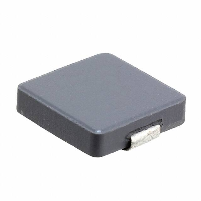

    功率电感 10µH ±20% IND_13.5X12.5MM_SM 3.30mm 13.50 x 12.50mm 29mΩ 7A
SRP1238A-100M 数据手册
Features C- *R Q2 o 00 HS CO an M d PL IA NT ■ Shielded construction ■ Carbonyl powder core ■ High saturation current AE ■ Inductance range: 0.10 to 10 µH ■ AEC-Q200 compliant ■ RoHS compliant* and halogen free** SRP1238A Series - Shielded Power Inductors Electrical Specifications @ 25 °C General Specifications Bourns Part Number Inductance @ 100 KHz Q (Min.) SRF /1V @100 KHz (MHz) /1V Typ. L Tol. (μH) (%) DCR (mΩ) Typ. DCR (mΩ) Max. Irms (A) Isat (A) SRP1238A-R10Y SRP1238A-R15Y SRP1238A-R22M SRP1238A-R33M SRP1238A-R47M SRP1238A-R60M SRP1238A-R68M SRP1238A-R82M SRP1238A-1R0M SRP1238A-1R2M SRP1238A-1R5M SRP1238A-1R8M SRP1238A-2R2M SRP1238A-3R3M SRP1238A-4R7M SRP1238A-5R6M SRP1238A-6R8M SRP1238A-8R2M SRP1238A-100M 0.10 0.15 0.22 0.33 0.47 0.60 0.68 0.82 1.0 1.2 1.5 1.8 2.2 3.3 4.7 5.6 6.8 8.2 10 0.36 0.4 0.7 0.85 1.2 1.5 1.9 2.2 2.7 4 4.8 5.2 6.3 11 15.3 18 20 23 29 0.43 0.48 0.81 1.0 1.8 2.2 2.5 3.0 3.5 4.0 5.5 7.0 8.0 13.5 18.5 22.0 24.0 28.0 34.0 43 41 38.5 36.5 32 29 28 25 24 21 19 17 16 12 10 9.5 9 8.5 7 84 75 65 62 55 51 49 44 40 37 35 30 29 27 24 19 18 16 14 ± 30 ± 30 ± 20 ± 20 ± 20 ± 20 ± 20 ± 20 ± 20 ± 20 ± 20 ± 20 ± 20 ± 20 ± 20 ± 20 ± 20 ± 20 ± 20 10 10 10 10 10 15 15 15 15 20 20 20 20 20 20 20 20 20 20 175 140 125 85 80 53 50 45 40 35 30 27 25 20 15 15 13 12 11 Terminal Type NonLead Frame Test Voltage ....................................1.0 V Test Frequency ......................... 100 KHz Operating Temperature ................................-55 °C to +150 °C (Temperature rise included) Storage Temperature ................................-55 °C to +150 °C Rated Current ............ Inductance drops 20 % at Isat Temperature Rise .....40 °C at rated Irms Moisture Sensitivity Level ..................... 1 ESD Classification (HBM)................. N/A 1 Circuit design, component, PCB trace Lead Frame size and thickness, airflow and other cooling provisions all affect the part temperature. Part temperature should be verified in the end application. Materials Core .............................Carbonyl powder Wire ............................Enameled copper Terminal Finish ...................................Sn Packaging ....... 500 pcs. per 13-inch reel How to Order Product Dimensions SRP1238A - 100M Non-Lead Frame Terminal Lead Frame Terminal 13.5 ± 0.5 (.531 ± .020) 13.5 ± 0.5 (.531 ± .020) R15 1510 3R3 1510 Model Value Code (see table) Recommended Layout 12.5 ± 0.3 (.492 ± .012) 12.5 ± 0.3 (.492 ± .012) 3.3 ± 0.2 (.130 + .008) 5.0 (.197) 3.3 ± 0.2 (.130 + .008) 8.0 (.315) 2.75 ± 0.35 (.108 ± .014) 2.75 ± 0.35 (.108 ± .014) 2.3 ± 0.3 (.091 ± .012) 2.0 (.079) REF. 2.3 ± 0.3 (.091 ± .012) DIMENSIONS: MM (INCHES) WARNING Cancer and Reproductive Harm www.P65Warnings.ca.gov 2.0 (.079) REF. GRADUATED LINE GRADUATED LINE 4.7 ± 0.3 (.185 ± .012) 14.2 (.559) 4.7 ± 0.3 (.185 ± .012) DIMENSIONS: MM (INCHES) Please consult Bourns® Model SRP-A Series Visual Inspection Guide for detailed construction, processing and testing information. * RoHS Directive 2015/863, Mar 31, 2015 and Annex. **Bourns considers a product to be “halogen free” if (a) the Bromine (Br) content is 900 ppm or less; (b) the Chlorine (Cl) content is 900 ppm or less; and (c) the total Bromine (Br) and Chlorine (Cl) content is 1500 ppm or less. Specifications are subject to change without notice. Users should verify actual device performance in their specific applications. The products described herein and this document are subject to specific legal disclaimers as set forth on the last page of this document, and at www.bourns.com/docs/legal/disclaimer.pdf. SRP1238A Series - Shielded Power Inductors L vs. I Charts 0 0 DC Current (A) 30 0 62 0 46.5 90 0.4 60 0.2 30 0 0 11 0 42 35 0 49 60 0.6 30 0.3 0 104 2.0 78 1.0 52 0.5 26 0 14.8 22.2 29.6 90 60 1.0 30 0.5 7 60 1 30 0 21.75 0 29 14 28 21 20.4 10.2 SRP1238A-1R0M 3 60 2 30 1 0 10.8 16.2 DC Current (A) Temperature Rise (°C) 120 90 60 0.6 30 0.3 16 8 32 24 SRP1238A-1R8M 3.0 0 40 100 2.4 80 1.8 60 1.2 40 0.6 20 0 0 10 5 15 20 25 0 30 21.6 0 27 SRP1238A-4R7M 10 120 90 4 5.4 0 51 0.9 0 0 35 5 0 40.8 30.6 DC Current (A) SRP1238A-3R3M 6 Inductance (μH) 90 2 DC Current (A) 30 DC Current (A) Temperature Rise (°C) Inductance (μH) 120 3 14.5 60 0 120 1.5 0 150 7.25 0.4 0.2 DC Current (A) 0 0 37 SRP1238A-2R2M 0 90 44 33 SRP1238A-1R5M DC Current (A) 4 22 Inductance (μH) 2.5 Inductance (μH) 1.5 7.4 0.6 1.2 0 130 Temperature Rise (°C) Inductance (μH) 2.0 0 120 1.5 Inductance (μH) 90 11 150 0.8 DC Current (A) SRP1238A-1R2M 2.5 SRP1238A-R60M 0 120 0.9 0 0 65 DC Current (A) SRP1238A-R82M DC Current (A) 52 39 0 Inductance (μH) 28 0 55 Temperature Rise (°C) 30 0.3 21 44 1.2 Inductance (μH) 60 0.6 Temperature Rise (°C) Inductance (μH) 90 0.9 14 33 22 1.5 120 1.2 7 26 13 DC Current (A) SRP1238A-R68M 0 30 1.0 120 0.6 DC Current (A) 1.5 0.1 DC Current (A) Inductance (μH) 0.2 31 60 0 Temperature Rise (°C) 60 Inductance (μH) 0.4 Temperature Rise (°C) Inductance (μH) 90 15.5 0.2 0 0 75 SRP1238A-R47M 0.8 120 0.6 0 60 45 90 DC Current (A) SRP1238A-R33M 0.8 30 15 0.3 Temperature Rise (°C) 67.2 50.4 40 0.1 Temperature Rise (°C) 33.6 16.8 60 Temperature Rise (°C) 0 0.2 20 0 84 0 80 Temperature Rise (°C) 30 100 Temperature Rise (°C) 0.05 120 150 8 120 6 90 4 60 2 30 0 0 6 12 18 Temperature Rise (°C) 60 0.3 Inductance (μH) 0.1 SRP1238A-R22M 0.4 140 120 Inductance (μH) 90 Temperature Rise (°C) Inductance (μH) 0.15 SRP1238A-R15Y 0.4 120 Temperature Rise (°C) SRP1238A-R10Y 0.2 0 24 DC Current (A) Specifications are subject to change without notice. Users should verify actual device performance in their specific applications. The products described herein and this document are subject to specific legal disclaimers as set forth on the last page of this document, and at www.bourns.com/docs/legal/disclaimer.pdf. SRP1238A Series - Shielded Power Inductors L vs. I Charts (Continued) 0 0 7.6 3.8 11.4 15.2 0 19 60 4 30 2 0 0 3 DC Current (A) 9 12 DC Current (A) 15 0 18 9 90 6 60 3 30 0 0 4 8 12 0 16 DC Current (A) SRP1238A-100M 15 90 9 60 6 30 3 0 0 7 3.5 10.5 Temperature Rise (°C) 120 12 Inductance (μH) 6 120 Temperature Rise (°C) 30 2 90 6 Inductance (μH) 60 4 8 SRP1238A-8R2M 12 120 Temperature Rise (°C) 90 6 Inductance (μH) Inductance (μH) 8 SRP1238A-6R8M 10 120 Temperature Rise (°C) SRP1238A-5R6M 10 0 14 DC Current (A) Electrical Schematic Soldering Profile PRE-HEATING SOLDERING NATURAL COOLING TP (260 °C / 10 seconds max.) Temperature (°C) tp (245 °C / 20~40 seconds) 217 200 60 ~ 150 seconds 150 60 ~ 180 seconds 25 480 seconds max. Time (Seconds) REFLOW TIMES: 3 MAX. Specifications are subject to change without notice. Users should verify actual device performance in their specific applications. The products described herein and this document are subject to specific legal disclaimers as set forth on the last page of this document, and at www.bourns.com/docs/legal/disclaimer.pdf. SRP1238A Series - Shielded Power Inductors Packaging Specifications 330 DIA. (12.99) 2.0 ± 0.5 (.079 ± .020) 13.5 ± 0.5 (.531 ± .020) DIA. 100.0 ± 2.0 (3.937 ± .079) 13.5 ± 0.5 DIA. (.531 ± .020) 24.0 ± 0.5 (.945 ± .020) 1.75 (.069) 2.0 (.079) 0.35 ± 0.05 (.014 ± .002) 1.5 ± 0.1 DIA. (.059 ± .004) 3° 16.0 ± 0.1 (.630 ± .004) 4.0 ± 0.1 (.157 ± .004) 14.2 ± 0.1 (.559 ± .004) 7.0 ± 0.1 (.276 ± .004) 13.0 ± 0.1 (.512 ± .004) USER DIRECTION OF FEED QTY: 500 PCS. PER REEL DIMENSIONS: 13.0 ± 0.1 (.512 ± .004) Marking Date Code Marking Date Code Marking Date Code Marking Date Code Marking 24.0 ± 0.3 (.945 ± .012) 4.0 (.157) Date Code 11.5 ± 0.1 (.453 ± .004) 24 (.945) MM (INCHES) Asia-Pacific: Tel: +886-2 2562-4117 • Email: asiacus@bourns.com EMEA: Tel: +36 88 885 877 • Email: eurocus@bourns.com The Americas: Tel: +1-951 781-5500 • Email: americus@bourns.com www.bourns.com REV. 11/19 Specifications are subject to change without notice. Users should verify actual device performance in their specific applications. The products described herein and this document are subject to specific legal disclaimers as set forth on the last page of this document, and at www.bourns.com/docs/legal/disclaimer.pdf. Legal Disclaimer Notice This legal disclaimer applies to purchasers and users of Bourns® products manufactured by or on behalf of Bourns, Inc. and P[ZHɉSPH[LZJVSSLJ[P]LS`¸)V\YUZ¹ Unless otherwise expressly indicated in writing, Bourns® products and data sheets relating thereto are subject to change ^P[OV\[UV[PJL
