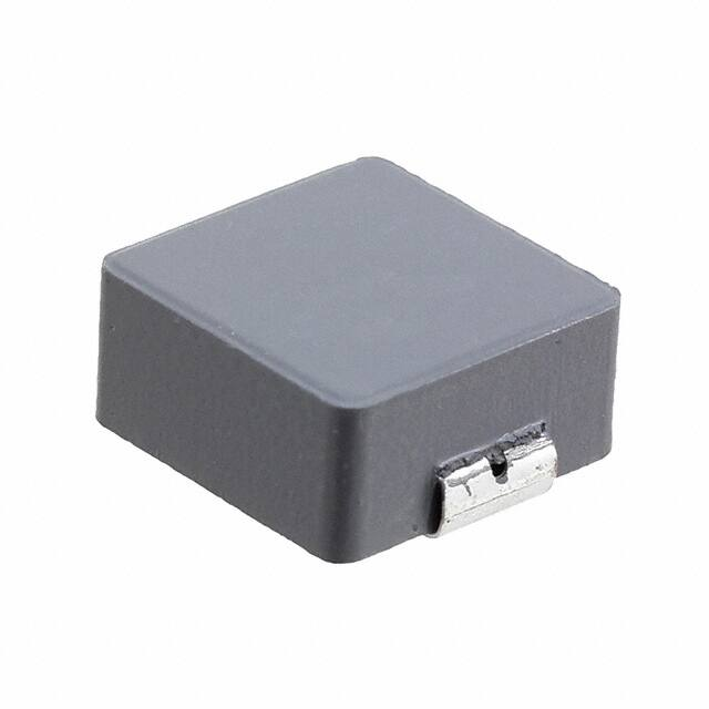

    固定电感器 Nonstandard 150nH ±20% 55A 0.6mΩ 210MHz 10@100KHz
SRP1265A-R15M 数据手册
Features C- *R Q2 o 00 HS CO an M d PL IA NT n Shielded construction 13.5 ± 0.5 (.531 ± .020) n Carbonyl powder core n High saturation current AE n Inductance range: 0.15 to 47 µH n AEC-Q200 compliant n RoHS compliant* and halogen free** 3R3 1510 12.5 ± 0.3 (.492 ± .012) 6.2 ± 0.3 (.244 + .012) 2.75 ± 0.35 SRP1265A Series - Shielded Power Inductors (.108 ± .014) 2.3 ± 0.3 (.091 ± .012) Electrical Specifications @ 25 °C Inductance @ 100 KHz /1V L Tol. (µH) (%) Bourns Part Number SRP1265A-R15M 0.15 20 SRP1265A-R22M 0.22 20 SRP1265A-R33M 0.33 20 SRP1265A-R36M 0.36 20 SRP1265A-R47M 0.47 20 SRP1265A-R56M13.5 ± 0.5 0.56 20 (.531 ± .020) SRP1265A-R68M 0.68 20 SRP1265A-R82M 0.82 20 SRP1265A-1R0M 1.0 20 3R3 SRP1265A-1R5M 1.5 20 12.5 ± 0.3 SRP1265A-1R8M 1.8 (.492 ± .012) 1510 20 SRP1265A-2R2M 2.2 20 SRP1265A-3R3M 3.3 20 SRP1265A-4R7M 4.7 6.2 ± 0.3 20 2.75 ± 0.35 SRP1265A-5R6M 5.6(.244 + .012) 20 (.108 ± .014) SRP1265A-6R0M 6.0 20 2.3 ± 0.3 SRP1265A-6R8M 6.8 20 (.091 ± .012) SRP1265A-8R2M 8.2 20 SRP1265A-100M 10 20 SRP1265A-150M 15 20 SRP1265A-220M 22 20 SRP1265A-330M 33 20 SRP1265A-470M 47 20 General Specifications Q (Min.) @100 KHz /1V SRF (MHz) Typ. DCR (mW) Typ. DCR (mW) Max. Irms (A) Isat (A) 10 10 10 10 10 10 30 30 30 30 20 20 20 20 20 20 2.0 20 (.079) 20 REF. 20 20 GRADUATED LINE20 20 20 210 130 90 80 75 65 50 43 34 30 30 23 20 17 15 14 13 11 10 7 6 5 4 0.49 0.49 0.65 0.7 0.9 1.05 1.3 1.6 2.0 2.7 3.6 3.8 5.7 7 8.5 8.5 9.5 12 13.2 23.2 32.5 48 76 0.6 0.6 0.8 0.9 1.2 1.2 1.5 1.9 2.3 3.0 4.0 4.2 6.8 8.4 10.0 10.0 11.5 15.5 16.5 28.0 37.0 58.0 90.0 55 53 46 45 41 37 35 33 30 27 24 22 18 13.5 12.5 12.0 11.5 10.5 10 9 9 8 6.5 118 112 68 66 63 58 55 50 48 45 40 40 30 28 23 23 18 16 15.5 12.5 12 11 9.5 Terminal Type NonLead Frame Test Voltage.....................................1.0 V GRADUATED Test Frequency.......................... 100 LINE KHz Operating Temperature .................................-55 °C to +150 °C 4.7 ± 0.3 (Temperature rise included) Storage Temperature (.185 ± .012) .................................-55 °C to +150 °C Rated Current ............. Inductance drops 20 % at Isat 13.5 ± 0.5 Temperature Rise......40 °C at rated Irms (.531 ± .020) Moisture Sensitivity Level......................1 ESD Classification (HBM).................N/A R15 112.5 ± 0.3 Circuit (.492 ± .012) Lead Frame design, component, PCB trace 1510airflow and other size and thickness, cooling provisions all affect the part temperature. Part temperature should be 6.2 ± 0.3 verified in the end application. 2.75 ± 0.35 (.244 + .012) (.108 ± .014) 2.3 ± 0.3 Materials (.091 ± .012) 2.0 (.079) Core..............................Carbonyl powder REF. Wire.............................Enameled copper Terminal Finish....................................Sn GRADUATED Packaging........ 500 pcs. per 13-inch reel LINE 4.7 ± 0.3 (.185 ± .012) How to Order SRP1265A - 100M 4.7 ± 0.3 (.185 ± .012) Model Product Dimensions Non-Lead Frame Terminal Value Code (see table) Lead Frame Terminal 13.5 ± 0.5 (.531 ± .020) Recommended Layout 13.5 ± 0.5 (.531 ± .020) R15 1510 12.5 ± 0.3 (.492 ± .012) 12.5 ± 0.3 (.492 ± .012) 14.2 (.559) 3R3 1510 8.0 (.315) 2.75 ± 0.35 (.108 ± .014) 6.2 ± 0.3 (.244 + .012) 2.3 ± 0.3 (.091 ± .012) 2.75 ± 0.35 (.108 ± .014) 2.0 (.079) REF. 2.3 ± 0.3 (.091 ± .012) GRADUATED LINE 4.7 ± 0.3 (.185 ± .012) WARNING 14.2 Cancer and (.559)Reproductive Harm www.P65Warnings.ca.gov 2.0 (.079) REF. 6.2 ± 0.3 (.244 + .012) 2.0 (.079) REF. GRADUATED LINE 4.7 ± 0.3 (.185 ± .012) DIMENSIONS: 5.0 (.197) MM (INCHES) Please consult Bourns® Model SRP-A Series Visual Inspection Guide for detailed construction, processing and testing information. * RoHS Directive 2015/863, Mar 31, 2015 and Annex. **Bourns considers(.531 ± .020) a13.5 ± 0.5 product to be “halogen free” if (a) the Bromine (Br) content is 900 ppm or less; (b) the Chlorine (Cl) content is 900 ppm or less; and (c) the total Bromine (Br) and Chlorine (Cl) content is 1500 ppm or less. Specifications are subject to change without notice. Users should verify actual device performance in their specific applications. The products described herein and this document are subject to specific legal disclaimers as set forth on the last page of 12.5 ± 0.3 this document, and at www.bourns.com/docs/legal/disclaimer.pdf. (.492 ± .012) R15 1510 SRP1265A Series - Shielded Power Inductors L vs. I Charts 94.4 26 0 0 118 0 22.4 DC Current (A) 0.48 104 0.36 78 26 26.4 39.6 52.8 SRP1265A-R68M 40 0.2 20 24 36 48 0 60 88 0.48 78 0.6 66 0.32 52 0.16 26 0 12.6 52 0.4 26 0 30 40 Inductance (μH) 0.8 Temperature Rise (°C) Inductance (μH) 78 20 0 50 0 63 11.6 36 48 SRP1265A-1R0M 52 0.30 26 0 0 60 0 12 36 48 0 60 DC Current (A) SRP1265A-2R2M 3.0 2.4 104 2.4 104 1.8 78 1.8 78 1.2 52 1.2 52 0.6 26 0.6 26 8 16 24 32 0 40 0 0 7.4 SRP1265A-4R7M 5.6 104 4.2 78 2 52 2.8 52 1 26 1.4 26 0 0 DC Current (A) 5.6 11.2 16.8 14.8 22.2 29.6 130 0 37 DC Current (A) 78 Inductance (μH) 24 130 130 104 24 0 58 0.60 SRP1265A-1R8M 0 0 30 46.4 78 20 0.24 24 34.8 104 40 12 23.2 0.90 3 18 0 1.20 4 12 0 80 7.0 6 22 DC Current (A) SRP1265A-3R3M 0 44 0.2 1.50 130 0 0.4 100 0.48 0 110 DC Current (A) 0 Temperature Rise (°C) Inductance (μH) 50.4 60 DC Current (A) 5 37.8 0.72 3.0 104 10 25.2 SRP1265A-R82M 130 1.6 0 68 0.8 0 1.2 0 SRP1265A-R56M DC Current (A) SRP1265A-1R5M 54.4 104 DC Current (A) 2.0 40.8 0.64 0.96 Inductance (μH) 0.4 Temperature Rise (°C) Inductance (μH) 60 27.2 1.0 1.20 100 0.6 12 13.6 130 0 0 66 80 0 0 DC Current (A) 0.8 0 26 DC Current (A) SRP1265A-R47M DC Current (A) 1.0 52 0.12 0 Inductance (μH) 13.2 0 112 Inductance (μH) 52 0.12 0 89.5 Inductance (μH) Inductance (μH) 0.24 Inductance (μH) 0.80 Temperature Rise (°C) 130 0 67.2 0.24 DC Current (A) SRP1265A-R36M 0.60 44.8 22.4 SRP1265A-5R6M 8.0 130 Inductance (μH) 70.8 52 0.1 Temperature Rise (°C) 47.2 78 0.2 Temperature Rise (°C) 23.6 0.36 Temperature Rise (°C) 0 78 130 Temperature Rise (°C) 26 0 104 0.3 Inductance (μH) 52 0.06 104 0.48 Temperature Rise (°C) Inductance (μH) 0.12 0.4 Temperature Rise (°C) 78 0.60 Temperature Rise (°C) 0.18 SRP1265A-R33M 130 Temperature Rise (°C) 104 SRP1265A-R22M 0 28 120 6.4 96 4.8 72 3.2 48 1.6 24 0 DC Current (A) 0 4.6 9.2 13.8 19.4 Temperature Rise (°C) 0.24 Inductance (μH) 0.5 Temperature Rise (°C) 130 Temperature Rise (°C) SRP1265A-R15M 0.30 0 23 DC Current (A) 3.6 40 7.2 60 4.8 40 ure Rise (°C) 60 tance (μH) 5.4 ture Rise (°C) 60 tance (μH) 6 ture Rise (°C) tance (μH) SRP1265A-6R0M SRP1265A-6R8M SRP1265A-8R2M 10 9.0 100 100 12.0 100 Specifications are subject to change without notice. Users should verify actual device performance in their 80 specific applications. 80 9.6 7.2 8 80 The products described herein and this document are subject to specific legal disclaimers as set forth on the last page of this document, and at www.bourns.com/docs/legal/disclaimer.pdf. 0 30 40 0 8 16 DC Current (A) SRP1265A-4R7M 6.4 4.2 26 18 24 0 30 0 0 8 80 7.2 6 60 4 40 2 20 13.8 18.4 20 3 24 0 12.4 Inductance (μH) 48 Temperature Rise (°C) Inductance (μH) 96 72 8 21 2.3 ± 0.3 (.091 ± .012) 5 20 8.8 SRP1265A-470M 24 0 0 1.9 DC Current (A) 3.8 5.7 40 20 12.8 Temperature Rise (°C) 0 16 120 6.2 ± 0.3 (.244 + .012) 96 72 2.0 (.079) 48 REF. 7 24 0 2.4 4.8 7.2 GRADUATED LINE 0 12 9.6 DC Current (A) 14 0 11 100 14 0 48 24 GRADUATED LINE SRP1265A-220M 40 28 10 R159.6 1510 6.4 10 9.6 0 23 DC Current (A) 60 72 48 3.2 15 96 20 19.4 13.5 ± 0.5 (.531 ± .020) 2.4 2.75 ± 0.35 (.108 ± .014) 7.2 13.8 60 28 4.8 48 2.0 24 (.079) REF. 7.2 4.8 80 0 12 72 80 20 2.4 6.2 ± 0.3 (.244 + .012) 4.7 ± 0.3 (.185 ± .012) 35 0 96 SRP1265A-8R2M 0 42 Inductance (μH) Inductance (μH) 9.2 12.5 ± 0.3 (.492 ± .012) 56 72 6.6 4.6 0 70 96 4.4 0 20 120 40 2.2 16 DC Current (A) Temperature Rise (°C) SRP1265A-330M 0 0 100 0 0 15.5 30 0 12 SRP1265A-150M DC Current (A) 50 9.6 1.8 25 9 9.3 80 3.6 120 6 6.2 1.6 2.3 ± 0.3 (.091 ± .012) 12.0 DC Current (A) 12 3.1 3.2 2.75 ± 0.35 (.108 ± .014) 100 60 4 0 37 120 DC Current (A) 40 0 29.6 1510 4.8 0 5.4 0 0 23 SRP1265A-100M 0 22.4 SRP1265A-6R8M DC Current (A) 15 16.8 Inductance (μH) 9.2 11.2 0 28 Inductance (μH) 9.0 Inductance (μH) 100 4.6 5.6 22.2 SRP1265A-5R6M 3R3 DC Current (A) SRP1265A-6R0M 0 26 1.4 Inductance (μH) 1 52 2.8 (.492 ± .012) Temperature Rise (°C) Inductance (μH) 52 L vs. I Charts (Continued) DC Current (A) Inductance (μH) Temperature Rise (°C) 2 0 14.8 DC Current (A) SRP1265A Series - Shielded Power Inductors 10 13.5 ± 0.5 (.531 ± .020) 7.4 78 78 12 0 104 104 3 6 0 26 5.6 4 0 0.6 8.012.5 ± 0.3 7.0 0 1.2 130 130 Temperature Rise (°C) Inductance (μH) 32 78 52 DC Current (A) SRP1265A-3R3M 5 24 0 40 Temperature Rise (°C) 20 0 Temperature Rise (°C) 10 26 4.7 ± 0.3 (.185 ± .012) 120 7.6 Temperature Rise (°C) 0 0 50 52 0.6 1.8 Temperature Rise (°C) 26 78 Temperature Rise (°C) 0.4 1.8 1.2 104 2.4 Temperature Rise (°C) 52 104 Inductance (μH) 78 0.8 2.4 Temperature Rise (°C) 1.2 Inductance (μH) 104 Temperature Rise (°C) Inductance (μH) 1.6 14.2 (.559) 0 9.5 DC Current (A) 8.0 (.315) Soldering Profile 5.0 (.197) Electrical Schematic PRE-HEATING SOLDERING NATURAL COOLING TP (260 °C / 10 seconds max.) Temperature (°C) tp (245 °C / 20~40 seconds) 217 200 60 ~ 150 seconds 150 60 ~ 180 seconds 25 480 seconds max. Time (Seconds) REFLOW TIMES: 3 MAX. Specifications are subject to change without notice. Users should verify actual device performance in their specific applications. The products described herein and this document are subject to specific legal disclaimers as set forth on the last page of this document, and at www.bourns.com/docs/legal/disclaimer.pdf. SRP1265A Series - Shielded Power Inductors Packaging Specifications 330 DIA. (12.99) 2.0 ± 0.5 (.079 ± .020) 13.5 ± 0.5 (.531 ± .020) DIA. 100.0 ± 2.0 (3.937 ± .079) 13.5 ± 0.5 DIA. (.531 ± .020) 24.0 ± 0.5 (.945 ± .020) 1.75 (.069) 2.0 (.079) 0.35 ± 0.05 (.014 ± .002) 1.5 ± 0.1 DIA. (.059 ± .004) 3 ° 16.0 ± 0.1 (.630 ± .004) 7.0 ± 0.1 (.217 ± .004) 14.2 ± 0.1 (.559 ± .004) 7.0 ± 0.1 (.276 ± .004) 13.0 ± 0.1 (.512 ± .004) USER DIRECTION OF FEED QTY: 500 PCS. PER REEL DIMENSIONS: 13.0 ± 0.1 (.512 ± .004) Marking Date Code Marking Date Code Marking Date Code Marking Date Code Marking 24.0 ± 0.3 (.945 ± .012) 4.0 (.157) Date Code 11.5 ± 0.1 (.453 ± .004) 24 (.945) MM (INCHES) Asia-Pacific: Tel: +886-2 2562-4117 • Email: asiacus@bourns.com EMEA: Tel: +36 88 885 877 • Email: eurocus@bourns.com The Americas: Tel: +1-951 781-5500 • Email: americus@bourns.com www.bourns.com REV. 04/20 Specifications are subject to change without notice. Users should verify actual device performance in their specific applications. The products described herein and this document are subject to specific legal disclaimers as set forth on the last page of this document, and at www.bourns.com/docs/legal/disclaimer.pdf. Legal Disclaimer Notice This legal disclaimer applies to purchasers and users of Bourns® products manufactured by or on behalf of Bourns, Inc. and its affiliates (collectively, “Bourns”). Unless otherwise expressly indicated in writing, Bourns® products and data sheets relating thereto are subject to change without notice. Users should check for and obtain the latest relevant information and verify that such information is current and complete before placing orders for Bourns® products. The characteristics and parameters of a Bourns® product set forth in its data sheet are based on laboratory conditions, and statements regarding the suitability of products for certain types of applications are based on Bourns’ knowledge of typical requirements in generic applications. The characteristics and parameters of a Bourns® product in a user application may vary from the data sheet characteristics and parameters due to (i) the combination of the Bourns® product with other components in the user’s application, or (ii) the environment of the user application itself. The characteristics and parameters of a Bourns® product also can and do vary in different applications and actual performance may vary over time. Users should always verify the actual performance of the Bourns® product in their specific devices and applications, and make their own independent judgments regarding the amount of additional test margin to design into their device or application to compensate for differences between laboratory and real world conditions. Unless Bourns has explicitly designated an individual Bourns® product as meeting the requirements of a particular industry standard (e.g., ISO/TS 16949) or a particular qualification (e.g., UL listed or recognized), Bourns is not responsible for any failure of an individual Bourns® product to meet the requirements of such industry standard or particular qualification. Users of Bourns® products are responsible for ensuring compliance with safety-related requirements and standards applicable to their devices or applications. Bourns® products are not recommended, authorized or intended for use in nuclear, lifesaving, life-critical or life-sustaining applications, nor in any other applications where failure or malfunction may result in personal injury, death, or severe property or environmental damage. Unless expressly and specifically approved in writing by two authorized Bourns representatives on a case-by-case basis, use of any Bourns® products in such unauthorized applications might not be safe and thus is at the user’s sole risk. Life-critical applications include devices identified by the U.S. Food and Drug Administration as Class III devices and generally equivalent classifications outside of the United States. Bourns expressly identifies those Bourns® standard products that are suitable for use in automotive applications on such products’ data sheets in the section entitled “Applications.” Unless expressly and specifically approved in writing by two authorized Bourns representatives on a case-by-case basis, use of any other Bourns® standard products in an automotive application might not be safe and thus is not recommended, authorized or intended and is at the user’s sole risk. If Bourns expressly identifies a sub-category of automotive application in the data sheet for its standard products (such as infotainment or lighting), such identification means that Bourns has reviewed its standard product and has determined that if such Bourns® standard product is considered for potential use in automotive applications, it should only be used in such sub-category of automotive applications. Any reference to Bourns® standard product in the data sheet as compliant with the AEC-Q standard or “automotive grade” does not by itself mean that Bourns has approved such product for use in an automotive application. Bourns® standard products are not tested to comply with United States Federal Aviation Administration standards generally or any other generally equivalent governmental organization standard applicable to products designed or manufactured for use in aircraft or space applications. Bourns expressly identifies Bourns® standard products that are suitable for use in aircraft or space applications on such products’ data sheets in the section entitled “Applications.” Unless expressly and specifically approved in writing by two authorized Bourns representatives on a case-by-case basis, use of any other Bourns® standard product in an aircraft or space application might not be safe and thus is not recommended, authorized or intended and is at the user’s sole risk. The use and level of testing applicable to Bourns® custom products shall be negotiated on a case-by-case basis by Bourns and the user for which such Bourns® custom products are specially designed. Absent a written agreement between Bourns and the user regarding the use and level of such testing, the above provisions applicable to Bourns® standard products shall also apply to such Bourns® custom products. Users shall not sell, transfer, export or re-export any Bourns® products or technology for use in activities which involve the design, development, production, use or stockpiling of nuclear, chemical or biological weapons or missiles, nor shall they use Bourns® products or technology in any facility which engages in activities relating to such devices. The foregoing restrictions apply to all uses and applications that violate national or international prohibitions, including embargos or international regulations. Further, Bourns® products and Bourns technology and technical data may not under any circumstance be exported or re-exported to countries subject to international sanctions or embargoes. Bourns® products may not, without prior authorization from Bourns and/or the U.S. Government, be resold, transferred, or re-exported to any party not eligible to receive U.S. commodities, software, and technical data. To the maximum extent permitted by applicable law, Bourns disclaims (i) any and all liability for special, punitive, consequential, incidental or indirect damages or lost revenues or lost profits, and (ii) any and all implied warranties, including implied warranties of fitness for particular purpose, non-infringement and merchantability. For your convenience, copies of this Legal Disclaimer Notice with German, Spanish, Japanese, Traditional Chinese and Simplified Chinese bilingual versions are available at: Web Page: http://www.bourns.com/legal/disclaimers-terms-and-policies PDF: http://www.bourns.com/docs/Legal/disclaimer.pdf C1753 05/17/18R
