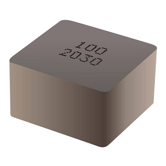

    功率电感 10µH ±20% 1510 9.70mm 16.50 x 15.50mm 7.1mΩ 18A
SRP1510CA-100M 数据手册
*R AE **H oHS C- AL C Q2 OG OM 00 EN P CO FR LIA M EE NT PL & , IA NT Features n Shielded construction n Metal alloy powder core n High saturation current n Low buzz noise n Flat wire n AEC-Q200 compliant n RoHS compliant* and halogen free** SRP1510CA Series - Shielded Power Inductors Electrical Specifications @ 25 °C Inductance @ 100 KHz / 0.1 V Bourns Part Number L (µH) Tol. (%) 4.7 20 SRP1510CA-4R7M SRP1510CA-5R6M 5.6 SRP1510CA-6R8M 6.8 SRP1510CA-8R2M 8.2 SRP1510CA-100M SRP1510CA-150M SRP1510CA-330M 20 20 Q SRF DCR Typ. (MHz) (mW) @ 100 kHz Typ. Typ. / 0.1 V 30 30  8 7.1 22 20 30 20 3.82 4.18 30 33 11 3.4 10 30 20 20 13 30 10 15 SRP1510CA-220M 20 Additional Information 30 30  9  6  5  4 6.0 9.2 13.2 18.7 Product Dimensions 20 °C 40 °C Temp. Rise Temp. Rise 3.8 4.2 4.6 7.2 8.6 11.5 15.8 Click these links for more information: Irms (A) Typ. 22 30 21 38 20 26 36 18 24 29 19 25 R45 151614 32 18 11 20 43 28 11.0 ± 0.5 (.433 ± .020) 10.0 ± 0.3 (.394 ± .012) Isat (A) Typ. 23 16 9 20 13 10.0 ± 0.3 3.8 ± 0.2 (.150 + .008) (.394 ± .012) 2.75 ± 0.35 (.108 ± .014) 18.7 2.3 ± 0.3 (.091 ± .012) 16.5 ± 0.3 (.650 ± .012) 15.5 ± 0.3 (.610 ± .012) DCR (mW) Max. 13.2 ± 0.5 (.520 ± .020) 100 2022 9.7 ± 0.3 (.382 ± .012) 7.0 ± 0.3 (.276 ± .012) Recommended Layout 13.6 (.535) DIMENSIONS: Electrical Schematic 6.0 (.236) 11.0 ± 0.5 (.433 ± .020) General Specifications 10.0 ± 0.3 (.394 ± .012) Operating Temperature .................................-55 °C to +155 °C 100 (Temperature rise included) 1516 Storage Temperature (Component) .................................-55 °C to +155 °C 10.0 ± 0.3 3.8 ± 0.2 Rated Current (.394 ± .012) (.150 + .008) 2.75 ± 0.35 Inductance drops 30 % at Isat ............. (.108 ± .014) Temperature Rise 2.3 ± 0.3 (.091 ± .012) .................... 20 or 40 °C at rated Irms1 Rated Voltage���������������������������40 V Typ. Moisture Sensitivity Level......................1 ESD Classification (HBM).................N/A size and thickness, airflow and other cooling provisions all affect the part temperature. Part temperature should be verified in the end application. (.118 ± .012) MM (INCHES) 3.5 (.138) 5.4 (.213) 15.0 (.591) 15.0 (.591) CONTACT 1 Circuit 3.0 ± 0.3 design, component, PCB trace 3.2 ± 0.2 (.126 ± .008) 3.0 ± 0.3 (.118 ± .012) PRODUCT TECHNICAL INVENTORY SAMPLES LIBRARY Materials Core...........................Metal alloy powder Wire.............................Enameled copper Terminal Finish....................................Sn Packaging........ 150 pcs. per 13-inch reel Please consult Bourns® Model SRP-A Series Visual Inspection Guide for detailed construction, processing and testing information. How to Order SRP1510CA - 1R0M Model DIMENSIONS: MM (INCHES) Value Code (see table) * RoHS Directive 2015/863, Mar 31, 2015 and Annex. ** Bourns considers a product to be “halogen free” if (a) the Bromine (Br) content is 900 ppm or less; (b) the Chlorine (Cl) content is 900 ppm or less; and (c) the total Bromine (Br) and Chlorine (Cl) content is 1500 ppm or less. Specifications are subject to change without notice. Users should verify actual device performance in their specific applications. The products described herein and this document are subject to specific legal disclaimers as set forth on the last page of this document, and at www.bourns.com/docs/legal/disclaimer.pdf. SRP1510CA Series - Shielded Power Inductors L vs. I Charts 2.40 40 1.20 20 18 27 0 45 36 3.60 40 1.80 20 0 0 8 16 DC Current (A) 7.20 60 4.80 40 2.40 20 7 14 21 Inductance (μH) 80 0 0 35 28 SRP1510CA-220M 7.20 60 4.80 40 2.40 20 0 8 12.00 40 6.00 20 13.5 0 22.5 18.0 Inductance (μH) 60 9.0 20 0 8 16 24 80 60 18.0 40 9.0 20 0 4.5 9.0 13.5 32 0 40 100 16.00 80 12.00 60 8.00 40 4.00 20 0 0 5.5 11.0 16.5 22.0 0 27.5 100 27.0 0 24 DC Current (A) 36.0 DC Current (A) 16 SRP1510CA-150M 20.00 0 32 SRP1510CA-330M 45.0 Temperature Rise (°C) Inductance (μH) 80 4.5 40 0 100 80 0 100 18.00 0 4.00 2.00 DC Current (A) 24.00 0 60 DC Current (A) 9.60 DC Current (A) 30.00 6.00 0 40 SRP1510CA-100M 12.00 Temperature Rise (°C) Inductance (μH) 100 9.60 0 32 80 DC Current (A) SRP1510CA-8R2M 12.00 24 Inductance (μH) 9 60 Temperature Rise (°C) 0 5.40 8.00 18.0 Temperature Rise (°C) 0 80 100 Temperature Rise (°C) 60 7.20 SRP1510CA-6R8M 10.00 Temperature Rise (°C) 3.60 100 Inductance (μH) 80 Inductance (μH) 4.80 SRP1510CA-5R6M 9.00 Temperature Rise (°C) Inductance (μH) 100 Temperature Rise (°C) SRP1510CA-4R7M 6.00 0 22.5 DC Current (A) Soldering Profile PRE-HEATING SOLDERING NATURAL COOLING TP (260 °C / 10 seconds max.) Temperature (°C) tp (245 °C / 20~40 seconds) 217 200 60 ~ 150 seconds 150 60 ~ 180 seconds 25 480 seconds max. Time (Seconds) REFLOW TIMES: 3 MAX. Specifications are subject to change without notice. Users should verify actual device performance in their specific applications. The products described herein and this document are subject to specific legal disclaimers as set forth on the last page of this document, and at www.bourns.com/docs/legal/disclaimer.pdf. SRP1510CA Series - Shielded Power Inductors Packaging Specifications 2.0 ± 0.5 (.079 ± .020) COVER TAPE 100 ± 2 (3.937 ± .079) 330 (12.992) 13 +0.5/-0.2 (.512 +.020/-.008) 32.4 +2/-0 (1.276 +.079/-0) 1.75 ± 0.1 (.069 ± .004) 1.5 ± 0.1 DIA. (.059 ± .004) 24.0 ± 0.1 (.945 ± .004) EMBOSSED CARRIER 4.0 (.157) 0.50 ± 0.05 (.020 ± .002) 14.2 ± 0.1 (.559 ± .004) 100 2022 32 ± 0.3 (1.260 ± .012) 100 2022 100 2022 16.0 ± 0.1 (.630 ± .004) 100 2022 10.5 ± 0.1 (.413 ± .004) NO COMPONENT 200 (7.874) MIN. COMPONENTS NO COMPONENT 400 (15.748) MIN. USER DIRECTION OF FEED QTY: 150 PCS. PER REEL 17.0 ± 0.1 (.669 ± .004) DIMENSIONS: MM (INCHES) Asia-Pacific: Tel: +886-2 2562-4117 • Email: asiacus@bourns.com EMEA: Tel: +36 88 885 877 • Email: eurocus@bourns.com The Americas: Tel: +1-951 781-5500 • Email: americus@bourns.com www.bourns.com 03/21 Specifications are subject to change without notice. Users should verify actual device performance in their specific applications. The products described herein and this document are subject to specific legal disclaimers as set forth on the last page of this document, and at www.bourns.com/docs/legal/disclaimer.pdf. Legal Disclaimer Notice This legal disclaimer applies to purchasers and users of Bourns® products manufactured by or on behalf of Bourns, Inc. and P[ZHɉSPH[LZJVSSLJ[P]LS`¸)V\YUZ¹ Unless otherwise expressly indicated in writing, Bourns® products and data sheets relating thereto are subject to change ^P[OV\[UV[PJL
