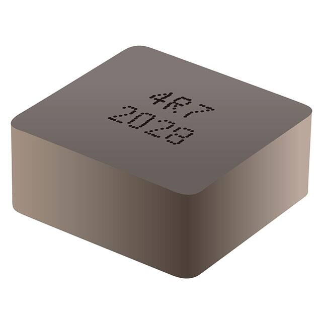

    固定电感器 Nonstandard 1µH ±20% 58A 1.15mΩ 28MHz 30@100KHz
SRP1580CA-1R0M 数据手册
*R AE **H oHS C- AL C Q2 OG OM 00 EN P CO FR LIA M EE NT PL & , IA NT Features n Shielded construction n Metal alloy powder core n High saturation current n Low buzz noise n Flat wire n AEC-Q200 compliant n RoHS compliant* and halogen free** SRP1580CA Series - Shielded Power Inductors Electrical Specifications @ 25 °C Bourns Part Number 11.0 ± 0.5 (.433 ± .020) 10.0 ± 0.3 (.394 ± .012) Inductance @ 100 KHz / 0.1 V R45 1516 L (µH) Tol. (%) 1.0 20 30 28 20 30 12 SRP1580CA-1R0M SRP1580CA-2R0M 2.0 10.0 ± 0.3 3.8 ± 0.2 20 (.150 + .008) (.394 ± .012) Q SRF DCR Typ. (MHz) (mW) @ 100 kHz Typ. Typ. / 0.1 V SRP1580CA-5R3M 2.75 ± 0.35 5.3 (.108 ± .014) 30 18 1.0 100 1516 20 °C 40 °C Temp. Rise Temp. Rise 1.15 (.394 ± .012) 4.45 2.3 ± 0.3 (.091 ± .012) 41 58 29.5 40 3.8 ± 0.2 (.150 + .008) 5.34 2.75 ± 0.35 (.108 ± .014) 19.5 26 Isat (A) Typ. 80 57 35 2.3 ± 0.3 (.091 ± .012) 16.5 ± 0.3 (.650 ± .012) 3.0 ± 0.3 (.118 ± .012) DCR (mW) Max. Click these links for more information: Irms (A) Typ. 10.0 ± 0.3 (.394 ± .012) 1.92 10.0 ± 0.32.21 Product Dimensions 15.5 ± 0.3 (.610 ± .012) Additional Information 11.0 ± 0.5 (.433 ± .020) 13.2 ± 0.5 (.520 ± .020) 3.0 ± 0.3 (.118 ± .012) 2R0 2010 3.2 ± 0.2 (.126 ± .008) 13.6 (.535) 7.7 ± 0.3 3.5 (.303 ± .012) (.138) Electrical Schematic 7.0 ± 0.3 (.276 ± .012) 5.4 (.213) DIMENSIONS: MM (INCHES) How to Order SRP1580CA - 1R0M Model Value Code (see table) Soldering Profile PRE-HEATING SOLDERING NATURAL COOLING PRODUCT TECHNICAL INVENTORY SAMPLES LIBRARY CONTACT General Specifications Operating Temperature .................................-55 °C to +155 °C (Temperature rise included) Storage Temperature (Component) .................................-55 °C to +155 °C Rated Current ............. Inductance drops 30 % at Isat Temperature Rise .................... 20 or 40 °C at rated Irms1 Rated Voltage���������������������������40 V Typ. Moisture Sensitivity Level......................1 ESD Classification (HBM).................N/A 1 Circuit design, component, PCB trace size and thickness, airflow and other cooling provisions all affect the part temperature. Part temperature should be verified in the end application. Materials Core...........................Metal alloy powder Wire.............................Enameled copper Terminal Finish....................................Sn Packaging........ 200 pcs. per 13-inch reel TP (260 °C / 10 seconds max.) Please consult Bourns® Model SRP-A Series Visual Inspection Guide for detailed construction, processing and testing information. Temperature (°C) tp (245 °C / 20~40 seconds) 217 200 60 ~ 150 seconds 150 60 ~ 180 seconds 25 Recommended Layout 15.0 (.591) 480 seconds max. Time (Seconds) REFLOW TIMES: 3 MAX. 15.0 (.591) 6.0 (.236) * RoHS Directive 2015/863, Mar 31, 2015 and Annex. ** Bourns considers a product to be “halogen free” if (a) the Bromine (Br) content is 900 ppm or less; (b) the Chlorine (Cl) content is 900 ppm or less; and (c) the total Bromine (Br) and Chlorine (Cl) content is 1500 ppm or less. Specifications are subject to change without notice. Users should verify actual device performance in their specific applications. The products described herein and this document are subject to specific legal disclaimers as set forth on the last page of this document, and at www.bourns.com/docs/legal/disclaimer.pdf. SRP1580CA Series - Shielded Power Inductors L vs. I Charts 60 0.60 40 0.30 20 0 0 18 36 54 0 90 72 2.00 80 1.50 60 1.00 40 0.50 20 0 0 12 24 DC Current (A) 36 48 0 60 SRP1580CA-5R3M 7.50 100 6.00 80 4.50 60 3.00 40 1.50 20 0 0 DC Current (A) 8 16 24 Temperature Rise (°C) 0.90 100 Inductance (μH) 80 Inductance (μH) 1.20 SRP1580CA-2R0M 2.50 Temperature Rise (°C) Inductance (μH) 100 Temperature Rise (°C) SRP1580CA-1R0M 1.50 0 40 32 DC Current (A) Packaging Specifications 2.0 ± 0.5 (.079 ± .020) COVER TAPE 100 ± 2 (3.937 ± .079) 330 (12.992) DIMENSIONS: MM (INCHES) 13 +0.5/-0.2 (.512 +.020/-.008) 32.4 +2/-0 (1.276 +.079/-0) 1.75 ± 0.1 (.069 ± .004) 1.5 ± 0.1 DIA. (.059 ± .004) 24.0 ± 0.1 (.945 ± .004) EMBOSSED CARRIER 4.0 (.157) 0.50 ± 0.05 (.020 ± .002) 14.2 ± 0.1 (.559 ± .004) 1R0 2022 32 ± 0.3 (1.260 ± .012) 1R0 2022 1R0 2022 16.0 ± 0.1 (.630 ± .004) 1R0 2022 8.5 ± 0.1 (.335 ± .004) NO COMPONENT 200 (7.874) MIN. COMPONENTS USER DIRECTION OF FEED NO COMPONENT 400 (15.748) MIN. QTY: 200 PCS. PER REEL 17.0 ± 0.1 (.669 ± .004) Asia-Pacific: Tel: +886-2 2562-4117 • Email: asiacus@bourns.com EMEA: Tel: +36 88 885 877 • Email: eurocus@bourns.com The Americas: Tel: +1-951 781-5500 • Email: americus@bourns.com www.bourns.com 03/21 Specifications are subject to change without notice. Users should verify actual device performance in their specific applications. The products described herein and this document are subject to specific legal disclaimers as set forth on the last page of this document, and at www.bourns.com/docs/legal/disclaimer.pdf. Legal Disclaimer Notice This legal disclaimer applies to purchasers and users of Bourns® products manufactured by or on behalf of Bourns, Inc. and P[ZHɉSPH[LZJVSSLJ[P]LS`¸)V\YUZ¹ Unless otherwise expressly indicated in writing, Bourns® products and data sheets relating thereto are subject to change ^P[OV\[UV[PJL
