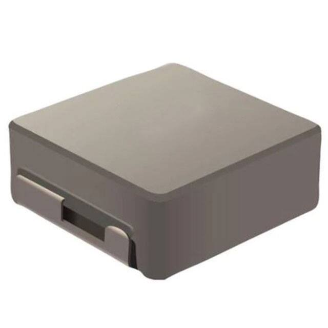

SRP1770C-R47M
SRP1770C-R47M
    BOURNS(伯恩斯)
    固定电感器 Nonstandard ±20% 0.83mΩ 28MHz 10@100KHz
SRP1770C-R47M 数据手册
Features n Shielded construction n Metal alloy powder core n High saturation current 220906H 1 n Low buzz noise n Inductance range: 0.47 to 47 µH n RoHS compliant* and halogen free** SRP1770C Series - Shielded Power Inductors Electrical Specifications @ 25 °C Inductance @ 100 kHz /1V Tol. L (µH) (%) Bourns Part Number SRP1770C-R47M SRP1770C-1R0M SRP1770C-1R5M SRP1770C-2R2M SRP1770C-3R3M SRP1770C-4R7M SRP1770C-5R6M SRP1770C-6R8M SRP1770C-8R2M SRP1770C-100M SRP1770C-150M SRP1770C-220M SRP1770C-330M SRP1770C-470M 0.47 1.0 1.5 2.2 3.3 4.7 5.6 6.8 8.2 10.0 15.0 22.0 33.0 47.0 Q (Min.) @100 kHz /1V ± 20 ± 20 ± 20 ± 20 ± 20 ± 20 ± 20 ± 20 ± 20 ± 20 ± 20 ± 20 ± 20 ± 20 Soldering Profile 10 20 20 20 20 20 20 20 20 20 20 20 20 20 General Specifications SRF (MHz) Typ. 28 24 22 21 19 17 15 14 13 12 10  8  6  5 DCR (mW) Typ. 0.75 1.30 1.80 2.50 3.50 4.80 5.90 8.40 9.60 11.60 16.50 24.00 36.00 46.00 DCR (mW) Max. 0.83 1.50 2.10 2.80 3.90 5.50 6.80 9.20 10.80 13.00 19.50 27.60 42.00 53.00 Irms (A) Typ. 60.0 48.0 42.0 40.0 28.0 26.0 24.0 22.0 18.0 17.0 14.0 12.0 10.7  8.7 Isat (A) Typ. Peak Temperature260 ഒ max. Max. Peak Temperature 260 ഒ10 sec. max. Max. Time Above 217 ഒ: 60~150 sec. max. Preheating Soldering Terminal Type 115  68  55  45  40  37  35  30  28  25  23  19  15  13 Lead Frame Temperature (°C) size and thickness, airflow and other cooling provisions all affect the part temperature. Part temperature should be verified in the end application. Core...........................Metal alloy powder Wire.............................Enameled copper Terminal Finish............................... Sn/Ni Packaging........ 200 pcs. per 13-inch reel Product Dimensions Natural Cooling 17.8 ± 0.50 (.701 ± .020) tp (245 °C, 20~40 Sec.) 16.9 ± 0.30 (.665 ± .012) 217 °C 100 1907H 60~150 Sec. 60~180 Sec. 25 1 Circuit design, component, PCB trace Materials TP (260 °C / 10 Sec. Max.) 200 °C 150°C Operating Temperature .................................-40 °C to +125 °C (Temperature rise included) Storage Temperature (Component) .................................-40 °C to +125 °C Rated Current ............. Inductance drops 30 % at Isat Temperature Rise......40 °C at rated Irms Moisture Sensitivity Level......................1 ESD Classification (HBM).................N/A 16.9 ± 0.30 (.665 ± .012) 480 Sec. Max. Time (Seconds) Reflow Times: 3 Times Max. How to Order 2.3 ± 0.30 (.091 ± .012) Recommended Layout SRP1770C - 220M 6.7 ± 0.30 (.264 ± .012) DIMENSIONS: MM (INCHES) 18.5 (.728) Model Value Code (see table) 12.5 (.492) 2.5 ± 0.30 (.098 ± .012) Schematic 11.0 (.433) DIMENSIONS: 11.9 ± 0.30 (.469 ± .012) MM (INCHES) WARNING Cancer and Reproductive Harm - www.P65Warnings.ca.gov * RoHS Directive 2015/863, Mar 31, 2015 and Annex. **Bourns considers a product to be “halogen free” if (a) the Bromine (Br) content is 900 ppm or less; (b) the Chlorine (Cl) content is 900 ppm or less; and (c) the total Bromine (Br) and Chlorine (Cl) content is 1500 ppm or less. Specifications are subject to change without notice. Users should verify actual device performance in their specific applications. The products described herein and this document are subject to specific disclaimers as set forth on the last page of this document, and at www.bourns.com/legal/disclaimer.pdf. SRP1770C Series - Shielded Power Inductors L vs. I Charts 100 0 0 125 0 15 1.2 40 0.6 20 30 40 50 0 SRP1770C-5R6M 4.0 80 60 2.0 40 1.0 20 0 60 3.0 40 1.5 20 16 24 32 40 Inductance (μH) 4.5 8 0 9 SRP1770C-100M 40 2.8 20 18 24 30 Inductance (μH) 60 5.6 12 4.0 40 20 28 2.8 40 1.4 20 0 8 60 8.0 40 4.0 20 15 65.0 80 27.0 60 18.0 40 9.0 20 Inductance (μH) 36.0 SRP1770C-470M 32 40 100 8.8 80 6.6 60 4.4 40 2.2 20 0 6 12 18 24 30 20 25 SRP1770C-220M 0 100 24.0 80 18.0 60 12.0 40 6.0 20 0 0 4.5 9.0 13.5 18.0 0 22.5 DC Current (A) 100 52.0 80 39.0 60 26.0 40 13.0 20 Specifications are subject to change without notice. 0 0 0 0 Users should verify actual device performance in17.5 their specific applications. 0 3 6 9 12 15 0 3.5 7.0 10.5 14.0 The products described herein and this document are subject to specific disclaimers as set forth on the last page of this document, and at www.bourns.com/legal/disclaimer.pdf. DC Current (A) DC Current (A) 0 SRP1770C-8R2M 30.0 DC Current (A) 100 24 0 100 80 10 16 DC Current (A) 12.0 5 100 60 0 SRP1770C-150M 0 0 4.2 35 16.0 0 0 Temperature Rise (°C) Inductance (μH) SRP1770C-330M 21 60 80 11.0 0 14 48 5.6 0 100 2.0 7 36 DC Current (A) 60 DC Current (A) 45.0 0 80 20.0 Temperature Rise (°C) Inductance (μH) 8.4 6 45 6.0 0 100 80 0 36 0 0 24 SRP1770C-4R7M 7.0 DC Current (A) 11.2 0 27 8.0 DC Current (A) 14.0 18 SRP1770C-6R8M 10.0 Temperature Rise (°C) Inductance (μH) 100 80 0 12 DC Current (A) 6.0 0 100 3.0 DC Current (A) 7.5 0 DC Current (A) Inductance (μH) 20 Inductance (μH) 60 Temperature Rise (°C) Inductance (μH) 80 10 0 0 75 SRP1770C-3R3M 5.0 100 1.8 0 60 Inductance (μH) SRP1770C-2R2M 2.4 0 45 DC Current (A) DC Current (A) 3.0 30 Inductance (μH) 75 20 20 Temperature Rise (°C) 50 0.3 Temperature Rise (°C) 25 40 40 Temperature Rise (°C) 0 1.0 0.5 0.6 Temperature Rise (°C) 0 20 60 60 Temperature Rise (°C) 0.12 80 1.5 80 Temperature Rise (°C) 40 2.0 1.2 0.9 100 Temperature Rise (°C) 0.24 2.5 Temperature Rise (°C) 60 SRP1077C-1R5M 100 Inductance (μH) 0.36 Inductance (μH) 80 Temperature Rise (°C) Inductance (μH) 0.48 SRP1770C-1R0M 1.5 100 Temperature Rise (°C) SRP1770C-R47M 0.60 1.5 20 16 24 32 40 20 0 0 7 SRP1770C-100M 80 8.4 60 5.6 40 2.8 20 Inductance (μH) Temperature Rise (°C) Inductance (μH) 21 28 0 100 16.0 80 12.0 60 8.0 40 4.0 20 18 24 30 0 0 SRP1770C-330M 80 60 18.0 40 9.0 20 3.5 7.0 10.5 10 15 20 25 18.0 12.0 6.0 0 0 4.5 80 60 26.0 40 13.0 20 3 6 9 9.0 100 52.0 0 12 15 0 DC Current (A) DC Current (A) Packaging Specifications 330 DIA. (12.99) 2.0 ± 0.5 (.079 ± .020) 13 + 0.5 / - 0.2 (.512 + .020 / - .008) DIA. COVER TAPE 100.0 ± 2.0 (3.937 ± .079) 13 + 0.5 / - 0.2 DIA. (.512 + .020 / - .008) 32.4 + 2 / -0 (1.276 + .079 / -0) 4.0 (.157) 1.5 ± 0.10 DIA. (.059 ± .004) EMBOSSED CARRIER Chip cavity Blank portions 0.50 ± 0.05 (.020 ± .002) 18.5 ± 0.10 (.728 ± .004) 24.0 ± 0.10 (.945 ± .004) 200 or more (7.874) Marking D/C 32.0 ± 0.30 (1.260 ± .012) Marking D/C Marking D/C 14.2 ± 0.10 (.559 ± .004) 7.5 ± 0.10 (.295 ± .004) USER DIRECTION OF FEED 200 PIECES PER REEL DIMENSIONS: MM (INCHES) 24 24.0 0 39.0 0 0 17.5 14.0 18 13.5 DC Current (A) SRP1770C-470M 65.0 100 27.0 0 5 12 SRP1770C-220M 30.0 DC Current (A) 36.0 0 0 DC Current (A) 45.0 Inductance (μH) 12 Inductance (μH) L vs. I Charts (Continued) 6 Temperature Rise (°C) 0 6 DC Current (A) SRP1770C Series Shielded Power Inductors 3312 - 2 mm SMD- Trimming Potentiometer 0 0 35 SRP1770C-150M 20.0 100 11.2 14 DC Current (A) DC Current (A) 14.0 4.4 2.2 0 0 Inductance (μH) 8 40 Temperature Rise (°C) 0 4.0 2.0 6.6 Temperature Rise (°C) 0 60 Inductance (μH 40 6.0 Temperature Rise 3.0 Inductance (μH 60 Temperature Rise Inductance (μH 4.5 400 or more (15.748) 17.5 ± 0.10 (.689 ± .004) Asia-Pacific: Tel: +886-2 2562-4117 • Email: asiacus@bourns.com EMEA: Tel: +36 88 885 877 • Email: eurocus@bourns.com The Americas: Tel: +1-951 781-5500 • Email: americus@bourns.com www.bourns.com REV. 08/20 Specifications are subject to change without notice. Users should verify actual device performance in their specific applications. The products described herein and this document are subject to specific disclaimers as set forth on the last page of this document, and at www.bourns.com/legal/disclaimer.pdf. 18 Legal Disclaimer Notice This legal disclaimer applies to purchasers and users of Bourns® products manufactured by or on behalf of Bourns, Inc. and its affiliates (collectively, “Bourns”). Unless otherwise expressly indicated in writing, Bourns® products and data sheets relating thereto are subject to change without notice. Users should check for and obtain the latest relevant information and verify that such information is current and complete before placing orders for Bourns® products. The characteristics and parameters of a Bourns® product set forth in its data sheet are based on laboratory conditions, and statements regarding the suitability of products for certain types of applications are based on Bourns’ knowledge of typical requirements in generic applications. The characteristics and parameters of a Bourns® product in a user application may vary from the data sheet characteristics and parameters due to (i) the combination of the Bourns® product with other components in the user’s application, or (ii) the environment of the user application itself. The characteristics and parameters of a Bourns® product also can and do vary in different applications and actual performance may vary over time. Users should always verify the actual performance of the Bourns® product in their specific devices and applications, and make their own independent judgments regarding the amount of additional test margin to design into their device or application to compensate for differences between laboratory and real world conditions. Unless Bourns has explicitly designated an individual Bourns® product as meeting the requirements of a particular industry standard (e.g., ISO/TS 16949) or a particular qualification (e.g., UL listed or recognized), Bourns is not responsible for any failure of an individual Bourns® product to meet the requirements of such industry standard or particular qualification. Users of Bourns® products are responsible for ensuring compliance with safety-related requirements and standards applicable to their devices or applications. Bourns® products are not recommended, authorized or intended for use in nuclear, lifesaving, life-critical or life-sustaining applications, nor in any other applications where failure or malfunction may result in personal injury, death, or severe property or environmental damage. Unless expressly and specifically approved in writing by two authorized Bourns representatives on a case-by-case basis, use of any Bourns® products in such unauthorized applications might not be safe and thus is at the user’s sole risk. Life-critical applications include devices identified by the U.S. Food and Drug Administration as Class III devices and generally equivalent classifications outside of the United States. Bourns expressly identifies those Bourns® standard products that are suitable for use in automotive applications on such products’ data sheets in the section entitled “Applications.” Unless expressly and specifically approved in writing by two authorized Bourns representatives on a case-by-case basis, use of any other Bourns® standard products in an automotive application might not be safe and thus is not recommended, authorized or intended and is at the user’s sole risk. If Bourns expressly identifies a sub-category of automotive application in the data sheet for its standard products (such as infotainment or lighting), such identification means that Bourns has reviewed its standard product and has determined that if such Bourns® standard product is considered for potential use in automotive applications, it should only be used in such sub-category of automotive applications. Any reference to Bourns® standard product in the data sheet as compliant with the AEC-Q standard or “automotive grade” does not by itself mean that Bourns has approved such product for use in an automotive application. Bourns® standard products are not tested to comply with United States Federal Aviation Administration standards generally or any other generally equivalent governmental organization standard applicable to products designed or manufactured for use in aircraft or space applications. Bourns expressly identifies Bourns® standard products that are suitable for use in aircraft or space applications on such products’ data sheets in the section entitled “Applications.” Unless expressly and specifically approved in writing by two authorized Bourns representatives on a case-by-case basis, use of any other Bourns® standard product in an aircraft or space application might not be safe and thus is not recommended, authorized or intended and is at the user’s sole risk. The use and level of testing applicable to Bourns® custom products shall be negotiated on a case-by-case basis by Bourns and the user for which such Bourns® custom products are specially designed. Absent a written agreement between Bourns and the user regarding the use and level of such testing, the above provisions applicable to Bourns® standard products shall also apply to such Bourns® custom products. Users shall not sell, transfer, export or re-export any Bourns® products or technology for use in activities which involve the design, development, production, use or stockpiling of nuclear, chemical or biological weapons or missiles, nor shall they use Bourns® products or technology in any facility which engages in activities relating to such devices. The foregoing restrictions apply to all uses and applications that violate national or international prohibitions, including embargos or international regulations. Further, Bourns® products and Bourns technology and technical data may not under any circumstance be exported or re-exported to countries subject to international sanctions or embargoes. Bourns® products may not, without prior authorization from Bourns and/or the U.S. Government, be resold, transferred, or re-exported to any party not eligible to receive U.S. commodities, software, and technical data. To the maximum extent permitted by applicable law, Bourns disclaims (i) any and all liability for special, punitive, consequential, incidental or indirect damages or lost revenues or lost profits, and (ii) any and all implied warranties, including implied warranties of fitness for particular purpose, non-infringement and merchantability. For your convenience, copies of this Legal Disclaimer Notice with German, Spanish, Japanese, Traditional Chinese and Simplified Chinese bilingual versions are available at: Web Page: http://www.bourns.com/legal/disclaimers-terms-and-policies PDF: http://www.bourns.com/docs/Legal/disclaimer.pdf C1753 05/17/18R
