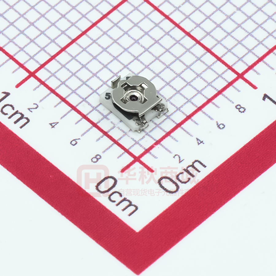

Features n Recommended for reflow soldering n Rotor design compatible with pick n For trimmer applications/processing guidelines, click here and place and automatic adjustment equipment n 3 mm size meets EIA/EIAJ standard trimmer footprint n RoHS compliant* Electrical Characteristics Standard Resistance Range ....................... 100 ohms to 1 megohm (see standard resistance table) Resistance Tolerance............. ±25 % std. Absolute Minimum Resistance ≤ 1 K Ohms................... 20 ohms max. >1 K Ohms.................. 2 % max. of TR Contact Resistance Variation..... 5 % max. Resolution.................. Essentially infinite Adjustment Angle................. 270 ° ± 20 ° TC33 - 3 mm SMD Trimpot® Trimming Potentiometer Product Dimensions TC33X-1 (1) Use an adjustment tool with the following recommended measurements: 1.7 mm (.067 in.) cross slot The recommended adjustment tool size is not available from Bourns. Please contact a Bourns representative for further information. 2.1 (.083) 1.75 (.069) 2 3.8 (.150) 3.8 (.150) 2.0 (.079) 0.65 (.026) 3 1 1.5 (.059) 1.2 (.047) 0.75 (.030) SEE MOUNTING NOTE BELOW 1.0 (.039) 0.8 (.031) 2.1 (.083) 2 0.5 (.020) 2.0 (.079) 0.65 (.026) 3.6 (.142) 3.0 (.118) 1.75 (.069) 0.5 (.020) Environmental Characteristics Power Rating (50 VDC max.) 70 °C..................................... 0.15 watt Temperature Range.....-40 °C to +100 °C Temperature Coefficient.....±250 ppm/°C Humidity...... +40 °C ± 2 °C, 90-95 % RH TRS max. ........................................±5 % Load Life ........ @ 70 °C rated power 1000 hours TRS ±5 % Rotational Cycling ..........................20 cycles, TRS ±10 % Physical Characteristics Torque................ 0.98-11.76 mN-m max. Mechanical Angle.....Continuous rotation for Model TC33X-1 Marking.......................Part marking code Standard Packaging.... 2500 pcs./7 ” reel Adjustment Tool..................... See note(1) Pushing Static Force...................
TC33X-2-501E
物料型号:TC33X-1, TC33X-2
器件简介:这是一种3毫米尺寸的SMD电位器,符合EIA/EIAJ标准,适用于回流焊接,兼容拾取放置和自动调节设备。
引脚分配:文档中未明确列出具体的引脚分配,但通常电位器有三个引脚:一个固定端,一个滑动端(可变电阻),一个公共端。
参数特性: - 标准电阻范围:100欧姆至1兆欧(具体值见标准电阻表) - 电阻公差:±25%标准值 - 绝对最小电阻:≤1K欧姆时最大20欧姆,>1K欧姆时为TR的2% - 接触电阻变化:最大5% - 分辨率:基本上是无限的 - 调整角度:270°±20°
功能详解: - 适用于电位器应用和处理指南 - RoHS合规 - 环境特性包括功率等级、温度范围、温度系数和湿度 - 负载寿命:在70°C额定功率下1000小时,TRS±5% - 旋转循环:20次,TRS±10%
应用信息:适用于需要调整电阻值的应用,如音频设备、仪器控制等。
封装信息: - 尺寸:1.2mm x 0.7mm x 3.0mm - 推荐封装图案 - 标准包装:2500 pcs./7英寸卷轴 - 调整工具:需要一个1.7mm交叉槽的工具
注意事项: - 不推荐使用水洗 - 不推荐使用波峰焊接;使用回流焊接 - TC33型号不设计用于与助焊剂一起使用 - 不建议超过有效旋转角度调整TC33X-1型号 - 调整电阻值时,如果对滑动部分施加过大力量,可能会导致变形或断裂。
