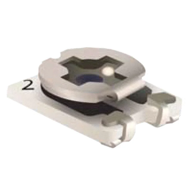

Features n Single-turn cermet/open-frame n 2 mm size meets EIA/EIAJ standard trimmer footprint n RoHS compliant* n For trimmer applications/processing guidelines,2.2click here 1.1 (.043) (.087) 0.3 (.012) 0.45 (.018) TC42 - 2 mm SMD Trimpot® Trimming Potentiometer 1.3 (.051) Electrical Characteristics Standard Resistance Range ........................... 100 ohms to 1 megohm (see standard resistance table) Resistance Tolerance................. ±25 % std. Absolute Minimum Resistance ≤ 1K Ohms........................ 20 ohms max. > 1K Ohms...................... 2 % max. of TR Contact Resistance Variation......... 5 % max. Resolution...................... Essentially infinite Adjustment Angle...................... 240 ° ±20 ° 1.5 (.059) Product (1) Use an adjustment tool with the following recommended measurements: • 1.2 mm (.047 in.) blade slot • 0.2 mm (.008 in.) slot width The recommended adjustment tool size is not available from Bourns. Please contact a Bourns representative for further information. Cautions • Aqueous cleaning not recommended • Flow soldering not recommended; use reflow soldering • Model TC42 is not designed to be used with flux - use care with flux when soldering • It is not recommended to adjust the Model TC42X-2 past the effective rotary angle. • If an excessive force is applied to the sliding part (the operating shaft) when adjusting the resistance value, the sliding part may be deformed or broken. WARNING Cancer and Reproductive Harm www.P65Warnings.ca.gov 1.5 (.059) 0.45 (.018) 0.3 (.012) 1.3 (.051) 1.5 (.059) 0.45 (.018) 1.3 (.051) 0.8 ± 0.1 1.0 (.039) (.031 ± .004) 2 0.6 (.024) 1.15 0.3 (.045)(.012) 1.0 (.039) 3 0.6 (.024) 1.0 1 (.039) 1.9 (.075) 1.0 (.039) 1.0 0.6 (.039) (.024) 0.7 (.028) 2 1.3 1 (.051) 1.9 (.075) 1.8 (.071) 1.0 Recommended Land (.039) 1.0 (.039) 1.9 0.6 (.075) (.024) 8.00 (.315) 1.75 ± 0.1 (.069 ± .004) 3.25 ± 0.05 (.128 ± .002) 3.0 (.118) 1.5 (.059) 5.5 (.217) 0.3 (.012) 4.0 ± 0.1 (.157 ± .004) 8.00 (.315) 1.75 ± 0.1 (.069 ± .004) 2.0 ± 0.1 (.079 ± .004) 1.15 (.045) 4.0 ± 0.1 (.157 ± .004) 4.0 ± 0.1 (.157 ± .004) 2.0 ± 0.1 (.079 ± .004) 180.0 -3/+0 (7.09 -.118/+0) 9.0 ± 1.0 (.354 ± .039) 11.4 ± 1.0 (.449 ± .039) 0.7 (.028) Pattern 0.7 (.028) 180.0 -3/+0 (7.09 -.118/+0) 1.3 (.051) 1.8 (.071) 1.0 (.039) 1.9 (.075) 4.0 ± 0.1 3.25 ± 0.05 (.157 ± .004) (.128 ± .002) 3.0 (.118) DIA. 1.55 ± 0.05 (.061 ± .002) 2.8 (.110) 3 5.5 (.217) 0.3 (.012) DIA. 1.55 ± 0.05 (.061 ± .002) 2.8 (.110) Physical Characteristics Torque.................... 0.49 - 7.84 mN-m max. Mechanical Angle.........Continuous rotation Marking...........................Part marking code Standard Packaging........ 3000 pcs./7 ” reel Adjustment Tool......................... See note(1) Pushing Static Force........................

物料型号:TC42 - 2 mm SMD Trimpot® Trimming Potentiometer
器件简介:单圈陶瓷/开放式框架电位器,2毫米尺寸符合EIA/EIAJ标准可变电阻器尺寸,RoHS合规。
引脚分配:文档中未明确提供引脚分配信息。
参数特性: - 标准电阻范围:100欧姆至1兆欧 - 电阻公差:±25%标准值 - 绝对最小电阻:对于小于或等于1千欧姆的,最大20欧姆;大于1千欧姆的,最大2%的总电阻值 - 接触电阻变化:最大5% - 分辨率:基本上是无限的 - 调整角度:240°±20°
功能详解: - 功率等级:在70°C下,0.1瓦特 - 温度范围:-40°C至+100°C - 温度系数:±250 ppm/°C - 湿度:在+40°C±2°C,90-95% RH条件下测试 - 推荐的调整工具尺寸:0.2毫米(0.008英寸)槽宽或1.2毫米(0.047英寸)刀片槽
应用信息:适用于可变电阻器应用和加工。
封装信息:60.0毫米直径,标准封装3000 pcs./7英寸卷。
