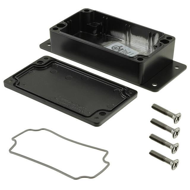

    金属 - 铝 盒 黑色 包含盖 4.545" 长 x 2.578" 宽(115.44mm x 65.48mm) X 1.185"(30.10mm)
AN-2802-AB 数据手册
ALUMINUM IP68 NEMA/UL TYPE 4,4X, 6, 6P, 12, 13 WITH WELDED EXTERNAL MOUNTING BRACKET  Ordering Information The AN-28xx-A series is an upgraded (IP68) replacement for the AN-28xx series. The only change is the gasket. They will be stocked by SKU as the current inventory is depleted. Natural Finish Catalog No. AN-2800-A AN-2801-A AN-2802-A AN-2803-A AN-2804-A AN-2805-A AN-2806-A AN-2807-A AN-2808-A AN-2809-A AN-2810-A AN-2811-A AN-2812-A AN-2813-A AN-2814-A AN-2815-A AN-2816-A AN-2817-A AN-2818-A AN-2819-A AN-2820-A AN-2821-A AN-2822-A AN-2823-A Black Finish Catalog No. AN-2800-AB AN-2801-AB AN-2802-AB AN-2803-AB AN-2804-AB AN-2805-AB AN-2806-AB AN-2807-AB AN-2808-AB AN-2809-AB AN-2810-AB AN-2811-AB AN-2812-AB AN-2813-AB AN-2814-AB AN-2815-AB AN-2816-AB AN-2817-AB AN-2818-AB AN-2819-AB AN-2820-AB AN-2821-AB AN-2822-AB AN-2823-AB Size LxWxD 3.54 1.42 1.18 2.52 2.28 1.38 4.53 2.56 1.18 4.53 2.56 2.17 4.53 3.54 2.17 5.83 4.25 2.95 6.73 4.76 2.17 8.75 5.75 2.17 8.75 5.75 3.25 4.75 4.75 4.00 6.25 6.25 4.00 1.95 1.77 1.12 3.85 2.52 1.35 4.90 3.14 1.59 4.90 3.14 2.26 5.91 2.52 1.45 6.29 3.93 2.37 6.29 3.93 3.19 2.19 1.61 1.22 3.13 2.93 2.05 4.04 2.07 1.00 6.89 3.15 2.36 7.87 4.72 2.95 10.24 6.30 3.56 Weight lb. 0.34 0.34 0.55 0.83 0.96 1.65 1.65 3.37 4.81 2.06 2.41 0.18 0.47 0.86 1.04 0.86 1.57 1.88 0.13 0.55 0.23 1.12 1.87 3.77  Priced, sold and packaged in quantities of one  Contact the factory for modifications BUD INDUSTRIES, INC.  4605 E. 355th Street Willoughby, Ohio 44094  (440) 946-3200  Fax (440) 951-4015 E-MAIL: saleseast@budind.com  WEB SITE: www.budind.com BUD WEST  440-946-3200 saleswest@budind.com Tradename AN-A Series IP68 Benefits and Features          0.09” External mounting brackets allow the box to be mounted on a wall or panel without having to remove the cover and exposing internal components to the environment Pre molded continuous Silicon gasket with outstanding performance. Rugged #ADC-12 alloy die cast aluminum box Available NEMA 6 (natural finish) & 6P (recommended powder coated Black for extra corrosion protection) Test results exceeded the requirements in respect to IEC60529 IP68 conditions (UL Type 6P tested under 6’ of water for 24 hours) Type 4X,6,6P,12,13 as listed under UL file #E194432 Cover attaches with stainless screws torqued at 12 in-lb. Easily machined and modified to your particular requirements Offers EMC protection Accessories   Aluminum internal panels ANX-91xxx series IP67 Cable glands IPG series Applications           Related Products     Switches Pushbuttons Connectors Cable Glands Key Customer Contacts    Design Engineers and Designers Manufacturing Engineers Electronic Engineers and Designers Questions to Ask      Instrument cases Meter cases Junction boxes Marine applications High Oil exposure applications Wet and dirty industrial applications Wash-down environments BUD has the first UL Type 6P (IP68) in this class of product style. best performance Die cast enclosure at an extremely competitive price Eliminates the need for customer to remove cover to mount box, thereby protecting internal components. Is your application exposed to occasional submersion? Who specifies your enclosures? Do you need the durability of a die cast aluminum enclosure? Does your product require EMC protection? Does your product require protection from a wet or dirty environment? Availability Transitioning through 2016 with the first sizes available in November 2015 BUD INDUSTRIES, INC.  4605 E. 355th Street Willoughby, Ohio 44094  (440) 946-3200  Fax (440) 951-4015 E-MAIL: saleseast@budind.com  WEB SITE: www.budind.com BUD WEST  440-946-3200 saleswest@budind.com

1. 物料型号:AN-A系列IP68外壳,包括多种尺寸和颜色选项。 2. 器件简介:这些外壳是AN-28xx系列的升级版,具有IP68防水等级,主要变化是密封垫。 3. 引脚分配:文档中未提及引脚分配,因为它是关于外壳的。 4. 参数特性: - 外壳材料:ADC-12合金压铸铝。 - 密封:预制的连续硅密封垫。 - 安装:0.09英寸的外部安装支架,允许外壳在墙上或面板上安装,无需移除盖子。 - EMC保护:提供电磁兼容性保护。 - 测试结果:超过IEC60529 IP68条件的要求。 - 认证:UL Type 4X, 6, 6P, 12, 13。 5. 功能详解:外壳设计用于保护内部组件,防止环境因素影响,适用于多种工业应用。 6. 应用信息:适用于仪器箱、计量箱、接线盒、海洋应用、高油暴露应用、潮湿和脏乱的工业应用以及冲洗环境。 7. 封装信息:外壳尺寸和重量详细列出,以及自然色和黑色粉末涂层选项。 8. 相关产品:开关、按钮、连接器、电缆入口。 9. 客户联系:设计工程师、设计师、制造工程师、电子工程师。 10. 问题咨询:文档建议询问应用是否需要偶尔浸泡保护、外壳规格、铝合金外壳的耐用性、EMC保护以及是否需要在潮湿或脏乱环境中使用。
