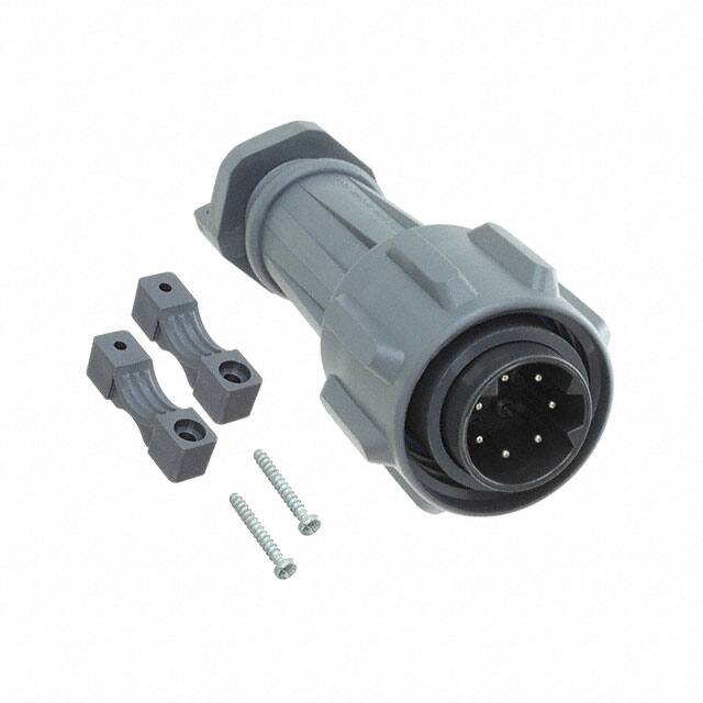

Introduction EXPlora The EXPlora range is most suited to manufacturers of ancillary electrical equipment such as motors, pumps, lighting equipment, process and control gear for use in factories and plant where hazardous or explosive atmospheres can be caused by flammable gases, mists or vapours or by combustible dusts. Independently tested for compliance to ATEX standards for use in Zone 2 and Zone 22 environments, the new EXP series is manufactured from a tough,high grade UL94V-0 rated Polyester material and provides environmental sealing to IP68. The ATEX coding is: Ex II 3 GD and the certificated no: Baseefa09ATEX0232X. EXPlora is rated up to 18A, 600V AC/DC for 2, 3, 4 and 5 Contacts, 16A, 430V AC/DC for 7 Contact and 10A, 250V AC/DC for 10 Contacts. The 3, 4, 5 and 7 Contact versions have leading earth contacts making them suitable for single or three phase applications. Circular Power Connectors 9 EXPlora EXP Series EXPlora - Hazardous Area ATEX approval for Zone 2 and Zone 22 applications ‘Scoop proof’ contacts Independently tested Field termination - screw terminations ATEX Coding: ATEX Classification: II 3 GD Ex nA IIC T6 Gc Ex tc IIIC T85°C Dc ATEX Certificate No: Baseefa09ATEX0232X Positive locating keyways - cannot be mis-connected Sealing caps available to maintain IP68 rating of unmated connectors IP68 rating tested at 1.054kg/sq cm (15lb/sq in) Compact design 10m depth for 2 weeks Easy assembly - no special tools required Up to 18A, 600V AC/DC rating Single or 3 phase applications 2, 3, 4, 5, 7 and 10 Contact Cost effective solution Leading earth contact for 3, 4, 5 & 7 Contact versions Cable acceptance from 7 to 22mm O/D Trailing Neutral on 5 Contact Plug or socket connection in each body style Two cable connector versions for 15mm and 22mm (maximum) cable diameters Water and dustproof to IP68 when mated Separate strain relief on large cable version 10 Circular Power Connectors EXPlora EXP Series EXPlora Hazardous Area Connector Flex Cable Connector EXP-0911 Flex Cable Connector Mates with Inline or panel mounting versions Positive, fast acting locking ring - can be turned with a gloved hand Plug or socket versions EXP-0 Series13-15mm cable dia. acceptance as standard, 7-13mm with additional Gland Pack PX0980 EXP-A Series 20-22mm cable dia. Acceptance as standard, 14-20mm with additional Gland Pack PXA980 Strain Relief Clamp EXP-A911 Standard Cable Large Cable Description Standard Cable Large Cable Description EXP-0911/02/P EXP-0911/03/P EXP-0911/04/P EXP-0911/05/P EXP-0911/07/P EXP-0911/10/P EXP-A911/02/P EXP-A911/03/P EXP-A911/04/P EXP-A911/05/P EXP-A911/07/P EXP-A911/10/P 2 Contact Plug 3 Contact Plug 4 Contact Plug 5 Contact Plug 7 Contact Plug 10 Contact Plug EXP-0911/02/S EXP-0911/03/S EXP-0911/04/S EXP-0911/05/S EXP-0911/07/S EXP-0911/10/S EXP-A911/02/S EXP-A911/03/S EXP-A911/04/S EXP-A911/05/S EXP-A911/07/S EXP-A911/10/S 2 Contact Socket 3 Contact Socket 4 Contact Socket 5 Contact Socket 7 Contact Socket 10 Contact Socket Inline Cable Connector EXP-0921 Inline Cable Connector Mates with either EXP-0911 or EXP-A911 connectors Plug or socket versions EXP-0 Series13-15mm cable dia. acceptance as standard, 7-13mm with additional Gland Pack PX0980 EXP-A Series 20-22mm cable dia. acceptance as standard, 14-20mm with additional Gland Pack PXA980 Strain Relief Clamp EXP-A921 Standard Cable Large Cable Description Standard Cable Large Cable Description EXP-0921/02/P EXP-0921/03/P EXP-0921/04/P EXP-0921/05/P EXP-0921/07/P EXP-0921/10/P EXP-A921/02/P EXP-A921/03/P EXP-A921/04/P EXP-A921/05/P EXP-A921/07/P EXP-A921/10/P 2 Contact Plug 3 Contact Plug 4 Contact Plug 5 Contact Plug 7 Contact Plug 10 Contact Plug EXP-0921/02/S EXP-0921/03/S EXP-0921/04/S EXP-0921/05/S EXP-0921/07/S EXP-0921/10/S EXP-A921/02/S EXP-A921/03/S EXP-A921/04/S EXP-A921/05/S EXP-A921/07/S EXP-A921/10/S 2 Contact Socket 3 Contact Socket 4 Contact Socket 5 Contact Socket 7 Contact Socket 10 Contact Socket Circular Power Connectors 11 EXPlora EXP Series EXPlora Hazardous Area Connector Front Panel Mounting Connector Mates with EXP-0911 and EXP-A911 connectors Single hole fixing Anti-rotation key High grade sealing gasket 3-7mm panel thickness EXP-0931 Panel Mounting EXP-0931/02/P EXP-0931/03/P EXP-0931/04/P EXP-0931/05/P EXP-0931/07/P EXP-0931/10/P Flange Mounting Connector EXP-0941 2 Contact Plug 3 Contact Plug 4 Contact Plug 5 Contact Plug 7 Contact Plug 10 Contact Plug EXP-0931/02/S EXP-0931/03/S EXP-0931/04/S EXP-0931/05/S EXP-0931/07/S EXP-0931/10/S 2 Contact Socket 3 Contact Socket 4 Contact Socket 5 Contact Socket 7 Contact Socket 10 Contact Socket EXP-0941/02/S EXP-0941/03/S EXP-0941/04/S EXP-0941/05/S EXP-0941/07/S EXP-0941/10/S 2 Contact Socket 3 Contact Socket 4 Contact Socket 5 Contact Socket 7 Contact Socket 10 Contact Socket Mates with EXP-0911 and EXP-A911 connectors Supplied with high grade sealing gasket Supplied with sealing grommets for panel fixing screws (M6 thread recommended) Panel Mounting EXP-0941/02/P EXP-0941/03/P EXP-0941/04/P EXP-0941/05/P EXP-0941/07/P EXP-0941/10/P 2 Contact Plug 3 Contact Plug 4 Contact Plug 5 Contact Plug 7 Contact Plug 10 Contact Plug Sealing Caps Sealing Caps Heavy duty sealing caps to maintain IP68 rating of unmated connectors, with stainless steel straps EXP-0990 Heavy duty sealing cap for use with EXP-0911/xx/x and EXP-A911/xx/x EXP-0991 Heavy duty sealing cap for use with EXP-0921/xx/x and EXP-A921/xx/x EXP-0992 Heavy duty sealing cap for use with EXP-0931 and EXP-0941 EXP-0990, EXP-0991, EXP-0992 Gland Packs Cable Glands Packs of 3 additional pairs Cable Glands for 900 Series Flex Cable Connectors PX0980, PXA980 12 Circular Power Connectors EXP-0980 Pack of 3 additional cable glands for EXP-0911 and EXP-0921 to suit cable sizes: 7-9mm (Dark Grey), 9-11mm (White) and 11-13mm (Black) diameter EXP-A980 Pack of 3 additional cable glands for EXP-A911 and EXP-A921 to suit cable sizes: 14-16mm (Dark Grey), 16-18mm (White) and 18-20mm (Black) diameter EXPlora EXP Series EXPlora - Hazardous Area Connector Part No System EXP-X9 Series Designation 09 = Standard Cable Accommodation (ø7-15mm) A9 = Large Cable Accommodation (ø14-22mm) X X XX Body Styles Contact Termination 1 = Flex, 2 = Inline, 3 = Front Panel, 4 = Flange Panel 1 = Screw Terminal Number of Contacts 02 03 04 05 07 10 X X Contact Type Cable Acceptance P = Plug, S = Socket EXP-0 version: Blank = 13-15mm Yellow cable gland (std) 3 = 11-13mm Black cable gland 2 = 9-11mm White cable gland Example: 1 = 7-9mm Dark Grey cable gland EXP-0911/07/P/3 = Flex cable connector body, seven Plug contacts, with gland to suit 11-13mm cable. EXP-A version: Blank = 20-22mm Yellow cable gland (std) Contact Layout 9 = 18-20mm Black cable gland 2 Contact 3 Contact 4 Contact 5 Contact Overall dimensions of connectors when mated together: EXP-0911 + EXP-0921 EXP-A911 + EXP-A921 EXP-0911 + EXP-0931 230 mm max. 270 mm max. 135 mm max. (to panel) EXP-A911 + EXP-A931 EXP-0911 + EXP-0941 point on flange) EXP-A911 + EXP-A941 point on flange) 7 Contact 10 Contact 8 = 16-18mm White cable gland 7 = 14-16mm Dark Grey cable gland 175 mm max. (to panel) 145 mm max. (to panel, mid 174 mm max. (to panel, mid Circular Power Connectors 13 EXPlora EXP Series EXPlora - Hazardous Area Connector Specifications Electrical: No Contacts: Current Rating: Mechanical: 2, 3, 4, 5 7 10 18A 16A 10A Sealing: IP68, EN60529:2001 tested @ 1.054kg/sq.cm. (15lb/sq.in.) 10m depth for 2 weeks Cable Acceptance: EXP-0911 - EXP-0921 13 - 15mm O/D standard, 7-13mm with Gland Pack PX0980 EXP-A911 - EXP-A921 20 - 22mm O/D standard, 14 - 20mm with Gland Pack PXA980 Contact Accommodation: 2-7 Contact - 2.5 to 4mm2 (14 to 10AWG) conductor, single or multi stranded 10 Contact - 0.75 to 2mm2 (14 to 18AWG) conductor, single or multi stranded Axial screw terminals 22mm dia, 150N 15mm dia, 150N 7mm dia, 80N Voltage Rating: 600V AC/DC 430V AC/DC 250V AC/DC Contact Resistance: 10⁶MΩ (@ 500V DC) Dielectric strength: 2.2kV DC min AC Breakdown voltage: 6kV Ambient Temperature Range: –20°C to +55°C Termination: Standards: ATEX Zone 2 and Zone 22 IEC60079-0:2007 IEC60079-15:2005 II 3 GD Baseefa09ATEX0232X Ex nA IIC T6 Gc Ex tc IIIC T85°C Dc Cable Retention force: ATEX Coding: ATEX Certificate No: ATEX Classification: Materials: Body Mouldings: Cap Mouldings: Flammability Rating: UV Resistance: Contacts: O Rings: Sealing Gasket: RoHS Polyester Polycarbonate UL94V-0 To EN50021:1999 Machined Solid Brass, Nickel plated Nitrile Panel Silicone Rubber Compliant Gland Nut Torques: EXP-0 range 13-15mm (Yellow - std.) 11-13mm (black) 9-11mm (white) 7-9mm (dark grey) EXP-A range 20-22mm (Yellow - std.) 18-20mm (black) 16-18mm (white) 14-16mm (dark grey) Tightening Torques: Panel mount nut Flange & Bulkhead fixing screws Rear thread EXP-0931 series 14 Circular Power Connectors 3.16Nm (28lbf/in) 3.16Nm (28lbf/in) 3.16Nm (28lbf/in) 3.16Nm (28lbf/in) 3.16Nm (28lbf/in) 3.16Nm (28lbf/in) 3.16Nm (28lbf/in) 3.16Nm (28lbf/in) 2.25Nm 0.9Nm M36 x 2-6g
