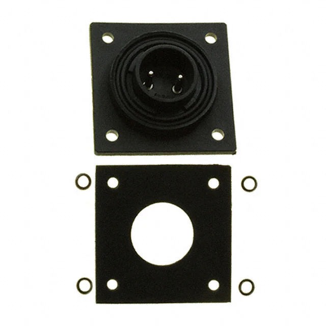

BUCCANEER FOR POWER Standard Buccaneer IP68 rating tested at 1.054kg/sq cm (15lb/sq in) 10m depth for 2 weeks and 9.84kg/sq cm (140lb/sq in) 100m depth for 12 hours IP69K, Tested in accordance with DIN 40050/Part 9 IP6k9k Water and dustproof to IP68 when mated 2, 3, 4, 6, 7, 9, 12 and 25 Contact 12A, 277V AC/DC 2 Contact screw terminal, 3 Contact screw terminal and crimp contacts 10A, 277V AC/DC 4 Contact screw terminal 5A, 277V AC/DC6 and 7 Contact screw terminal 5A, 150V AC/DC 9 Contact crimp contacts 5A, 50V AC/DC 12 Contact crimp and solder contacts 1A, 50V AC/DC 25 Contact crimp and solder contacts Plug or socket connection in each body style Compact design Diameter over coupling ring 38mm Sealing caps available to maintain IP68 rating of unmated connectors 7 body styles - flex cable, Inline cable, panel mount (front), panel mount (rear), PCB mount, bulkhead and flange mount Leading earth contact for 3 Contact socket version Positive locating keyways - cannot be mis-connected Easy assembly - no special tools required on screw terminal versions Cable range from 3.5mm - 9mm Colour coded identification variants Pre-wired, overmoulded cable assemblies UL, CSA and VDE approvals EN60068-2-52 Test Kb Salt Mist (Cyclic) Marine Severity Level 1 Circular Power Connectors 21 BUCCANEER FOR POWER Standard Buccaneer Flex Cable Connector PX0731/P Mates with Inline or Panel Mounting Versions Screw Locking Ring Plug or Socket Versions Leading Earth on 3 Contact connectors Contacts 2, 3, 4, 6, 7, 9, 12, 25 Standard Cable Acceptance (2 to 9 Contact) 6-8mm, 3.5-9mm with alternative glands See page 25 Contacts Termination Plug Contacts Socket Contact 2 3 3 4 6 7 9 12 25 Screw Screw Crimp Screw Screw Screw Crimp Crimp/Solder Crimp/Solder PX0736/P PX0731/P PX0776/P PX0748/P PX0739/P PX0745/P PX0728/P PX0794/P PX0820/P PX0736/S PX0731/S PX0776/S PX0748/S PX0739/S PX0745/S PX0728/S PX0794/S PX0820/S Inline Cable Connector PX0732/S Termination Plug Contacts 2 3 3 4 6 7 9 12 25 Screw Screw Crimp Screw Screw Screw Crimp Crimp/Solder Crimp/Solder PX0737/P PX0732/P PX0778/P PX0749/P PX0740/P PX0746/P PX0729/P PX0795/P PX0821/P Socket Contact PX0737/S PX0732/S PX0778/S PX0749/S PX0740/S PX0746/S PX0729/S PX0795/S PX0821/S Pre Wired Flex Cable Connector Overmoulded cable assemblies Up to 14mm dia cable with PVC or PU jackets Mates with Inline connector and all panel connectors 22 Circular Power Connectors Supplied Fitted Supplied Fitted Supplied Loose Supplied Fitted Supplied Fitted Supplied Fitted Supplied Loose Order Separately (SA3348/SA3347) Order Separately (SA3180/SA3179) Mates with Flex or Panel Mounting Versions Screw Locking Ring Plug or Socket Versions Leading Earth on 3 Contact connectors Contacts 2, 3, 4, 6, 7, 9, 12, 25 Standard Cable Acceptance (2 to 9 Contact) 6-8mm, 3.5-9mm with alternative glands See page 25 Contacts PX0700 Contacts Contacts Supplied Fitted Supplied Fitted Supplied Loose Supplied Fitted Supplied Fitted Supplied Fitted Supplied Loose Order Separately (SA3348/SA3347) Order Separately (SA3180/SA3179) BUCCANEER FOR POWER Standard Buccaneer Front Panel Mounting Connector Mates with Flex Cable Connector Single Hole Fixing Plug or Socket Versions Contacts 2, 3, 4, 6, 7, 9, 12, 25 PX0730/P Contacts 2 3 3 4 6 7 9 12 25 Termination Screw Screw Crimp Screw Screw Screw Crimp Crimp/Solder Crimp/Solder Plug Contacts Socket Contact Contacts PX0735/P PX0730/P PX0779/P PX0747/P PX0738/P PX0744/P PX0727/P PX0796/P PX0822/P PX0735/S PX0730/S PX0779/S PX0747/S PX0738/S PX0744/S PX0727/S PX0796/S PX0822/S Supplied Fitted Supplied Fitted Supplied Loose Supplied Fitted Supplied Fitted Supplied Fitted Supplied Loose Order Separately Order Separately Rear Panel Mounting Connector Mates with Flex Cable Connector Single Hole Fixing Plug or Socket Versions Contacts 2, 3, 4, 6, 7, 9, 12 or 25 PX0709/P/03 Contacts Termination Plug Contacts Socket Contact Contacts 2 3 3 4 6 7 9 12 25 Screw Screw Crimp Screw Screw Screw Crimp Crimp/Solder Crimp/Solder PX0709/P/02 PX0709/P/03 PX0708/P/03 PX0709/P/04 PX0709/P/06 PX0709/P/07 PX0708/P/09 PX0708/P/12 PX0708/P/25 PX0709/S/02 PX0709/S/03 PX0708/S/03 PX0709/S/04 PX0709/S/06 PX0709/S/07 PX0708/S/09 PX0708/S/12 PX0708/S/25 Supplied Fitted Supplied Fitted Supplied Loose Supplied Fitted Supplied Fitted Supplied Fitted Supplied Loose Order Separately (SA3348/SA3347) Order Separately (SA3180/SA3179) Sprung Loaded Sealing Cap IP54 rated Spring loaded Clip shut to seal For use with front of panel mounting connector types PX0713 Circular Power Connectors 23 BUCCANEER FOR POWER Standard Buccaneer Rear PCB Mounting Connector Mates with Flex Cable connector No. Contacts: 3, 4, 6, 9, 12 or 25 Plug or socket versions Pre-loaded Gold Plated contacts PX0707/P/12 Contacts Termination Plug Contacts Socket Contact Contacts 3 4 6 9 12 25 PCB PCB PCB PCB PCB PCB PX0707/P/03 PX0707/P/04 PX0707/P/06 PX0707/P/09 PX0707/P/12 PX0707/P/25 PX0707/S/03 PX0707/S/04 PX0707/S/06 PX0707/S/09 PX0707/S/12 PX0707/S/25 Supplied Fitted Supplied Fitted Supplied Fitted Supplied Fitted Supplied Fitted Supplied Fitted Bulkhead Flange Mounting Connector  ates with Flex Cable M Connector Plug or Socket Versions Contacts 2, 3, 4, 6, 7, 9, 12, 25 Supplied with sealing gasket and screw sealing grommets PX0756/S Contacts Termination Plug Contacts Socket Contact Contacts 2 3 3 4 6 7 9 12 25 Screw Screw Crimp Screw Screw Screw Crimp Crimp/Solder Crimp/Solder PX0757/P PX0756/P PX0787/P PX0761/P PX0758/P PX0760/P PX0762/P PX0798/P PX0823/P PX0757/S PX0756/S PX0787/S PX0761/S PX0758/S PX0760/S PX0762/S PX0798/S PX0823/S Supplied Fitted Supplied Fitted Supplied Loose Supplied Fitted Supplied Fitted Supplied Fitted Supplied Loose Order Separately (SA3348/SA3347) Order Separately (SA3180/SA3179) Low Profile Flange Mounting Connector Screw Flange Fixing Plug or Socket Versions Contacts 2, 3, 4, 6, 7, 9, 12, 25 Mates with Flex Cable Connector Supplied with sealing gasket and screw sealing grommets PX0765/S Contacts Termination Plug Contacts Socket Contact Contacts 2 3 3 4 6 7 9 12 25 Screw Screw Crimp Screw Screw Screw Crimp Crimp/Solder Crimp/Solder PX0764/P PX0765/P PX0781/P PX0766/P PX0767/P PX0768/P PX0769/P PX0797/P PX0824/P PX0764/S PX0765/S PX0781/S PX0766/S PX0767/S PX0768/S PX0769/S PX0797/S PX0824/S Supplied Fitted Supplied Fitted Supplied Loose Supplied Fitted Supplied Fitted Supplied Fitted Supplied Loose Order Separately (SA3348/SA3347) Order Separately (SA3180/SA3179) 24 Circular Power Connectors BUCCANEER FOR POWER Standard Buccaneer Accessories Coloured Contact Inserts Contact Inserts Colour Options With or without matching gland nut Positive visual identification Available in; Black, Blue, Green, Grey, Light Grey, Red, White and Yellow Coloured Inserts Part No Blank BL GN GY LG RD WH YL Suffix Colour Black Blue Green Grey Light Grey Red White Yellow Insert/Gland Nut Combinations 1 2 Insert and Gland Nut Coloured Insert Only Coloured E.g. PX0731/P/YL1 = Yellow insert and gland nut Contacts for 12 and 25 Contact Inserts Contacts - Solder & Crimp for 12 and 25 Contact Crimp or Solder Plugs and Sockets Gold Plated Current ratings: 12 way: 5A, 50V 25 way: 1A, 50V 12 and 25 way contacts Assembly Tools Contacts (for 12 Contact) (Supplied in packs of 10) Solder Crimp Plugs Sockets SA3348/1 SA3348 SA3347 SA3347/1 Contacts (for 25 Contact) (Supplied in packs of 10) Solder Crimp Plugs Sockets SA3180/1 SA3180 SA 3179/1 SA3179 Tools Crimp Tools for 3, 9,12 and 25 Contact crimp contacts Insertion/Extraction Tool for 25 Contact contacts Crimp Tool (25 Contact) Crimp Tool (12 Contact) Positioner (12 Contact) Crimp Tool (9 Contact) Crimp Tool (3 Contact) 3 Contact positioner Insertion/Extraction Tool (25 Contact) Insertion/Extraction Tool (12 Contact) Insertion/Extraction Tool (3 Contact) PNo. 14025/1AMP PNo. 14025 PNo. 14025/5AMP PNo. 13826 PNo. 14232 PNo. 14232/1 PNo. 13027 PNo. 13027/1 PNo. 13027/3 PNo 14025 and 13027 Cable Glands Cable Acceptance - Alternatives Pack of alternative cable glands to suit cables from 3.5 to 9mm dia. 12023/1, 12023/2 & SA3253 Gland Diameter Gland Part No. Gland Colour Additional Suffix 6-8mm 3.5-5mm 5-7mm 7-9mm Gland Pack 12023 SA3426 12023/1 12023/2 SA3253 Black Standard for 2-12 Contact Grey Suffix /04† White Suffix /05 Yellow Suffix /07* Pack of 3 glands to suit cables 3.5-5mm, 5-7mm & 7-9mm dia† *Note: 7-9mm gland standard for 25 way, no suffix required. †Includes additional black gland cage for 3.5-5mm dia. cable range. To order connector with alternative cable gland add suffix to part no. e.g. PX0731/P/07 = PX0731 3 Plug connector with cable gland to suit 7-9mm dia. cable. Cable Acceptance - Standard as supplied No. Contacts Cable Diameter or Type 2-12 Contact 25 Contact 6-8mm 7-9mm Circular Power Connectors 25 BUCCANEER FOR POWER Standard Buccaneer Accessories Sealing Cap and Assembling Tool PX0734 & PX0733 Rear of Panel Back Shell PX0799  aintains IP68 Rating of M Unmated Connectors Can be used to remove Inserts PX0734 for Flex Cable Connector PX0733 for Inline, Front Panel, Bulkhead and Flange mount connectors PX0711 for PCB and Rear Panel Mount connectors  rovides environmental seal to P rear of panel Standard cable acceptance 6-8mm, 3.5 to 9mm with alternative glands For use on front panel mounting connectors Replaces mounting nut in panel connector PVC Insulation Boot  hock protection for rear of S connector Flammability Rating UL94V-0 Fits Front Panel Mount Versions only PNo. 12855 Cable Support Accessory Gives Extra Support to the Cable Suitable for 5-7mm and 7-9mm Cable Diameters PNo. 12237 26 Circular Power Connectors BUCCANEER FOR POWER Part No System X PX07XX Body Styles Contacts Type PX0736 PX0731 PX0776 PX0748 PX0739 PX0745 PX0728 PX0794 PX0820 PX0737 PX0732 PX0778 PX0749 PX0740 PX0746 PX0729 PX0795 PX0821 PX0735 PX0730 PX0779 PX0747 PX0738 PX0744 PX0727 PX0796 PX0822 PX0709 PX0708 PX0707 PX0757 PX0756 PX0787 PX0761 PX0758 PX0760 PX0762 PX0798 PX0823 PX0764 PX0765 PX0781 PX0766 PX0767 PX0768 PX0769 PX0797 PX0824 P = Plug S = Socket XX XX X Cable Acceptance or PCB/Rear Panel Mounting Insert/Gland Nut Colour Insert/Gland Nut Colour Combination Flex Cable and Inline Connectors cable acceptance use: Blank = 6-8mm (Black) standard for 2-12 Contact Blank = Black BL = Blue GN = Green GY = Grey 1 = Insert and Gland Nut Coloured 2 = Insert only Coloured 04 = 3.5-5mm (Grey) 05 = 5-7mm (White) 07 = 7-9mm (Yellow) (standard for 25 way, no suffix required) PCB (PX0707) and Rear Panel Mount connectors (PX0708 and PX0709) use: 02 = 2 Contact 04 = 4 Contact 07 = 7 Contact 12 = 12 Contact LG = Light Grey RD = Red WH = White YL = Yellow 03 = 3 Contact 06 = 6 Contact 09 = 9 Contact 25 = 25 Contact Front Panel, Bulkhead and Flange Mount not required: Examples: PX0707/P/06= PCB Panel connector, Plug contacts, 6 Contact PX0731/S = Flex Cable connector, socket contacts, 3 Contact PX0732/P/07/BL2 = Inline Cable connector, Plug contacts, 3 Contact, 7-9mm cable acceptance, blue insert PCB Layouts Sockets Contact Nos viewed from rear of panel Plugs Contact Nos viewed from rear panel rear of panel PX0707/S/03 PX0707/S/04 PX0707/P/03 PX0707/P/04 PX0707/S/06 PX0707/S/09 PX0707/P/06 PX0707/P/09 PX0707/S/12 PX0707/S/25 PX0707/P/12 PX0707/P/25 Circular Power Connectors 27 BUCCANEER FOR POWER Specifications Mechanical: Electrical: No. Contacts: Current Rating: VDE UL, CSA Voltage Rating (AC/DC): Contact Resistance: 2, 3 4 6, 7 9 12 25 Insulation Resistance: AC Breakdown voltage: >10⁴MΩ @ 500V DC (2-9 Contact) 4kV Contact - Contact (2-9 Contact) 6kV Contacts - Panel (Low Profile Flange and Panel Types – 2-9 Contact) 7.5kV Contacts - Panel (Other Types – 2-9 Contact) 12A 10A 5A 5A 5A 1A 12A 10A 5A 5A 5A 1A 277V 277V 277V 150V 50V 50V

物料型号:Buccaneer系列连接器,由Bulgin公司生产。
器件简介:Buccaneer系列连接器具有多种防护等级,包括IP68和IP69K,能够在极端环境下使用。它们设计用于多种接触点数量,如2、3、4、6、7、9、12和25,并有多种连接方式,包括螺钉端子、夹紧端子和焊接端子。
引脚分配:连接器支持不同数量的接触点,具体分配如下: - 2、3、4接触点:螺钉端子 - 6、7接触点:螺钉端子 - 9接触点:夹紧端子 - 12接触点:夹紧/焊接端子 - 25接触点:夹紧/焊接端子
参数特性:电流和电压等级因接触点数量而异,例如: - 2接触点:12A, 277V AC/DC - 3接触点:12A, 277V AC/DC(螺钉端子);10A, 277V AC/DC(夹紧端子) - 4接触点:10A, 277V AC/DC - 6和7接触点:5A, 277V AC/DC - 9接触点:5A, 150V AC/DC - 12接触点:5A, 50V AC/DC - 25接触点:1A, 50V AC/DC
功能详解:Buccaneer系列连接器具有紧凑设计,多种安装方式,如电缆安装、面板安装、PCB安装等。它们还具有领先的地球接触点、正定位键槽以防止误连接,以及易于组装的特点。
应用信息:这些连接器适用于多种环境和应用,包括海洋、工业和汽车领域。
封装信息:连接器有多种封装类型,包括柔性电缆连接器、直列电缆连接器、前面板安装连接器、后面板安装连接器、PCB安装连接器、隔板安装连接器和法兰安装连接器。
