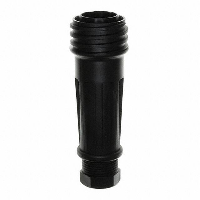

    CONN RCPT MALE 5POS NICKEL SCREW
PX0921/05/P 数据手册
BUCCANEER FOR POWER 900 Series Buccaneer IP68 rating tested at 1.054kg/sq cm (15lb/sq in) 10m depth for 2 weeks Trailing Neutral on 5 Contact Compact design IP69K, Tested in accordance with DIN 40050/Part 9 IP6k9k Easy assembly - no special tools required 32A, 600V AC/DC rating Single or 3 phase applications 2, 3, 4, 5, 7 and 10 Contact  ulkhead moulding available for use with flange B mounting body for 45° or 90° mounting (order each separately) Plug or socket connection in each body style Water and dustproof to IP68 when mated Cost effective solution ‘Scoop proof’ contacts Cable accommodation 7-22mm O/D Field termination - screw terminations Positive locating keyways - cannot be mis-connected Sealing caps available to maintain IP68 rating of unmated connectors  Leading earth contact for 3, 4, 5 and 7 Contact versions  wo cable connector versions for 15mm and 22mm T (maximum) cable diameters  Separate strain relief on large cable version UL, CSA and VDE approvals EN60068-2-52 Test Kb Salt Mist (Cyclic) Marine Severity Level 1 Circular Power Connectors 15 BUCCANEER FOR POWER 900 Series Buccaneer Flex Cable Connector PX0911 Flex Cable Connector PXA911 Mates with Inline or panel mounting versions Positive, fast acting locking ring - can be turned with a gloved hand Plug or socket versions PX0 Series13-15mm cable dia. as standard, 7-13mm with additional Gland Pack PX0980 PXA Series 20-22mm cable dia. as standard, 14-20mm with additional Gland Pack PXA980 Strain Relief Clamp Standard Cable Large Cable Description Standard Cable Large Cable Description PX0911/02/P PX0911/03/P PX0911/04/P PX0911/05/P PX0911/07/P PX0911/10/P PXA911/02/P PXA911/03/P PXA911/04/P PXA911/05/P PXA911/07/P PXA911/10/P 2 Contact Plug 3 Contact Plug 4 Contact Plug 5 Contact Plug 7 Contact Plug 10 Contact Plug PX0911/02/S PX0911/03/S PX0911/04/S PX0911/05/S PX0911/07/S PX0911/10/S PXA911/02/S PXA911/03/S PXA911/04/S PXA911/05/S PXA911/07/S PXA911/10/S 2 Contact Socket 3 Contact Socket 4 Contact Socket 5 Contact Socket 7 Contact Socket 10 Contact Socket Inline Cable Connector PX0921 Inline Cable Connector Mates with either PX0911 or PXA911 connectors Plug or socket versions PX0 Series 13-15mm cable dia. as standard, 7-13mm with additional Gland Pack PX0980 PXA Series 20-22mm cable dia. as standard, 14-20mm with additional Gland Pack PXA980 Strain Relief Clamp PXA921 Standard Cable Large Cable Description Standard Cable Large Cable Description PX0921/02/P PX0921/03/P PX0921/04/P PX0921/05/P PX0921/07/P PX0921/10/P PXA921/02/P PXA921/03/P PXA921/04/P PXA921/05/P PXA921/07/P PXA921/10/P 2 Contact Plug 3 Contact Plug 4 Contact Plug 5 Contact Plug 7 Contact Plug 10 Contact Plug PX0921/02/S PX0921/03/S PX0921/04/S PX0921/05/S PX0921/07/S PX0921/10/S PXA921/02/S PXA921/03/S PXA921/04/S PXA921/05/S PXA921/07/S PXA921/10/S 2 Contact Socket 3 Contact Socket 4 Contact Socket 5 Contact Socket 7 Contact Socket 10 Contact Socket 16 Circular Power Connectors BUCCANEER FOR POWER 900 Series Buccaneer Front Panel Mounted Connector Mates with PX0911 and PXA911 connectors Single hole fixing Anti-rotation key High grade sealing gasket 3-7mm panel thickness PX0931 Panel Mounting PX0931/02/P PX0931/03/P PX0931/04/P PX0931/05/P PX0931/07/P PX0931/10/P Flange Mounted Connector PX0941 2 Contact Plug 3 Contact Plug 4 Contact Plug 5 Contact Plug 7 Contact Plug 10 Contact Plug PX0931/02/S PX0931/03/S PX0931/04/S PX0931/05/S PX0931/07/S PX0931/10/S 2 Contact Socket 3 Contact Socket 4 Contact Socket 5 Contact Socket 7 Contact Socket 10 Contact Socket PX0941/02/S PX0941/03/S PX0941/04/S PX0941/05/S PX0941/07/S PX0941/10/S 2 Contact Socket 3 Contact Socket 4 Contact Socket 5 Contact Socket 7 Contact Socket 10 Contact Socket Mates with PX0911 and PXA911 connectors Supplied with high grade sealing gasket Supplied with sealing grommets for panel fixing screws (M6 thread recommended) Flange Mounting PX0941/02/P PX0941/03/P PX0941/04/P PX0941/05/P PX0941/07/P PX0941/10/P 2 Contact Plug 3 Contact Plug 4 Contact Plug 5 Contact Plug 7 Contact Plug 10 Contact Plug Circular Power Connectors 17 BUCCANEER FOR POWER 900 Series Buccaneer Accessories Additional Bulkhead Adaptor Moulding PX0950 Additional Bulkhead Adaptor Moulding  or use with flange mounting F connector PX0941, to give 45° or 90° angle Supplied with high grade sealing gasket Supplied with sealing grommets for panel fixing screws (M6 thread recommended) PX0950 & PX0941 Sealing Caps PX0960, PX0970, PX0990, PX0991, PX0992 Sealing caps to maintain IP68 rating of unmated connectors, with plastic straps Heavy duty sealing caps to maintain IP68 rating of unmated connectors, with stainless steel straps Sealing Caps PX0960 PX0970 PX0990 PX0991 PX0992 PX0980 Pack of 3 additional cable glands for PX0911 and PX0921 to suit cable sizes: 7-9mm (dark grey), 9-11mm (white) and 11-13mm (Black) diameter PXA980 Pack of 3 additional cable glands for PXA911 and PXA921 to suit cable sizes: 14-16mm (dark grey), 16-18mm (white) and 18-20mm (black) diameter Packs of 3 additional pairs Cable Glands 18 Circular Power Connectors Heavy duty sealing cap for use with PX0911/xx/x and PXA911/xx/x Heavy duty sealing cap for use with PX0921/xx/x and PXA921/xx/x Heavy duty sealing cap for use with PX0931Wand PX0941 Gland Packs Cable Glands PX0980, PXA980 Sealing cap for use with PX0911/xx/x and PXA911/xx/x Sealing cap for use with all other styles BUCCANEER FOR POWER 900 Series Buccaneer Specifications Electrical Mechanical: No Contacts: 2, 3 4, 5 Current Rating: Voltage Rating: 32A 30A, CSA 600V AC/DC Contact Resistance: Insulation Resistance: Dielectric strength: AC Breakdown voltage: 10⁶MΩ (@ 500V DC) 2.2kV AC min 6kV 7 32A 32A 25A, CSA 25A, CSA* 600V AC/DC 430V AC/DC Operating Temperature Range: –40°C to +85°C Approvals: UL (Underwriters Laboratory) CSA (Canadian Standards Association) VDE (Verband der Elektrotechnik) 10† Sealing: 10A UL 250V AC/DC E214972 1211899 40003148 IP68, EN60529:1992+A2:2013 tested @ 1.054kg/sq.cm. (15lb/sq.in.) 10m depth for 2 weeks Salt Mist: EN60068-2-52 Test Kb Salt Mist (Cyclic) Marine Severity Level 1 Cable Acceptance: PX0911-PX0921 13 - 15mm O/D standard, 7-13mm with gland pack PX0980 PXA911-PXA921 20 - 22mm O/D standard, 14 - 20mm with gland pack PXA980 Contact Accommodation: 2-7 Contact - 2.5 to 4mm2 (14 to 10AWG) conductor, single or multi stranded 10 Contact - 0.75 to 2.5mm2 (14 to 18AWG) conductor, single or multi stranded *with 75ºC min. rated cable Material Body Mouldings: IP69K, Tested in accordance with DIN 40050/Part 9 IP6K9K. Termination: Axial screw terminals Cable Retention force: 22mm dia, 150N 15mm dia, 150N 7mm dia, 80N Polyamide Flammability Rating: UL94V-0 UV Resistance: To EN50021: 1999 Gland Nut Torques: Contacts: Machined Solid Brass, Nickel plated O Rings: Nitrile Panel Sealing Gasket: Silicone Rubber RoHS Compliant PX0 range 13-15mm (Yellow - std.) 11-13mm (black) 7-9mm (dark grey) PXA range 20-22mm (Yellow - std.) 18-20mm (black) 16-18mm (white) 14-16mm (dark grey) Contact Layout 3.16Nm (28 lbf.in.) 3.16Nm (28 lbf.in.) 3.16Nm (28 lbf.in.) 3.16Nm (28 lbf.in.) 3.16Nm (28 lbf.in.) 3.16Nm (28 lbf.in.) 3.16Nm (28 lbf.in.) Tightening Torques: 2 Contact 3 Contact 4 Contact 5 Contact Dimensions Overall dimensions of connectors when mated together PX0911 + PX0921 230 mm max. PXA911 + PXA921 270 mm max. 7 Contact 10 Contact Panel mount nut Flange & Bulkhead fixing screws Inserts into Bodies Term screws - 2 to 5 Contacts Term screws - 7 Contact Term screws - 10 Contact 2.25Nm (20 lbf.in.) 0.9Nm (8 lbf.in.) 1.13Nm (10 lbf.in.) to 1.36Nm (12 lbf.in.) 1.0Nm (9 lbf.in.) max 0.4Nm (3.5 lbf.in.) max 0.25Nm (2.2 lbf.in.) max Rear thread PX0931 series M36 x 2-6g PX0911 + PX0931 135 mm max. (to panel) PXA911 + PX0931 175 mm max. (to panel) PX0911 + PX0941 145 mm max. (to panel, mid point on flange) PXA911 + PX0941 174 mm max. (to panel, mid point on flange) Circular Power Connectors 19 BUCCANEER FOR POWER 900 Series Buccaneer Part No System PXX9 X X XX X XX Series Designation Body Styles Contact Termination Number of Contacts Contact Type Cable Acceptance 09 = Standard Cable Accommodation (ø7-15mm) 1 = Flex 2 = Inline 3 = Front Panel 4 = Flange Panel 1 = Screw Terminal A9 = Large Cable Accommodation (ø14-22mm) Example: PX0911/07/P/03 = Flex cable connector with standard cable accommodation body, seven Plug contacts, with gland to suit 11-13mm cable. 02 03 04 05 07 10 P = Plug, S = Socket PX-0 version: Blank = 13-15mm Yellow cable gland (std) 3 = 11-13mm Black cable gland 2 = 9-11mm White cable gland 1 = 7-9mm Dark Grey cable gland PX-A version: Blank = 20-22mm Yellow cable gland (std) 9 = 18-20mm Black cable gland 8 = 16-18mm White cable gland 7 = 14-16mm Dark Grey cable gland 20 Circular Power Connectors
